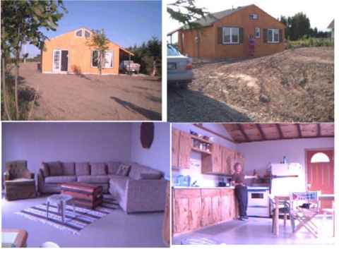

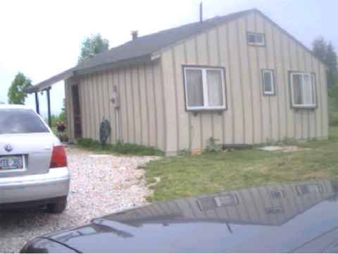

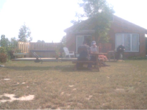

Quoting: brandon3006 the first time around Two bedrooms [9x10] , loft [8x12] bath 5x7 , great room 14 x 24 . cottage_aug_30.jpg

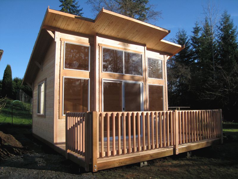

Thanks for all the input. Bldng, here's what i'm thinking...something super efficient and small to start, like a 150-200 sq ft cabin. I'll try and attach a picture of what i'm thinking for the place.
brandon3006
# Posted: 10 Feb 2014 01:46pm
Heres a building similar in style to the one I want to build, with mine being built of brick instead of wood. I have no idea about the roof, but i know I want a roof in this sloped style.

A building as pictured with a wall of windows is beyond simple DIY design. There is not enough space to have the bldg code required shear wall sections for one thing. Walls like that are engineered for wind loads against the face and sideways across the plane of the wall as well as the more obvious vertical loads. Depending where in VA you are or end up you may also be in a special wind zone that requires better than average windows because of the probability of higher than average winds.
Remember not every design seen on the internet is a product of an educated designer. Not every project seen has been built to best design and construction practices or applicable building codes.

In looking at your picture, another consideration would be ventilation. All of the windows look very nice, but if they are exposed to the south, summer would be very hot in that building.
