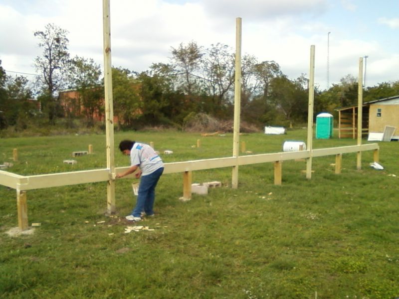

# Posted: 15 Feb 2014 09:17pm
Thanks all. I am the kind of guy that is always seeking knowledge, and feel I can always learn from others. I am by no means a pro at building, but I will say that I dont shy away from a challenge. I never built a home before this one, but am a Disabled Marine that dont have a Quit, button installed With that said I will definately be chiming in, and asking lots of questions. I didnt have any plans or blueprints to work of of. I bought myself a laser transome from Harbor Freight to get a good level on my post for the foundation, and went from there. I put treated 4x4,s in concrete 2 ft. deep, and spaced them 8 ft. apart. Left the post 10ft above ground, and incorporated them in my walls. Seemed like a good thing to do No pro by no means, so please help...

# Posted: 15 Feb 2014 10:22pm
eddienlinda

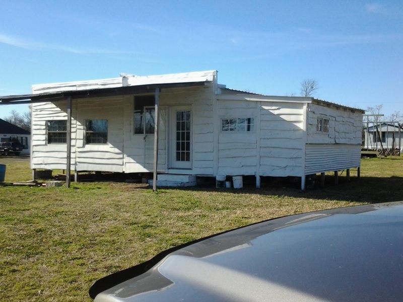

Your foundation sounds very similar to ours. Our cabin was 12X16 so we put 6"X6"'s in the four corners and 4X4's halfway down each side. Our base wrap is a 2"X12" with two 1/2" bolts through each upright. Our floor joists are 2X8's and it feels very sturdy...as yours does I'm sure. We added a sideroom (8'X16') a year after we built the cabin and built it the same way.
Your picture above looks like a cabin that is going to be much larger than a 16X20??

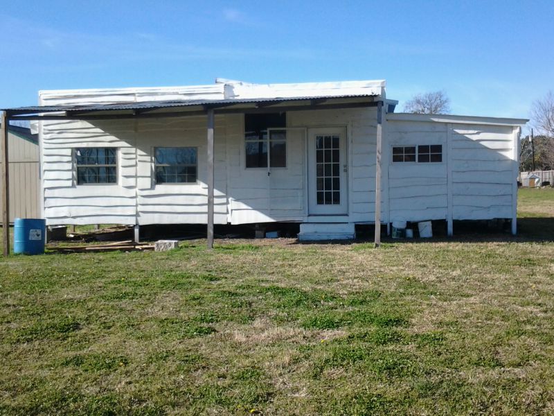

# Posted: 16 Feb 2014 09:16pm
The cabin/home above is 20x34. We made it 3 bedroom, and 1 1/2 baths. 12x20 living/cooking area, and a laundry room

# Posted: 16 Feb 2014 09:29pm
We have since stained it with a white solid siding stain. It will be trimmed in grey around trim. Here are pics of the land we have a contract on, and plan on having a get away cabin on it. Looking at several options for the cabin on the new land that may later be turned into our forever home once the kids are out of school, and gone.

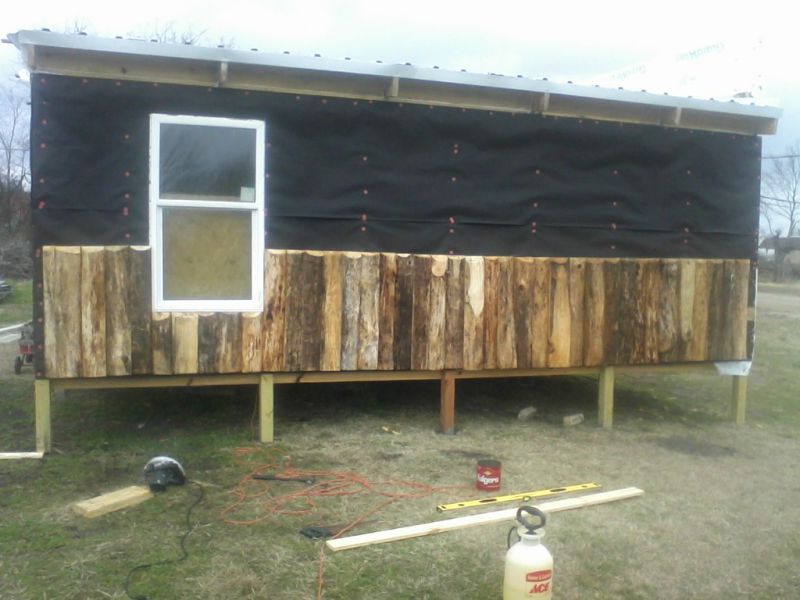

# Posted: 16 Feb 2014 09:39pm

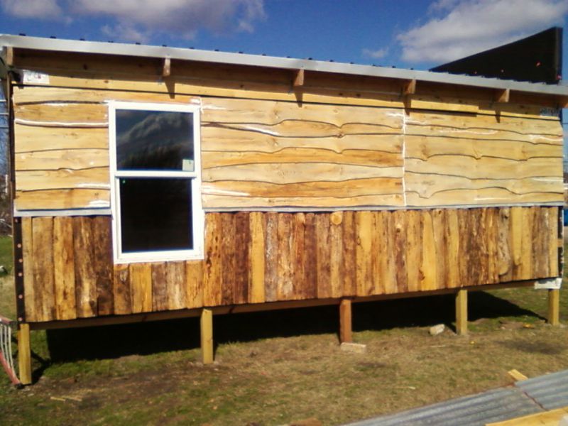

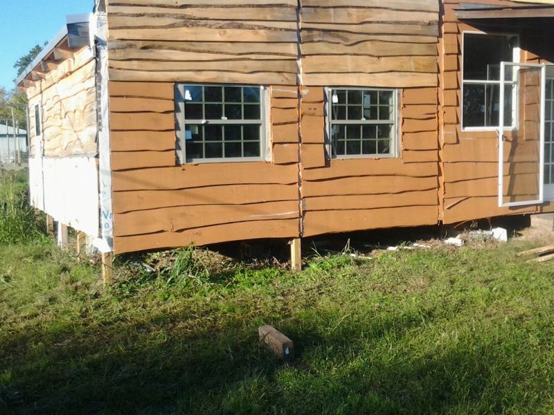

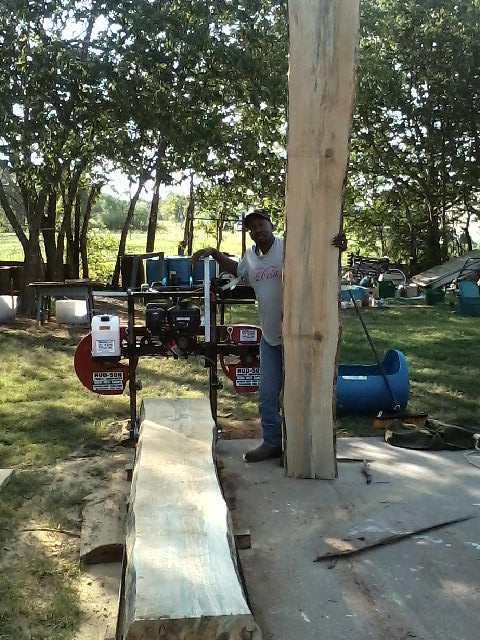

Few more pics of our little sawmill house build
# Posted: 17 Feb 2014 12:43am
I like the look of the irregular siding. Using a bandmill is a lot of fun, seeing what the inside of the tree looks like- a new discovery with every board.
Do critters like to hang out underneath the house?

# Posted: 17 Feb 2014 08:49am
What are the thin white lines? Some sort of chinking to fill in cracks?

# Posted: 17 Feb 2014 10:52am
Mike 870 that is a high grade calk/chink to fill in cracks. I sawed standing dead pines to get around the drying time, and also I dont like to cut good healthy trees. People are more than willing to let me cut standing dead trees for the logs off their property. Works out great for both of us.
