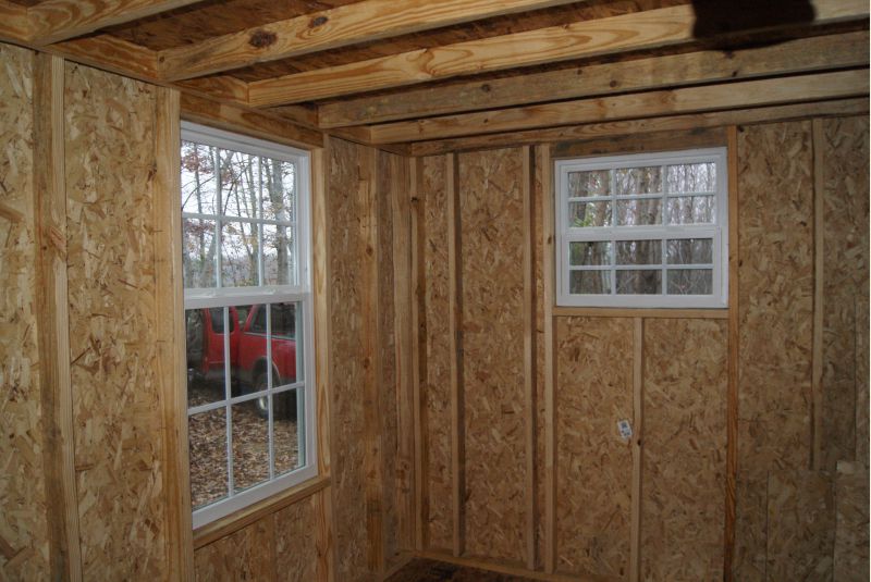

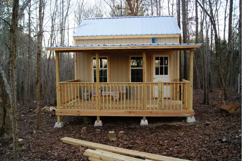

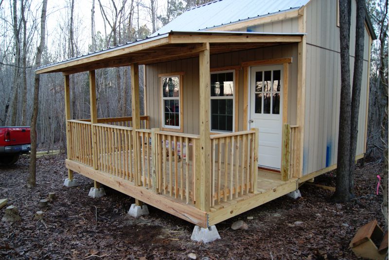

We purchased this property at the end of September and started clearing the old drive to the back of the property. What started of as a place to drag our camper to...kinda grew!
I had it all designed in my head when I found this forum. I like a lot of ideas from this site especially Taiwin and thier 12 X 16.
As I was designing our cabin, I came across theirs. Let me tell ya, great minds must think alike cause thiers looked almost exactlly like the ideas floating around my head!

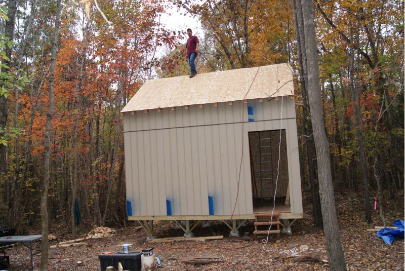

What started our as a 12x16 shed plan from a local discount building supplier changed...a lot...![DSC03743.JPG DSC03743.JPG](https://www.small-cabin.com/forum/shared_files/uploaded/4348/64380_1.jpg) DSC03743.JPG
| ![DSC03764.JPG DSC03764.JPG](https://www.small-cabin.com/forum/shared_files/uploaded/4348/64380_2.jpg) DSC03764.JPG
| ![DSC03855.JPG DSC03855.JPG](https://www.small-cabin.com/forum/shared_files/uploaded/4348/64380_3.jpg) DSC03855.JPG
| ![DSC03885.JPG DSC03885.JPG](https://www.small-cabin.com/forum/shared_files/uploaded/4348/64380_4.jpg) DSC03885.JPG

gersus
# Posted: 23 Feb 2014 11:54
I think your cabin is way better than a camper ;) Love the porch!! How about some inside pics?
ATB
# Posted: 23 Feb 2014 11:59
Very nice
knock

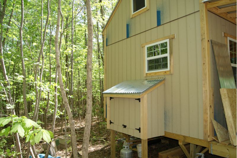

# Posted: 23 Feb 2014 13:01
I agree, very nice. Waiting for the inside pics.

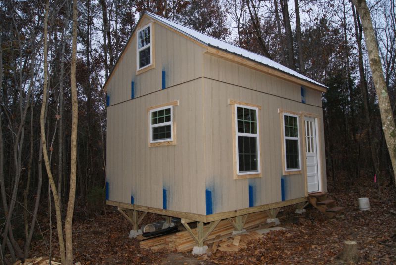

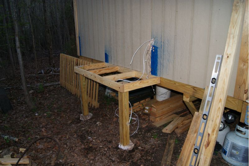

What are the blue marks on the siding? do they serve some purpose?
keljohnso
# Posted: 23 Feb 2014 15:28
Thanks all!

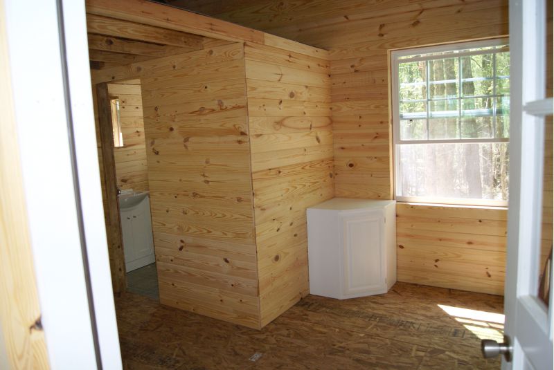

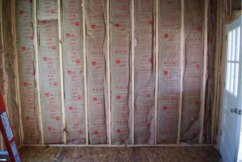

Not much on the inside yet. We put in insullation and ran the 12/120 volt wiring (no pics).
The lighting will be 12 volt, and we will have 1 outlet for a tv and a ceiling fan w/light running off an invertor.
We plan on using T&G pine panels and some type of laminate wood flooring.
We will also have a 8x8 bbq deck coming off the porch

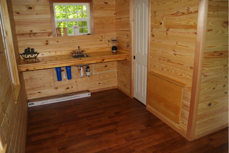

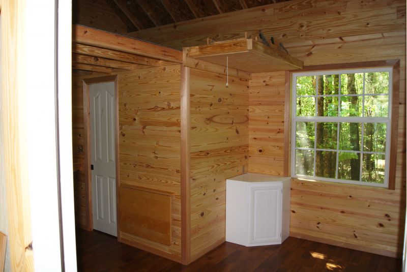

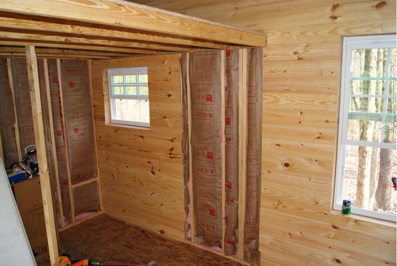

The blue marks on the ouside are from the mill. Some sort of ID, not sure.![Loft Loft](https://www.small-cabin.com/forum/shared_files/uploaded/4348/64394_1.jpg) Loft
| ![Kitchen Kitchen](https://www.small-cabin.com/forum/shared_files/uploaded/4348/64394_2.jpg) Kitchen
| ![Bath and living area window Bath and living area window](https://www.small-cabin.com/forum/shared_files/uploaded/4348/64394_3.jpg) Bath and living area window
| ![Dining area Dining area](https://www.small-cabin.com/forum/shared_files/uploaded/4348/64394_4.jpg) Dining area

Awesome looking place! Love the space in the loft. Great use of the extra height staying in the 12x16 footprint. Was the same design we were looking at before we ended up going bigger.

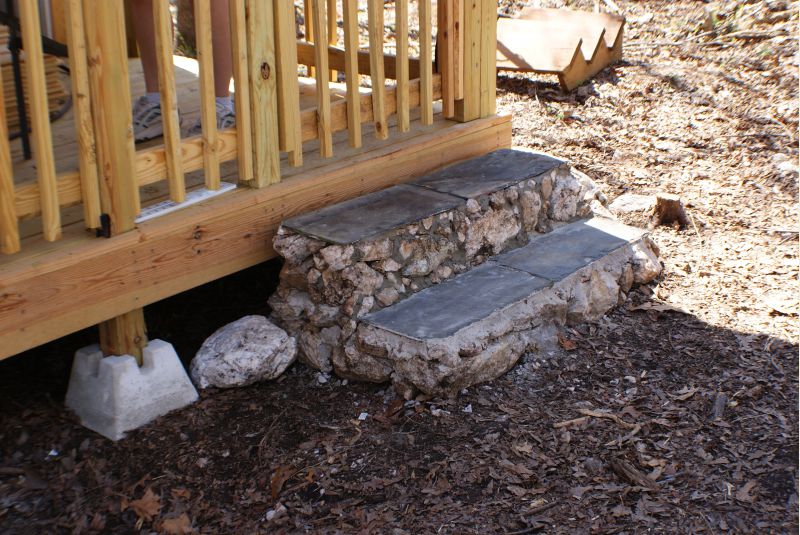

Stone steps and T & G pine on the first wall...![Steps Steps](https://www.small-cabin.com/forum/shared_files/uploaded/4348/66138_1.jpg) Steps

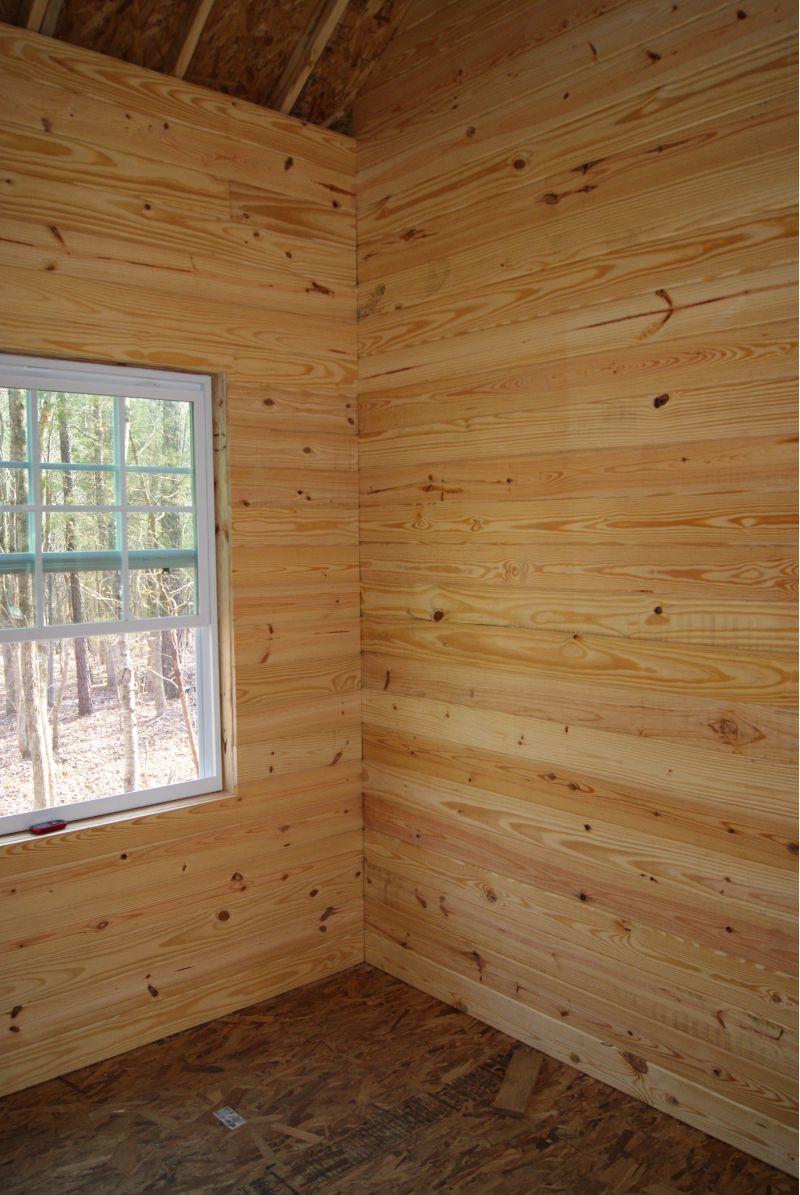

| ![Wall after Wall after](https://www.small-cabin.com/forum/shared_files/uploaded/4348/66138_3.jpg) Wall after

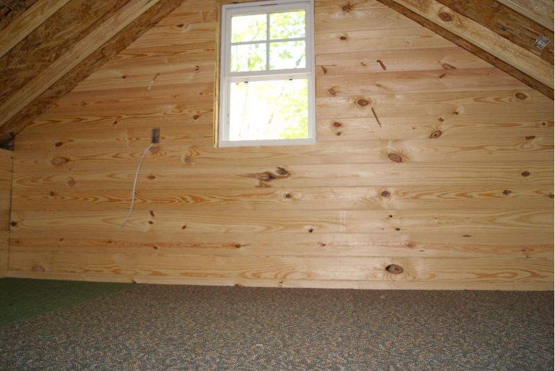

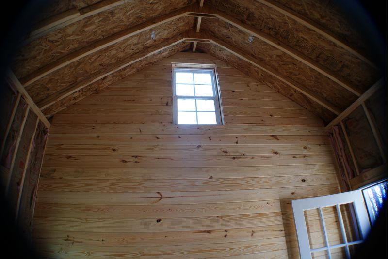

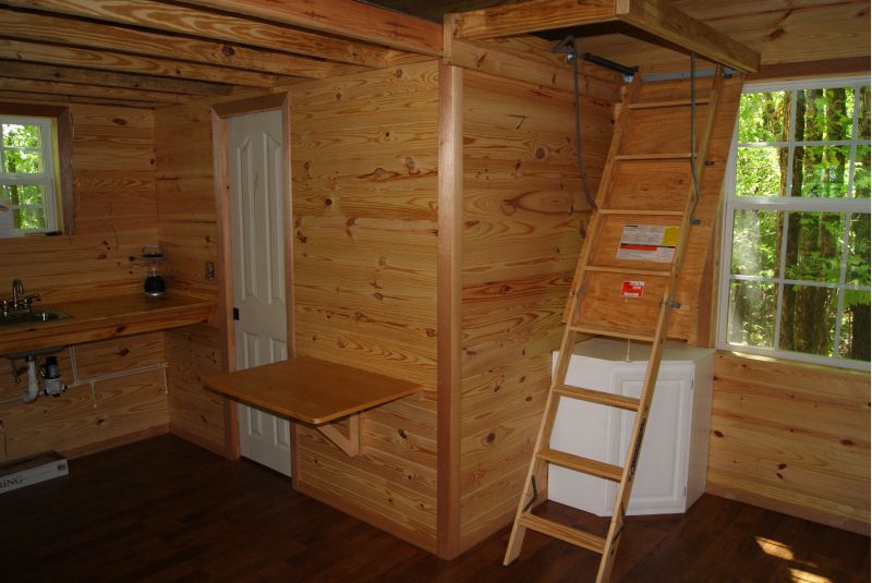

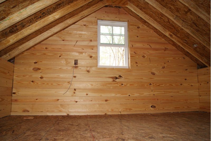

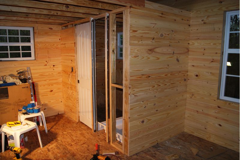

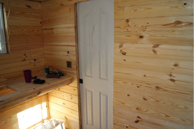

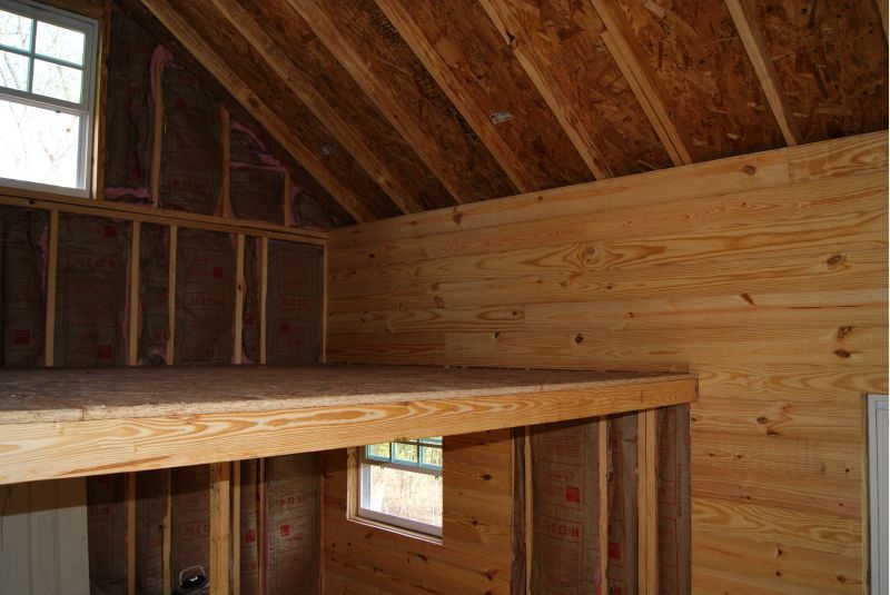

More from this week...![Loft Loft](https://www.small-cabin.com/forum/shared_files/uploaded/4348/66523_1.jpg) Loft
| ![Pocket door Pocket door](https://www.small-cabin.com/forum/shared_files/uploaded/4348/66523_2.jpg) Pocket door
| ![DSC04117.JPG DSC04117.JPG](https://www.small-cabin.com/forum/shared_files/uploaded/4348/66523_3.jpg) DSC04117.JPG

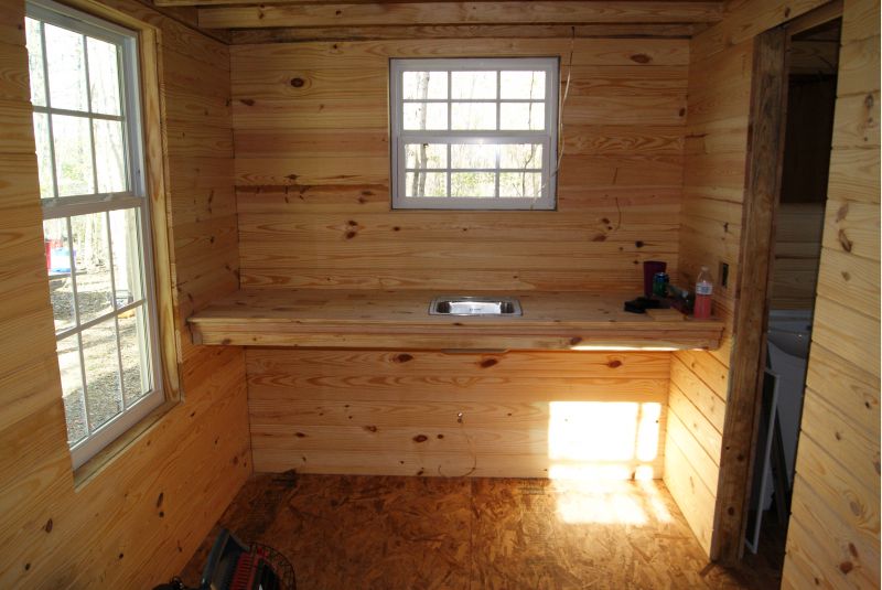

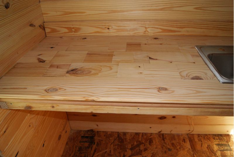

| ![Kitchen countertop Kitchen countertop](https://www.small-cabin.com/forum/shared_files/uploaded/4348/66523_4.jpg) Kitchen countertop

| ![addon for elec., plumbing, and water heater. addon for elec., plumbing, and water heater.](https://www.small-cabin.com/forum/shared_files/uploaded/4348/66524_4.jpg) addon for elec., plumbing, and water heater.

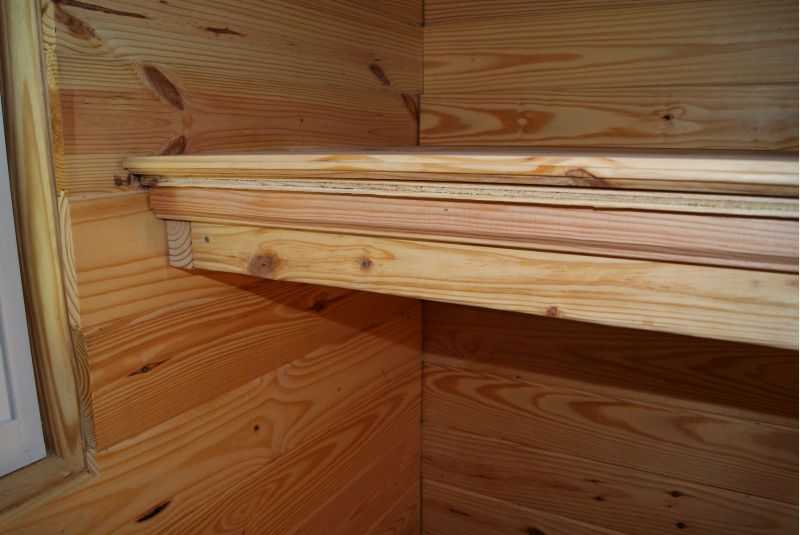

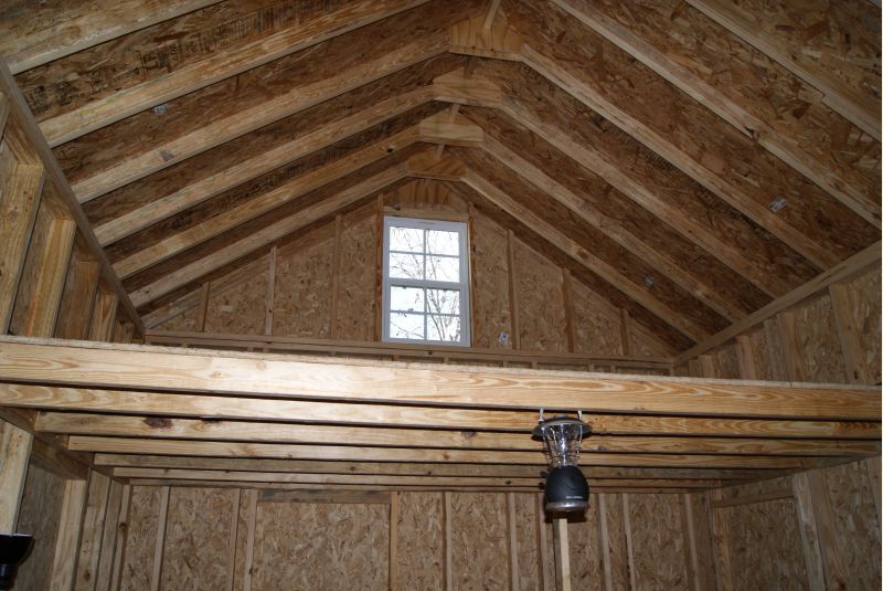

nice work. did you hang notched 2x6s on 2x4s attached to the wall studs for the floor of your loft?
dsc04122. that's some shelf.
keljohnso
# Posted: 20 Apr 2014 18:24
Quoting: creeky did you hang notched 2x6s on 2x4s attached to the wall studs for the floor of your loft?
No I just nailed the loft joist at every stud.
On the countertop I framed it out of 2x4 then added some 3/8 plywood so I could add the scrap t&g pine. We're really pleased with the end result!

How are you going to insulate the celing? Did you put up a vapour barrier after the insulation but before the T & G pine?
What's the product on the outside? Is it something similar to "Smart Side"?
keljohnso
# Posted: 23 Apr 2014 12:50
For now I plan on leaving the ceiling exposed. I may insulate and cover with T & G later.
I didn't put any vapor barrier up, maybe I'll regret it I dunno.
Yes its like the Smart Siding, resin on the outside and osb on the other.

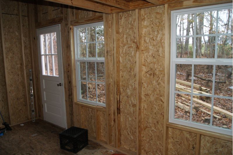

More pics...![Loft Loft](https://www.small-cabin.com/forum/shared_files/uploaded/4348/67271_1.jpg) Loft
| ![DSC04143.JPG DSC04143.JPG](https://www.small-cabin.com/forum/shared_files/uploaded/4348/67271_2.jpg) DSC04143.JPG
| ![Utility room Utility room](https://www.small-cabin.com/forum/shared_files/uploaded/4348/67271_3.jpg) Utility room

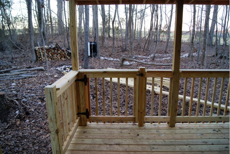

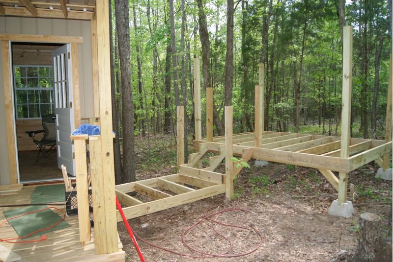

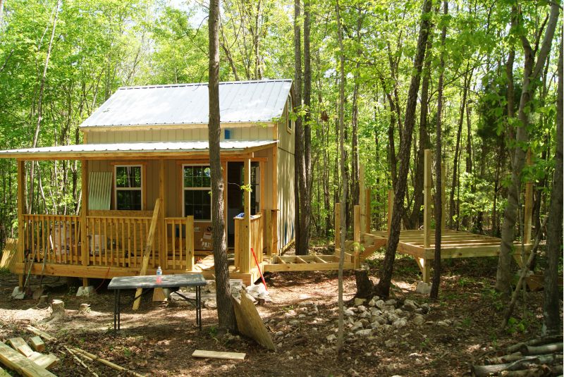

| ![Grillin' deck 8X10' Grillin' deck 8X10'](https://www.small-cabin.com/forum/shared_files/uploaded/4348/67271_4.jpg) Grillin' deck 8X10'

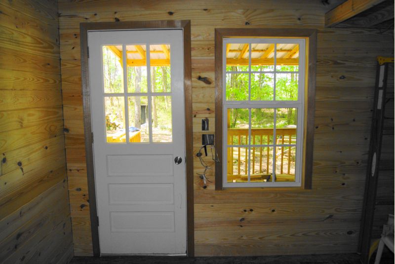

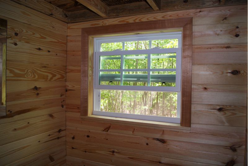

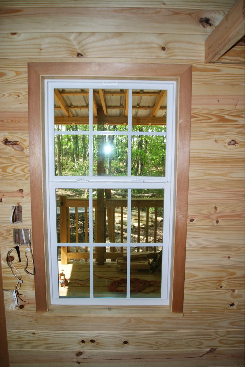

more...![DSC04172.JPG DSC04172.JPG](https://www.small-cabin.com/forum/shared_files/uploaded/4348/67272_1.jpg) DSC04172.JPG
| ![Inside window trim Inside window trim](https://www.small-cabin.com/forum/shared_files/uploaded/4348/67272_2.jpg) Inside window trim

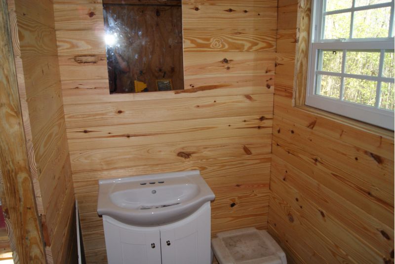

| ![Bathroom window Bathroom window](https://www.small-cabin.com/forum/shared_files/uploaded/4348/67272_3.jpg) Bathroom window
| ![DSC04175.JPG DSC04175.JPG](https://www.small-cabin.com/forum/shared_files/uploaded/4348/67272_4.jpg) DSC04175.JPG

Love the grilling deck idea! Place is really coming along.
keljohnso
# Posted: 8 May 2014 20:40
Thanks! Yeah the deck will keep us out of the mud. It'll have railings on it also so our 2 dogs can stay contained.

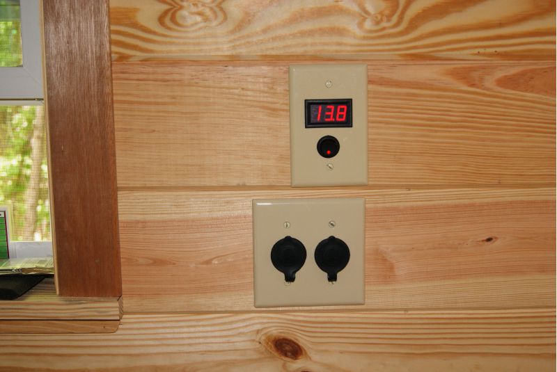

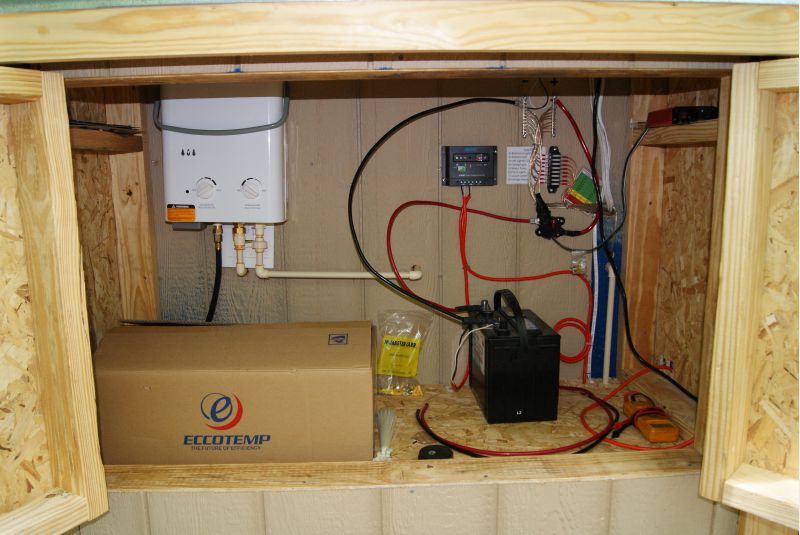

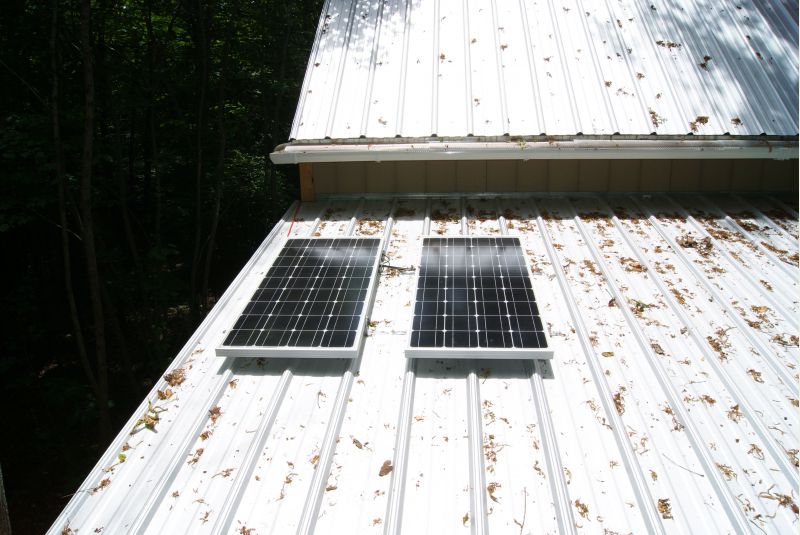

More...![Solar Solar](https://www.small-cabin.com/forum/shared_files/uploaded/4348/68129_1.jpg) Solar
| ![DSC04191.JPG DSC04191.JPG](https://www.small-cabin.com/forum/shared_files/uploaded/4348/68129_2.jpg) DSC04191.JPG
| ![DSC04194.JPG DSC04194.JPG](https://www.small-cabin.com/forum/shared_files/uploaded/4348/68129_3.jpg) DSC04194.JPG
| ![DSC04197.JPG DSC04197.JPG](https://www.small-cabin.com/forum/shared_files/uploaded/4348/68129_4.jpg) DSC04197.JPG

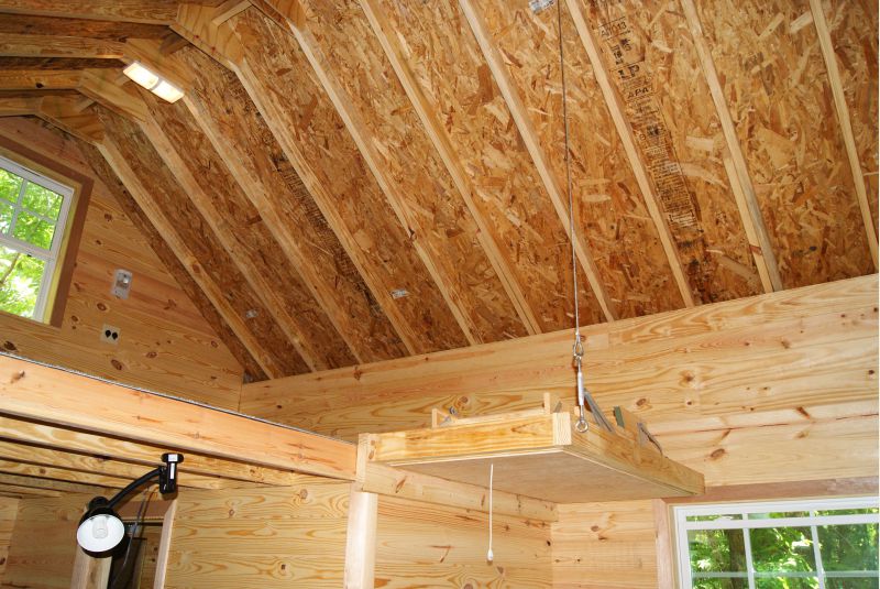

keljohnso
# Posted: 1 Jun 2014 21:01

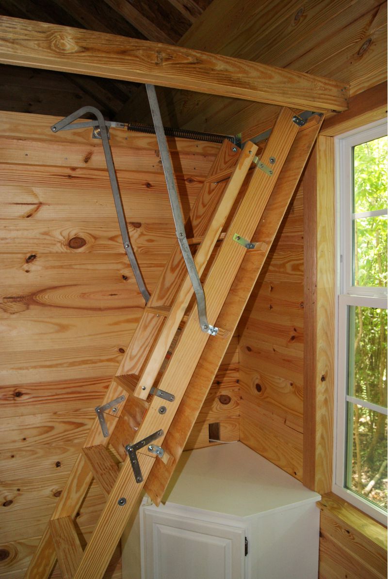

Attic ladder cable
MI drew
# Posted: 1 Jun 2014 21:14
Too funny. Renogy and Ecotemp. Same setup I'm going with. How do you like both? I just saw they came out with 150w panels last week. I will be placing my order soon. Also, how are you venting the how water heater? I see that is the outdoor model.
Looks like your coming along great!
keljohnso
# Posted: 1 Jun 2014 21:38
The solar is great! I didn't have water yet to test the water heater. I'm not sure how hot it gets, but I'm going to cut vents in both sides of the utility box. I may have to put metal on the cieling or a vent of some sort, we'll see...

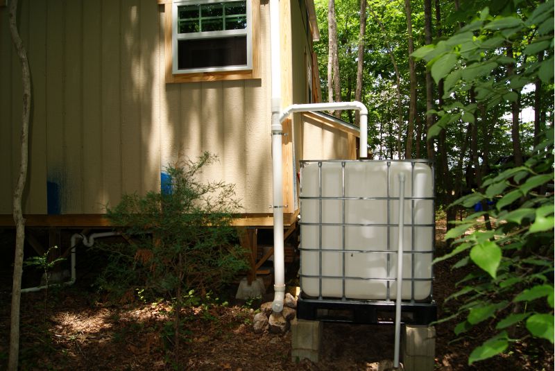

It has been a while since I posted. I like your water tank and capture flush system. The only problem I see is your water tank needs to be painted black or enclosed. The opaque finish you have will allow a variety of unwanted growth inside your tank. I could be wrong, but I have seen similar advice posted here before. You have a great camp going on, and appear very well thought out especially the grilling deck and outside kitchen.
