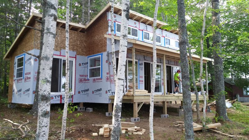

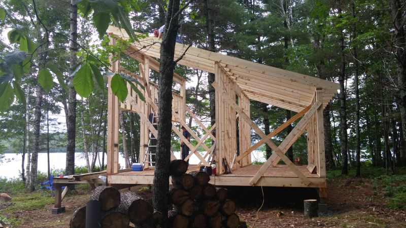

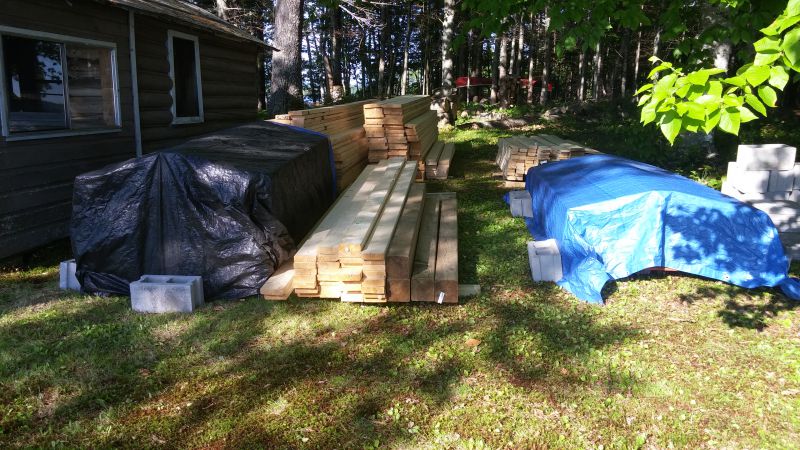

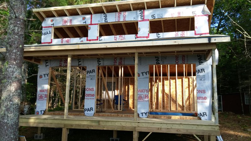

So, I got my lap top fixed and am able to upload pix now. DAY 1 June 25th and by 4pm we had the whole floor 20x24 and front deck 6x24 framed in. DAY 2 June 26 Sheathed the floor, Got front wall (24w x 14h), middle load bearing wall and rear wall framed and stood up  DAY 3 June 27 At this point the decision was made to add a third bedroom, a 10x12 master on the side of the 24x20, roof framed, sheathed and papered, and back wall sheathed. June 28 Off DAY 4 June 29 Sheathed in all outside walls and typar'd. DAY 5 June 30 Window and door install started. DAY 6 July 03 Window and door install completed and clean up...then it was beer time on the 7 mile boat trip down lake.   8 Pontoon boat and 8 aluminum boat trips of materials
|  End of day 2
|  End of day 4
|  End of day 6

Hey, "Metoo" If I were you I'd fill those concrete blocks up with something. Those things aint that strong all by themselves. Just thinking out loud here.

I am a little concerned with the concrete blocks and the way you have them turned on their sides. Like OutdoorFanatic said I would at least fill them up. Maybe using an engineered cookie would provide better support and last longer due to the winters(frost heave) we have in Maine.

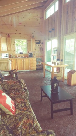

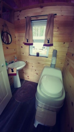

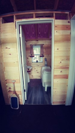

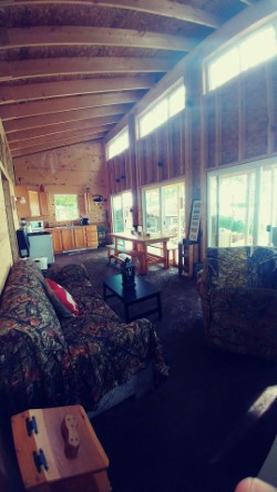

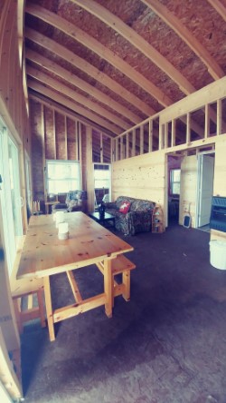

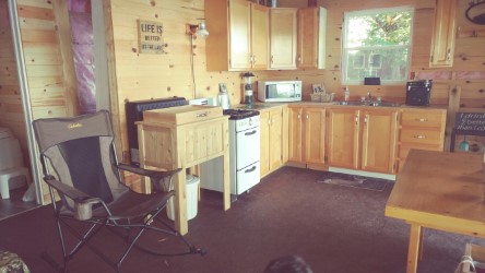

Haven't updated in a while...have been picking away at the inside when there is time. We close up usually labour day weekend and open up again in may. last summer i installed: a water tank, running tap water to bathroom and kitchen, hot water in kitchen, composting toilet, new dock, fire pit. The old log cabin is still standing...but may soon be gone. And by gone I mean drug across the lake and given new life...if all goes as planned. I have attached some pics. We have enjoyed some great family times and my youngest became engaged in August at the end of the new dock at the lake and island she loves. camp1.jpg

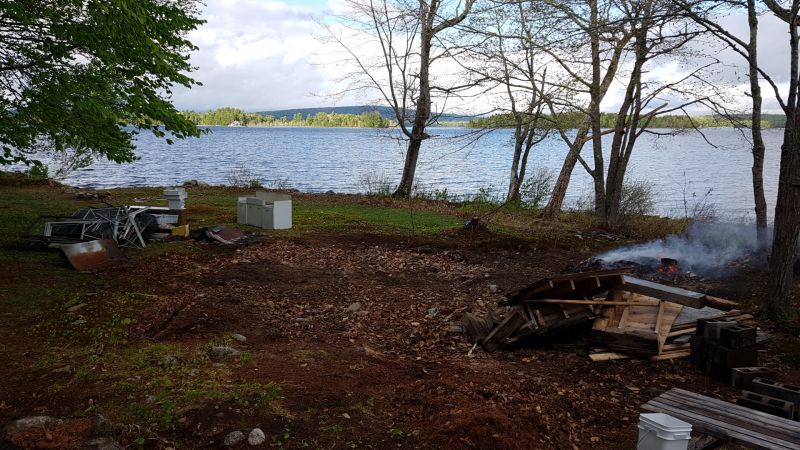

# Posted: 28 May 2018 10:57pm

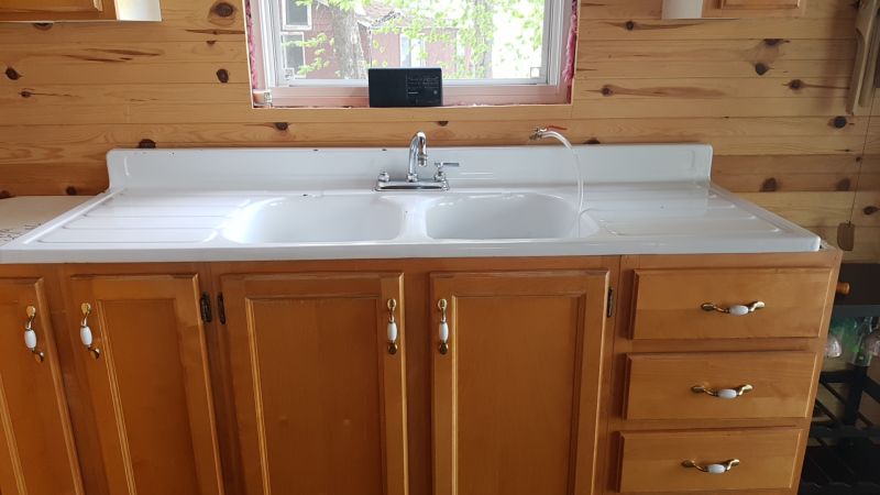

A couple of updated photos Old porcelain sink from old camp
|  The old camp is no more
