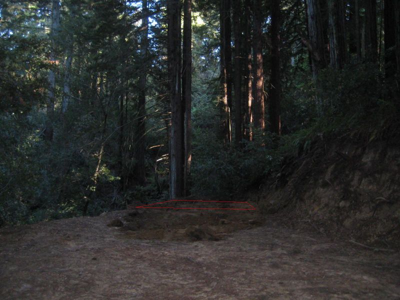

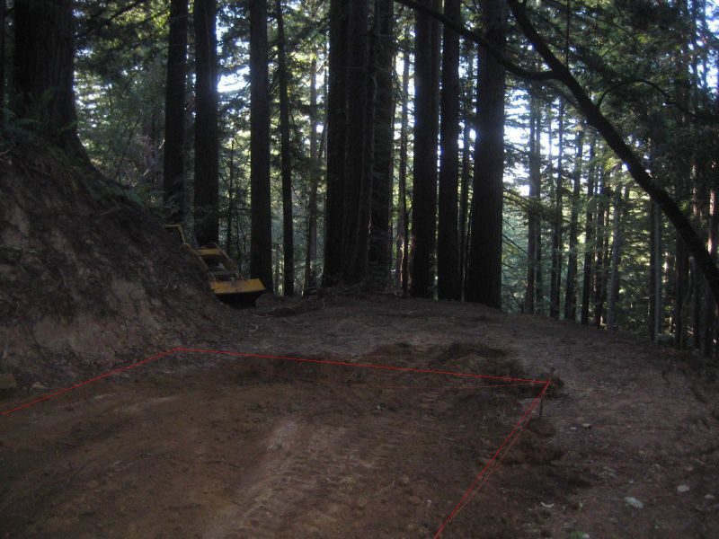

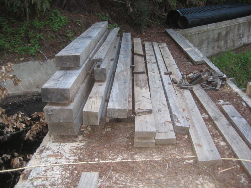

Hi everyone, first post. I've finally notched out a spot on my steep little chunk paradise. I'd like opinions on how to proceed. Cabin with toilet and electricity. Here are photos showing a 12x24 rectangle. The ground is good solid rocky, no clay. Never freezes, no snow. How close can I get to the hillside? What foundation would you use, pier blocks OK? I have access to a lot of leftover doug fir beams and large size lumber, at least 5 times what is in the photo, how can I best use these? Pole barn style? I also have lots of redwood trees and a small mill saw (Lumbersmith) and can use redwood for siding etc.. Which way should I slope the ground for runoff? I could dig a ditch along the base of the hillside, or I could slope the ground toward the downhill side.

I would be more worried about the back wall coming down on me than the front wall giving out . perhaps build a retaining wall behind the cabin sight first then decide on the shape and size of the cabin .I built a small cabin on a steep slop that was constantly moving . I built the back retaining wall first from 4 large cedar logs . then built the cabin on blocks so I could adjust it if and when it moved [every year] . I also would overbuild the floor as it will tend to twist when the blocks move . I did build close to the edge but continued the build down a few steps with another retaining wall and a deck. I will look for a pic . I managed the water with a French drain made with big o and some stone just below the retaining wall with the sight sloping back to it .
# Posted: 3 May 2014 18:29 - Edited by: paulz
Thanks for the reply. Yes the hill is a concern. I've dug back about as far as I can into the roots of those 150 ft. redwoods, I think if the hill slid they'd be coming with it! How far from your retaining wall to the cabin? I'm thinking 3ft. would be the absolute minimum.
So you sloped the ground back towards the wall? I'm thinking that's a good idea, otherwise the water has to run under the cabin to flow out the downhill side.

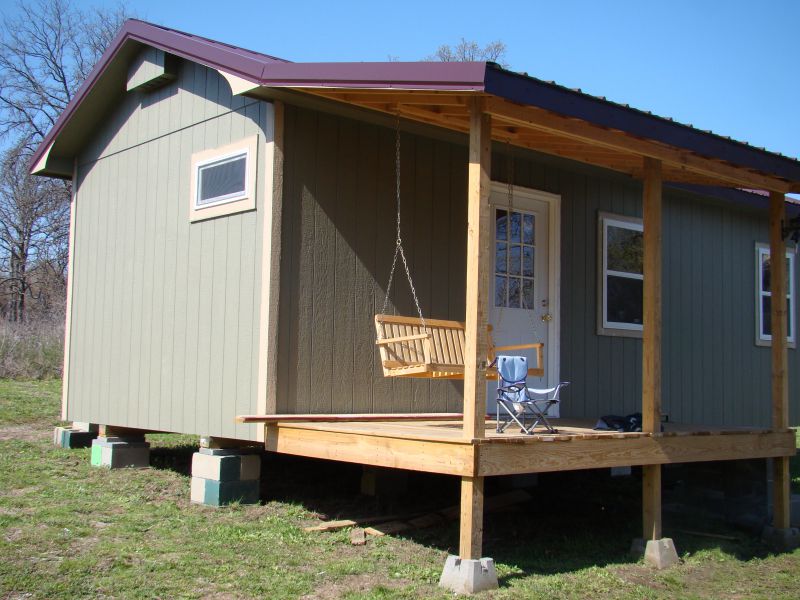

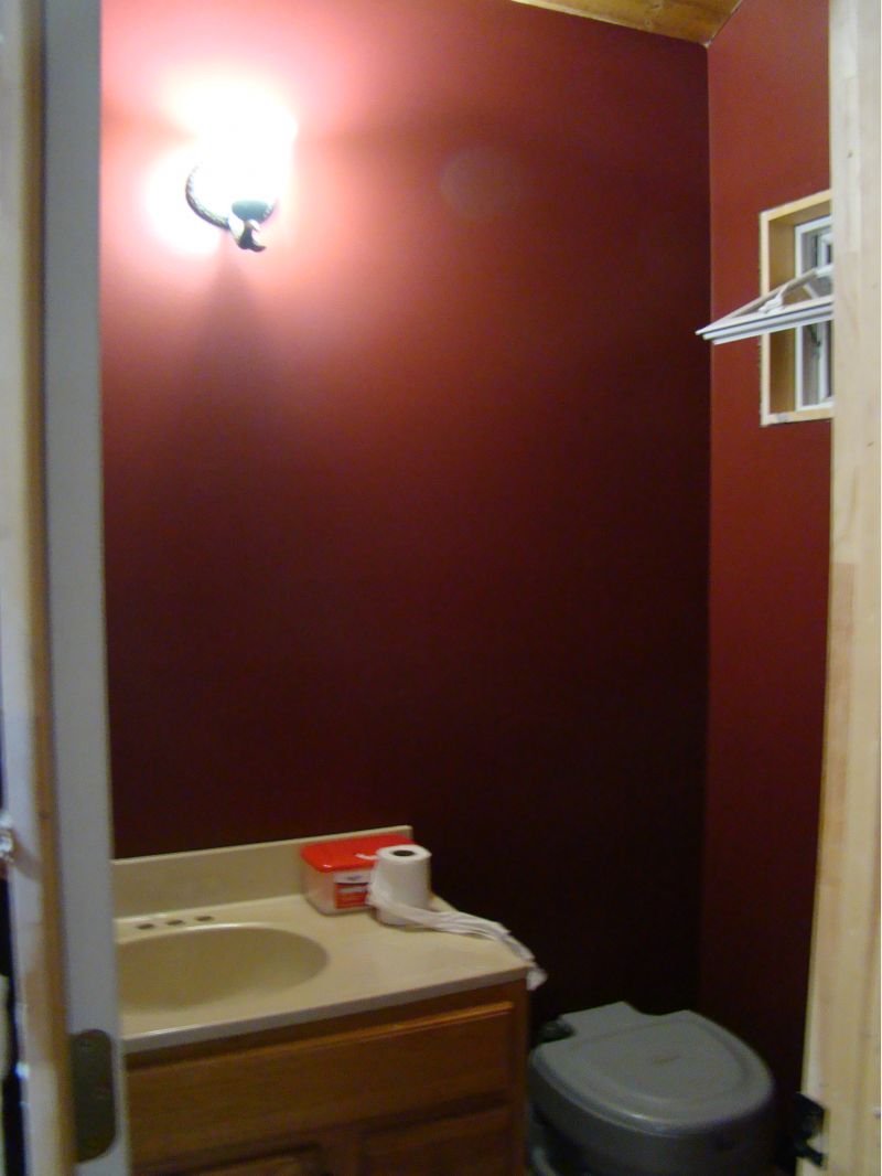

Thoughts for wanting windows higher on sidewall. we used a small awning type window in our bathroom for venting and keeping privacy. It looks good while letting in light and good air flow. these were the only pics I could find that showed it, you can see a most of it in the inside bath pic. I would say the bottom of the window is about 68" high but you can set where you like. It was about eye level for me

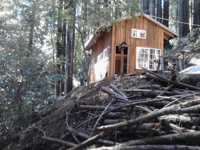

So my cabin is up, going to spend our first night in it hopefully this weekend. Still staring at wall studs but got a hidabed, wood stove and table, fully furnished!

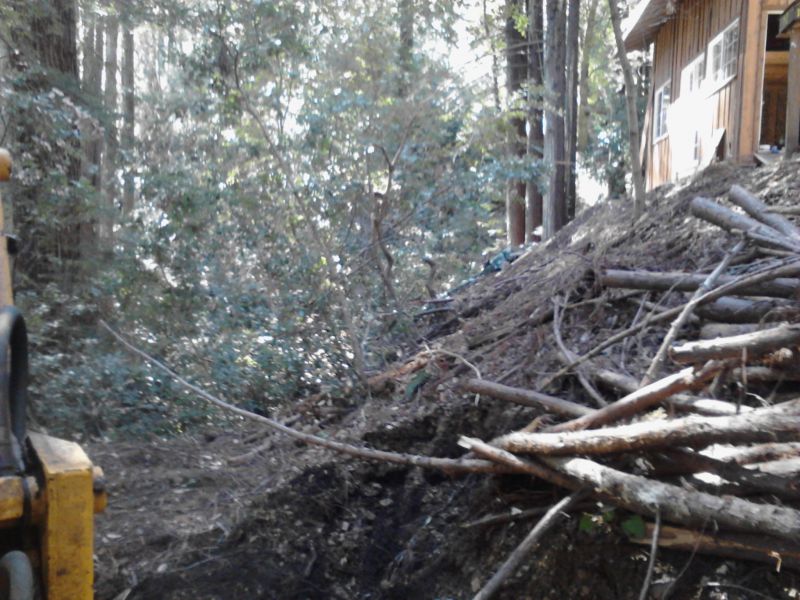

I've cut another notch in the hillside below (lower left corner of second photo) and I have a 20' storage container. My plan is to put it here and run some beams out to the roof from the cabin parking area to make a deck.
Any strategies on doing this? Should I fill the area between the wall and hillside with rock or something, or leave it open? It would be nice to cut more off the hillside to make the flat area wider where the container will sit. What about underneath? I have had it sitting on dirt for two years, should I put it up on blocks?![0415151054a.jpg 0415151054a.jpg](https://www.small-cabin.com/forum/shared_files/uploaded/4532/81144_1.jpg) 0415151054a.jpg

# Posted: 15 Apr 2015 22:53
If I understand what you're describing, you'll have a triangle shaped cross section underneath the deck (which is supported on the roof of the storage container).
Depending on how wide / tall the space is, you might be able to use the space to install a root cellar.
# Posted: 15 Apr 2015 23:29
Yes that's right, either I have the triangle space or I notch the hillside to almost vertical, shove the container as close as possible to the hillside and fill it in the rest of the way with rock or something. The latter would have the benefit of the container acting as a retaining wall of sorts, and also I wouldn't need to span the gap from the ground to the roof of the container with beams. The down side would be rotting the side wall of the container I guess, unless it could be protected somehow. Thanks for the feedback.
