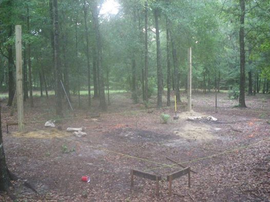

I've been a lurking for a spell. I have loved looking at the great cabins on here. I do not consider myself as having great carpentry skills but things are coming together. I chose to do something a bit different with my cabin. I purchased a pole barn kit with the intention of splitting it in half with two rooms. Once I got the kit up I realized I wanted more room. I ended up with a total foot print of 20x 48. I wanted a front porch so I built one 10x20. As you walk into the cabin/barn the first room is 20x20. This will be my cabin/showroom. The second room is 20x18. This is my shop area where I do my taxidermy work. I have been working on it for 4 years so far. It is located a 100 yards from the house so I get to work on it regularly. I would love to hear if anyone else has taken this approach. I'll try to attach some photos of my progress so far.
South360
# Posted: 3 Jul 2014 05:21pm
Getting ready

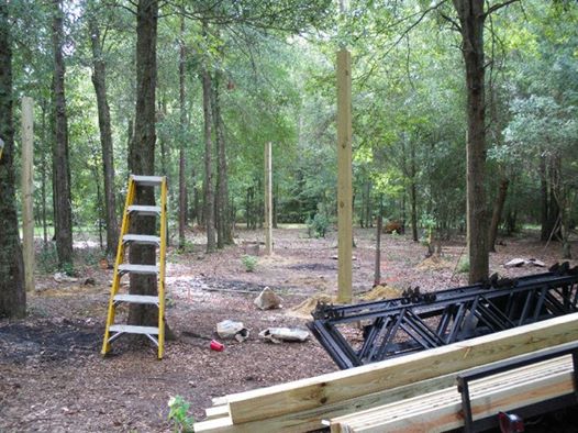

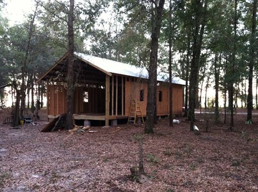

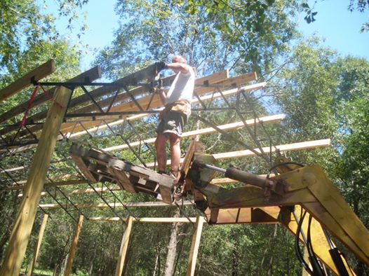

# Posted: 3 Jul 2014 05:26pm

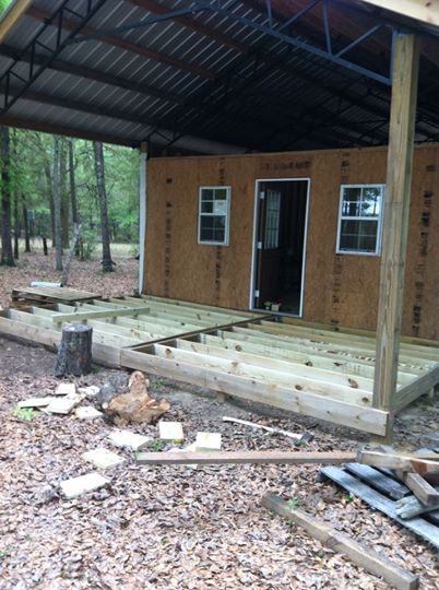

This probably a years worth of work. This was a bit scary
|  Taking shape
|  Working on the walls
|  The back side

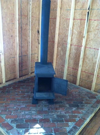

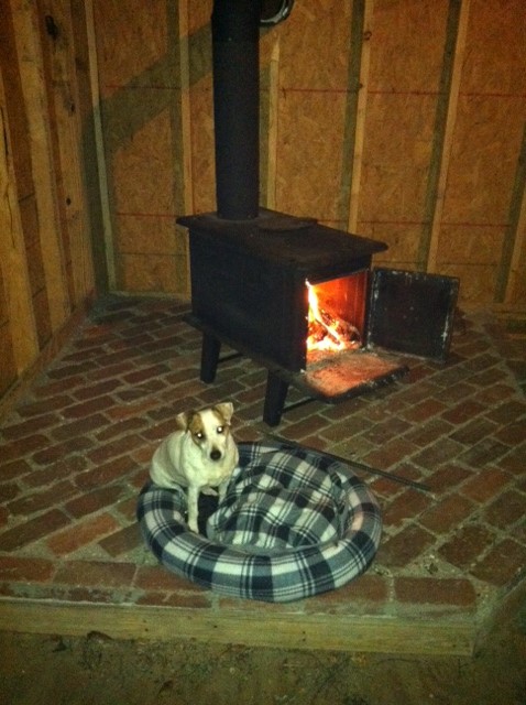

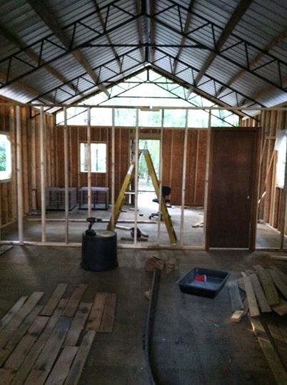

Another year worth of work The back side has a wall
|  A free stove
|  100 year old bricks from the farm

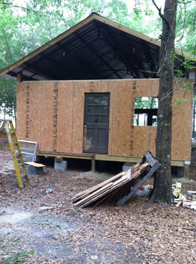

# Posted: 3 Jul 2014 05:31pm

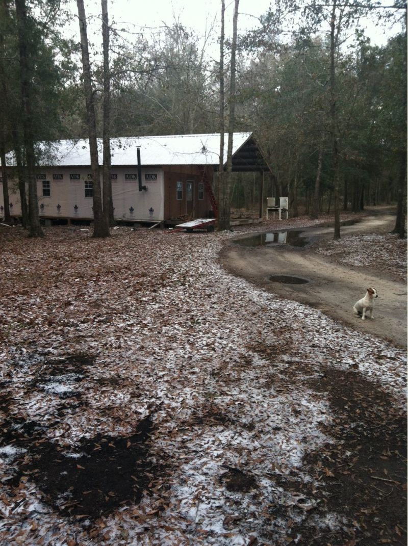

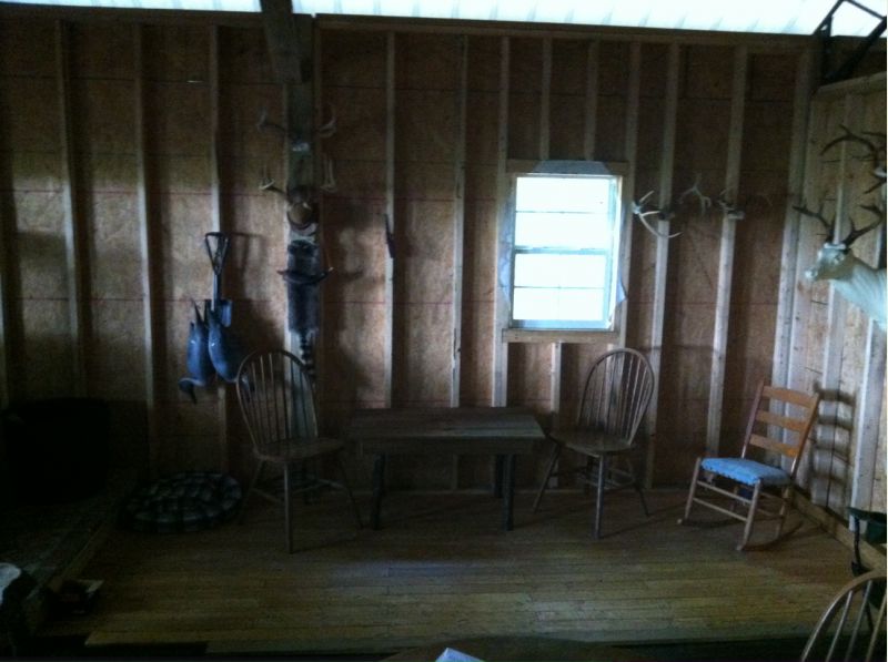

I have done all of the work myself so far. I find it hard to find time to work on it and the cost of materials slow me down a good bit. Working on the inside
|  The North side
|  First snow in 10 years

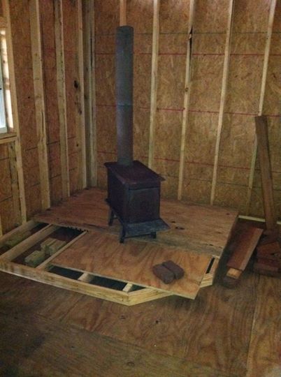

|  Finally got to build a fire
South360
# Posted: 3 Jul 2014 05:35pm

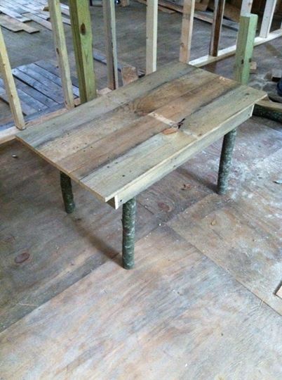

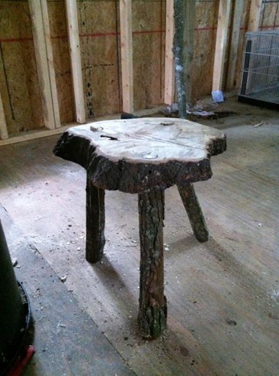

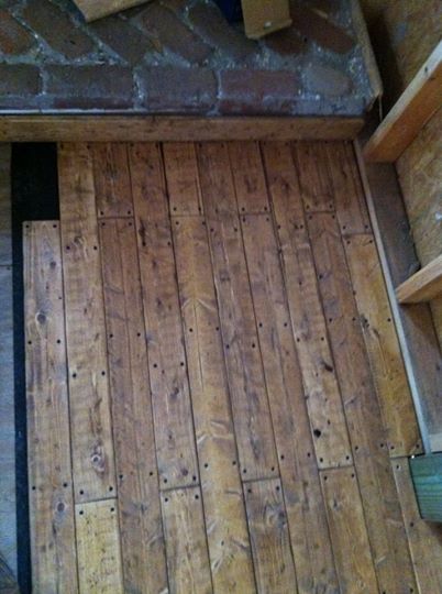

I was very excited when I finally got the stove hooked up so I could sit by it. The family has enjoyed going out to it just to hang out. For the flooring I used cheap furing strips. I just stained them and butted them up against each other. If it shrinks a bit, Oh well. A little table I made
|  A stool to sit on while putting wood in the stove
|  The family
|  My flooring

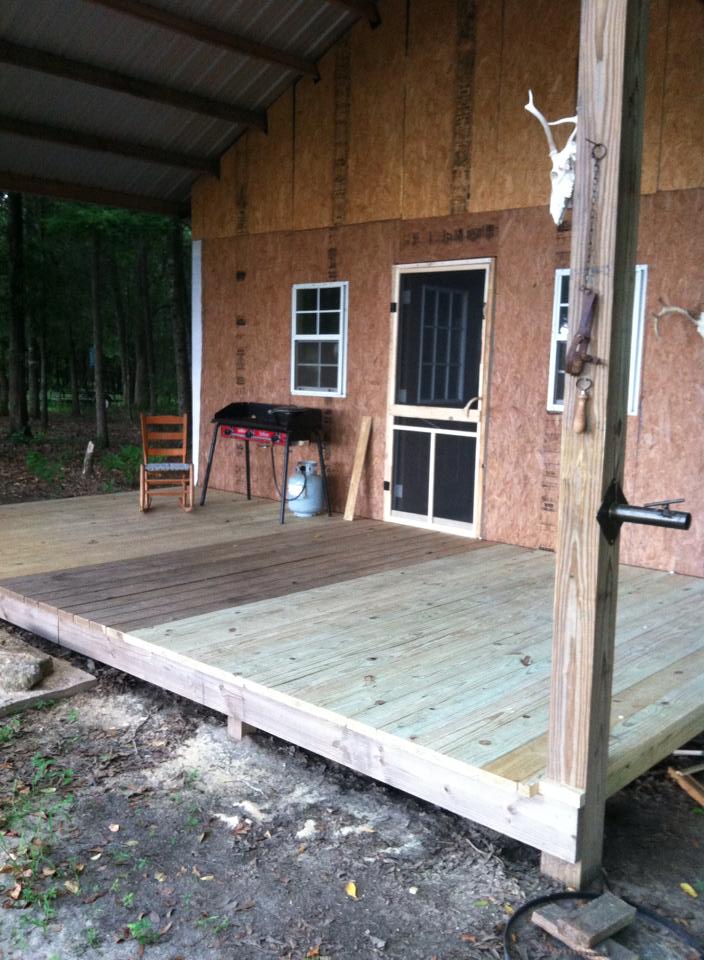

# Posted: 12 Jul 2014 08:58am

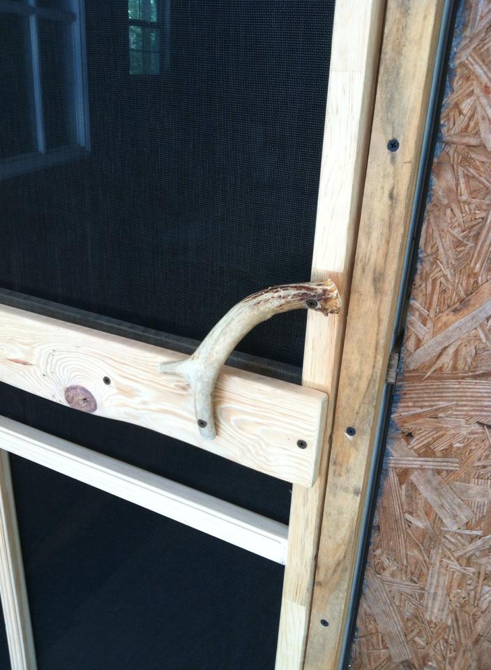

I have a three tone porch since I did it in three stages. By spring it will all be the same color. Installed screen door with antler handle
South360
# Posted: 12 Jul 2014 01:30pm
I gave the wrong porch size on a previous post 10x20 porch made of treated 2x6

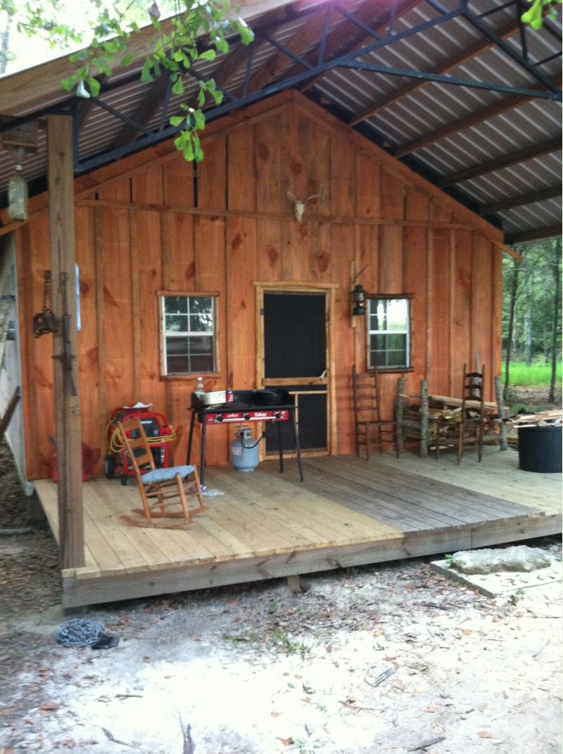

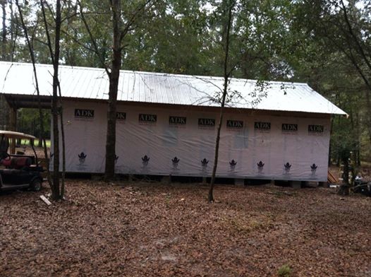

# Posted: 26 Jul 2014 09:12am

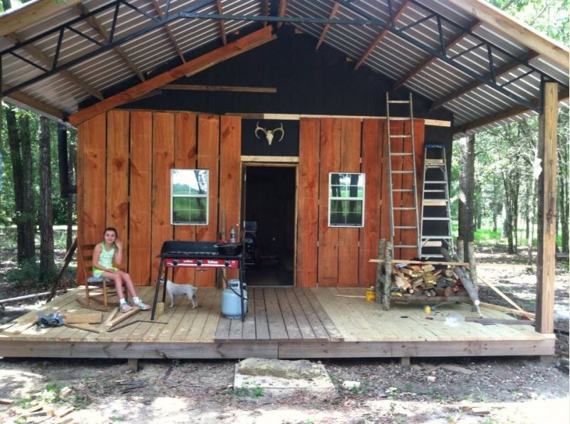

Putting up 13" board and batten. I bought this from a local guy who runs a small saw mill.

# Posted: 4 Aug 2014 02:24pm
I've got most of my board and batten up. I used sweet gum that I ripped on my table saw to place around the windows and doors. I shouldn't have to worry about rot because it shouldn't get wet. I picked up the old Coleman lantern for 12 bucks. I'll be converting this to electric and it will be my porch light. I picked up 4 ladder back chairs at the flea market for 10 apiece which was a steal. I've made a firewood holder out of logs by using my tenon cutter. As soon as the weather cools off some, I will work on the inside.
