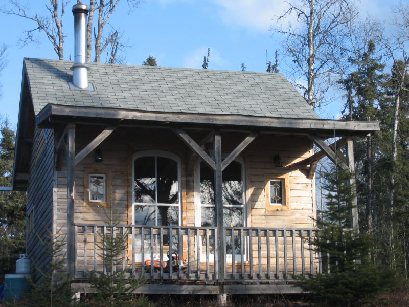

I just came across this website and I thought that I'd share some pictures of a 16' x 16' post and beam cabin that I built over the last decade.
Since access to the property was very difficult (6km from the logging road), I used as much from the land as I could.
The cabin frame is comprised of 6"x6" and 6"x12" spruce posts and beams cut from the trees on the property using an Alaskan Saw Mill. All surfaces exposed to the elements are white cedar (the inside walls are white cedar also).
The biggest challenge with successfully completing this project was managing the tension between the limited time available to me (I only had so much vacation and I live 15 hours from the site) and staying true to the original design...I like to say that I made it 90% of the way there. Cabin Front
|  Cabin Back

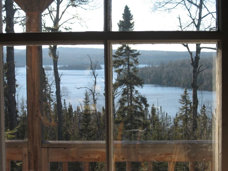

|  Lake View
|  The Frame

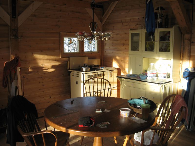

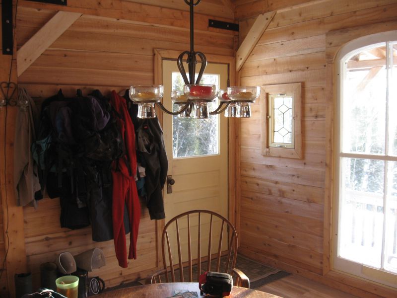

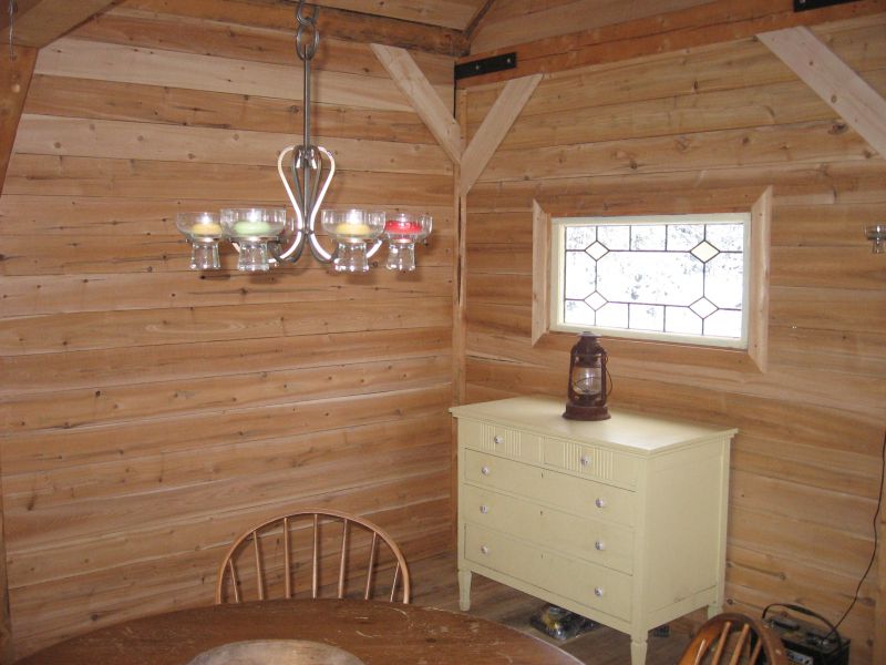

Here are some interior pictures. Gable wall looking sw
|  Stove looking nw
|  Kitchen looking ne
|  Entrance looking sw

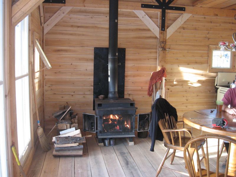

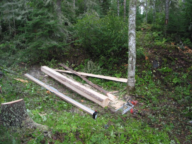

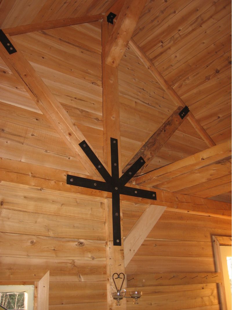

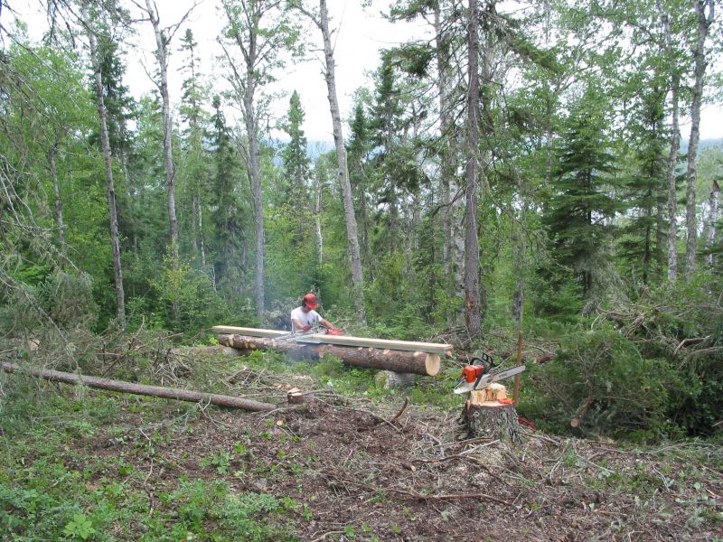

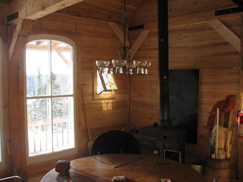

A couple more interior shots and the sawmill in action. Se corner
|  Wood Stove
|  Saw Mill
|  Main 6x12 beam

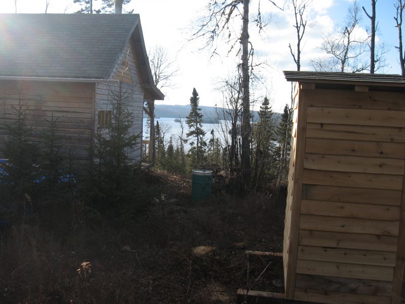

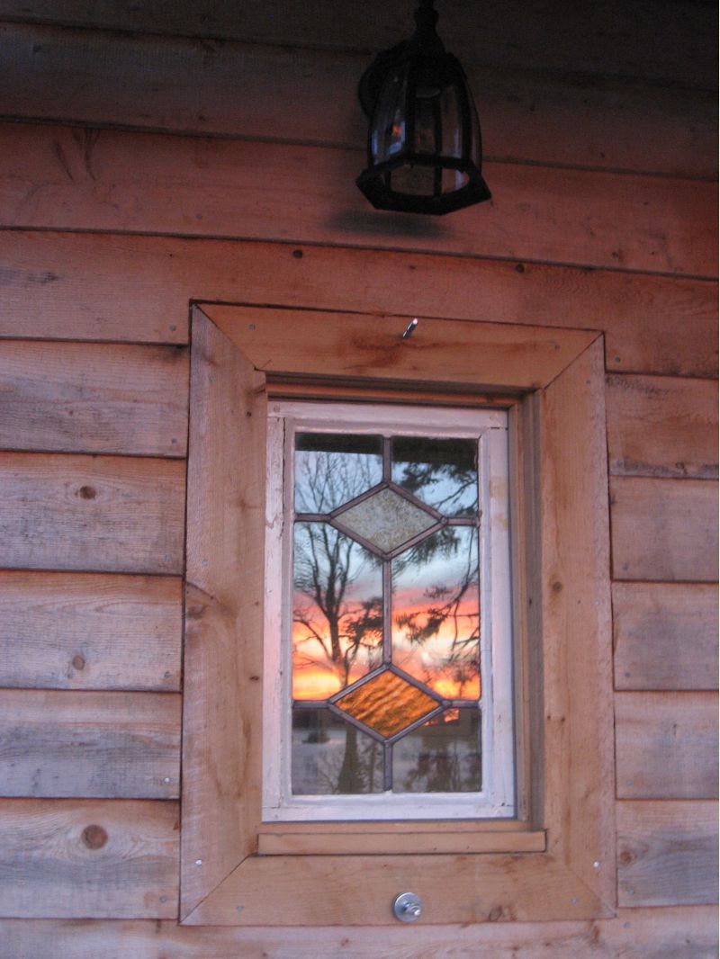

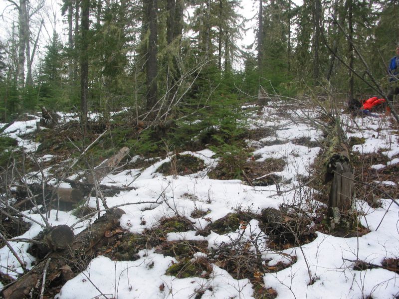

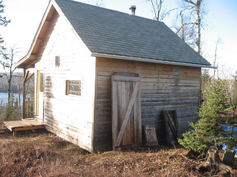

The site before clearing and a couple miscellaneous pictures. Outhouse and back of cabin looking wsw
|  Sunset in window
|  The site before clearing (orange hat at future door location)

Andrew: gorgeous. How did you finish the interior wood. It looks beautiful.
andrew
# Posted: 14 Aug 2014 06:19pm
Thank you.
The walls are unfinished white cedar cut with a band saw.

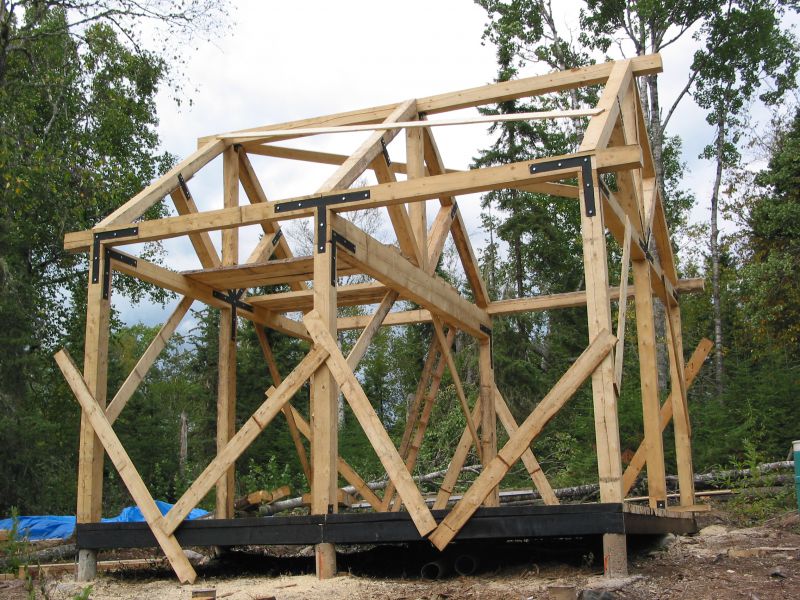

# Posted: 9 Sep 2014 10:19am

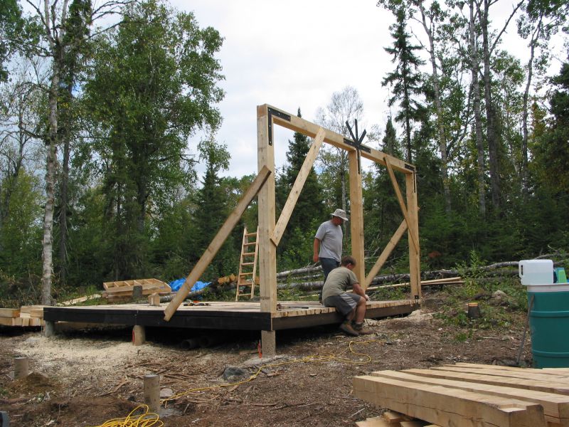

Another question about building in a relatively out-of-the-way location: I get the impression you had very little, if any, help during your build. How did you move your posts and beams into position without a crane?
(I'm considering using an electric winch, generator powered, with some sort of pully system.)

# Posted: 11 Sep 2014 11:47am

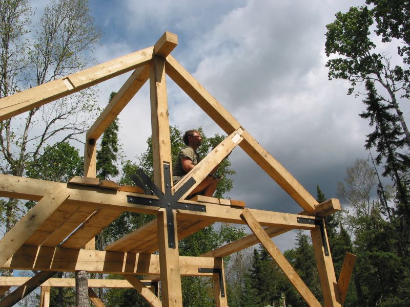

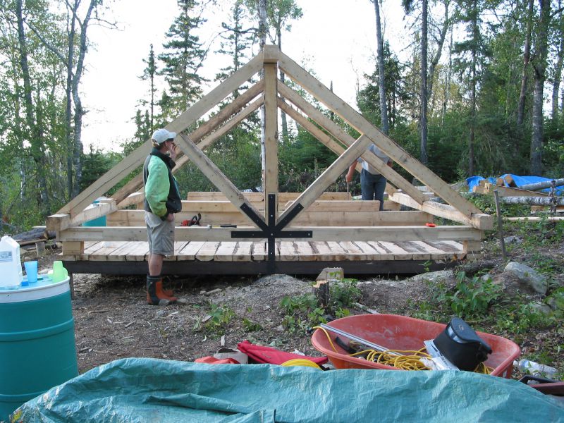

Since the posts and beams were made from 6"x6" spruce (main beam 6"x12"), they weren't very heavy. Each of the three "bents" were built on the cabin sub-floor and raised into place with three people (one person on each end to stabilize and push the bent upward and one person in the middle for pushing and gusseting); once in place the bents were secured with temporary gussets (see picture). The roof structure was dry-fitted on the cabin sub-floor (see picture) and then assembled piece-by-piece on top of the sill plates that ran perpendicular to the bents (see picture). South bent in place - held by temporary gusset
|  Roof frame pre-built on cabin sub-floor
|  Roof frame being placed on sill plates
duster
# Posted: 11 Sep 2014 01:13pm
Thanks Andrew - interesting and helpful. I hadn't thought of doing the assembly piece-by-piece but it may well be the way to go. (And thanks also to skootamatta. Nice to know that if I do decide to use block-and-tackle that it could work too)
