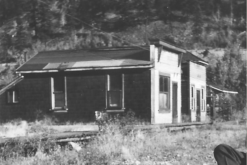

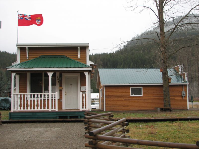

We purchased our cabin about 7 years ago to use as a cottage, but now we live in it full time. It has been moved 3 times over its life, but now is on a permanent foundation. It was built in 1912 and had two rooms. When we purchased, a room was added to the back where the wood shed was. It is the bedroom and bathroom now. We had also added a utility room and a passive solar greenhouse. Total sq. ft. of the main cabin is 550 sq. ft. Utility room is 250 sq. ft.
What he looked like in 1942 (in foreground)

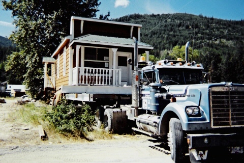

New shakes and roof and moving for the last time
All settled in and we built a garage too

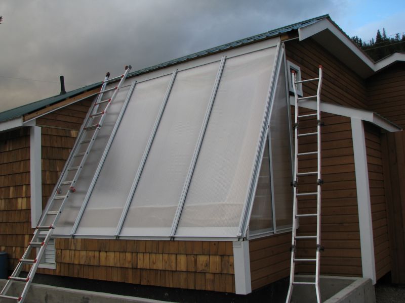

We added a greenhouse on the back

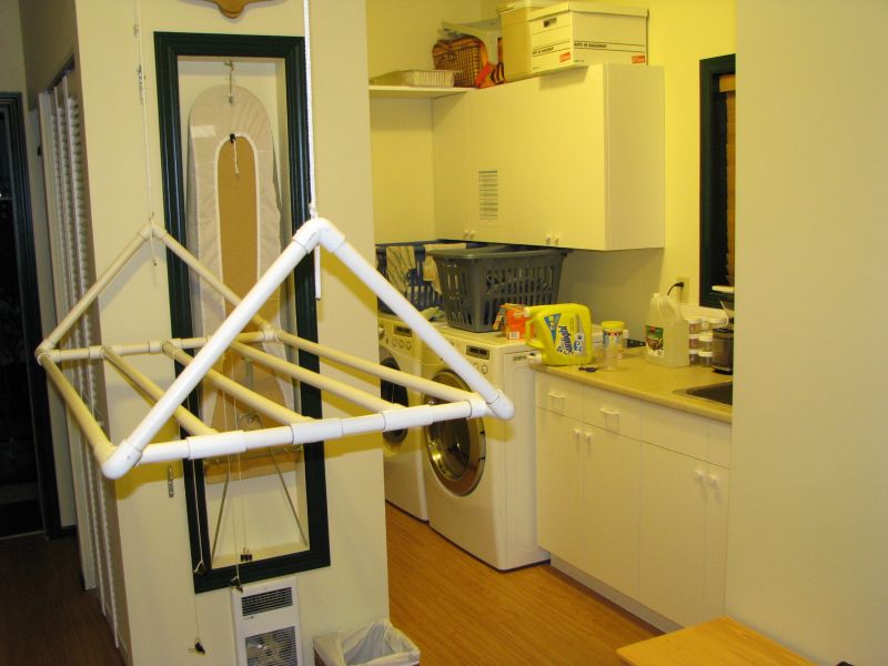

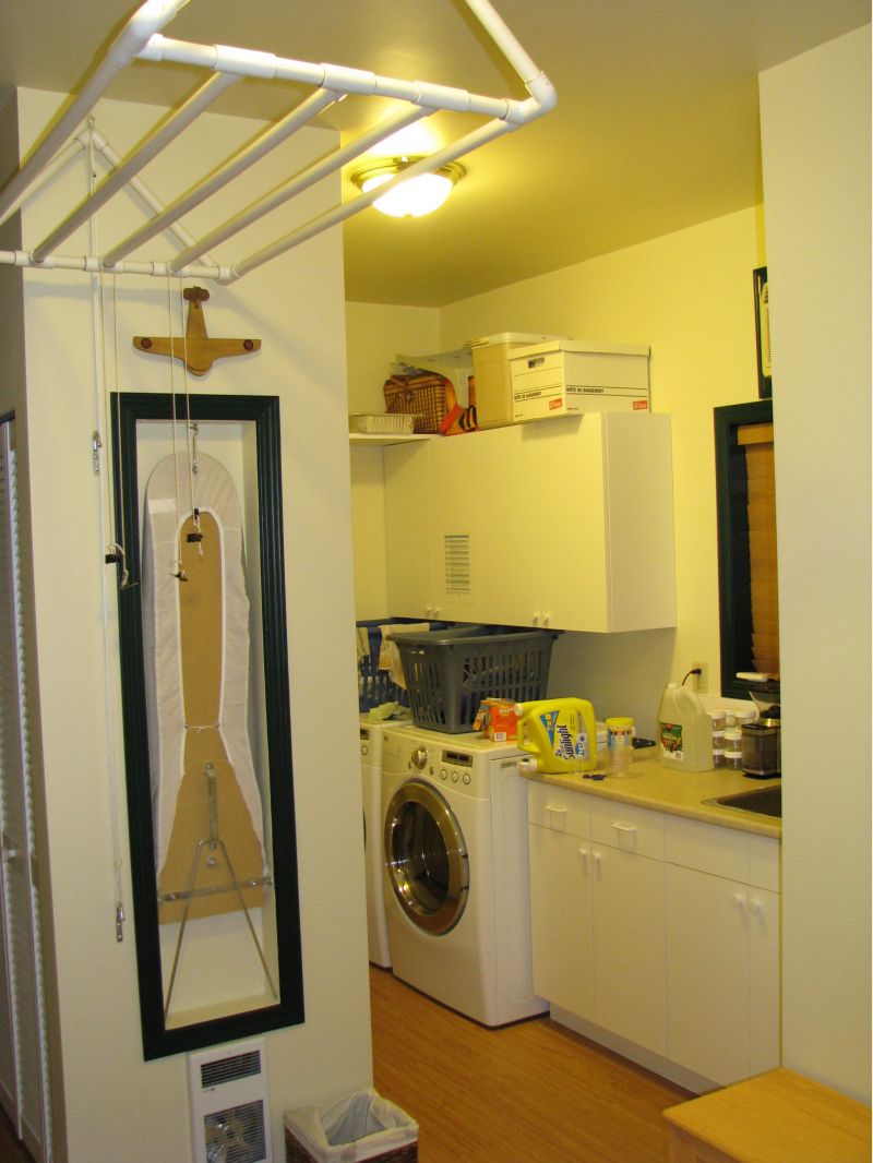

The utility room is for our clothes closets, pantry, and laundry room. We have a fold down ironing board and a clothes drying rack above which can be raised and lowered. The heater near the floor was installed upside down (on purpose) so that the hot air would blow up toward the drying clothes.

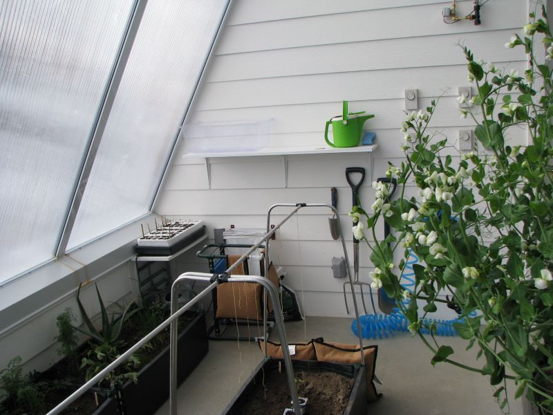

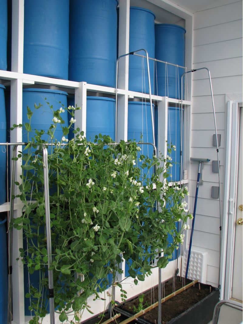

The greenhouse has passive solar heating. The blue barrels are filled with water. The sun heats up the water and at night the heat from the barrels warms the room. We have a backup heater but have only used it twice when it went to -30. We pick tomatoes until December. The windows are angled so that in the summer the barrels are in the shade and in the winter, receive full sun.
Utility Room
Utility Room
Drying rack lowered
Drying rack lowered
Passive solar heating in greenhouse
Greenhouse from another angle

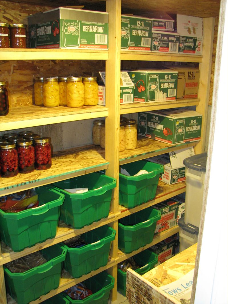

A cold cellar (about the size of a closet) is below the greenhouse. We use it to store preserves, dog food, flour, sugar, etc.

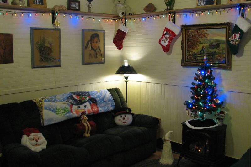

The living room photo shows an electric fireplace. I would like to have a small wood stove for backup heat in case the power goes out.

Cold Cellar
Cold Cellar
Inside living room at Christmas

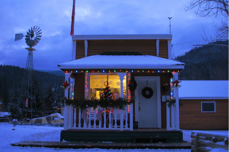

Outside at Christmas

Is that 15 30gal water barrels?
# Posted: 9 Jun 2010 03:39pm
Hi MikeOnBike: We are using 18, 25 gallon (Canadian)/30 gallon (US) barrels. They were originally used for juice concentrate and we paid, I think, $15 each barrel. Hubby says that it would be better to use 45 gallon (Canadian)/55 gallon (US) barrels if you have the space (which we didn't). He said that the larger barrels will require more time to heat up, but will hold more heat that will be transferred to the room. The barrels are extremely heavy when filled, so you have to build a very strong support system for them. We put a little bit of bleach into each barrel to keep them from going skanky.

Is that peas growing in front of the barrels?

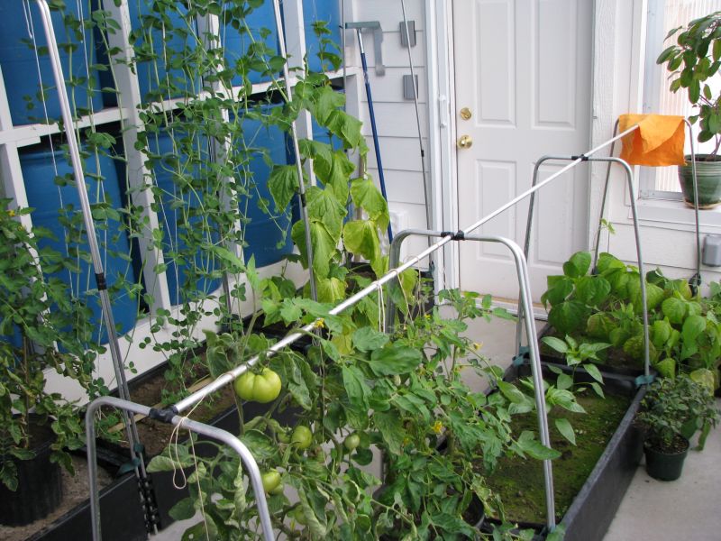

Yup, those are peas. We also grow tomatoes, carrots, peppers (really hard to grow because the aphids love 'em), lettuce, beans, cucumbers and mint (but always grow mint in a container or else it will take over the world - *S*).
More veggies
More veggies
