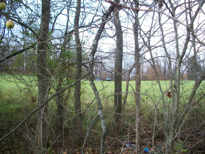

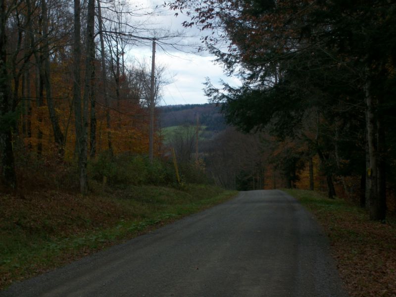

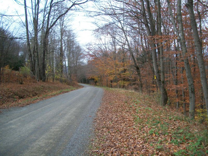

I had been looking for property on and off for 3 or 4 years and discovered land ain't cheap...especially if water is involved and I had to have some kind of water on it, had to, right?. Well I found that land ain't cheap even if water is not on it...unless it's an over-grown skeeter-infested unusable swamp on a unmaintained private road that had an association. (had enough of associations...forget about it) After many solitary (I may be lone wolf material) day trips I found a beautiful open, surrounded by trees on three sides, swampless parcel on a 4 season town maintained dirt road that I could use even if only for camping in my '74 Apache popup and bought it. OK, so I don't have an ocean or a lake or a river or even a SEASONAL stream but I have a really nice seven acres that was pasture until the 80's when a farm was subdivided...but I've found out I have ground water! Just 18" down I hit water digging post holes for fencing! Not the same I know and I wish I didn't find it but well as someone else said it is what it is. Please stay tuned because I'll be asking for some advice to put together my master plan.

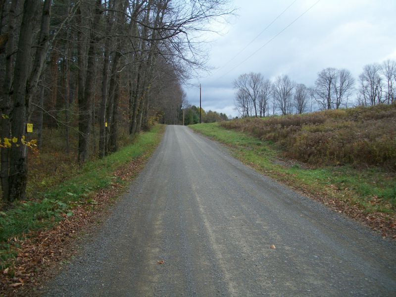

# Posted: 25 Aug 2014 04:49pm
Town maintained road
Water, but not mine it's neighbors across the street

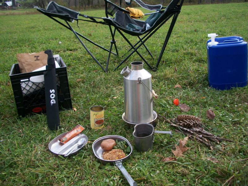

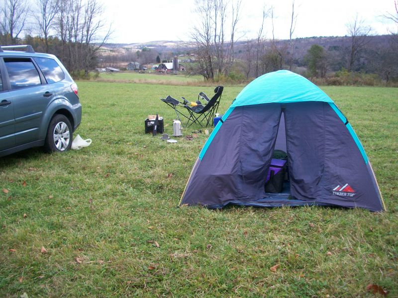

# Posted: 25 Aug 2014 04:52pm - Edited by: ChuckDynasty
Camping last fall. I didn't drag the Apache up until this summer.
Looking out from my campsite
Tested sleeping in car, temps in 30's worked out well.
Small amount of fuel to boil water in kettle and heat food.

Quoting: leonk
nice kettle, scary SOG
The kettle is great. This was my first use of it and it needed just a couple of pine cones and small sticks to boil water in just a few minutes. After the water boiled I put the mess kit over the coals to heat my meal. Highly recommend the kettle. I have several items to make water potable and this is one of them.
I don't have a firearm so I keep the SOG handy. Easy to backpack too.

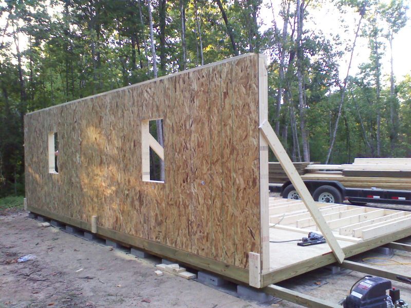

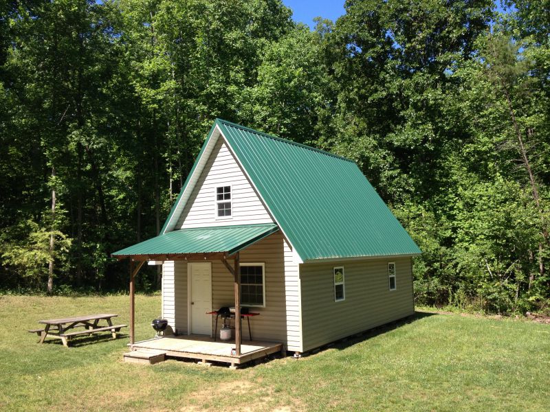

I used flat 4" cinder blocks under my cabin. Spaced very close. 4x4 runners are industry standard unless you plan to drag it 20 miles. Then you mite wanna tack horseshoes underneath. 8' wide=2 runners, 10' wide=3 runners, 12 wide=3 runners, 14-16 wide=4 runners. I prefer 2x6 floor joist on 16" centers. Wouldn't consider smaller. For sub flooring, I prefer Advantec. I painted the underside of mine with latex to add another layer of weather resistance. I always frame with 2x6. Live every day like it's your last, and build like you will live forever!!
Salty
Framing
Framing
Nearly finished
Nearly finished
