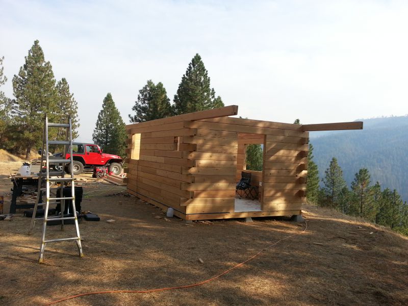

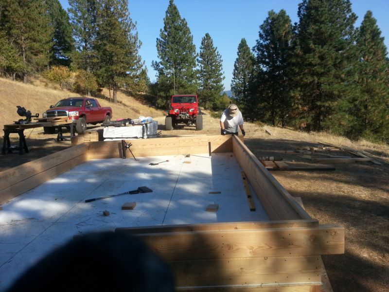

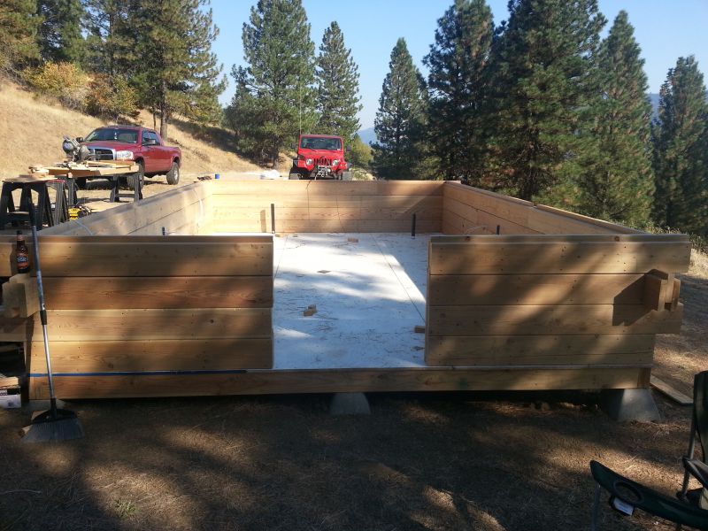

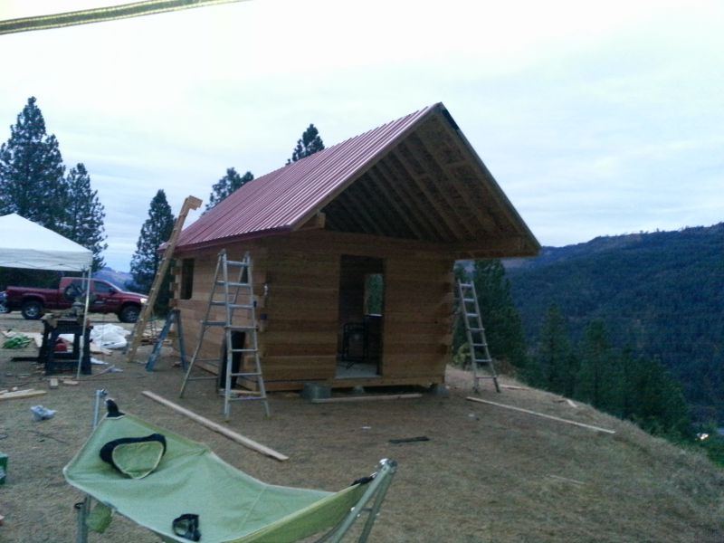

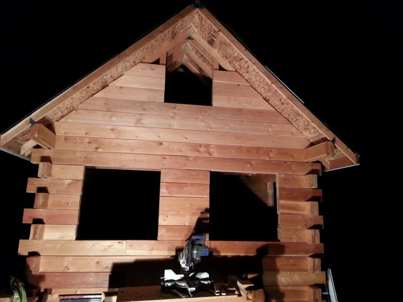

I wanted to put up some pics of last months progress....enjoy 20140913_162637.jpg

Very cool, butt & pass version of Stoney's easy build log cabin? Do you think your eaves overhang enough to keep water off the wall?
Osrik
# Posted: 2 Oct 2014 09:55am
Yep! Got his book a year or so back looked it over and decide to build this first before we took on a shop. Gutters will be in place but got some pretty good rain last week and seemed to keep most of the rain off, but could have went a little longer. Also miscalculated our rafters so a ridge pole is going in next few weeks to be safe. Its been a fun build and cost has been low and a learning experience. .
Nirky
# Posted: 2 Oct 2014 01:48pm
Low cost and high learning is a very good thing. What is the footprint size? Our grass is still green here in N. Idaho so you must be southern?
Osrik
# Posted: 2 Oct 2014 03:08pm
12x18 in clearwater probably south of you but not that much south we have been pretty dry but been getting a little rain last week.

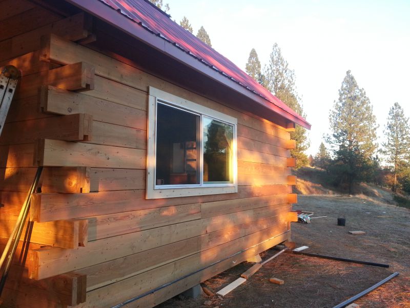

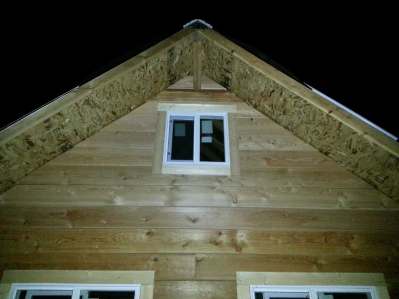

Got a little bit more done. dried in
|  window

Looks good. you gonna stain or paint the outside?
Osrik
# Posted: 23 Oct 2014 10:20pm
Think we are going to stain and I need to do it quick raining pretty good last frw days
