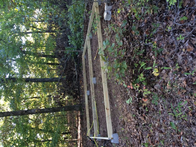

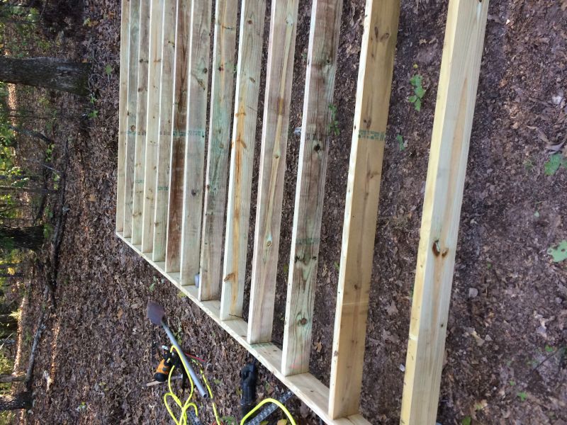

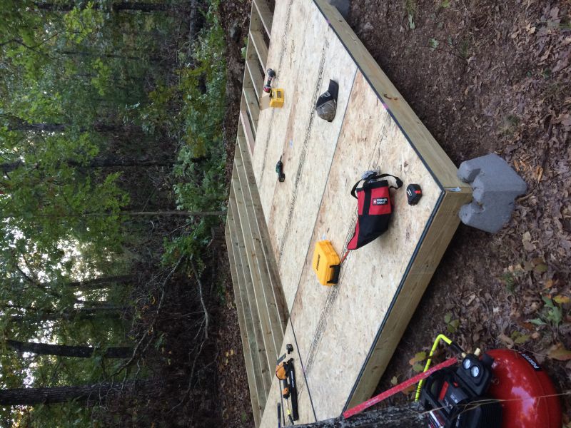

Well foundation is started and almost done. Will start the walls tomorrow morning.
Foundation
Foundation
Foundation
Foundation
Foundation decking
Foundation decking

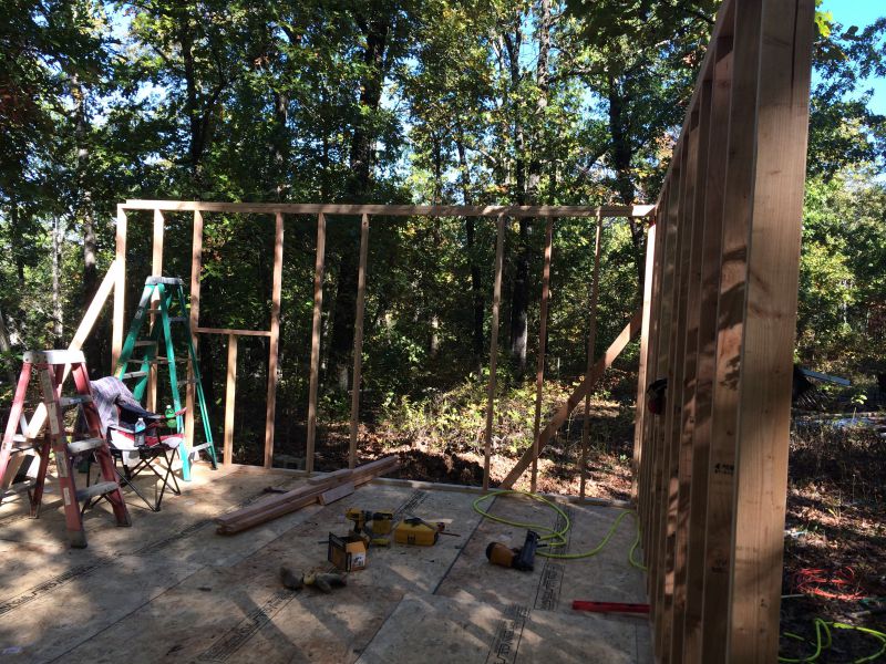

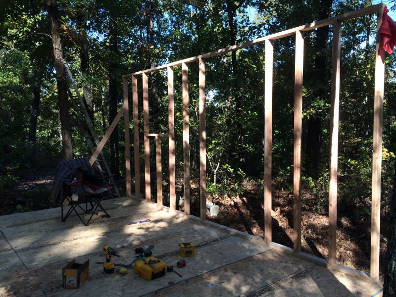

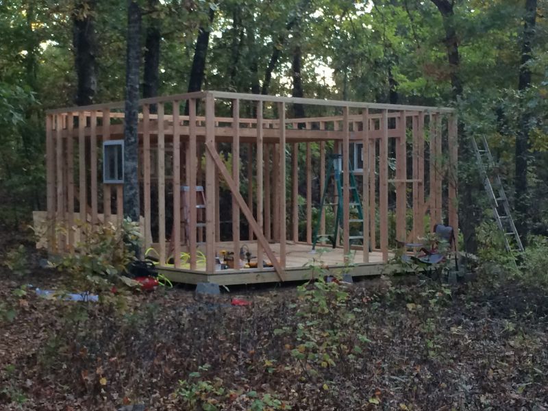

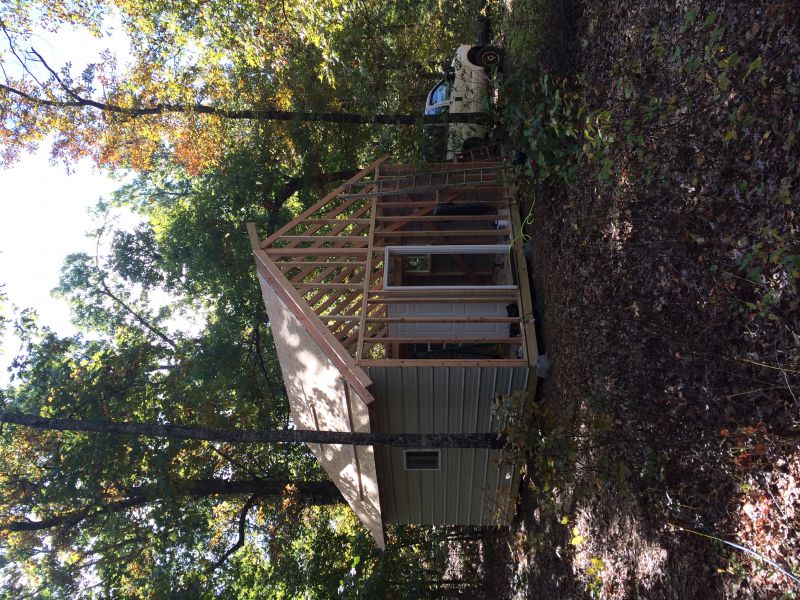

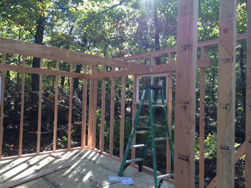

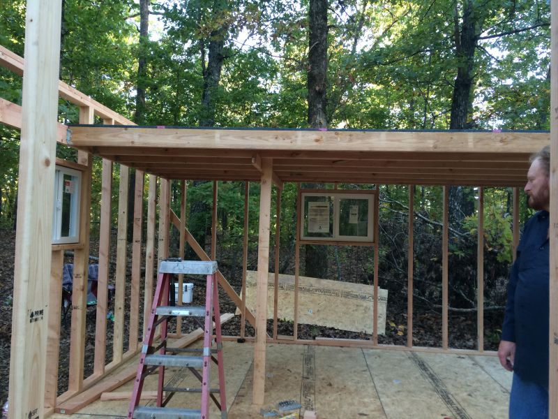

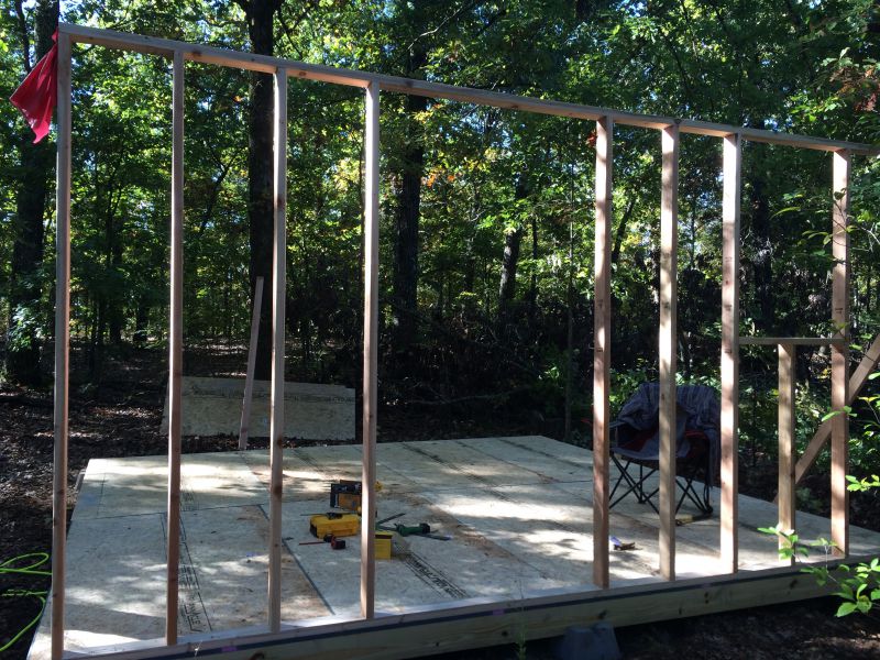

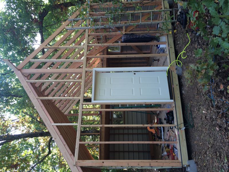

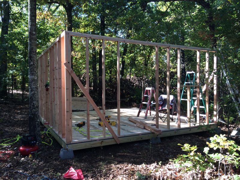

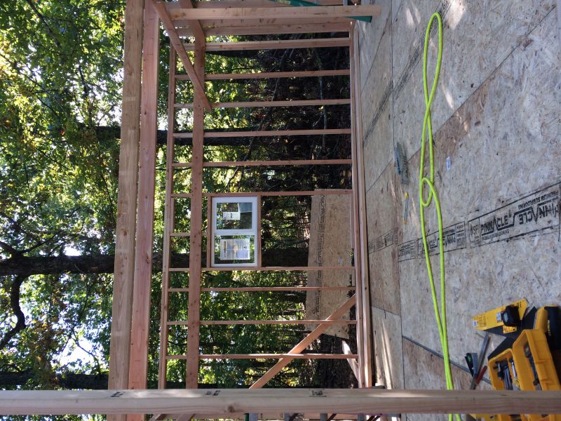

Got the walls up, windows in. Only a few minor issues one being the osb I got was not true 4x8 osb so had to make a few modifications.
Troutstudent
# Posted: 16 Oct 2014 09:30pm
Few more pictures

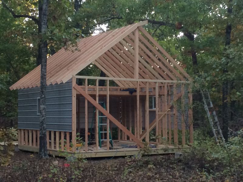

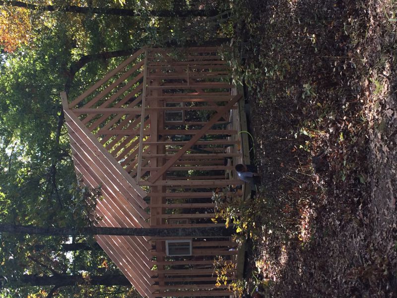

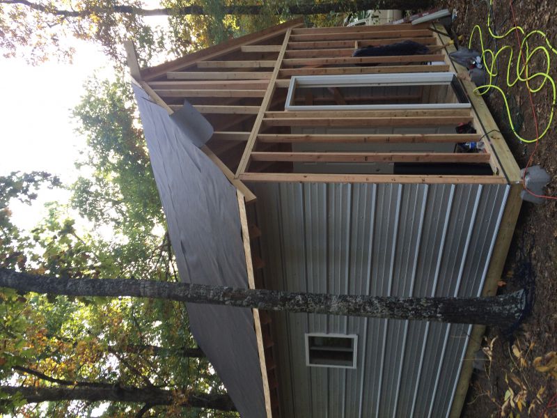

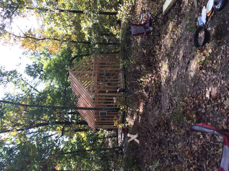

Few more pictures been slow going buddy thought we should do a steeper pitch for roof but he won't get up on it to help.

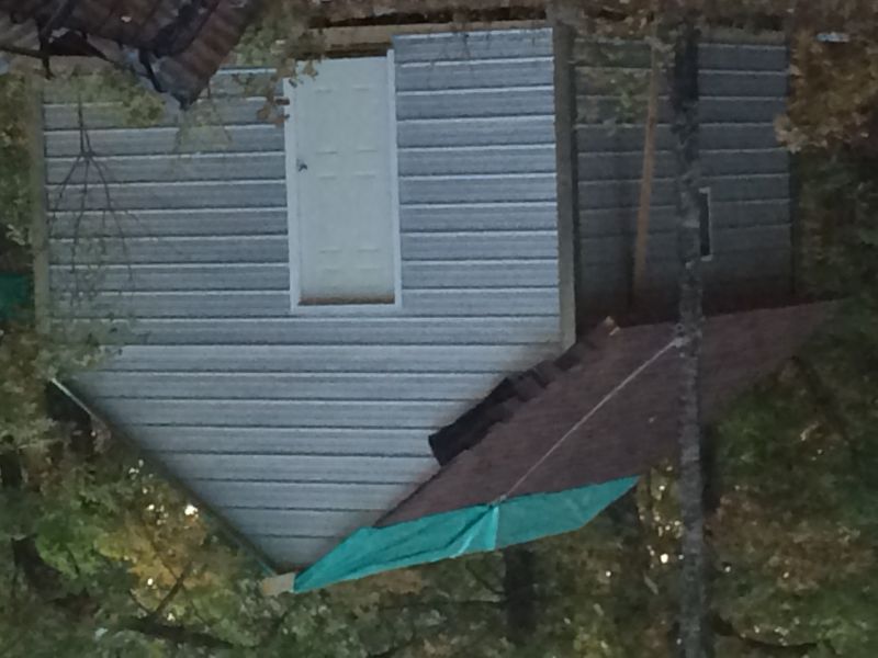

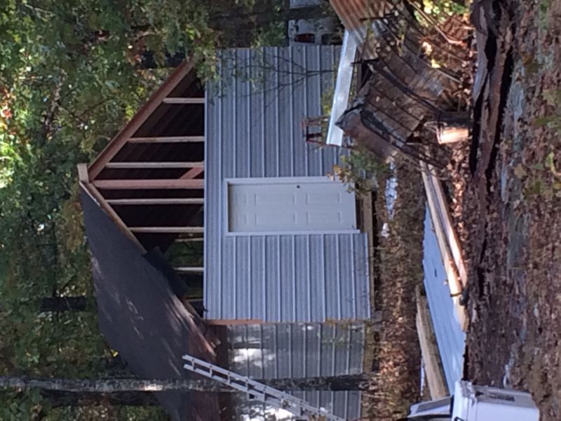

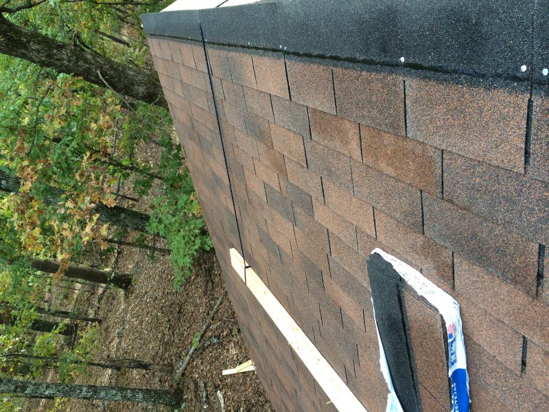

Well didn't get it done in the 5 days, one issue was my math was off on the amount of shingles I needed. I'll post some more pictures.

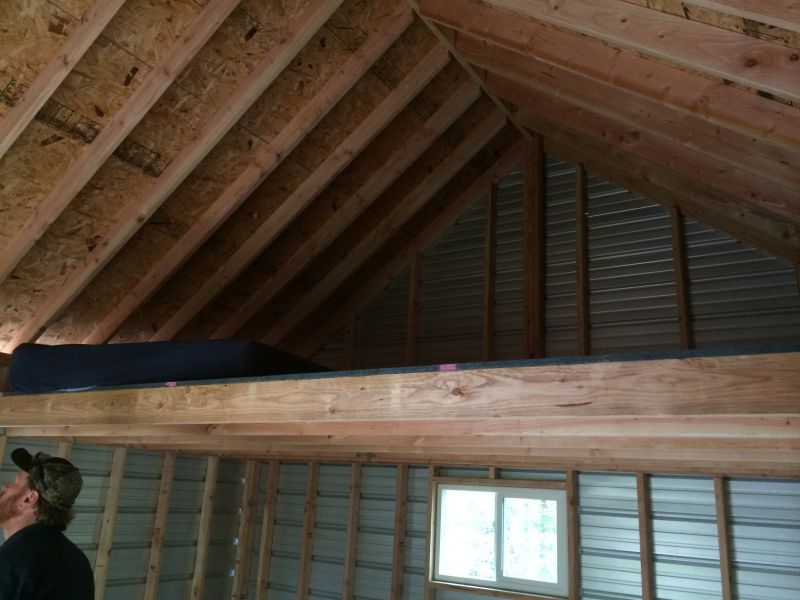

Looking good! What pitch did you go with? You got enough room for a bed up there... Are you putting in a window or some sort of ventilation?
Troutstudent
# Posted: 20 Oct 2014 04:46pm

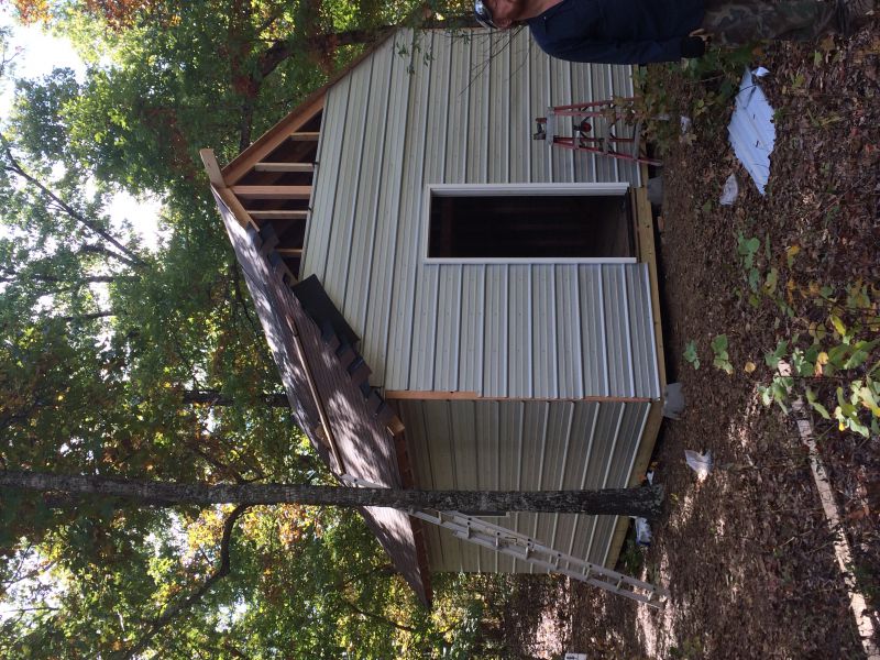

I believe it's around a 7-12 pitch. We are going to put a small window up in loft to be able to vent it. I bought a barrel stove kit and I know I will run everyone out of cabin if I don't be very careful with building a fire. Have to get back down there next Saturday after work and finish the shingles on the other side, can't believe I was 6 bundles short on shingles. Then need to pull off corner trim and fill in the tin ridges with steel wool to keep the mice at bay. The front porch will be in a few weeks I'm hoping. Just hoping I don't forget anything else I'm needing. But it's going good other than my friend won't get on roof to help.

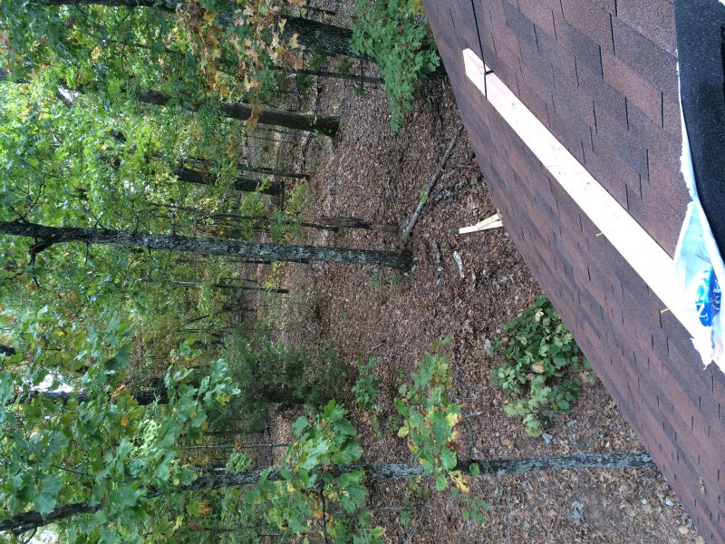

Finished up the roof shingles this last weekend. My buddy used three bags of Brillo to fill in corner gaps to keep mice and wasps out. Also had to cut down two trees that were too close to the cabin. Wish we would of cut them before starting the cabin. Next trip will be putting in barrel stove kit and filling in the eves. Hopefully building the porch if we have time, thinking of a 8x16 screened in porch for getting out of weather and bugs. Will take more pictures next trip, this trip was all work and I didn't get off the roof till I finished it.

Nice looking cabin, Troutstudent. I'm jealous of the roof pitch. I'm going to have a loft but with my short 4/10 pitch it will just be for sleeping and no walking around. Looking forward to the updates.

I'm happy with the extra room in loft for my girls to sleep but didn't like it so much when I had my old butt and back on it putting shingles on all alone.

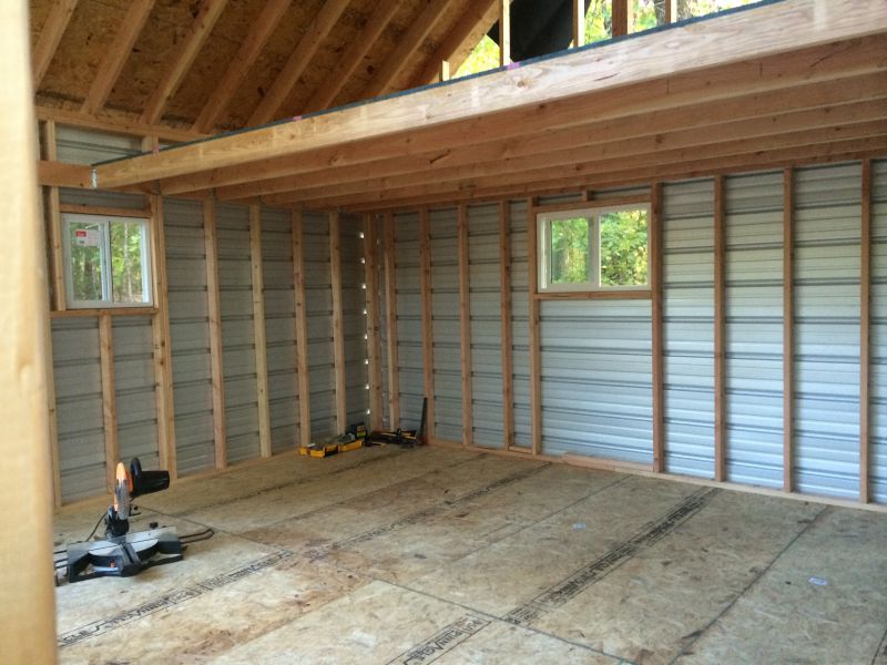

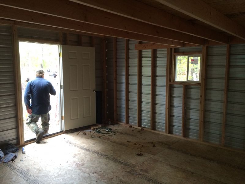

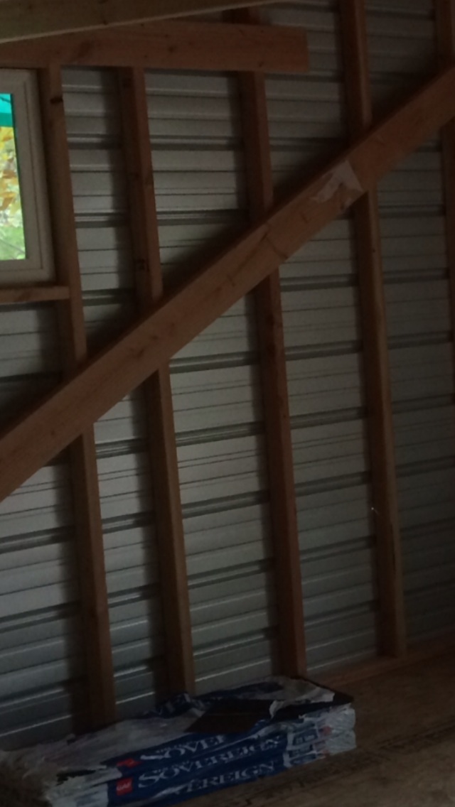

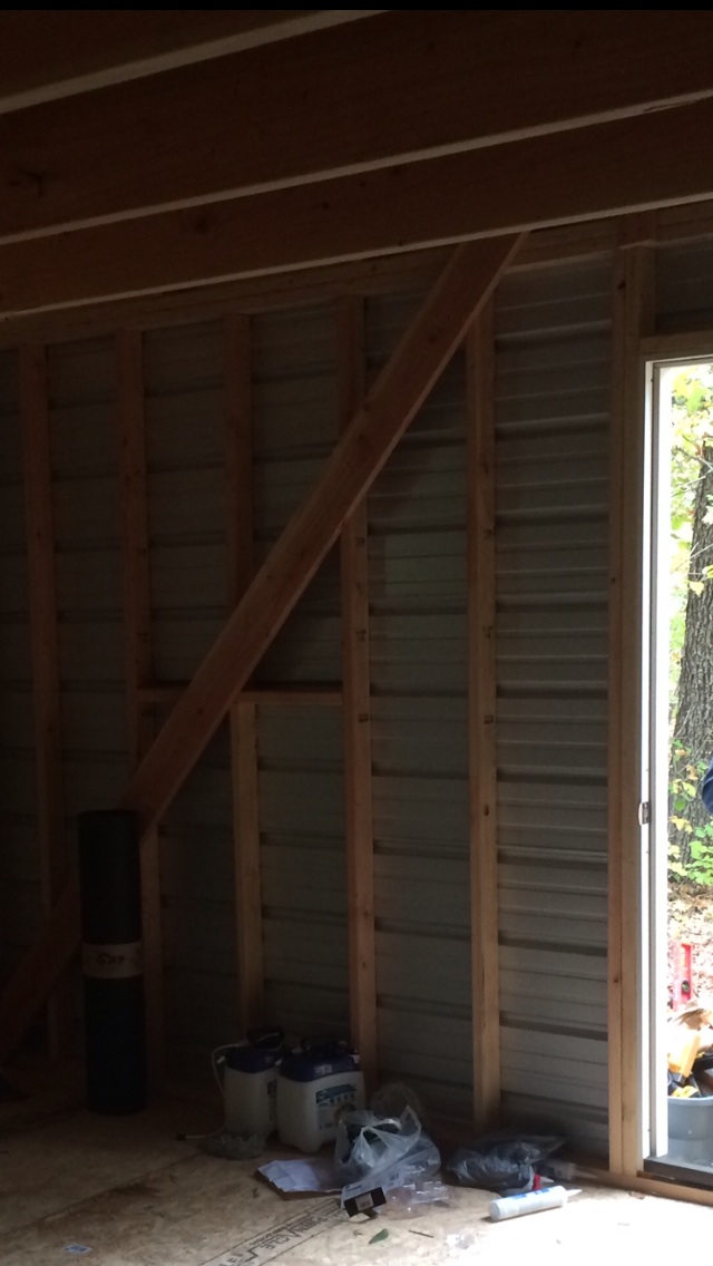

I try not to ever say negative things, but I'm wondering what keeping your building standing. The metal is poor storm bracing, not like plywood. You should maybe put some diagonals back on the inside.

I have 2x6 diagonal bracing on inside walls, when we put the tin on outside I moved the bracing inside until I could insulate and put inside walls on.
Troutstudent
# Posted: 28 Oct 2014 08:31pm - Edited by: Troutstudent
Here is a couple pic's I have of the bracing.

Hey Steve I used 2x4x8 for walls and dropped the loft down a foot making my lower ceiling just over 7' but gave me a little extra area head room up in loft. Going be heading back down to install barrel stove and insulate up in loft and put plywood above the loft this weekend.

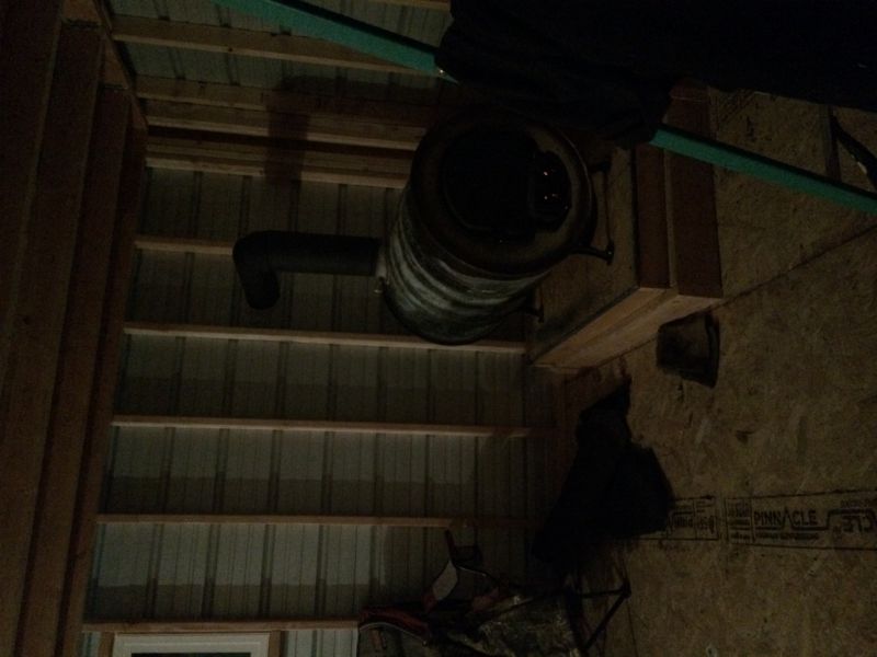

Got the stove in this last weekend, will post a pic. It is farther away from the walls than it appears in the picture.
