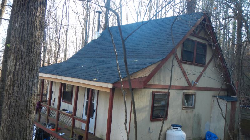

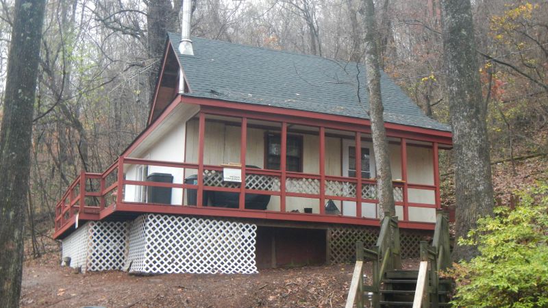

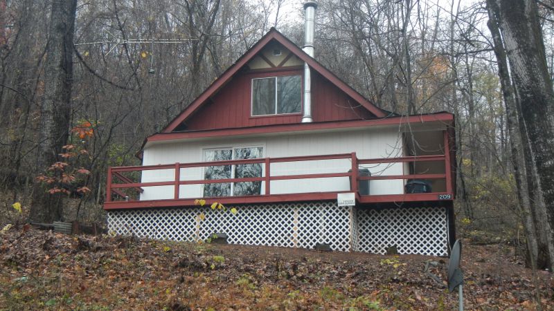

Long time sine I posted on this thread. Here is a quick up date- We had a new roof put on the cabin in November of 2015. Got a lot of work to do on the inside but at least the roof is good and we can start concentrating on other stuff.![New Roof 1 New Roof 1](https://www.small-cabin.com/forum/shared_files/uploaded/4980/95814_1.jpg) New Roof 1

I can't believe how different it looks with a new roof and redwood stain ? on the porch and posts. Looks excellent and like you said you are in the dry now so take your time and enjoy.

Easiest way to do the moss is with a leaf rake and a telescoping extension (Lowes/Home Depot have them) and just scrape it off. That was temporary as we actually had a whole new roof put on including about half of the plywood that needed replaced. I'm in my late 50's and 10 years ago I would have done it myself, but just decided not to chance it and we paid $6,500 to have it done by a local contractor. Time was also a big factor for me as I probably couldn't have done it all by myself at one time since I can't get to it for more than a week at a time. Actually the paint is Barn Red from Lowes which is what seems to have been on it before. Had to paint the new trim that was put up anyway so we did as much as we could on the rest too. I'll dig up some interiors and post them as well. Thanks for the response!

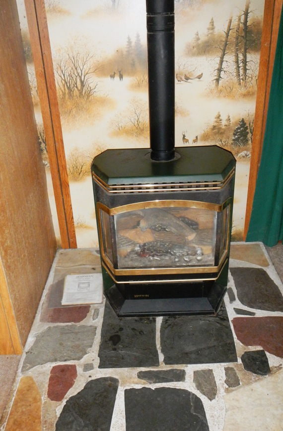

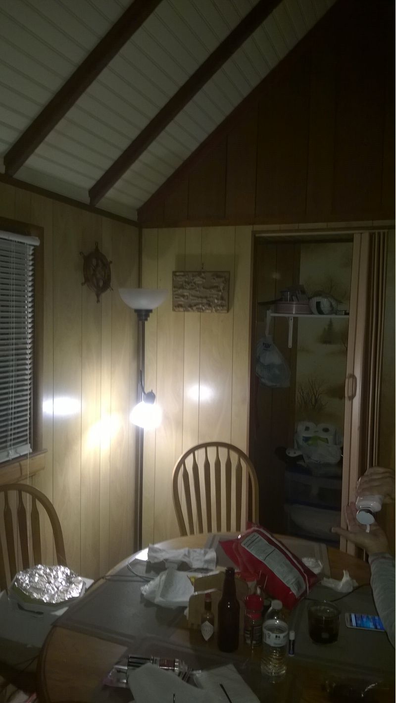

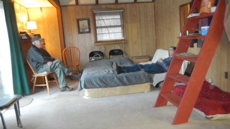

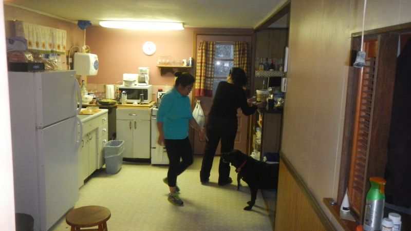

Here are some interior shots for you!![DSCN1020.JPG DSCN1020.JPG](https://www.small-cabin.com/forum/shared_files/uploaded/4980/95837_1.jpg) DSCN1020.JPG

I just read through the whole thread and realized I left a lot out! The plumbing has been fixed and we have running water throughout and the commode and shower work. In one of the interior shots you can see an electric hot water heater on the wall in the kitchen. It holds 4 gallons so it is fine for washing dishes and getting ready to go to bed at night. You have about 4 minutes of hot water for a shower and then the tank takes about 20 minutes to come back to full heat. Generally we just take a "Navy" shower and get wet and turn the water off, soap up rinse. Same for shampooing your hair and you usually have enough for a decent shower. The nice thing is the water heater has quick disconnects and in the winter I drain as much as I can and then take it off the wall and dump it in the kitchen sink and leave it upside down so the water drains fully and I don't have to worry about it freezing up. I also made sure the pipes running from the bathroom to the kitchen are at a down angle and there are cutoff valves that punch down under the house so I can drain the pipes to winterize as well. No more frozen pipes! Another trick I learned from my local friend was to get some RV line anti-freeze and pour a half a cup or so into the sinks and toilet to keep the traps from freezing. That is why we are going this weekend to "un-winterize" for the upcoming season. Thanks again, I'll post again soon!

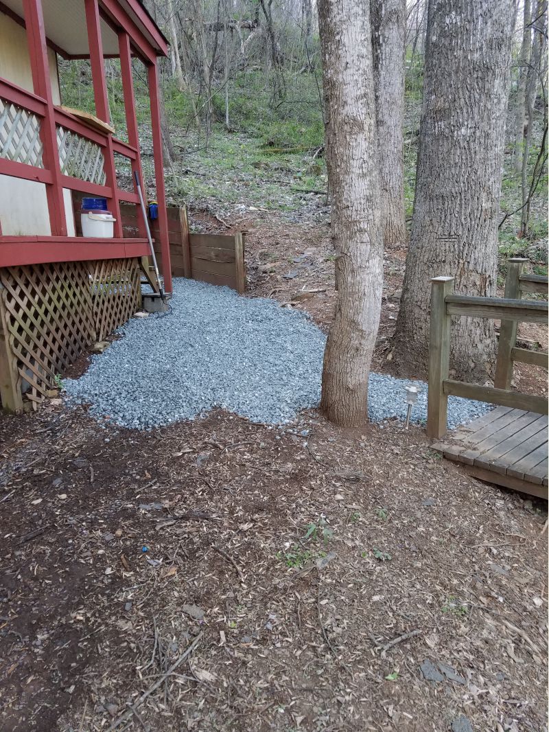

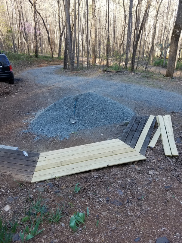

Spent a week at the cabin and got a few things done. The biggie was having 5 tons of gravel delivered. We carried it up the stairs one bucket full at a time to place it around the cabin for drainage. Then we spread the rest around the parking pad at the top of the driveway. We also power washed the deck and painted it so it won't deteriorate any more. I did some work on the deck pads at the bottom of the stairs since they were rotting and becoming dangerous to walk on. Got more to do but things are getting done each and every trip.
