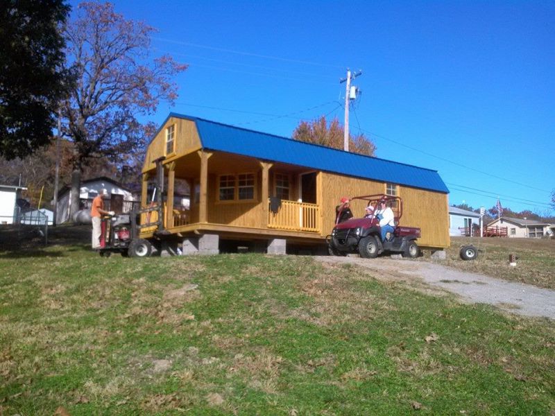

  here is a pic of my new cabin 14x36 including porch, 2 lofts ridge vents and soffet vents[img=null]null[/img]
# Posted: 5 Nov 2014 08:24pm
  beautiful! enjoy!
# Posted: 5 Nov 2014 09:04pm - Edited by: OwenChristensen
  Interesting. They're just finishing leveling, and setting up? Very nice!

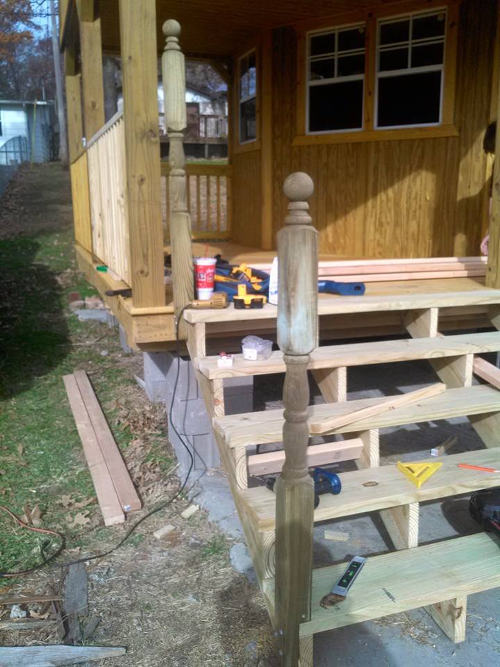

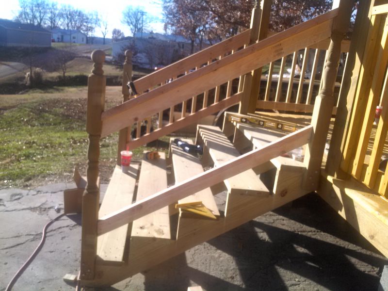

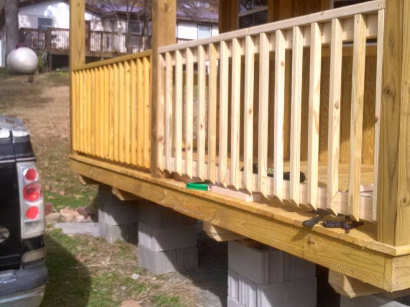

  here is pics of the porch railing getting finished by me and family  porch_post.jpg
# Posted: 10 Nov 2014 07:27pm
  Nice job on steps and railing!! .....is you  " cabin" located in a campground or subdivision??

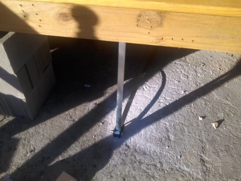

  would go fishing but we got 5" of snow. my next task will be to tie down the cabin incase of high winds. I'm using mobilehome strapping sinking bolts every 8' into the concrete slab. then wrapping over the runners and using lag bolts through the runners. also putting rafter ties from the runners to the floor joices.

  worked on the tie downs and the second step railing, got the railing completed but did not take a pic, I used mobile home tie downs per state regs 8 foot apart using the expanding bolts into 6 inch slab and had to drill hole into the clips that usually would hook to the steel frame, since my runners are wood I used lag screws through the clip into the runners. I did this because the cabin sits on 24 inch cinder block piers sitting on the concrete slab.

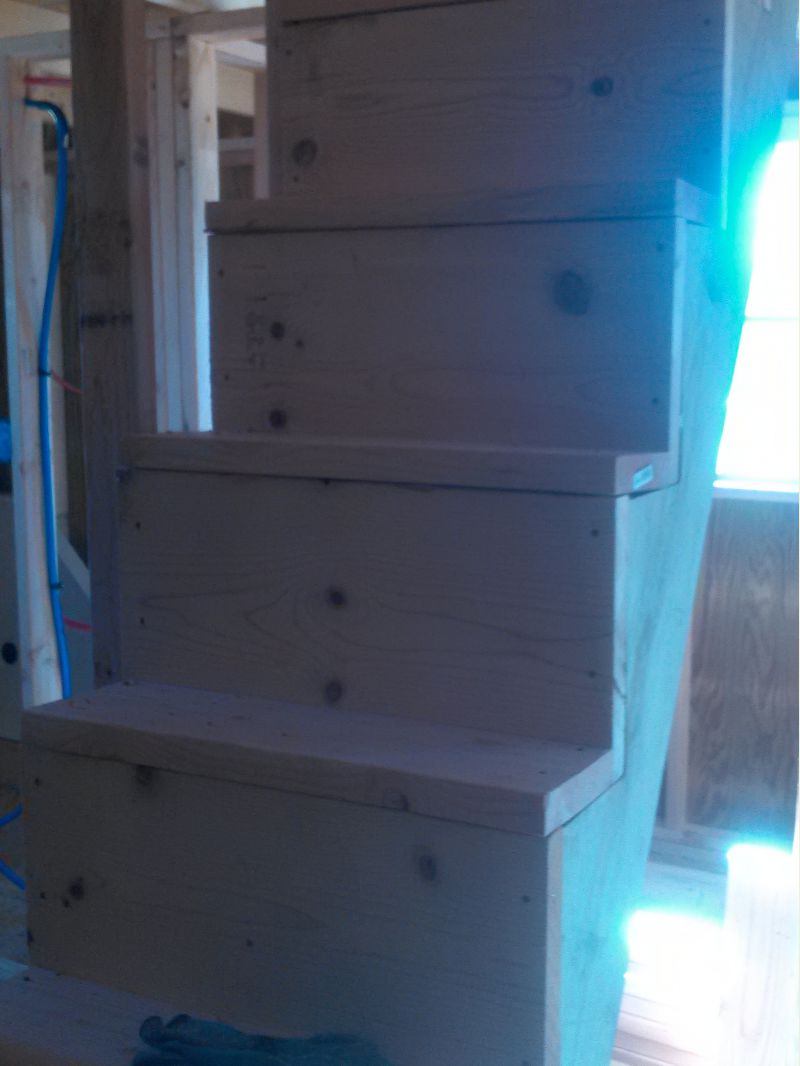

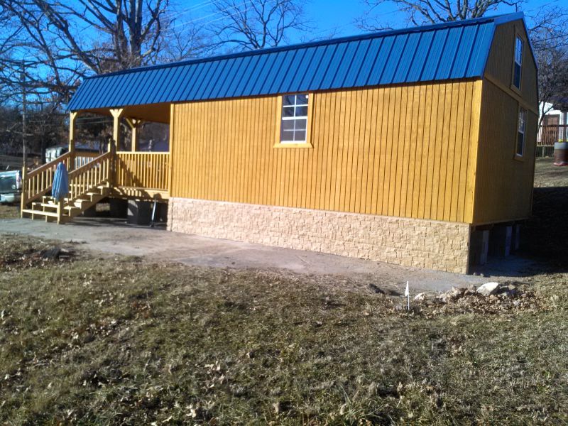

  here is a bit of work i did at my cabin today i skirted the front and built a narrow stair case to one of the lofts.

  Hi Skip, nice work.
  Can I ask what you used to skirt around the cabin?   Looks very nice.

  It is called everlock by novik i think. this is the sandstone stacked rock patteren. its a fiberglass and polyresin i believe goes together easy just have to frame behind it. i plan on insulating it later

 Quoting: SkipL It is called everlock by novik i think. this is the sandstone stacked rock patteren. its a fiberglass and polyresin i believe goes together easy just have to frame behind it. i plan on insulating it later
  Wow, that skirting is really nice!  Pictures you have shown so far are great.  You all stay warm!
