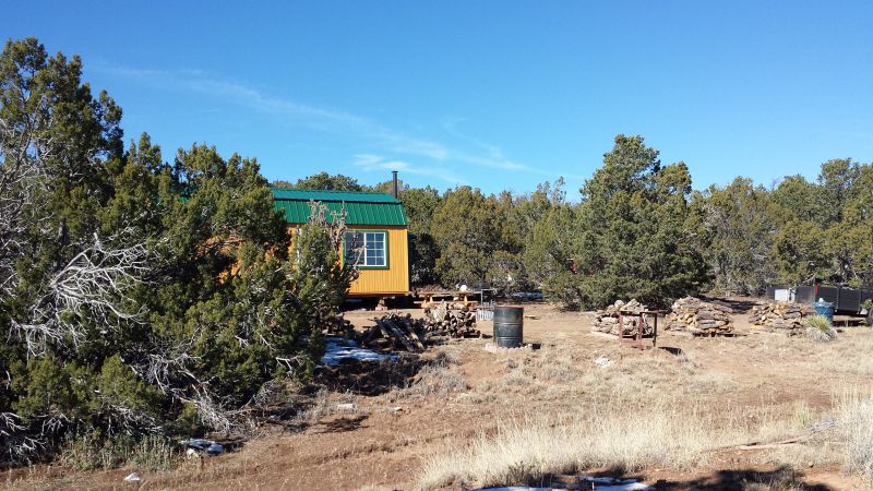

That's right!! You all helped....after years of trolling, reading ideas and lessons learned. I pulled the trigger and started my own project last October. It has taken a little over a year to get to this point.
I purchased 12 acres of land from family. It wasn't the "perfect" piece of land but the price and terms were good. We immediately went to work cutting in a road and burning off residual debris. We did as recommended and camped on the property every weekend for a couple of months rain, snow and shine before we decided on the spot for the cabin. i highly recommend anyone starting do the same. My first couple of ideas for locations did not work out and i would not have known this if it wasn't for camping on the property.

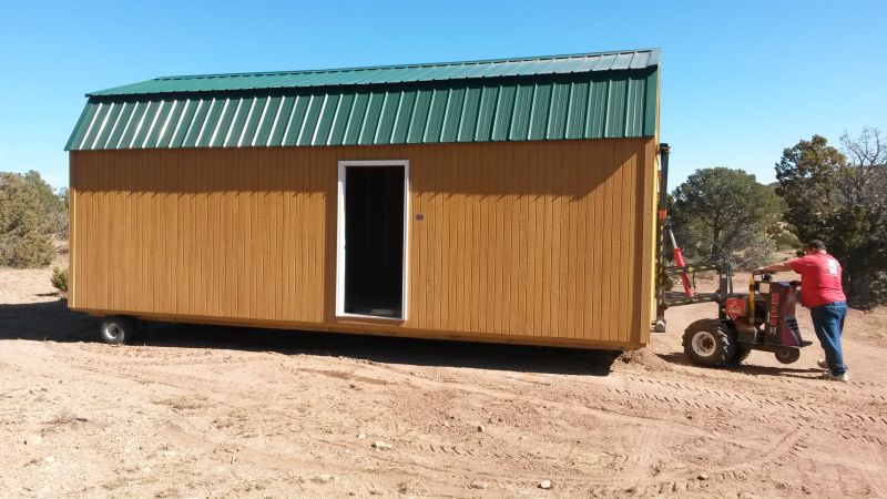

Because of associated cost and other issues I decided to start with a 12x32 shed and have it delivered. It took a bit of time to get it set and leveled but the delivery guy was patient and helped out with a lot of my leveling labor.

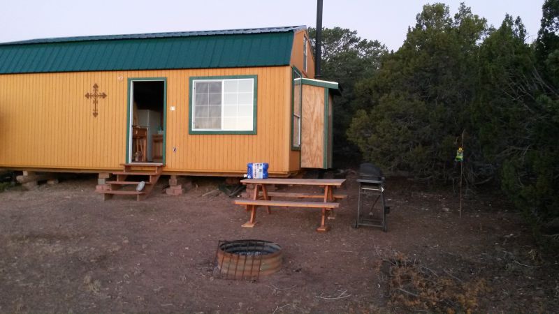

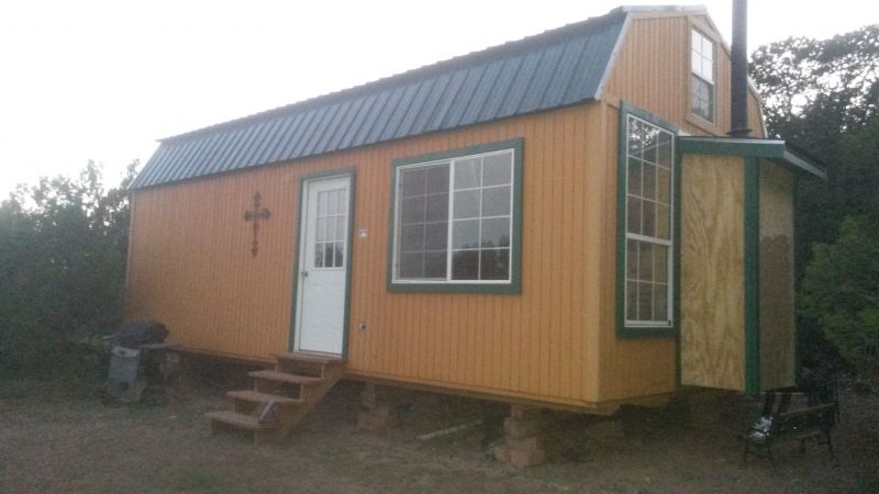

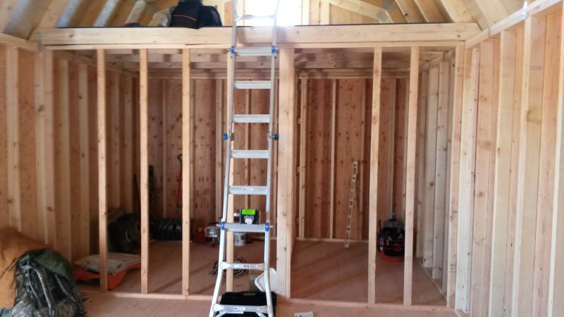

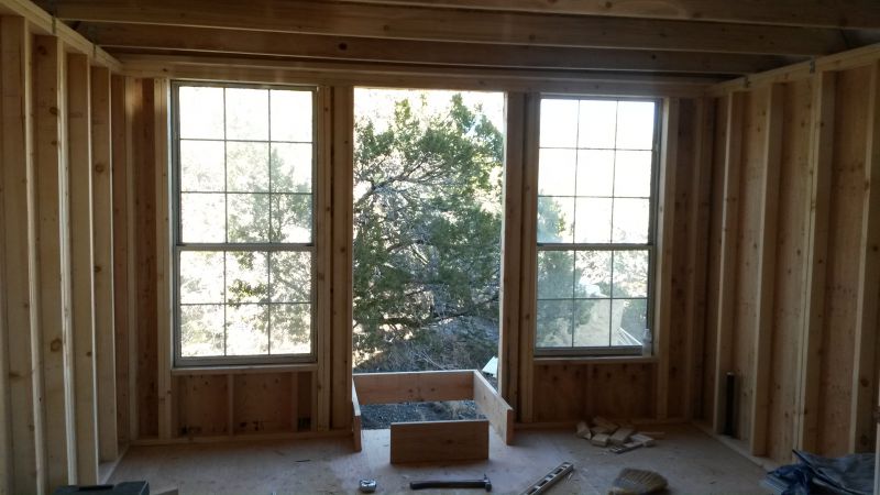

The exterior...at delivery and after installation of doors windows and trim. And initial interior framing.

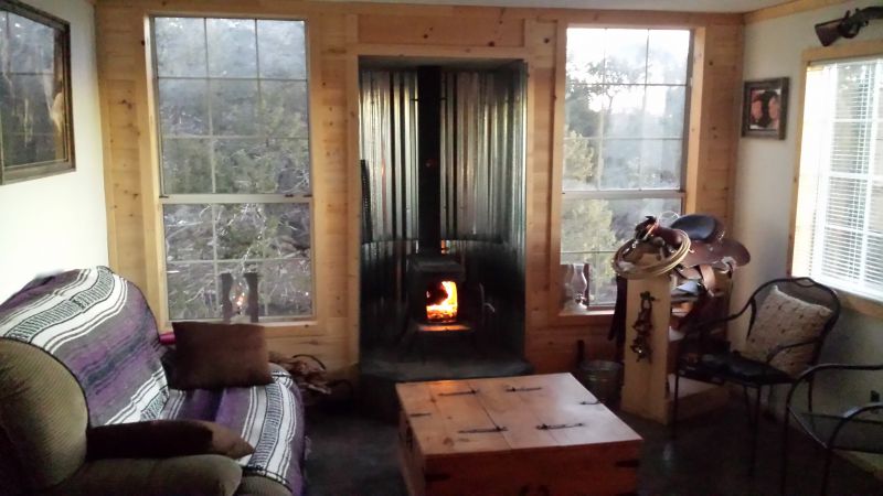

Almost complete...

Looks great! Really like how you set up the woodstove Congrats!

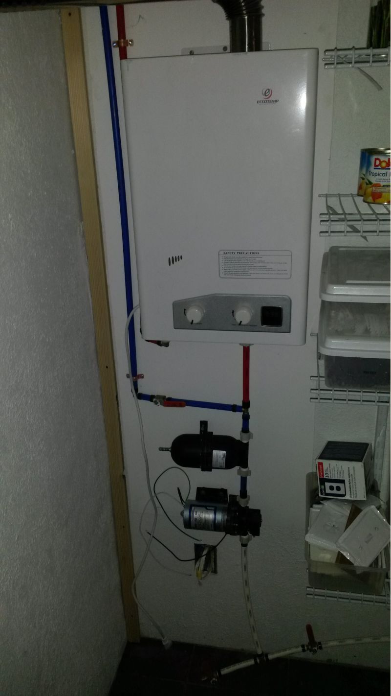

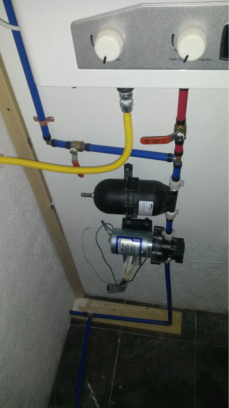

How'd MY water heater wind up on YOUR wall ? pressure can & filter too I see... lookit here bub ! ROFLOL !

What company did your shell?It doesn't quite look like a derksen.

I really like your stove setup. I might have to do something like that

I had to cantilever it to get some floor space....i like the way it turned out but i have to keep the fires small or run a fan to get the heat out of the pocket.

Steve S.....i soooo stole the idea from this site. I researched and found pics to copy it. I actually laid it out on the living room floor and built it out next to the IPAD with this site up.

Tiny acres...its a Graceland shed. Its the largest size i could get here in NM because of DOT regulations. Its full sized walls, double top plate and all hurricane hardware. Built just like a house with 2x6 rafters.

I thought it was a graceland.They are the best I have seen.And I have looked at numerous other companies.
Very impressive.

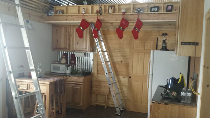

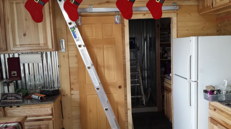

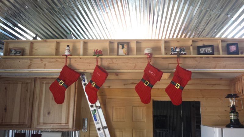

In my years on the forum I have not seen as fine of loft ladders as you have ,space saving ,lite weight ,sturdy, reasonable price ,who would have thought ,the essence of the small cabin forum, you listen well" grasshopper " !!

lol..thanks, i tried to be redundant in my use of things. I needed an extension ladder to work on the exterior so i purchased one. When i was done with the outside, I separated the two halves and used each half for a loft ladder. In the spring and fall when i need the extension ladders for cleaning the chimney its there, hidden in plane sight. I got the ladder at home depot when they had the Christmas sale. i think it was 30 bucks at the most.

Awesome job on the cabin. I have a question regarding your shower and pump. Looks like the exact setup I'm going for: shurflo pump 3 gallon/min and the eccotemp L12.... Do you get enough pressure/water for a decent shower? I ran the pump all this summer on cold water and was afraid when I split the line for hot and cold I would not have enough water or pressure. Thanks and nice place you have.

I really like the way you did the stove, what a clever design.

Morock.... I do have enough pressure....i have a short run to the shower of about 12 feet. But i can only support one fixture at a time. The sinks are plumbed just like any modern home. The shower is as well but instead of a traditional faucet i went with the MASH style pull chain low flow shower head directly above instead of a wall mount. With three women in the cabin i wanted to make it a "down and dirty" shower. Since i haul water in i cant afford to have them take all day with it.
