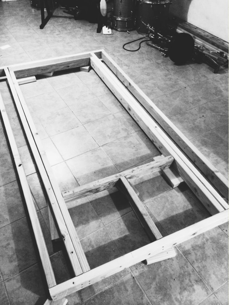

After lots of thought and many scrapped plans we decided to build the cabin in manageable portions offsite and assemble them over several long weekends. We found Michael Janzen's ebook Tiny Prefab: A Do-It-Yourself Prefab Building System helpful for filling in some of the blanks with our plan.

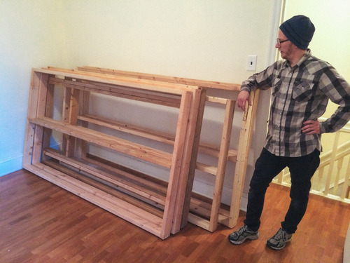

As of right now we are finished with most of the wall panels and should be getting the windows and door we need to finish the rest this weekend.

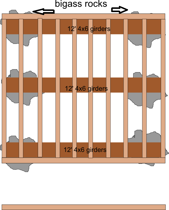

The property does have a ton of fairly large rocks, think we could maybe swing placing a span of two or three 4x6 or 6x6 girders across them and building the joists on top of those? See attached highly technical and totally (NOT) to scale drawing.
(Showing 12' girders as Lowes and HD don't seem to sell 16's?)

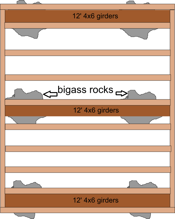

Or if we were to move towards a 12x12 structure (which may be happening), then something like this?

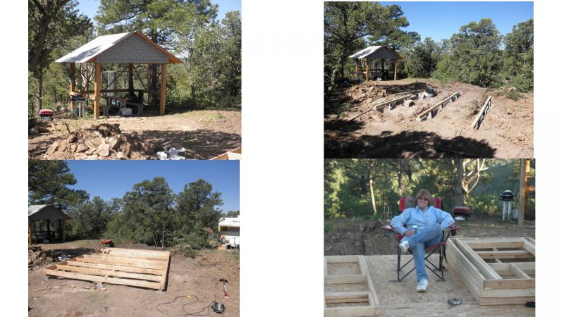

Wish I had found that book. My wife and I built a 12X16 a couple of years ago using the same idea. We built all of the wall sections 4 feet wide and trailered them to the property. Once you do the foundation (we trenched, leveled cinder blocks and pinned on treated 4X4) and build the floor, it goes together like a jigsaw puzzle. I drew up our plans in powerpoint if you'd like them as another reference. Cheers.
Ruggles
# Posted: 29 Jan 2015 16:55
Here's one from the beginning.

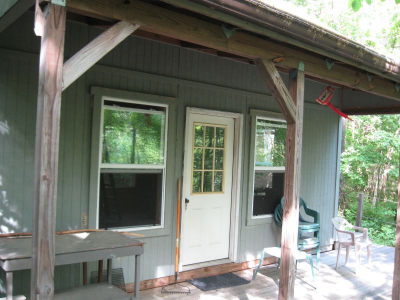

I also preassembled wall panels in roughly four foot sections for about the same reasons you did. I did 4x4s as deep as I could get them with a target of 3' but it's on a steep hillside and as I dug the holes I noticed they were dry as a bone - I've had no noticeable settling in about 10 years on my 16x20 in Ohio. I'm not a great carpenter and I should have spent more time squaring up the deck and other parts as I went along. The walls went up very quick and easy (and I have a nearly full second story with half-wall panels) but minor errors magnified themselves with each not-exactly-square panel (I'm not a great carpenter but I do have a PhD in Mechanical Engineering and thought I'd taken out all sources of variability - hah - yours likely won't be exactly square either, so be prepared). At the top I ended up cinching things with ratchet straps to bring them together; I understand they did the same thing with the two sides of the St. Louis arch. Good luck and let us know how it goes!![Cabin Porch Cabin Porch](https://www.small-cabin.com/forum/shared_files/uploaded/5277/77603_1.jpg) Cabin Porch
