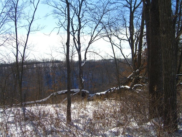

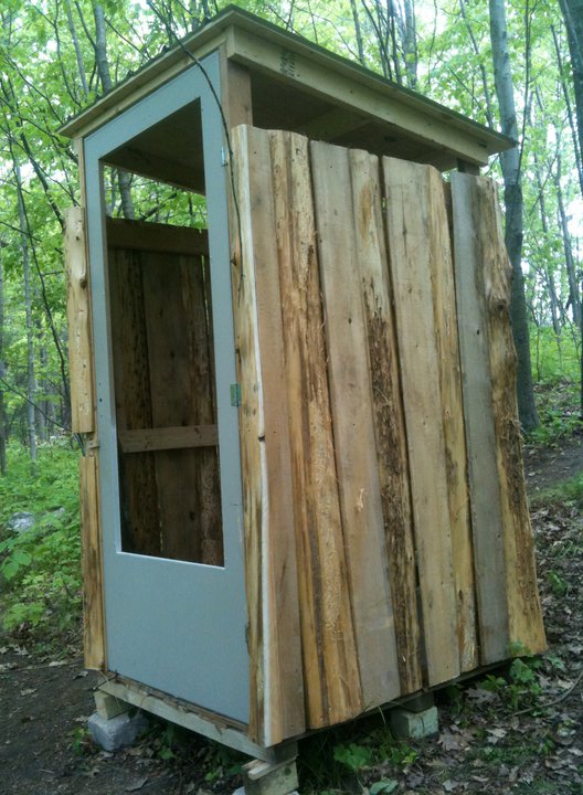

Hi all. I really enjoy looking at everyone else's projects / progress, so I thought I'd start posting some of my own.
I bought 6 acres in WI in April 2009, and since then have managed to build a (fancy) shed and an outhouse for a bucket toilet. The next set of projects include:
- summer kitchen - solar shower - chimney/woodstove set up - wall insulation/interiors Exterior Finished! (mostly)

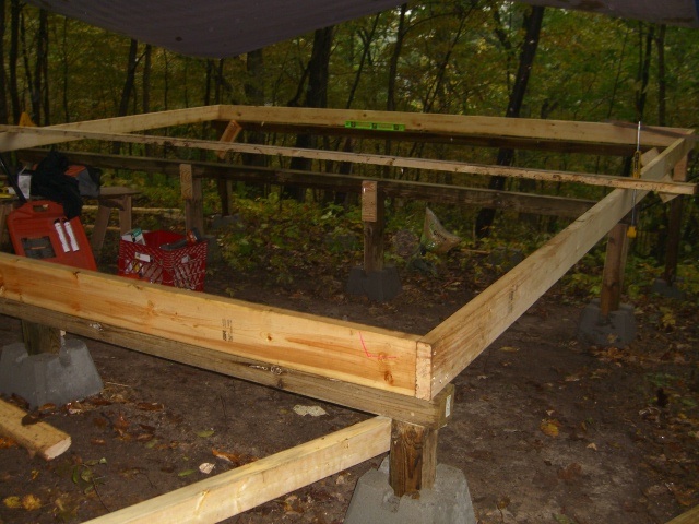

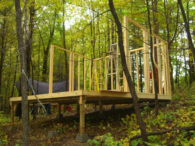

A little more about my project...the inspiration for the basic design came from a project for modern looking shed from ReadyMade magazine a few years back, and from there I used SketchUp to merge that base concept with various other design wants like a front porch, roof overhang, operable windows, etc.
It's has 2x4 walls with 16" centers, plywood sheathing, a Tyvek wrap, and LP Smartside for the siding.
For the foundation, I used the Dek-block piers after learning about them on this site. So far so good, and after the freeze/thaw of the first winter things were as plumb and level as ever.
The roof is metal, which I decided to go with so that I could collect rainwater. Here are a few more photos of the construction process, which was carried out over 2.5 days last fall and another 2.5 days this spring. Floor deck

# Posted: 1 Aug 2010 11:26pm
Our property is in Southern Idaho. We have 80 acres of rocks to build on.
Is that a 4ft. roof overhang? I have to deal with up to 3ft. of snow so I will have to have a pretty beefy roof and probably a steeper pitch.
I do need to get a better drawing tool. My wife and I want to build a modern shed followed by a modern 'cabin'.
I'm going to set concrete piers on the rocks that are ~1ft. under the surface.
Modern looks simple but the proportions are very important.
