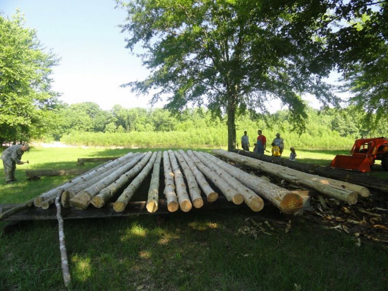

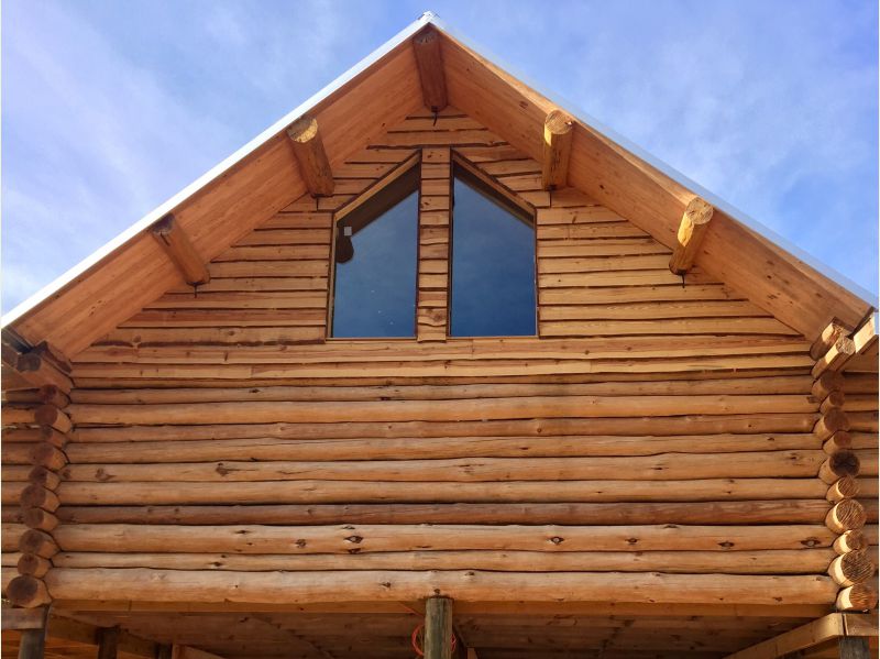

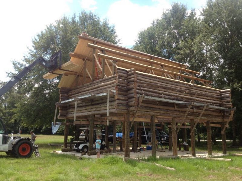

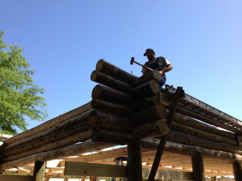

I started this project roughly 3 years ago and have loved every weekend working on it. I started falling trees in February of 2012 and have been busy ever since. Hope you enjoy seeing my pictures as I have truly enjoyed seeing other members pictures and reading post. Learned Alot from sharing with others.
Falling/de barking logs
Walls going up
Walls going up
Roof going up
Roof going up
Starting to work on chinking.

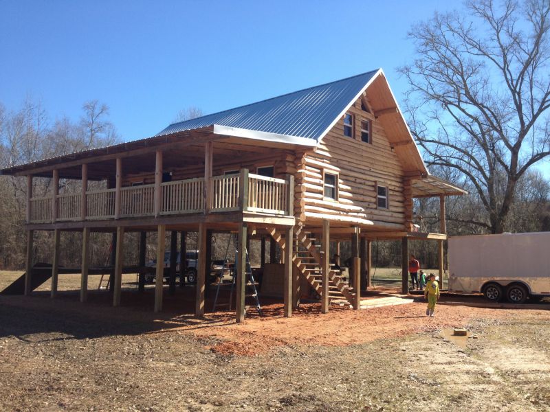

# Posted: 2 Apr 2015 01:22pm
Very Nice Simpleman ! I could drop that right in my build clearing without a blink ! Nice to have storage underneath and safety from any possible flooding.

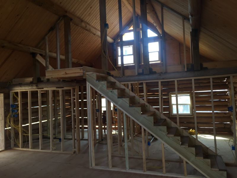

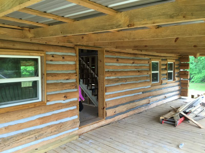

Im currently trying to finish up the exterior chinking. Pulled most of wire for inside and would like to start plumbing in May.
Insulation and nails
Chinking
Chinking
Inside
Inside
Windows
Windows
Simpleman
# Posted: 2 Apr 2015 01:26pm
Yes, I'm located on the Pearl river. Great fishing and hunting.

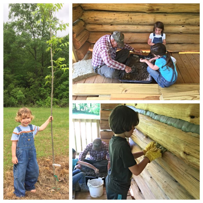

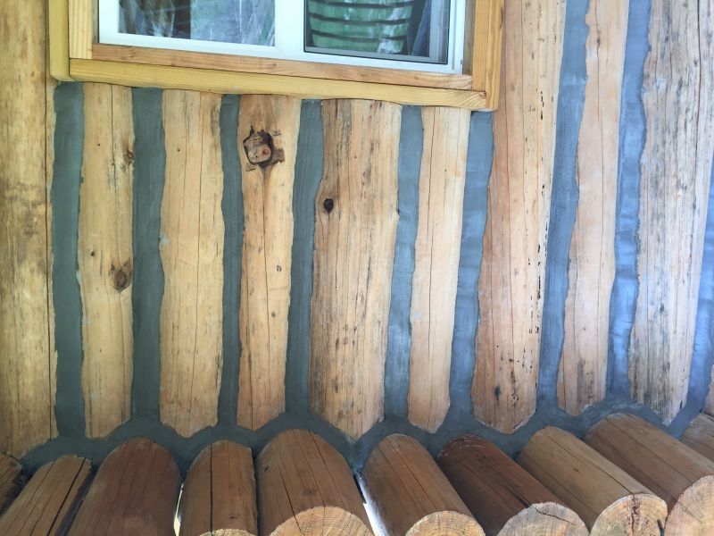

# Posted: 14 Apr 2015 10:53pm

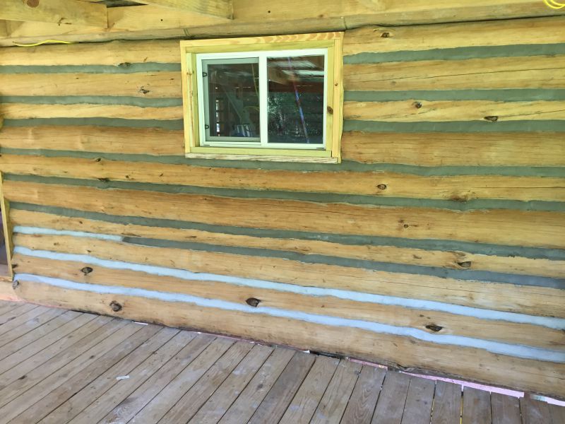

Front exterior of the cabin is chinked. Did I mention that this is time consuming! I'm pretty good at underestimating time to completion on projects.😉

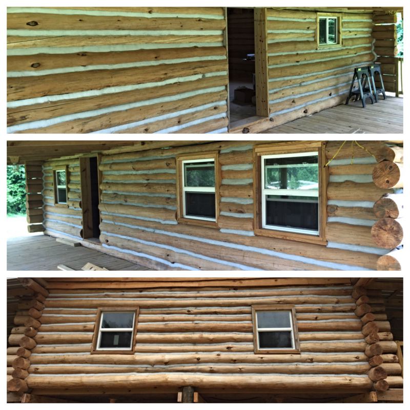

Simpleman,
Beautiful cabin!

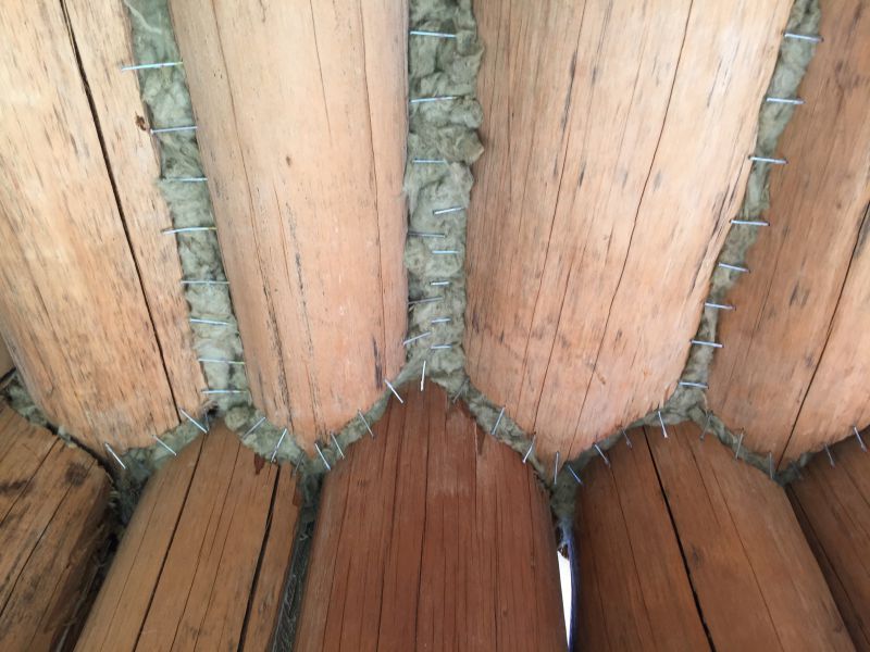

What is the process for chinking?
Simpleman
# Posted: 15 Apr 2015 09:17pm
The process that I am using is to first stuff gaps between logs with wool (treated with borates) or roxul insulation (cheaper). Important to have insulation that will repel water/moisture. Then I nail galvanized nails every 1" to 1.5" apart. Must use galvanized nails due to the lime in the chinking recipe which will cause nails to rust if not galvanized. The nails are what allows the mortar mix to adhere and stay in place. The chinking recipe that I use is 3 parts sand, 1 part Portland cement, and 1/2 part lime. Add just enough water so that you can ball up the mortar mix in your palm. I use a small 2" margin trowel to pack and spread the mortar mix on top of insulation through nails. So far so good. I researched using synthetic chinking but due to budget constraints went with the above. Difference in cost came out to close to 10k. I'll try and take more pictures of the process.
AU2009
# Posted: 16 Apr 2015 09:35am
Simpleman,
Good call...we used permachink on our cabin and it must not have gone on right. its already started to separate after 5 years. Needs to be ripped out and redone, will probably go with traditional chinking.

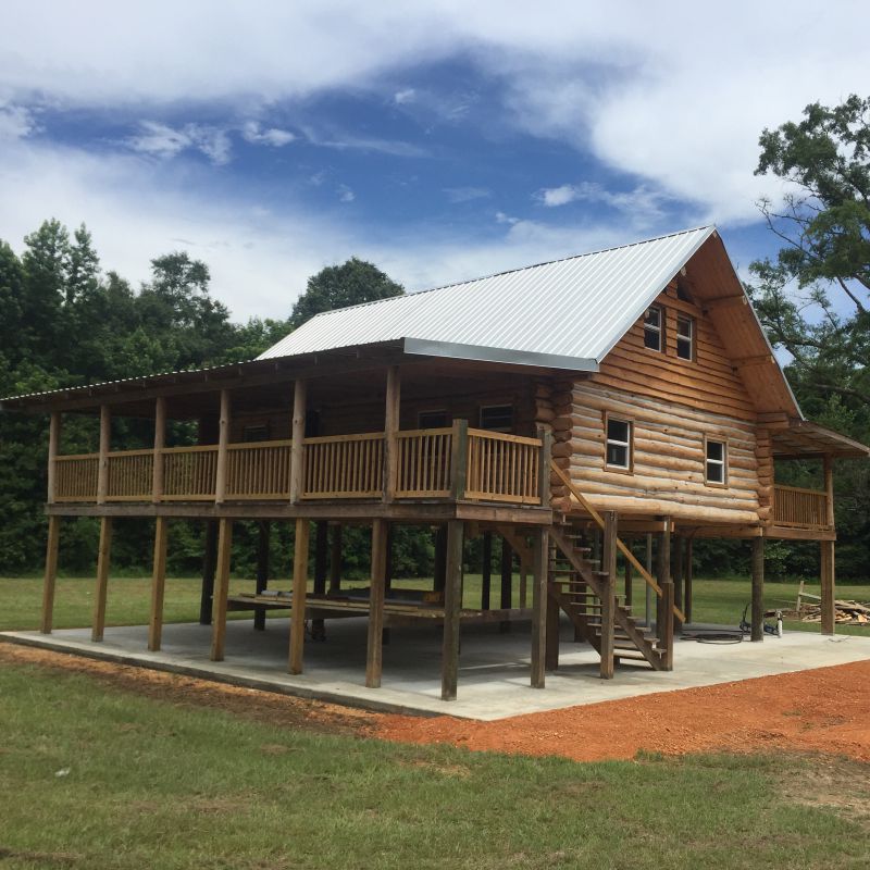

# Posted: 14 Jun 2015 07:39pm
Finished Chinking the exterior of the cabin and with the dry weather was able to get a few concrete trucks in to pour my slab under the cabin. I don't know where I will spend the most time, under cabin or on porches.
