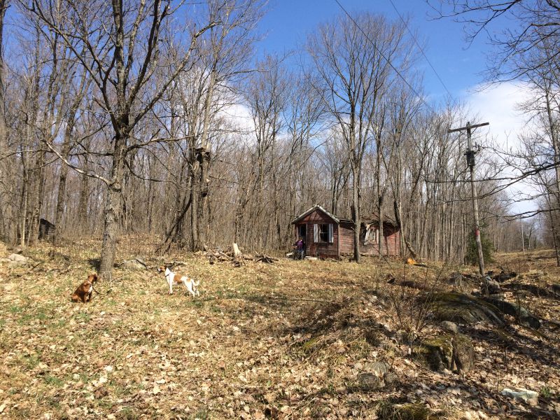

After a winter of waiting to get started on our property, we went up to check it out this weekend.
The property is drier than we expected, and we have a couple of ideas on where to put our cabin up. The cabin build will likely be a few years down the road, but in the meantime we will be fixing up the 12x24 shed (really a complete re-build) that will serve as a "shabin" until the cabin gets built and it will then become a shed/shop or may live on as a guest "Bunkie".
Attached are a few photos. The large house has to come eventually, but we can salvage some useful stuff out of it prior to demolition. The red shed with the caved-in roof is the re-build project this summer - and also we have a major clean up to do with lots of rubbish around the buildings.
There was a well drilled on the property in 1951 with clear water at 20 feet so hopefully it won't be much of an issue get a new well done in the next few years. I imagine the old one is a write-off and we haven't been able to locate it yet.
There's no septic system, just an old run-down outhouse. As for grey water, the house has some lines that run into the ground but I am unsure of where they go.
We have power on the property and it runs to the old house - we'll have them move it once the cabin is built. The "shabin" will likely run off of a 3000 watt generator, and be heated by a salvaged wood stove from the old house (there's a nice Fisher stove in there).
We have 12.5 acres of maple, ash, oak and elm forest and we absolutely love it. We had it surveyed this winter and our property lines are very clearly marked. No trespassing signs are up along the road and will be added to the other lines in the next couple of weeks. We are a short walk to the lake, so in the summer a refreshing swim will be great - in the winter ice-fishing is going to be fun!
I'll try to keep updates with photos posted after each visit.

Looks like you got your hands full! Couple questions, just from what you have shown us,
Why a generator if you have existing power? I can see the transformer on the pole.
You sure the old place has to come down? Not saveable?
How do you know the well has clean water at 20 feet if you don't know where it is? You sure it needs to be replaced? I've heard that some of the first drilled water wells from back in the 20s are still operational. Maybe all you need is a pump.

Hey bldinsp, the existing power is currently hooked up to the old house but not active. The power company will move the meter/hookup for us once for free, so we are saving that move for the cabin once it is constructed.
The old home is in really really rough shape. Inside the drywall has come down in almost all places (including the ceiling). There is standing water under the house (a stream runs under it in heavy rain). It smells badly of mould and mildew and it has obvious signs of rodent infestation. The next time I go up to the property I'll go in with my camera and post some shots of the inside. It's kind of creepy - lol. We don't like the style of the house and really want a cabin situated a little further from the road.
I researched the well location on our provincial government's website and obtained a record of the well that was done in 1951. The record describes the type of well. It's a scan of the original record that has been saved as a pdf file. The map showing the location of the well is so poor that it really doesn't help much. As all the information on the record is hand written and has likely been copied many times prior, it is a little hard to read but here's what I can make out:

I see your reasoning with the elec and the old house. Time for that building to die.
A well in solid granite is ideal. It's the sand and the casing above that could be a problem. Steel casing doesn't last forever and then it will let in sand. Since the original casing is 5 inch I bet you could get a new 4 inch casing in if necessary then drop a 3 inch pump in. But at such a minimal depth all you need is a surface pump. Let us know what happens.
I had to drill to 400 feet. Consider yourself lucky

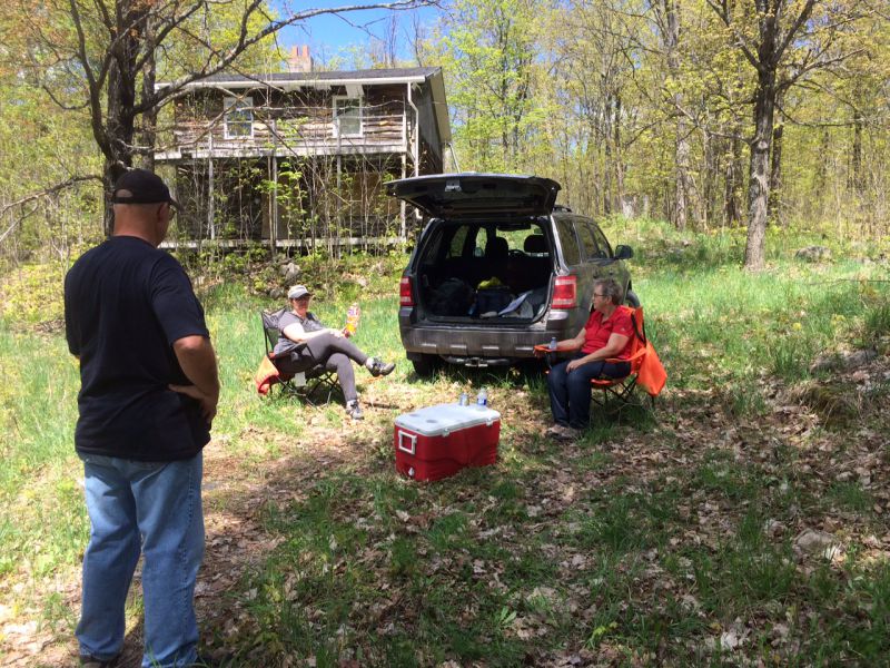

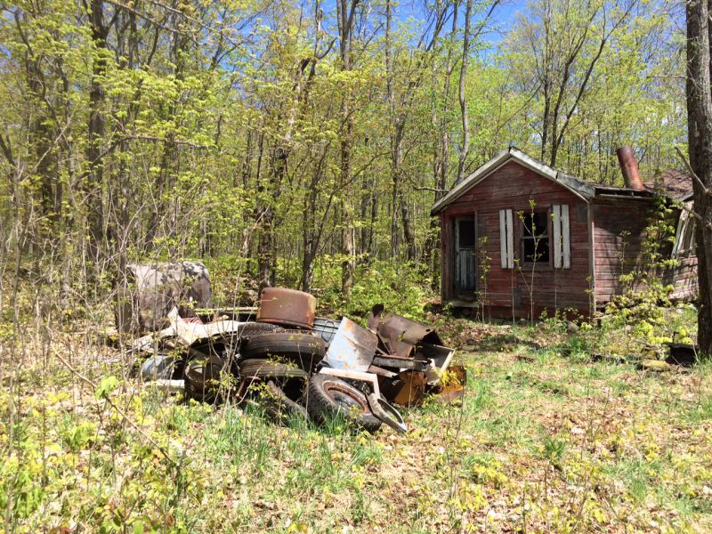

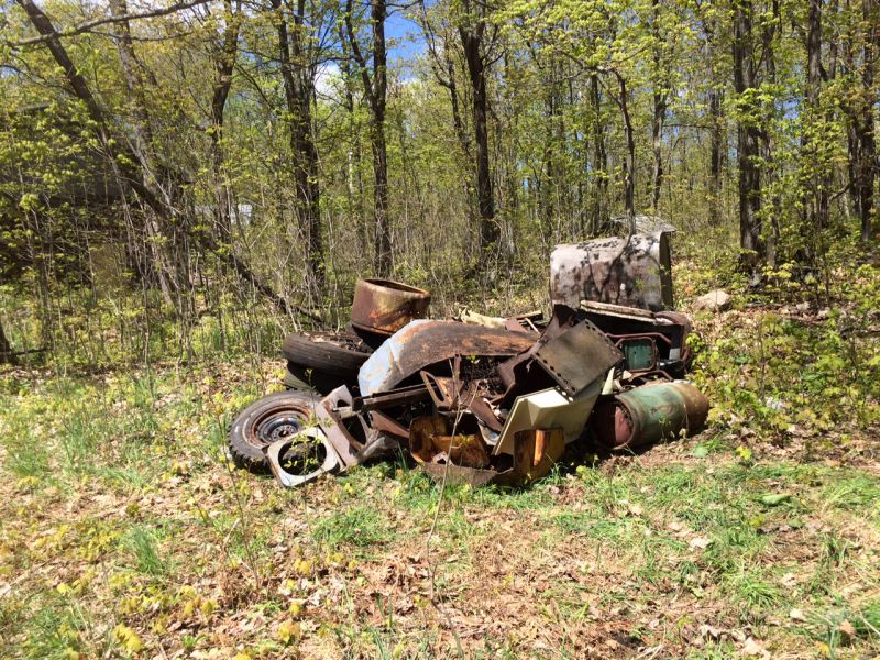

So this past weekend we (my wife, mom, dad and I) went up to the property to do some cleaning up. We cut back lots of saplings around the driveway and culvert leading into the property, and cleaned up a lot of scrap metal that was thrown out behind the red shed. One of the previous owners apparently ran a roofing business and lots of his scrap was just dumped behind the shed. Now it's all nicely piled and ready for placing in a dumpster or pickup from a salvage/recycling company.
We also had a good walk around the property and saw that we have tons of white, red and painted trilliums growing everywhere we look. These are really nice flowers and I'm glad that we have them. Blackflies were out in full force but not as bad as I have seen before - thank goodness for Off!
After the clean up we enjoyed a tail-gate / picnic lunch, did some shooting with my wife's new pistol (it's a BB gun) and then enjoyed some time by the lake.
Life is good!

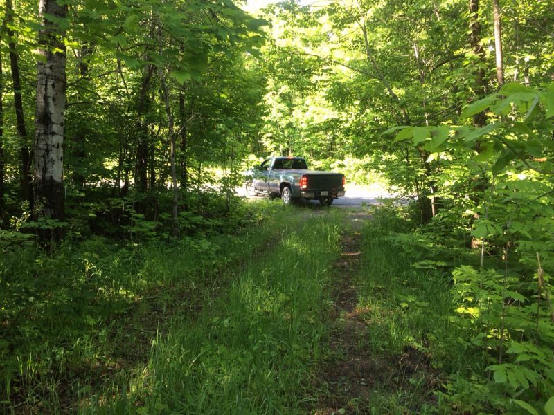

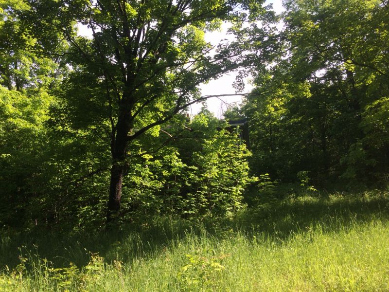

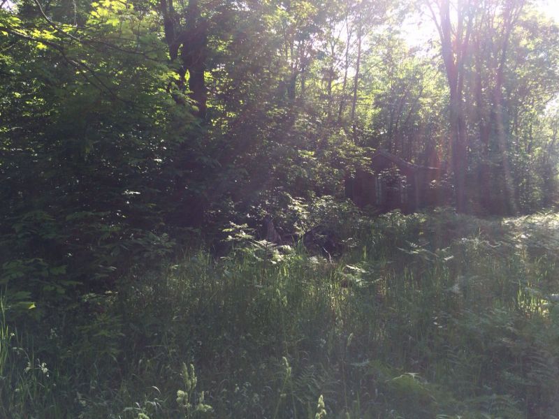

# Posted: 15 Jun 2015 10:16am
Update from this past weekend.
We managed to get up to the property this weekend. What a difference 3 weeks can make with vegetation growth! The house is barely visible from the driveway (see in photos attached) and the grass and ferns were up to about 4 feet high in some places. My dad and I went in with a Stihl gas-powered weed-wacker and cleaned up the driveway, and made a path to the shed. We started pulling "stuff" out of the the shed and sorting it. There was some metal (old cans mostly) and lots of old rotten wood. The wood we placed in a separate pile away from the metal pile we started on the last trip.
We got most of the big stuff out of the shed and decided the remainder would likely do better in a bin. Of course we don't have a bin so we'lll have to organize that for a later date. We also looked at pulling off some of the wood on the outside of the shed. We got started and realized that there was loose insulation between the outer wall and the panelling on the inside. Pulling the outer wall off would result in loose insulation everywhere - we need lots of bag... didn't have any of those either and were not sure if they would take it at the local landfill/dump. So, we went over to the old house and took some of the firewood that has been drying inside for many years to use at our campsite down the road (it burned well - nice and hot). We made a quick stop at the local landfill and got all the info we needed for disposal of waste. Lots of stuff I can drop there for free, but some has charges associated (shingles, construction waste, mattresses, etc). I've attached a few photos. I'm going to organize a bin to be delivered and get ready for some heavy work there in a few weeks. I've got the whole month on July off and hope to get lots done up there!

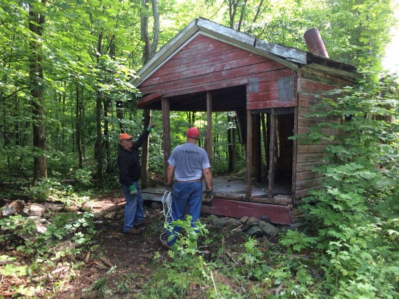

I managed to get up to the property for a few days of work in July. The weather was hot but for the most part dry with no rain. Mosquitoes weren't too bad for the most part. My dad and father-in-law came out to help as well.
We managed to get the shed down, but the roof still has to be dismantled and scrapped. The shed was in too rough of a state to try to get the roof off while the walls were still up so we stripped the walls down to studs with a few supporting posts added to the middle of the main room. Once it was stripped down, it took only a rope and a little pull to get it to collapse. It came down quick and didn't shift too far off of the floor (almost straight down).
I was surprised at some of the findings we had while stripping the shed down to the studs:
1. Insulation types inclduded fiberglass batts, cardboard boxes and wood chips / sawdust
2. The oldest thing we found in the shed was what appears to be a stone axe-head (we kept it)
3. Cardboard boxes used for insulation/draft sealing dated back to 1964
4. In some spots old vinyl flooring was used as vapor barrier for insulation.
5. There must have been a huge discount sale on nails - EVERYTHING had waaaaay too many nails in it!
We hauled off 3 truckloads of scrap metal, 5 truckloads of construction waste, and 20 large garbage bags to the dump. I figure that we will have at least 2 loads of shingles and another 6 or 7 loads of construction waste before it's all gone. Hope to get it don in August to September.

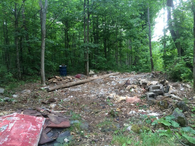

# Posted: 8 Jul 2016 09:15am
After almost a year with no updates I thought I would drop a note on how things are going with the property. Since last fall we didn't have much time to work on things. This spring and so far this summer we've managed to get the shed/cabin completely torn down and off to the local dump. In total (so far) the shed/cabin took 10 loads of "construction waste", 3 loads of scrap metal, and 20 large garbage bags. I expect we will still have another 15-20 garbage bags, one load of shingles and one load of scrap metal until the site is "clean".
Attached is the most recent photo of the site where the shed/cabin sat. I was surprised to find so much rubble underneath the floor. Lots of broken brick and cinderblock. The flooring was all tongue and groove and a bit of work to get pulled up. The joists were in pretty rough shape with a lot of rot. Some were still in good shape but so riddled with nails that they were unusable. We did manage to salvage some rough cut planks (measured about 1"x12"x12') that we will be using to make a target backstop for our pellet guns, and also a small "fort" in the woods for my step-son.
We are pretty sure that we will build our "shabin" (shed/cabin) in the same spot, with future plans of a bigger build further back in the centre of the property later. For now I would like to just have a place that I can use during hunting season for shelter, or as a place to warm up if I decide to do some ice fishing in the winter.
