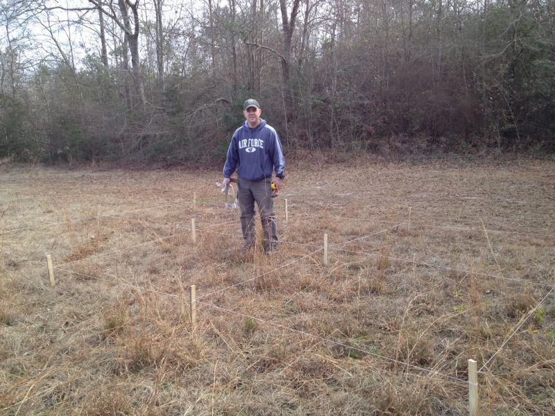

here is the start of our 12x20 hunting cabin just south west of Troy Alabama. We started Jan 2015 when it was still cool. This is in the north west corner of our 42 acres.

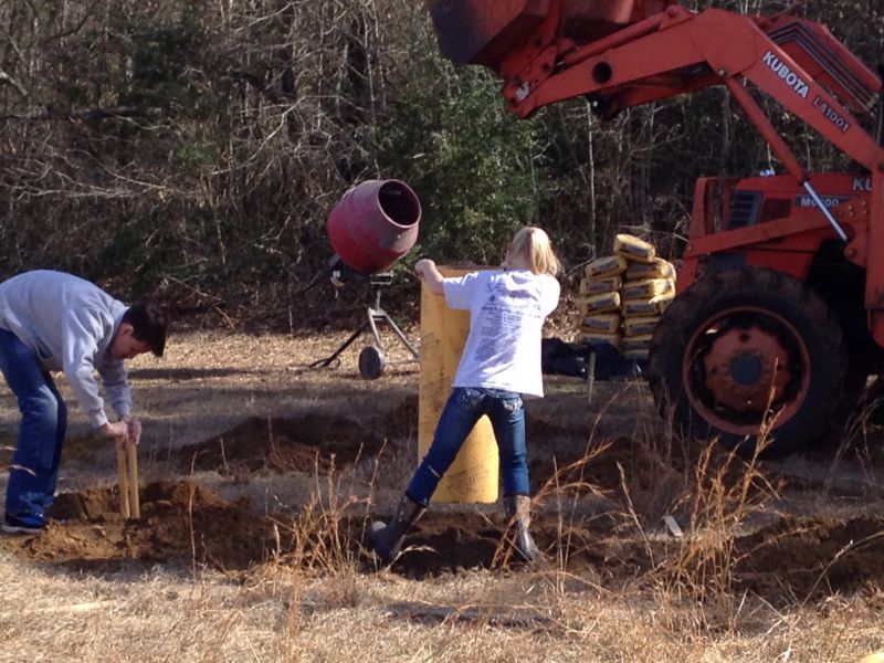

# Posted: 30 May 2015 22:39

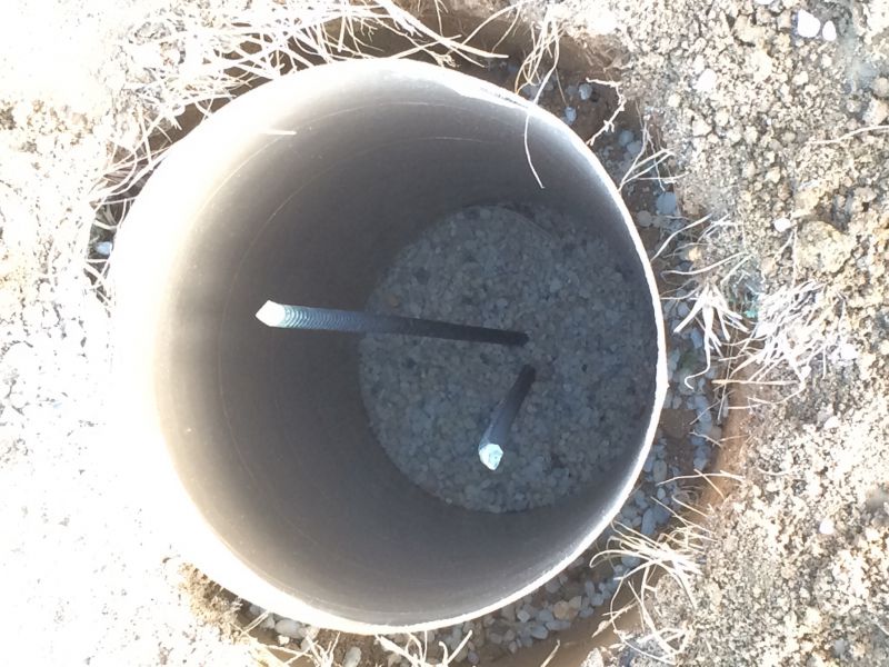

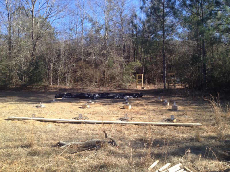

We chose the highest point in a cleared grassy area. We have some great neighbors who came to our rescue with a drill. Using 12" sonotubes each 4 feet deep we build the piers/footers.![image.jpg image.jpg](https://www.small-cabin.com/forum/shared_files/uploaded/5642/82808_1.jpg) image.jpg

# Posted: 30 May 2015 22:45
Surprisingly enough the piers came out rather straight. 3' lengths of 3/4" all thread was placed deep in the concrete and adjustable brackets.

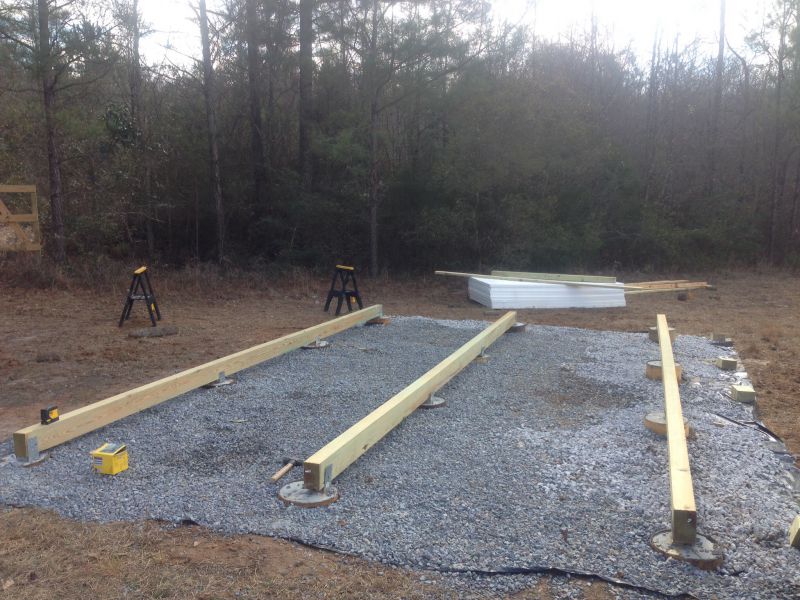

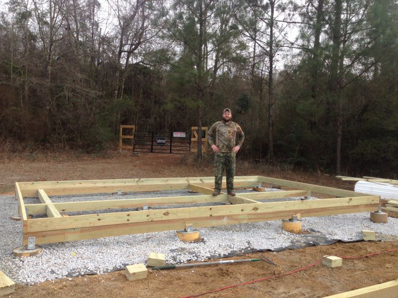

# Posted: 30 May 2015 22:52

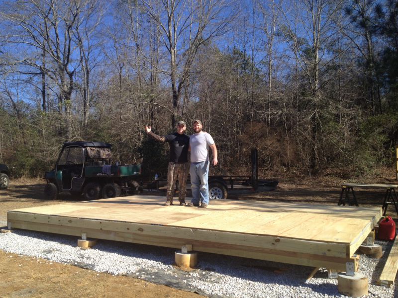

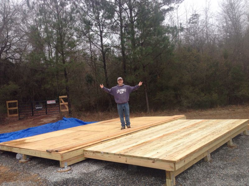

My brother came down from Washington to lend a hand. The ground was leveled, plastic put down and drainage rock placed. I decided to go with 20' long 4x6 PT beams that will be reinforced. We will use this as the base for our floor.

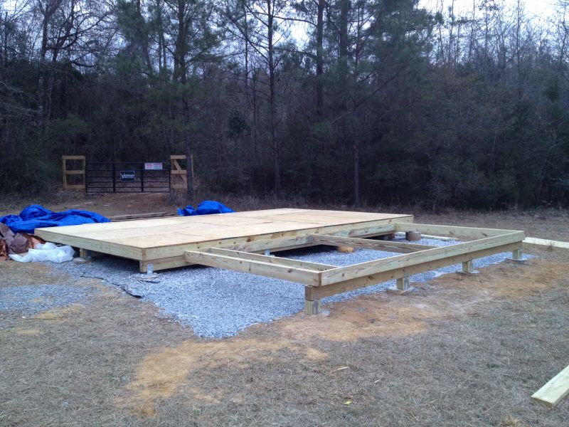

Pawag

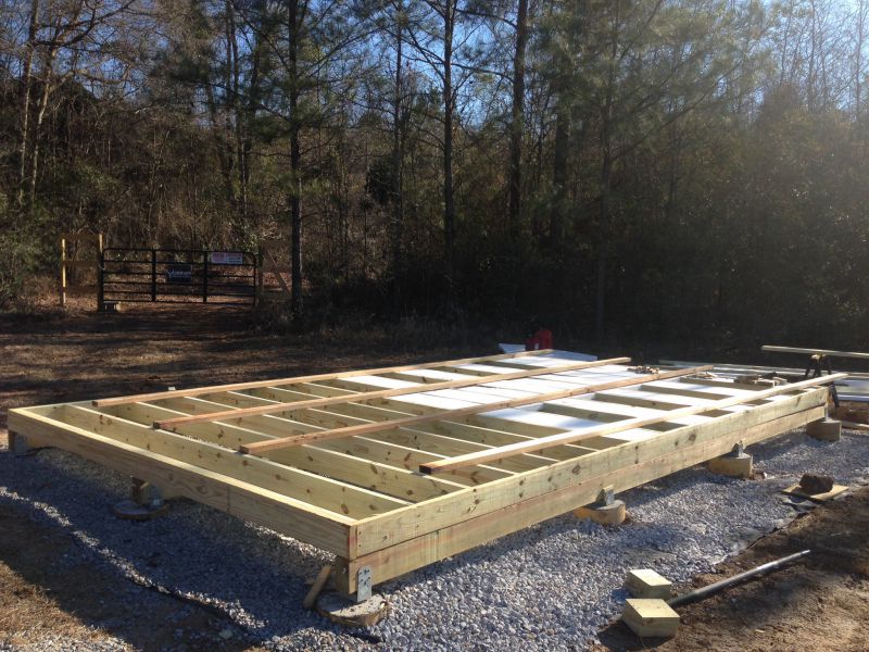

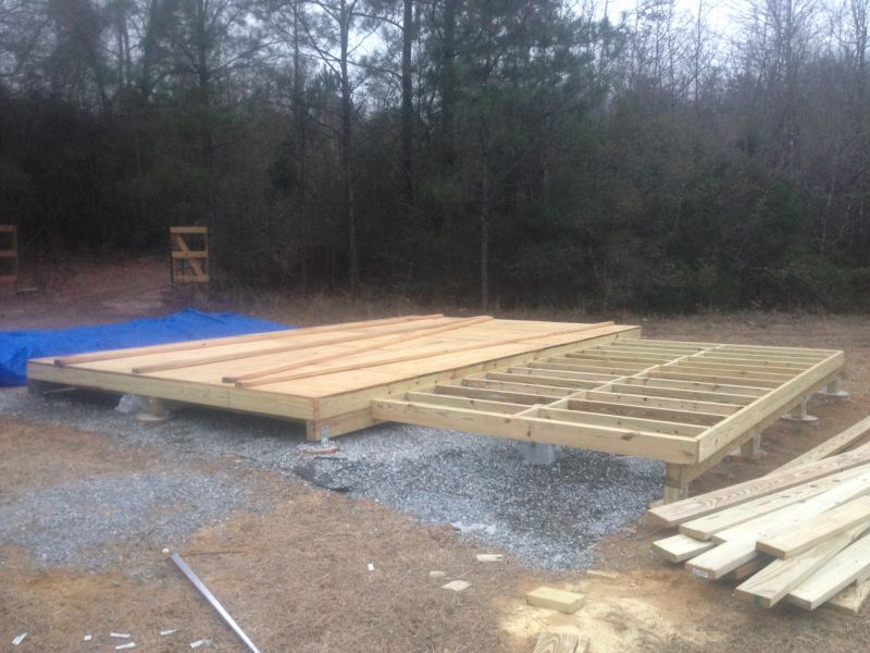

# Posted: 30 May 2015 23:02

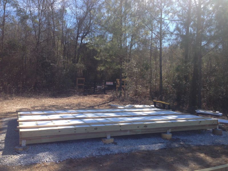

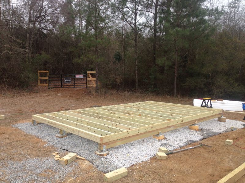

After purchasing every piece of pressure treated wood in the Troy Alabama area we built the floor. Because we had 3 beams < 6 ft across we went with 2x6 at 16" on center. We built supports to hold styrofoam sheet for the insulation them covered with thick plastic. Then the 3/4 inch plywood was secured down with screws.![image.jpg image.jpg](https://www.small-cabin.com/forum/shared_files/uploaded/5642/82814_1.jpg) image.jpg

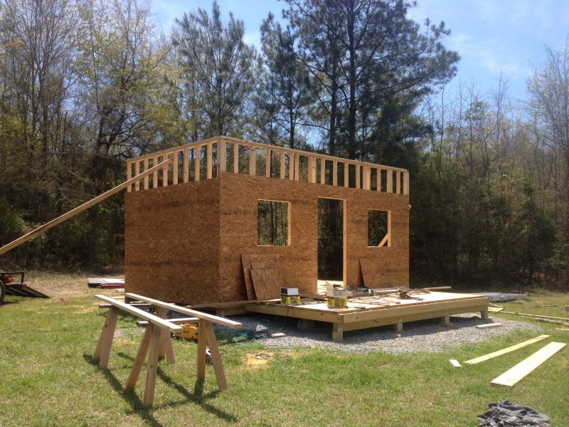

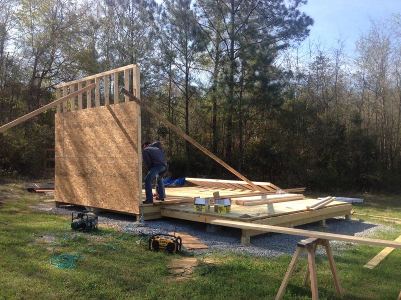

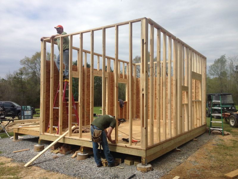

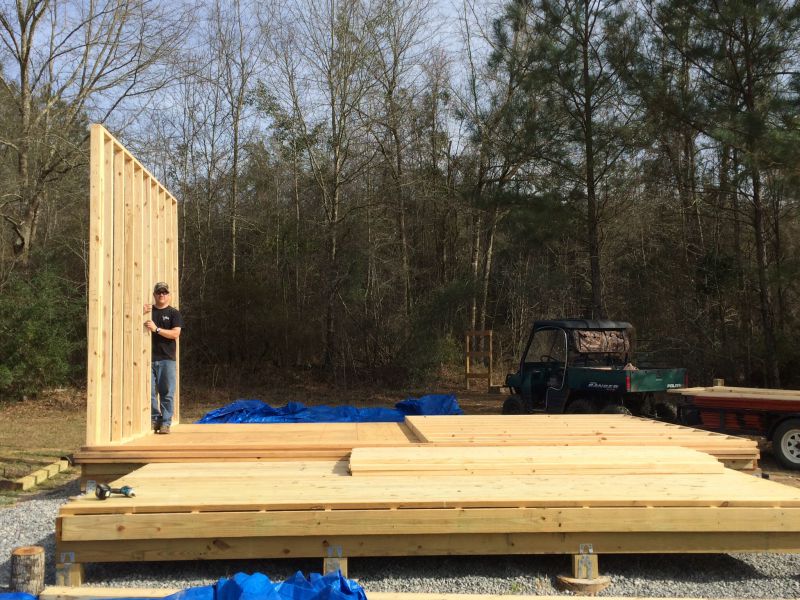

# Posted: 30 May 2015 23:18
It's time for the walls. This is where I went a little crazy. I decided to order trusses, I felt bad I didn't do it myself but I did everything but build them. My friends from Wisconsin came down to lend a hand. These would be 10' walls on half and the other 8' high to give me a nice loft.![image.jpg image.jpg](https://www.small-cabin.com/forum/shared_files/uploaded/5642/82818_1.jpg) image.jpg

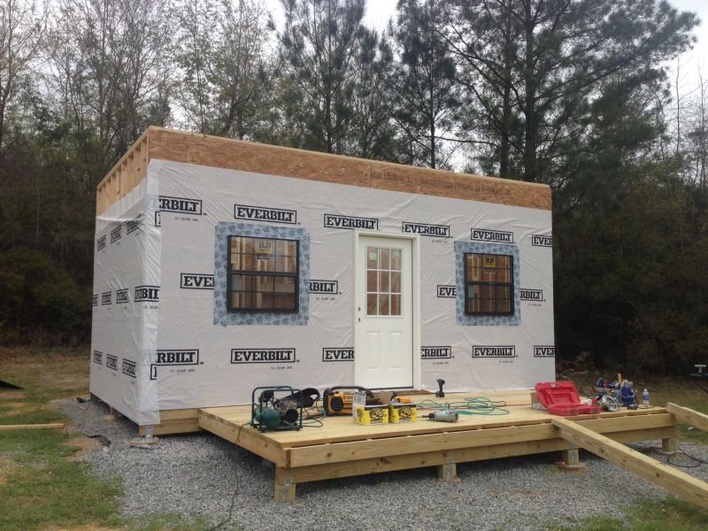

Pawag

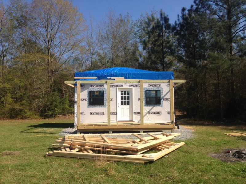

# Posted: 30 May 2015 23:22

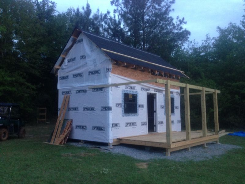

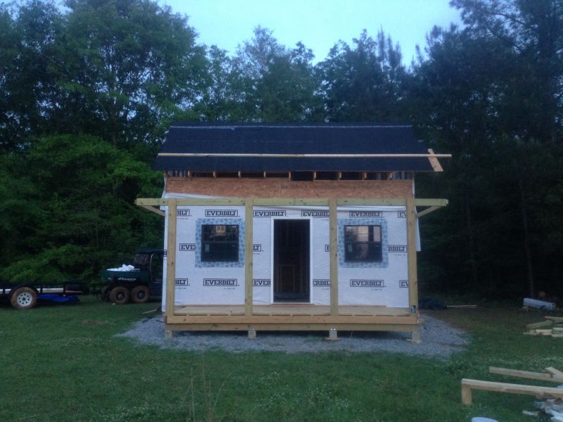

The sheathing and wrap was nice to put on. We added the windows and door. it's now starting to look like a cabin.

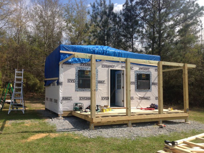

# Posted: 30 May 2015 23:33
My good friend brad built the porch beams using four 6x6 PT beams. He ties these perfect into the floor boards. This has a 20' long 4x6 cross beam.

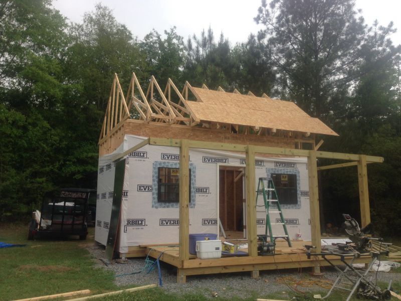

Pawag

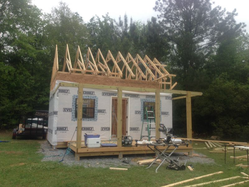

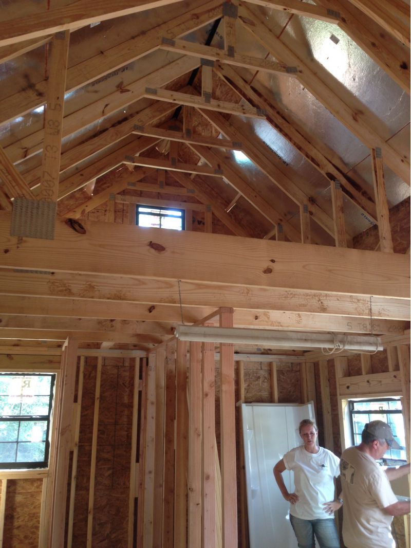

# Posted: 30 May 2015 23:37
The trusses were quite the project but instantly gave me an 80 sq/ft loft. The roof sheathing was attached and peel and stick rolled tar paper was put on until we put the metal roof on.![image.jpg image.jpg](https://www.small-cabin.com/forum/shared_files/uploaded/5642/82821_1.jpg) image.jpg

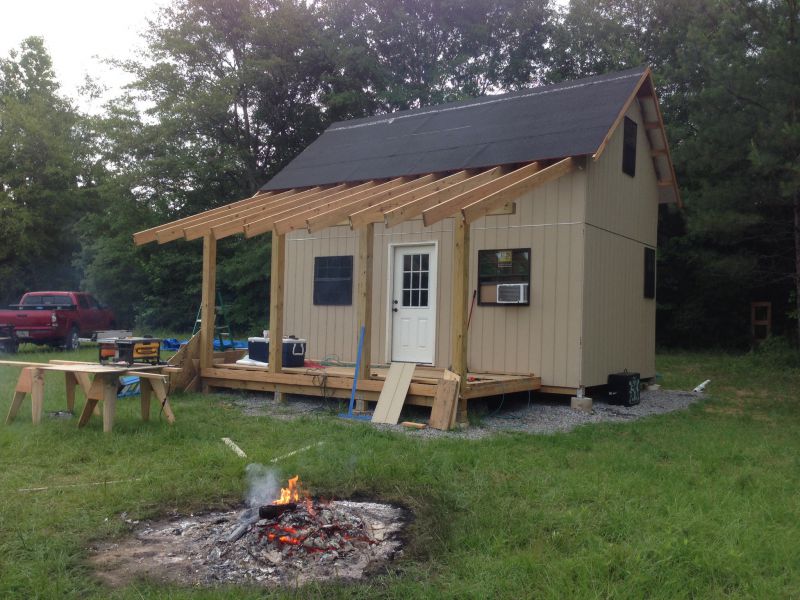

Pawag

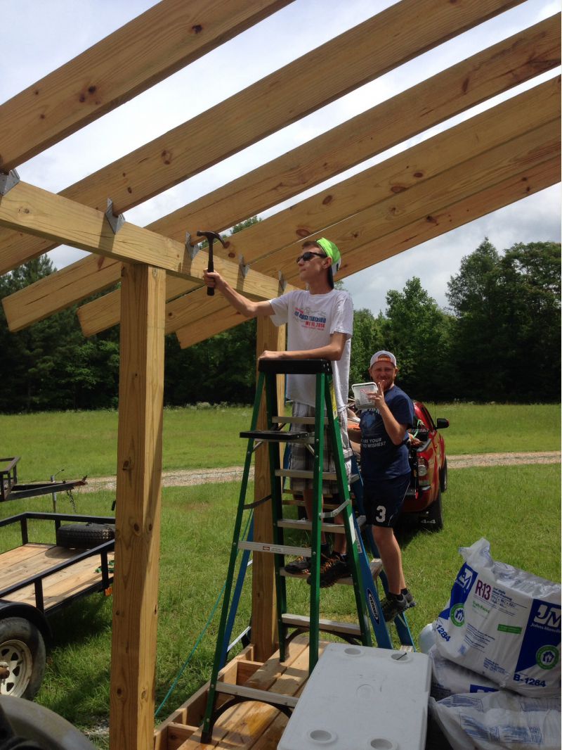

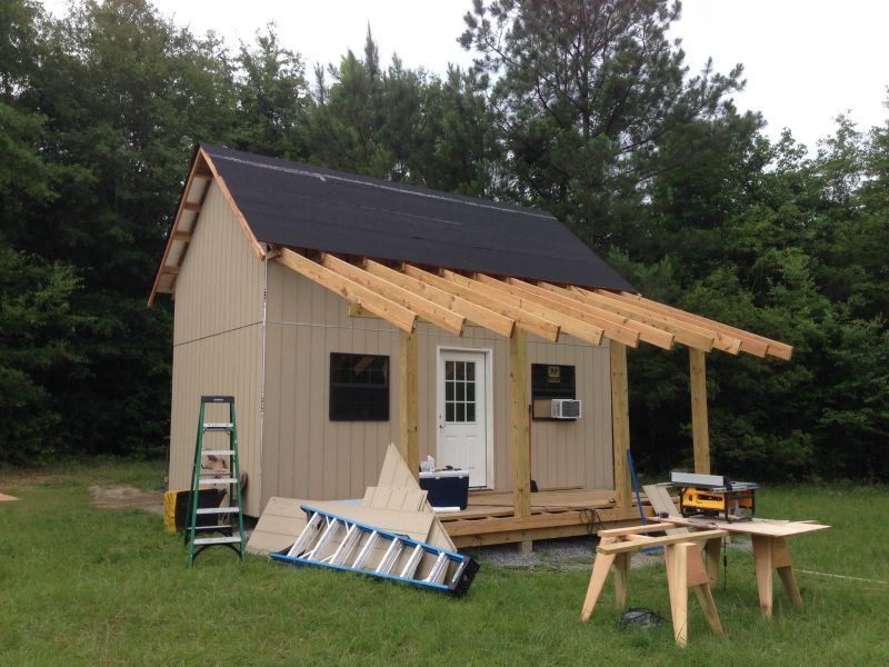

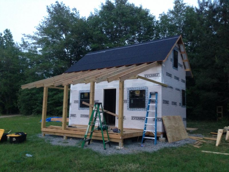

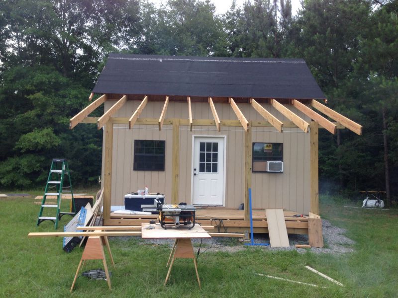

# Posted: 30 May 2015 23:49
The porch rafters were notched and attached. I had to do this myself but I got it done. These are 2x8 PT on 24" center with a nice overhang. I did later get some help from my son Cole and his friend Hunter putting in some hurricane brackets.![image.jpg image.jpg](https://www.small-cabin.com/forum/shared_files/uploaded/5642/82822_1.jpg) image.jpg

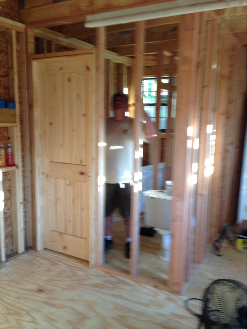

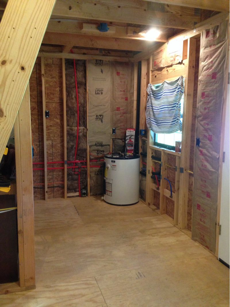

# Posted: 30 May 2015 23:52

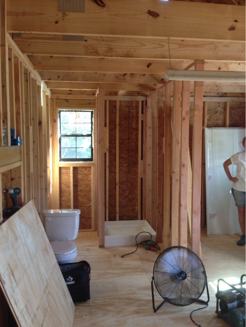

My mom and dad came in from Seattle to help. We were able to build the bathroom/kitchen walls, put in the bathroom door and start the wiring/pluming .![image.jpg image.jpg](https://www.small-cabin.com/forum/shared_files/uploaded/5642/82823_1.jpg) image.jpg

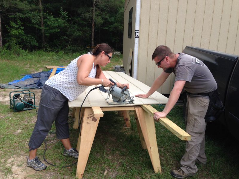

# Posted: 30 May 2015 23:56
Our friends, the Felhausens, came up from Florida to help with the siding. They did a great job!!!!![image.jpg image.jpg](https://www.small-cabin.com/forum/shared_files/uploaded/5642/82824_1.jpg) image.jpg

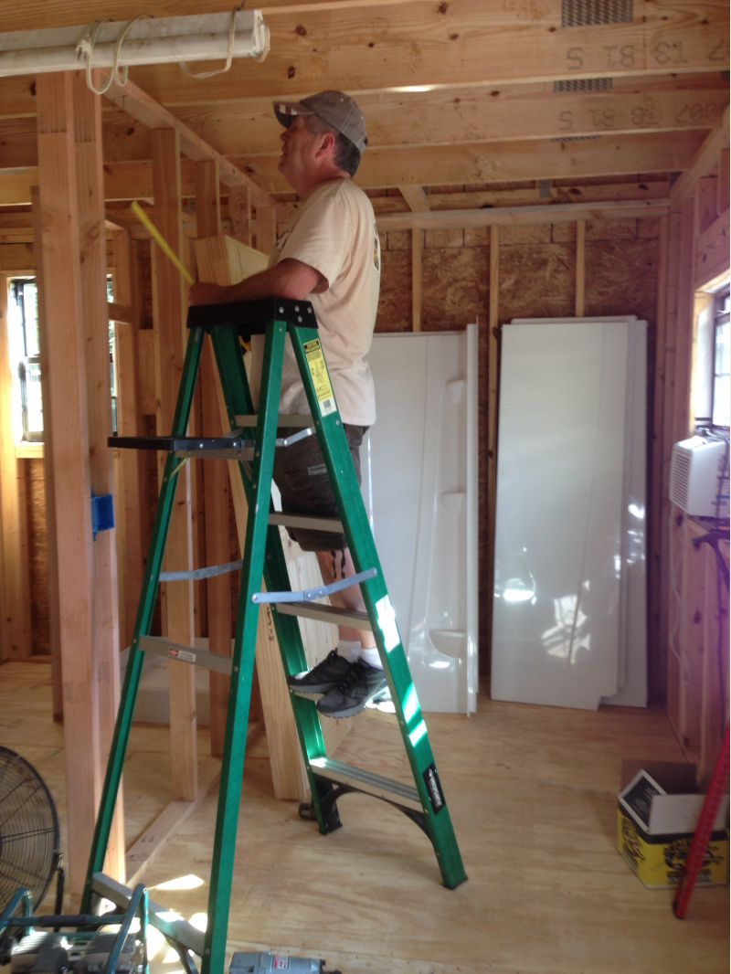

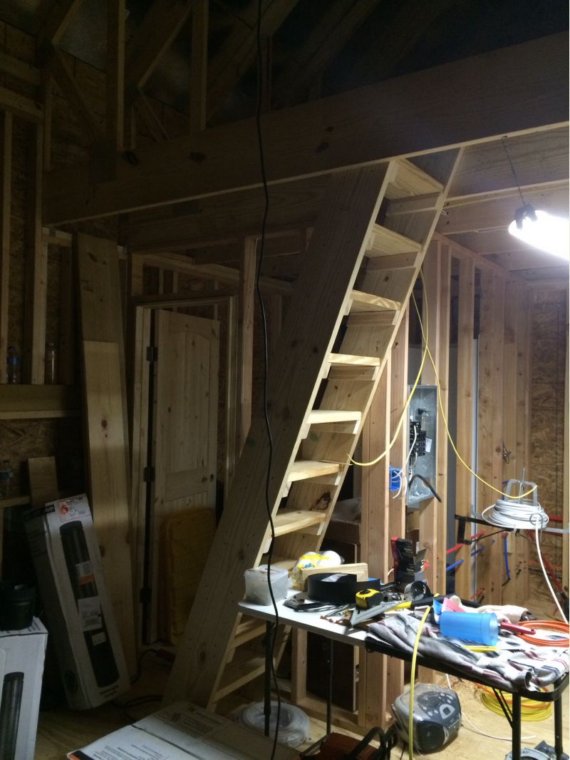

# Posted: 30 May 2015 23:59
We needed a ladder to get into the loft. It's attached to the front of the bathroom wall to save on space. Things are tight in a 240 sq/ft area.

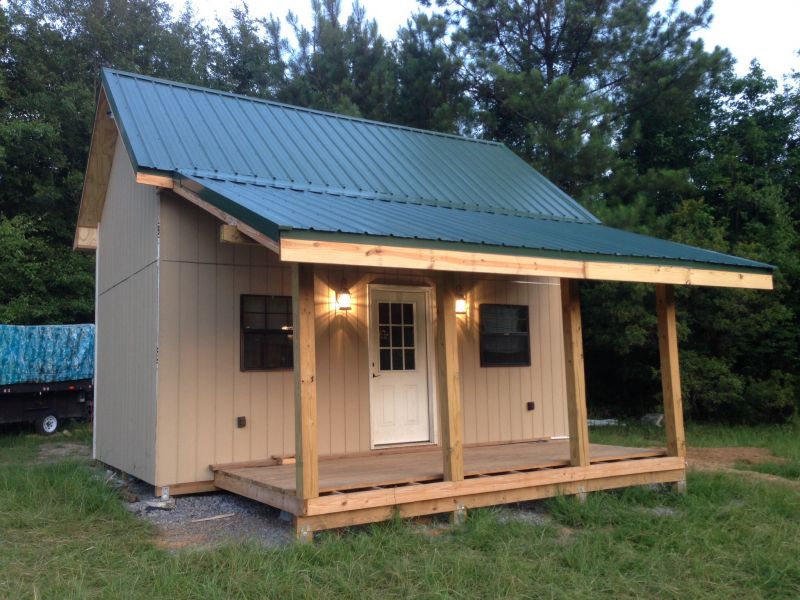

Pawag

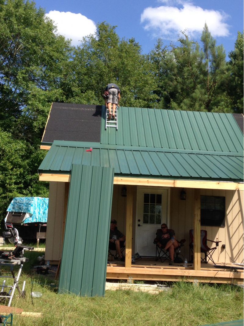

# Posted: 5 Jul 2015 18:57

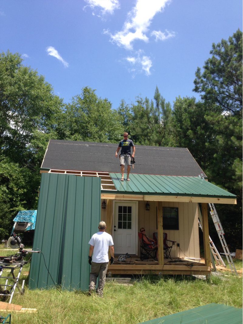

The metal roofing, fascia and soffit are in place. This is starting to look like a cabin now. Power is connected and that ugly temp pole can come down. Thanks to my good friends the Davis family, Brad Terrill and Josh Boyle for the help.![image.jpg image.jpg](https://www.small-cabin.com/forum/shared_files/uploaded/5642/84456_1.jpg) image.jpg

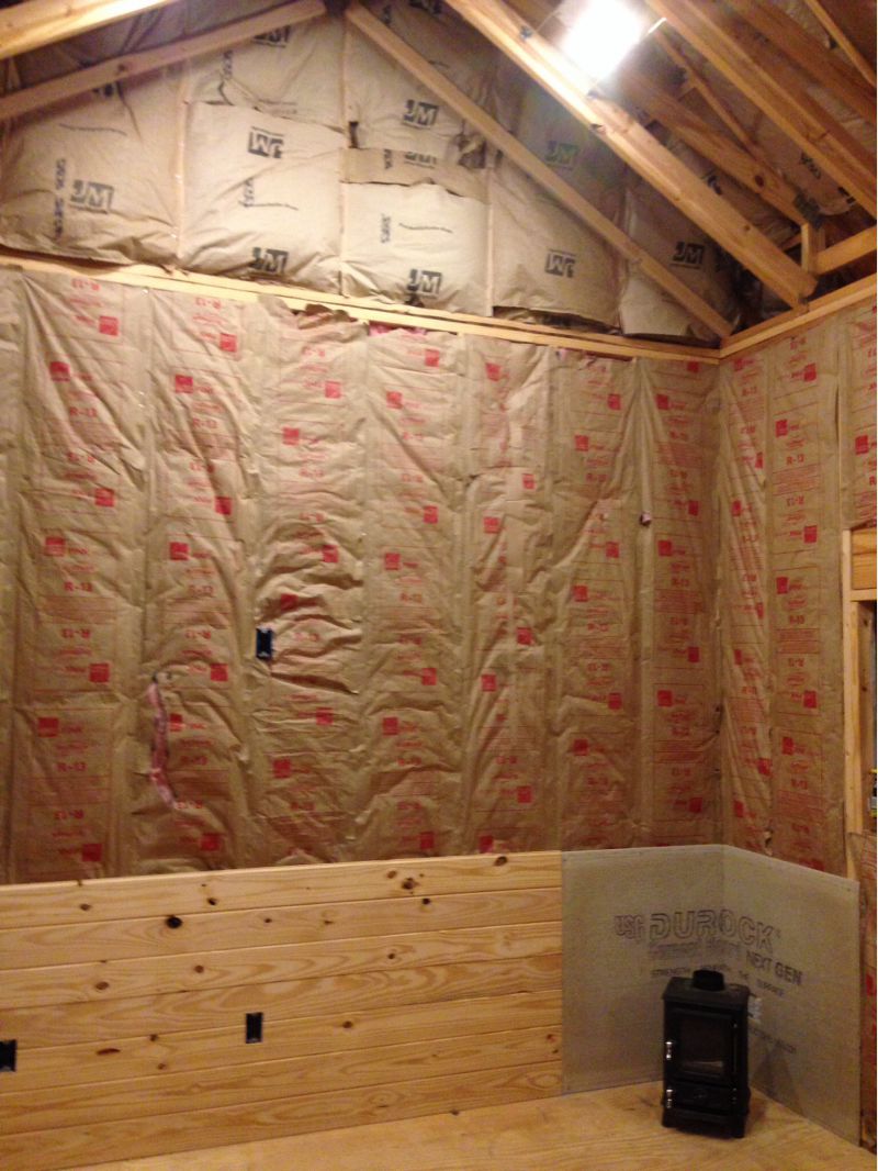

Pawag

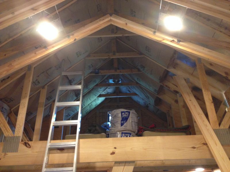

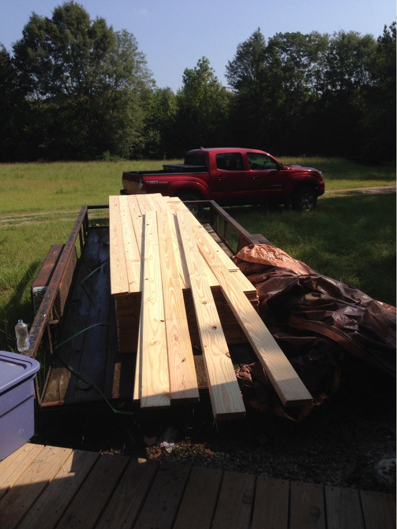

# Posted: 10 Aug 2015 14:09
The interior wood is in. A 6 hour drive, almost ran out of gas, one flat tire, 2 cans of fix a flat, trip to a back woods Alabama tire shop, mad dash to Walmart for a tarp so the wood didn't get wet and warp. 3500 lbs of knotty pine board. Here are a few new pics.![image.jpg image.jpg](https://www.small-cabin.com/forum/shared_files/uploaded/5642/85971_1.jpg) image.jpg
