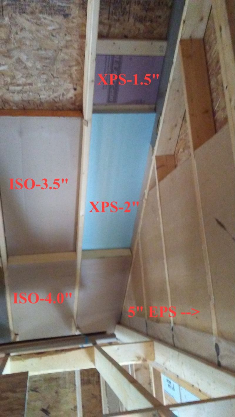

To answer your Q, My rafters are 2x8, 24oc, I used 3-1/2" & 4" PolyISO , although I did have to get a wee bit creative on the ends due to the way my fly rafters are set-in for the gables. No Vapour Barrier as ISO is Hydrophobic and breaths. I do have photos but not on this computer unfortunately.

Back Again... with photos too !
Gable End: The 4" ISO being set into place.

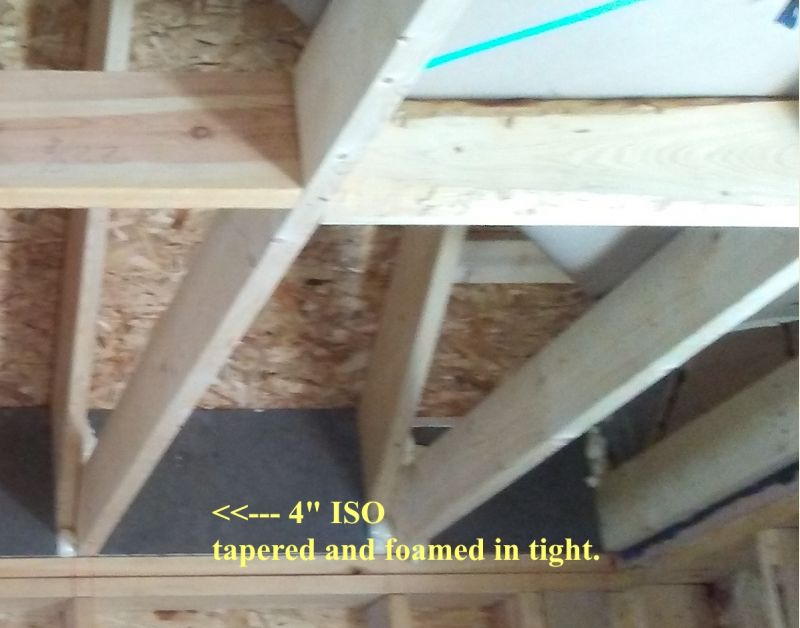

Wall @ Gable: Again 4" ISO tapered and tight

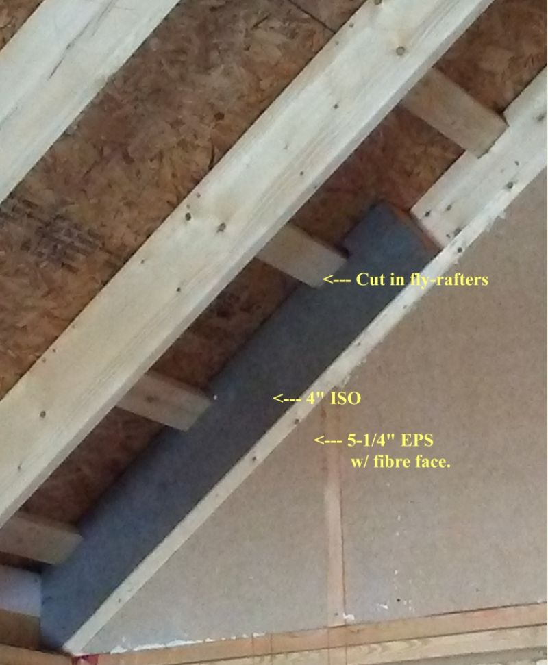

Insulation Detail @ Gable The tricky bit and PITA... Worked out great, all snug and well insulated. You can also see the Gable Wall showing the HD-EPS partly in place, that fibre on it also has insulation value, is fire retardant & not bug friendly either... no toxics in it!
Everything was put in "Very Tight" (think 2x4 or 6 & med sledge) then every possible crevice / nook foamed with a professional system (not spray bombs).
Really, it would have been much better to cut, & fit in the insulation during assembly as everything would have been much simpler and better "obviously" but this was my Bldg Inspectors 1st experience with such a build. So, Ces't la vie mon amis.

Couple things I noticed in the frame in those last three photos.
Oh and great thread, I snatched a few screenshots of your grey water system.
first photo I'm guessing that photo was taken before the inspection. There's no double top plate, and no drywall backing within 8" of the last supporting member.
Second photo No hangers ? That single joist doesn't qualify as an adequate beam in this application.
Third photo Corrections, same as the first Look outs/fly rafters look good, suggestion, they're more structurally sound in high snow load areas when placed on the vertical.

# Posted: 6 Jan 2023 02:31pm
All the exterior walls have double top plates, they are not necessarily visible in these pics.
No clue about what your talking about on photo #2
Also note that some of the pics are Pumphouse / powerhouse and not the actual cabin. which is a slightly different kind of build.
