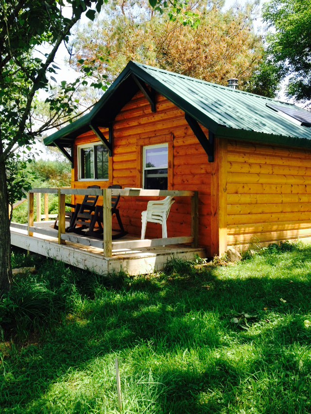

Hope it's thumbs up, since I don't know if I want the hassle of taking them off.
I have been thinking about adding these braces to the 4 X 4 overhang supports for a while. They are pretty cosmetic since the roof has held for 20+ years.
Now that they are up, I have mixed feelings. It does add some interest to the cabin, but it really says "OVERHANG" now. I get a little of the WWII German Bunker feeling. I think they might look a lot better after I paint them green like the roof.
Anyhow, gang. Thoughts?

I think details like that go a long way toward adding to the character of a building. Other people won't look at it as closely as you, they will take in the overall impression rather than scrutinizing a particular element, unless a given element is grossly out of place or proportion. Yours is neither, the braces go well with the siding, IMO, and give the place a rustic and craftsman appearance simultaneously. I prefer something to dress up even the smallest buildings to keep them from looking like plywood boxes.
German bunker? Last thing I would have thought.

were they needed or just cosmetic...??
sometimes less is better...the only one that looks OFF is the corner one.....you asked for opinion's ...and remember your's is the ONLY one that counts!!!!

Two thumbs up for me! Looks good and adds some character.

I think they look good. Try to picture in my head, without them there, and it seems like they were meant to be.

The problem is that your roof has different slopes, so the braces hit the wall at different heights. I especially wouldn't want to be looking out of that corner window and seeing those sticks in the way of the view. Even if you took off just the center one it would look better, but it still seems like a couple of sticks stuck on the side of the cabin for no reason (do you have to duck your head to get around that corner one?)

??? They may be the first things to fall off and hit you on the head in an earthquake.....

maybe if you painted them a different colour? the dark colour really bounces around off the gold wood. a bright white might be nice.

Rmak, no offence but IMO they detract from the clean, good looking build. If they are not necessary I'd remove them, if they are needed, then maybe something that matches with the log siding in colour & form so it blends in more naturally.

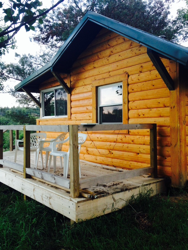

Thanks everyone. What a great site! I appreciate all of the input. And Steve, I will never take offense.
I'm going to try two more things because of the suggestions. I will build out the one corner with the long one to match the others so there is more uniformity in length of the braces, and I am going to put one on the peak.

OK, taking the offered advice I worked on my braces yesterday. I rebuilt the corner so that all braces were the same length. I also added one to the peak for uniformity. I think things look better and I'm going to paint them and live with it for a while. Input and suggestions always welcome.

My personal opinion is that although they look nice, I think it would look better without. Perhaps if your overhang was another foot or two out, they might fit in better, but to me, they seem like an after thought.

You are no doubt right, ColdFlame, but it's my nature to keep messing with things. I'm a landscape painter too and my wife is constantly telling me to stop and leave the paintings alone because I've been known to screw them up by overworking.

Actually, what was bothering me was the way they connected to the wall. It seemed like they were just sticks stuck to the side of the cabin, so I looked up "eave braces" on google and found these. There should be an extra piece of wood against the wall to transfer the load over more of the wall, and preferably another piece of wood at the top under the eave for the same reason. Although your braces are decorative, they were designed this way to help support the roof overhangs during excess snow load.

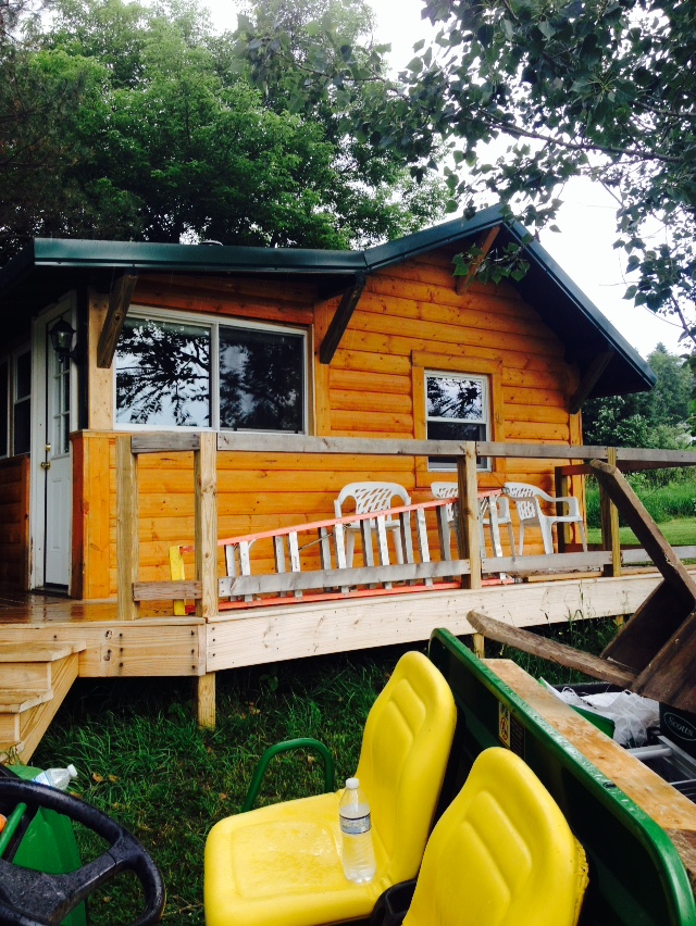

Last photo. I promise. I took rockies' advice and made the brackets more "brackety". I am all in with the brackets so they stay now. I actually quite like them. I should mention that the brackets are functional. The 4 x 4's that stick out 20 inches under the overhang are part of the original post and beam skeleton. They haven't bowed or sagged over the years, but extra support can't hurt.

EXCELLENT! Now those look nice. Well done!

RMak... Now that looks much better being more "brackety"... Gosh, now I'm thinkin of these things.... dang distractions...

Much better now - I retract my original opinion now that you've made them "more brackety".
