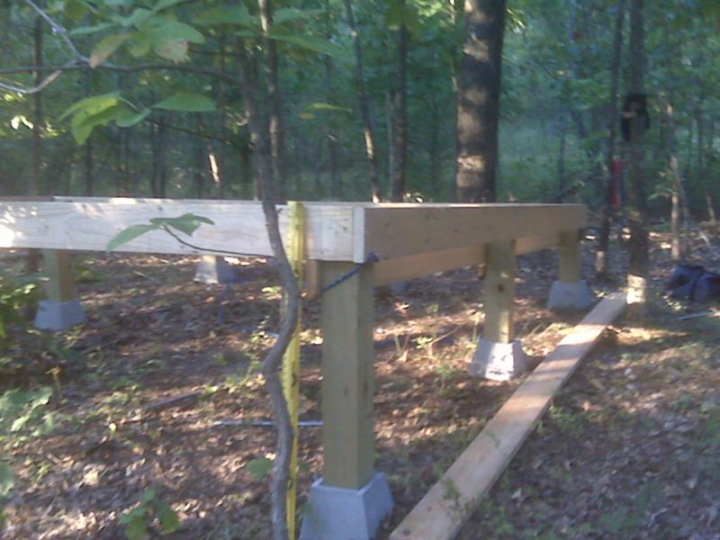

After a long wait I have begun my cabin. Saturday I bought and had delivered all of the lumber to build the post and beam foundation and to install the floor joists. I am typing this while sitting on the steps leading to the floor joists. What a feeling to see actual progress and to get a picture in my mind of the soon to be finished cabin.
I went with a 12x14 which will have a barn style double slope roof and full loft. The barn style roof will give me more head room upstairs and keep the loft from counting as a second floor by the county. This is important because under the requirements of the county and I will need no permits or safety inspection by the fire dept.

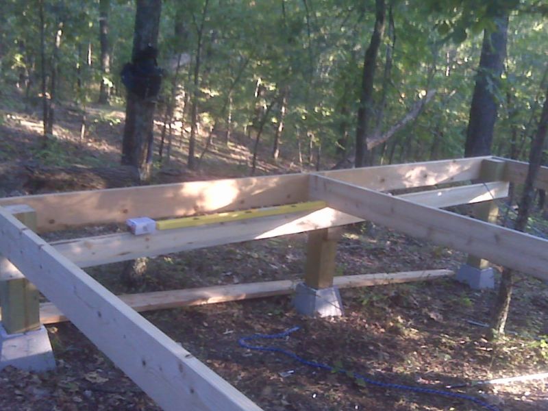

I went with a total of 9 peirs placed 3 down each side and 3 down the center. I place beams consisting of 2 2x6 one on each side of 6x6 posts down about 6 inches from the top. I then fastened the posts to the rim joists so that the beams are held to the posts and supported by the beams. The posts on the 14ft side are place 7 ftoot apart while the posts on the 12ft side are placed 6ft apart with a post in the center. The posts are mounted on big foot deck blocks.
While it is far from done there is no give in the joists even when jumping. 2x8 floor joists 12ft long supported midway does not seem to give at all in the 6ft span between beams.

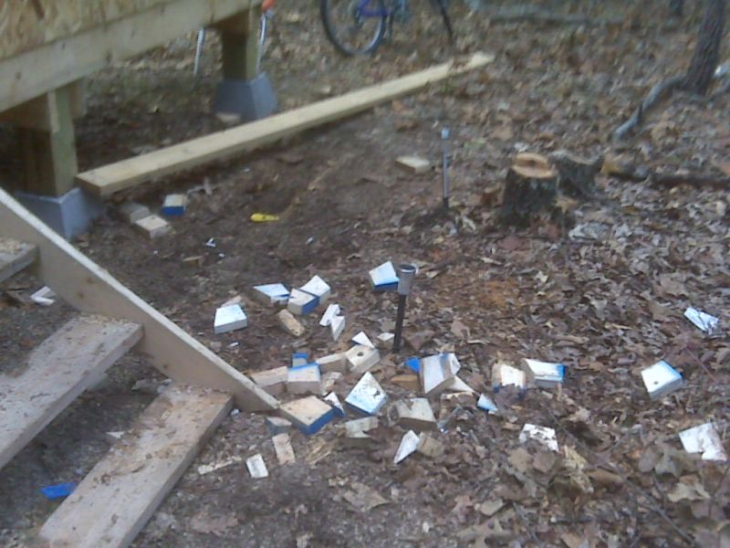

part of the drive I cut in
starting on floor loists
all four corners square

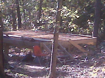

floor joists all in
floor joists all in

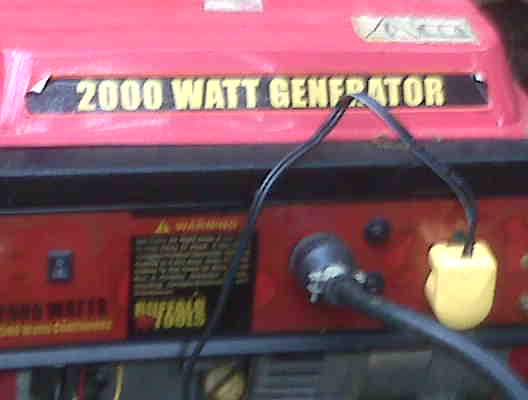

my little generator...

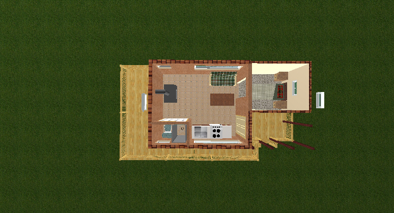

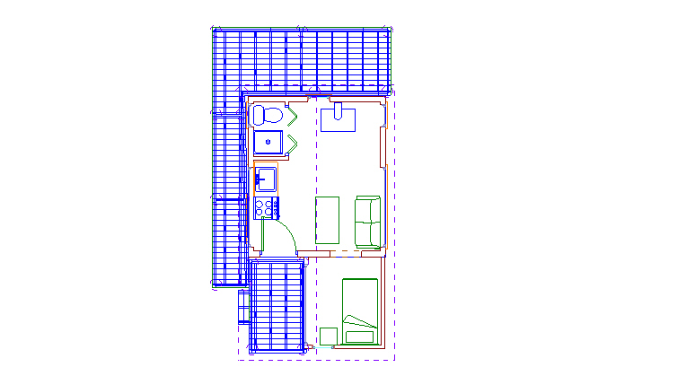

my intended finished floor plan

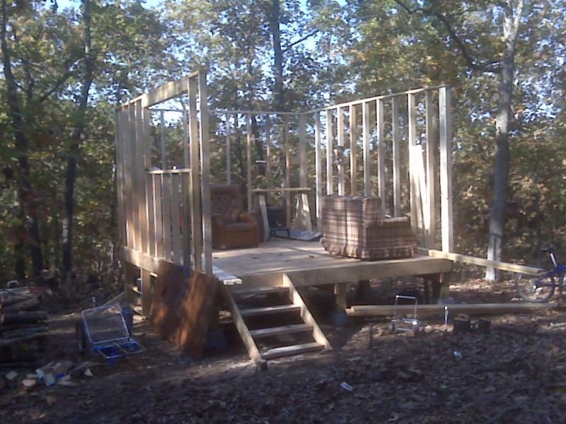

it's easier to put the furniture in before you put up the last wall..

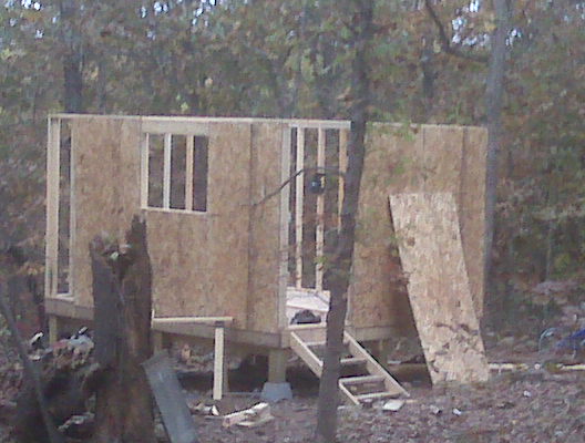

putting the osb on the walls

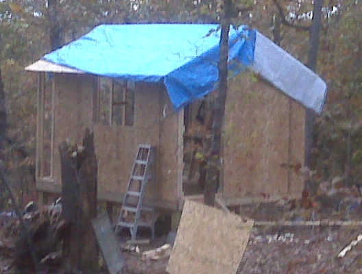

osb on the roof just before it rained.

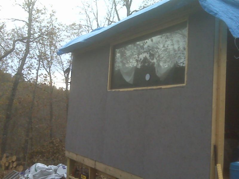

the window is actually a sliding patio door turned sideways

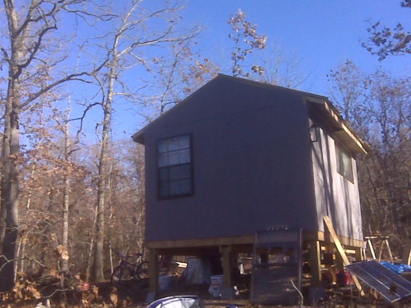

painted the osb so it will last till the cedar shake goes on the walls..

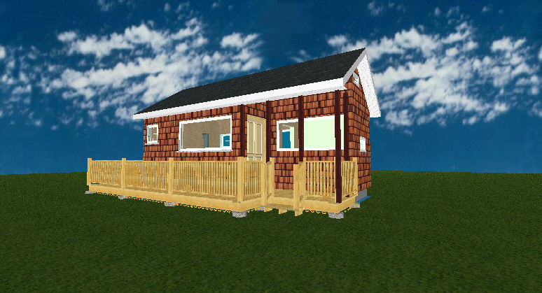

this is what my cabin should look like when I get it done. I hope to finish it this spring by adding the bedroom and deck.
exterior view
exterior view
top off view
top off view

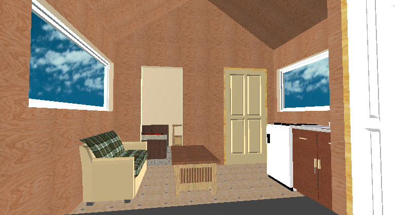

a modeled view from by the wood stove.

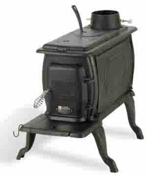

the wood stove I put in. it works great here
