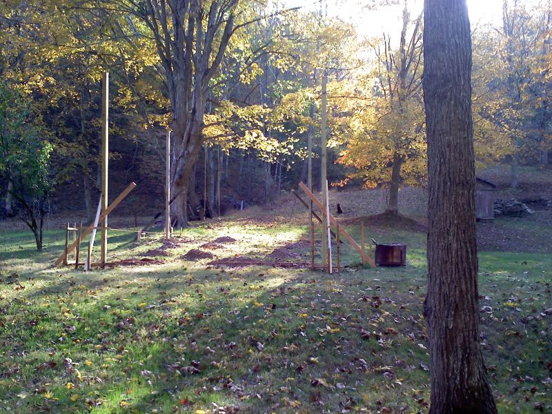

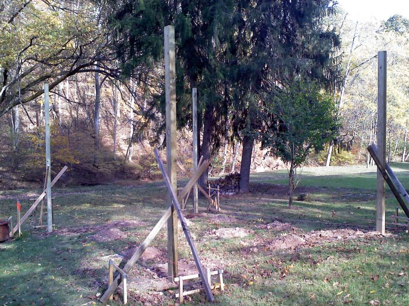

Starting the cabin!!!
Got the corner posts up..
adding some pics..
Anonymous
# Posted: 11 Oct 2010 11:57pm
Nice looking site, how did you fix your posts into the ground?
I look forward to watching your progress.
Anonymous
# Posted: 12 Oct 2010 11:26am
Holes dug 4 ' deep . 1 bag of cement in bottom of each hole for pole to sit on . After poles set in correct position, filled rest of hole with soil.

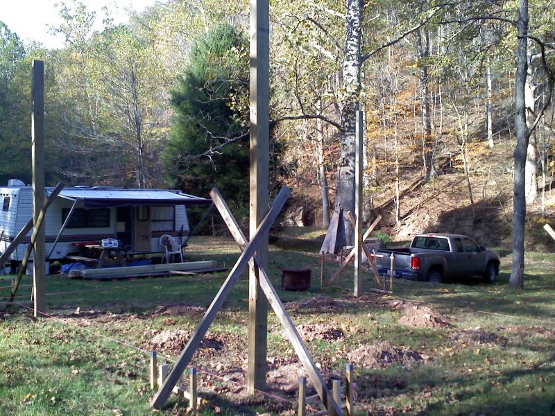

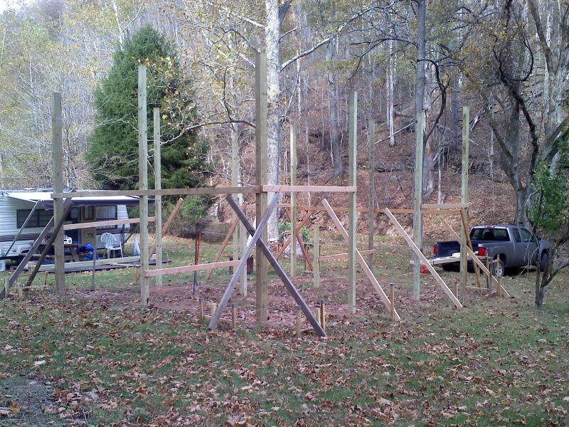

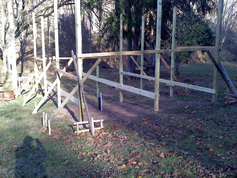

# Posted: 20 Oct 2010 09:29pm
Got all posts set this week.
still working by myself. hopefully get more done soon.
Took a few more pics.

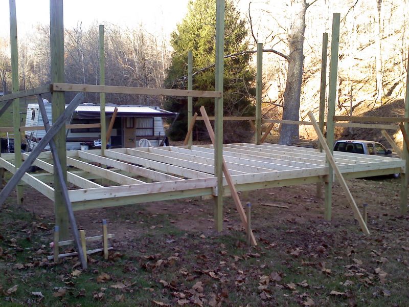

shotgun
# Posted: 28 Oct 2010 08:26pm
Dug lines and installed water pipe and drains today
Cleaned up all extra dirt and rocks left from digging posts.
Nailed on boards for floor joists to set on .
Cleaned out camper and raked some leaves.

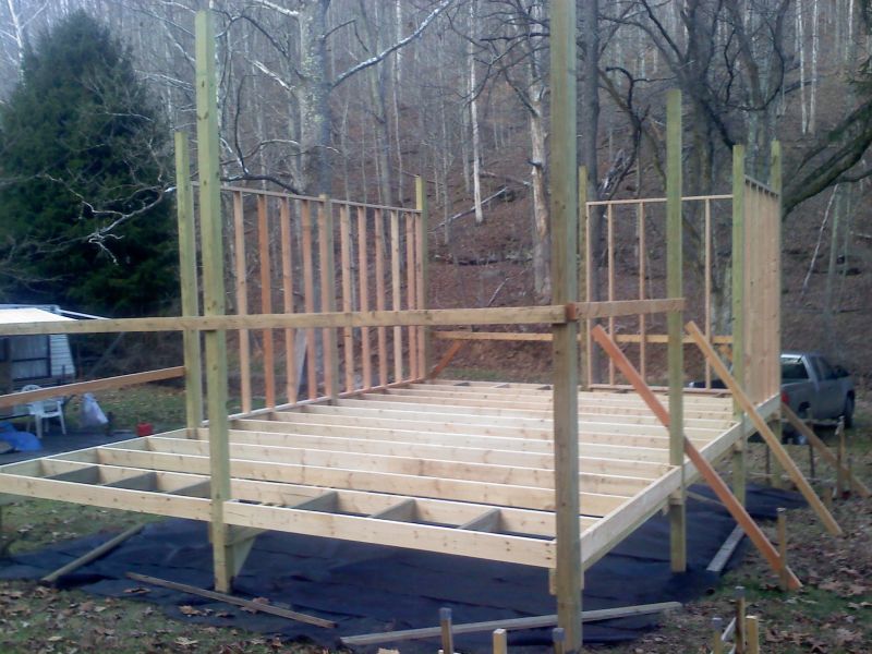

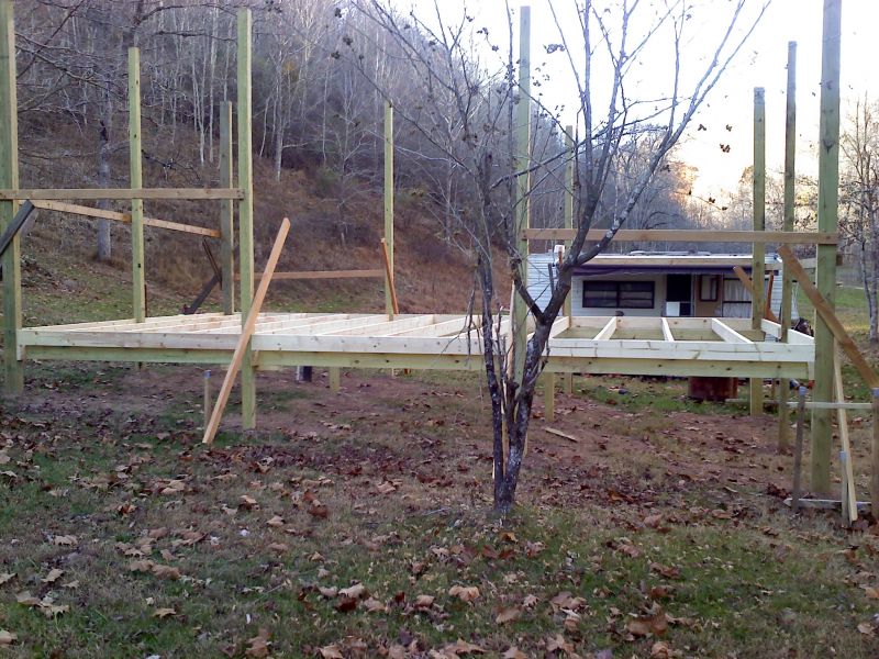

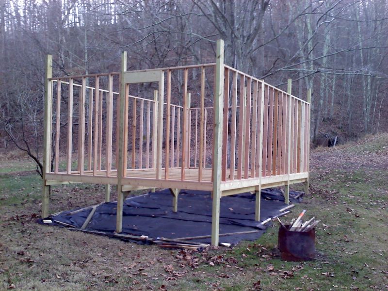

shotgun
# Posted: 12 Nov 2010 09:47pm
Its been 2 weeks since i have been back to cabin
Got all floor joists done today.
It was unuseally warm today, went from frost in the morning to 70 degrees. Was a really nice day for working.

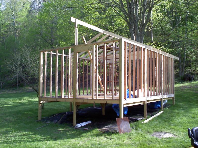

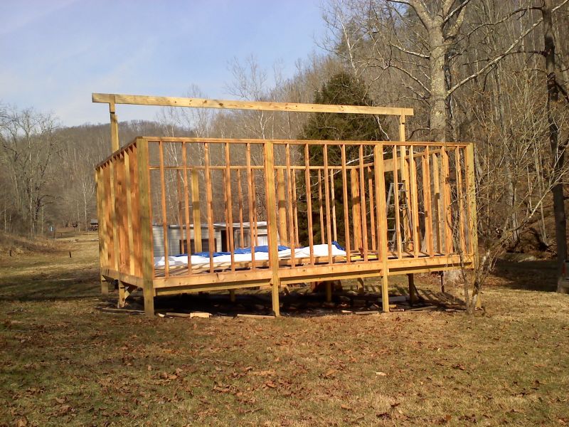

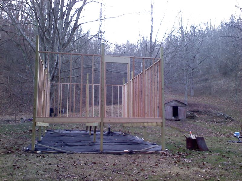

shotgun

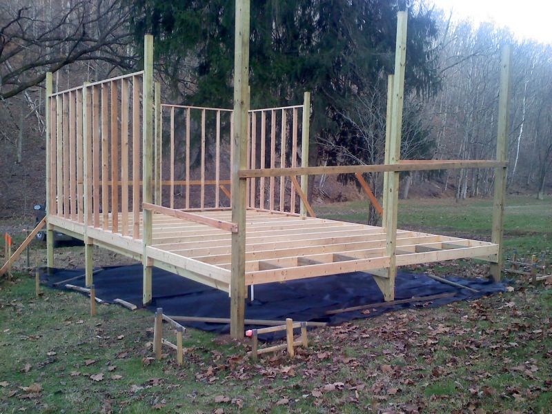

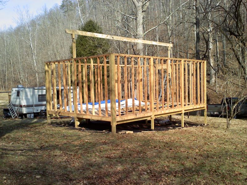

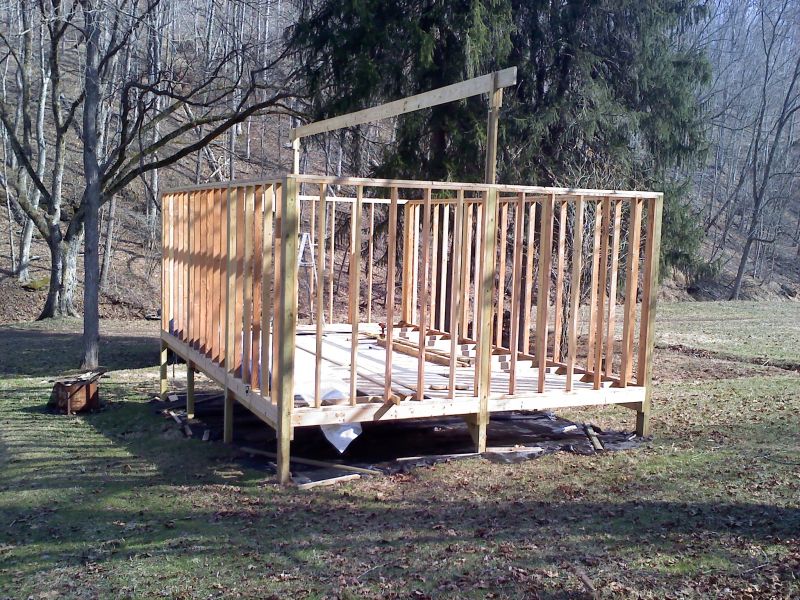

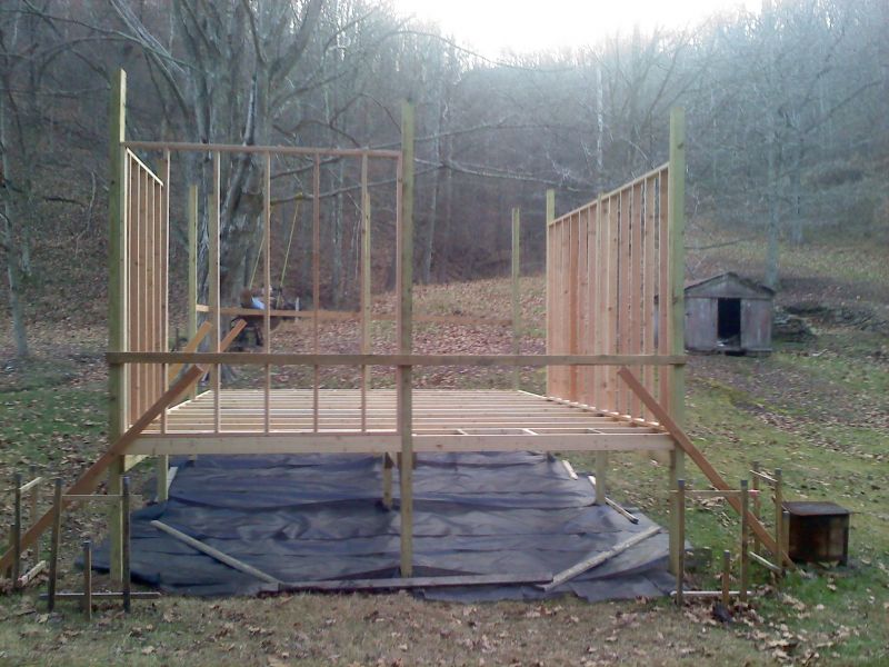

# Posted: 28 Nov 2010 10:08pm
Went down to the cabin sunday and finished putting up all the walls

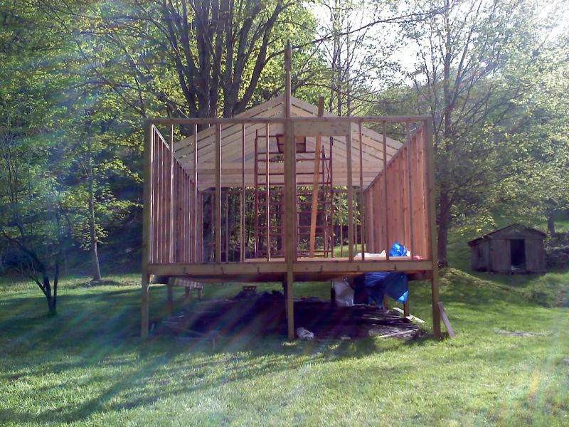

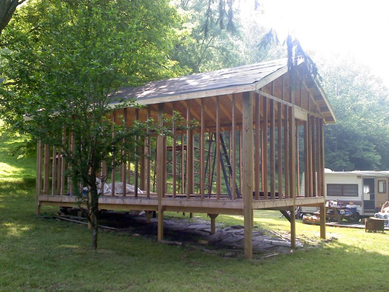

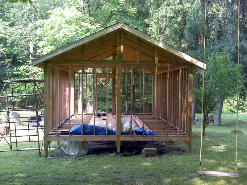

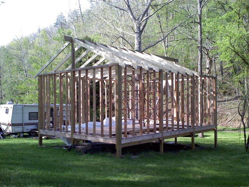

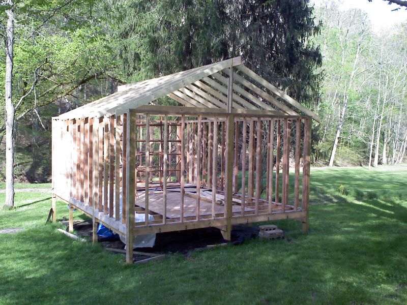

# Posted: 30 Apr 2011 11:00pm
Finally got back down to cabin to do some work. Mowed grass and put up some rafters

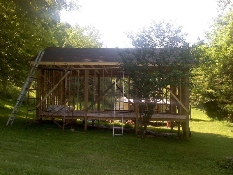

# Posted: 10 Jun 2011 12:13pm
Back down to do some roofing. It was in the mid 90s , much to hot for me. Need to do some mowing to but dont have enough time.
Will have to get it next time.

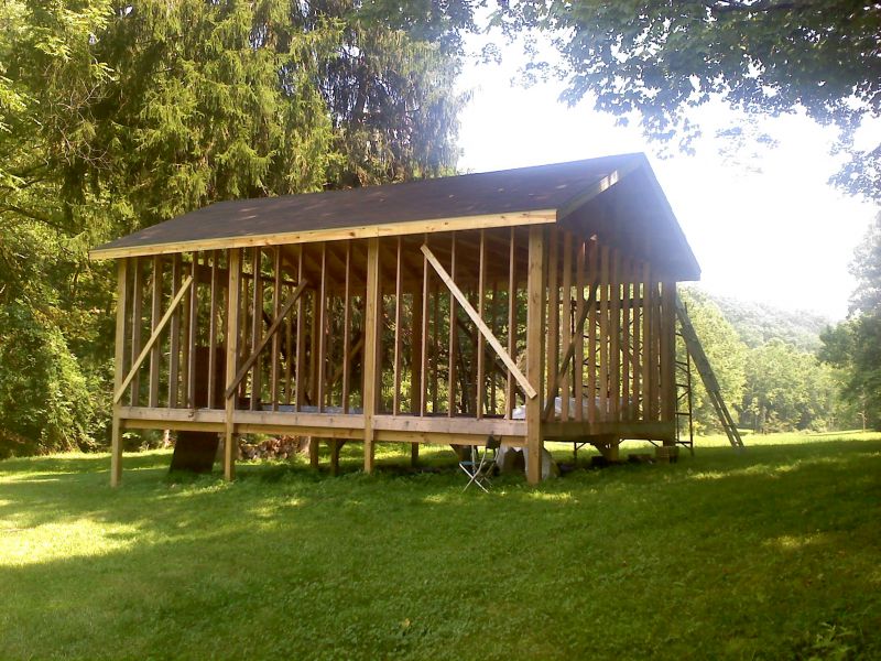

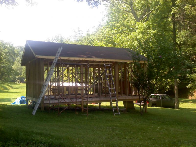

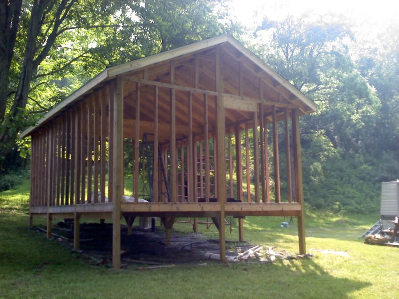

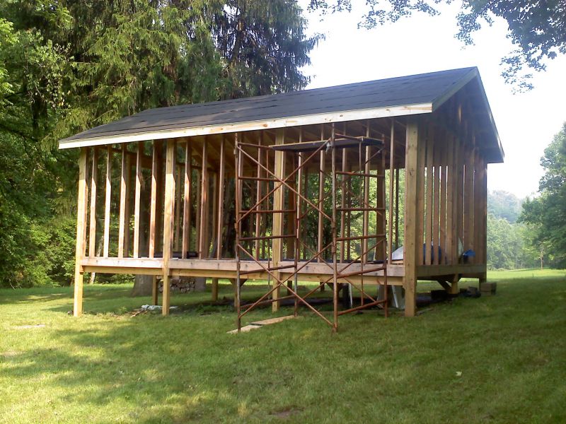

# Posted: 7 Jul 2011 11:03am
Worked on cabin again this week putting down shingles stayed overnight and did some mowing also.
