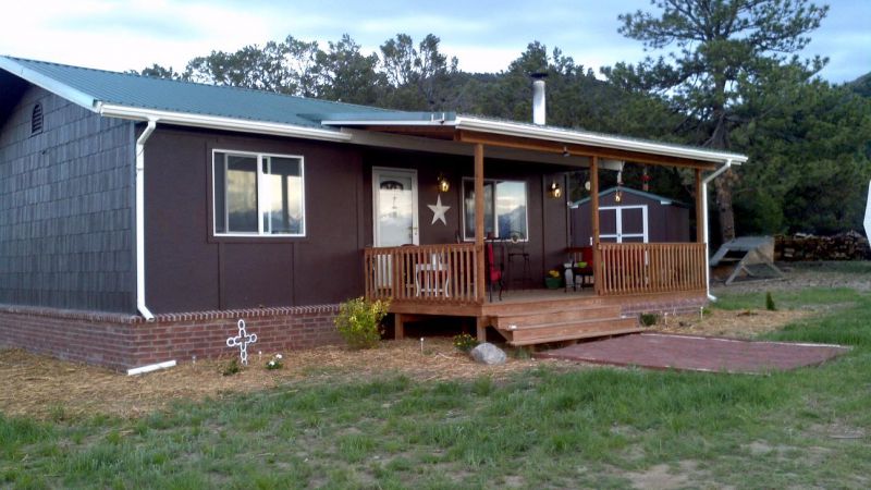

My house and solar array. House

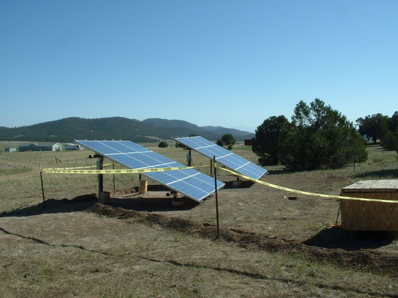

|  Solar Panels

looking good. that's quite the solar system. what amps/volts/watts are you at.

48VDC System 4800 Watt PV 1600(750) Watt Wind Turbine 415ah (20KWH) Full River AGM Battery MagnaSine 48V 4400 Watt Sine Inverter/Charger Xantrex XW MPPT 60 150 Controller 50 gal 240VAC water heater 240VAC GE Stove 240VAC Baseboard heaters 120VAC Dual purpose heat pump split units
