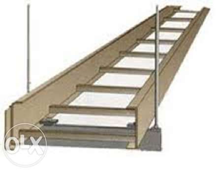

 I used two 20' x 30 inch, I think they are called wire ways/cable ladders for carrying large wires runs in factories. They are aluminum and very light. I have them laying side by side with some planks running up the centers. They will hold my atv .  I have no pics ,but this one is very close to what I used....the previous owner has left several of these on the property.

 Quoting: Jebediah I used two 20' x 30 inch, I think they are called wire ways/cable ladders for carrying large wires runs in factories. They are aluminum and very light. I have them laying side by side with some planks running up the centers
 I’ve been looking on Kijiji and Facebook marketplace for used cable trays for about a year and a half. Really hard to come by here.
 Also been watching for long open web metal trusses / joists.
 Maybe I’ll try a scrap metal dealer.
