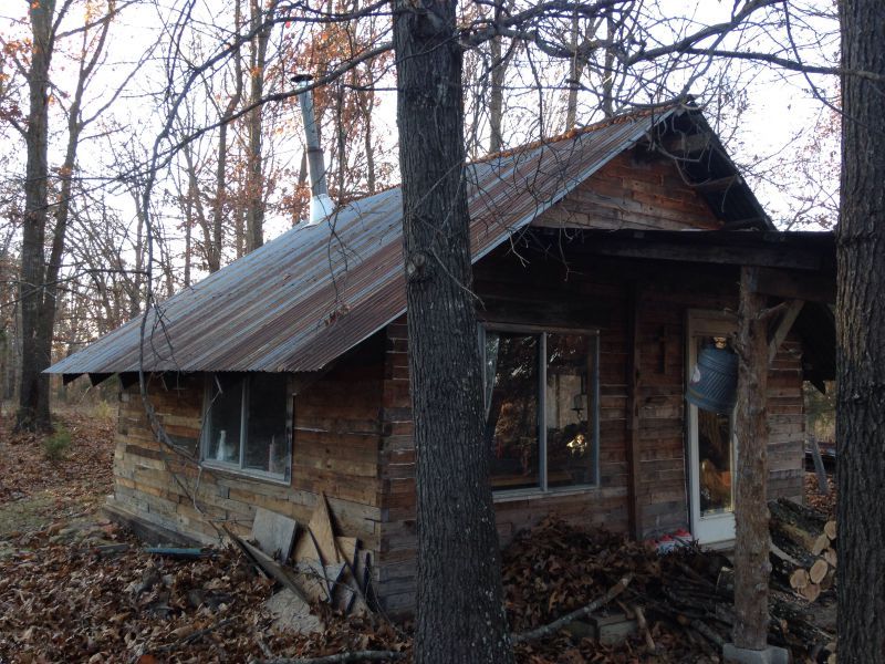

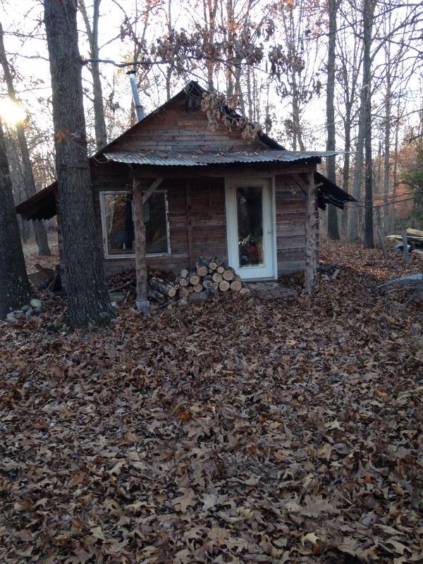

I am new here, I have just been reading through the topics and it seems like a nice community. I am headed to my off grid cabin for the weekend. I was looking at some of the lighting threads. I mostly use candles. Any way I thought I would just say hi and post a photo of my cabin. It is about 16 x 16 feet
littlehouseontheprarie
# Posted: 16 Oct 2015 09:48pm
Yep that is a cool old Ozark cabin.
I would love to see more pics. some interior and some of what I am sure is a beautiful view.

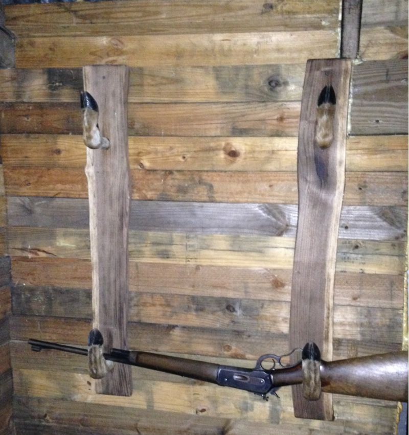

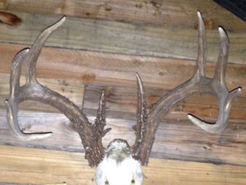

I have just a couple of the decorations , I will try to take some more this weekend.

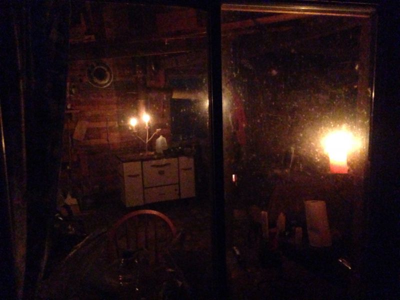

I found one more, I took this one through the window in the dark

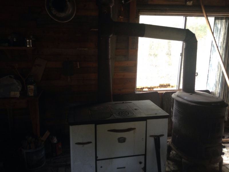

The stoves

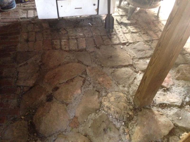

We did the floor in field stone and salvaged bricks. I swept dry quickcrete into the gaps and wet it down with a hand sprayer.

It's hard to believe that your cabin is only four years old. It has that wonderful "moonshiners cabin" look. I thik it looks perfect for those ozark hills!
Derby42
# Posted: 22 Oct 2015 01:10pm
The trick is to build it out of really old junk, ha ha. I actually spent very little on it. The foundation is 8 railroad ties from the local hardware store. The walls are pine 4x4's that are only three feet long. They were scrap from a company that uses them to stack bundles of pipe on flat beds. I just stacked them up like bricks, wood glue between each and nailed together with sixteen penny nails. The rafters and tin were from an industrial chicken house that burned and was reused as a shop for another 35 years before we tore it down and made the cabin. The windows are old single panes that dad took out of his house. So it is really just a combination of old junk. Sure is a nice place to spend the fall.

Thanks , I really enjoy my time there and only spent a couple of hundred dollars building it. The wood cook stove was setting out behind dads barn with a sheet of tin over it. Looks a lot better in a cabin. It was really made for coal I think, has a very small fire box

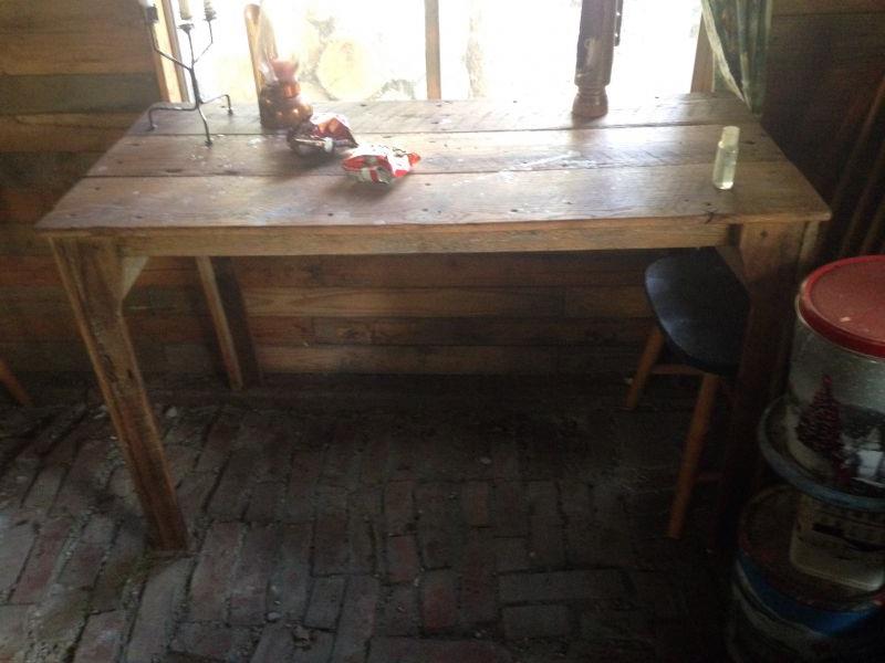

This is a photo of the table. My brother made it out of some rough sawn oak off of an old hog farrowing house we had. It made a really nice little table for the cabin. We put bricks salvaged from the concession stand at the old drive in theater under the table and the stove so we could have a more level surface.

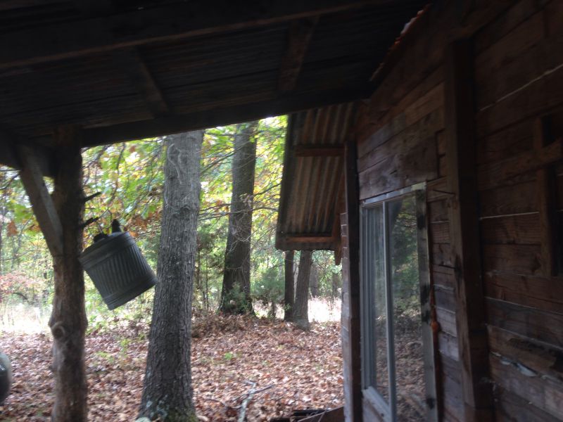

Here is a photo from the porch. I used to have some squirrel tails and a deer tail tacked on the wall but that kind of stuff doesn't last too long out side like that. I used to smoke and I would put my butts in the metal can, can't be too careful in the woods with fire.

The cabin and pictures DO have a character...
