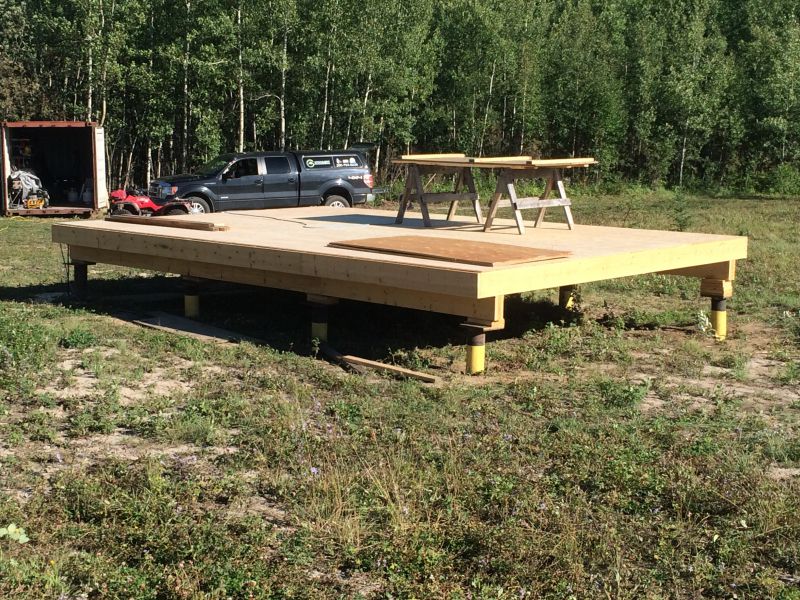

Here are a couple pics of my cabin build. We've had the property for about 9 years and finally pulled the pin on building this past summer. The 40 year old truck camper was getting, shall we say, a bit old.

Can you tell us more about the foundation? What is it? Is that concrete tubes or some helical piles or..?

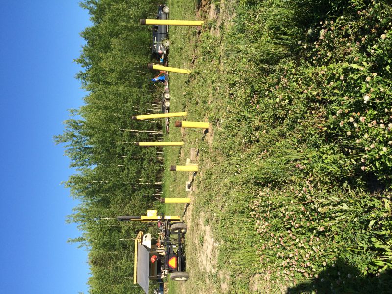

Greenland South
# Posted: 11 Feb 2016 11:27am
Quoting: Nate R
The foundation piles are surplus gas line piping I picked up at an auction. They are all about 12' in length x 6"I/D. I bought a post hole auger for the tractor with a 9" bit and drilled down about 4'. This gave me enough clearance to use a tow behind post pounder that I borrowed from a buddy. I managed to get them down roughly 10'. Took me a full weekend to get them in at 1-1/2" per stroke. A couple of them might have hit something going down, the went in a bit crooked. I still have 16 more to go in for the wrap around deck. It was a lot cheaper than the 5K I was quoted for screw piles.
Greenland South
# Posted: 11 Feb 2016 11:29am
Sorry about the sideway pic.

$5K for screw piles? Did that quote include piles for the deck, of was that just for the structure alone? (I'm considering them as an option for my future cabin build)

That quote was for the deck as well.

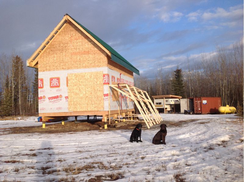

Went out to the property today to have a look around and put up some A frame
scaffolding that I built at home. Want to get the soffit done before the birds start nesting and the bats come back. Hope to get a bit done this weekend.
Wish I'd had a bit more time this winter to work on the place, because we haven't had much of a winter. As you can see in the pic we have no snow and temps have pretty much hovered around the 0*c(32f) mark all winter. +5c today. Last year we had over 2m(about 7') by now.

# Posted: 3 Apr 2016 10:45am
Have all the gable tin on and soffit up all the way around. Bat and bird tight I hope. Start installing windows and doors next.

How are they connected to the posts, or are they just sitting on it?

I welded 1/2 plate to the top of the post and bolted to the beam for now. Have the straps to put on yet.
Screw piles are just pipe with a helical welded to one end a couple holes drilled in the other end for the drive to fit on. Come in pretty much whatever length or diameter you want. Limiting factor is the machinery used to drive them.

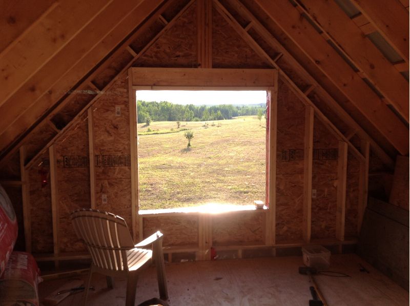

i haven't been out much this summer. Fires and evacuation orders earlier this spring and now unrelenting weekend rain. All the windows except the heavy one and front door in. Hers a pic from the loft, finished framing it this morning. Now I need to recruit a few buddies to help. null
Greenland South
# Posted: 11 Aug 2016 12:42am
A couple more pics of the deck piles and cabin.

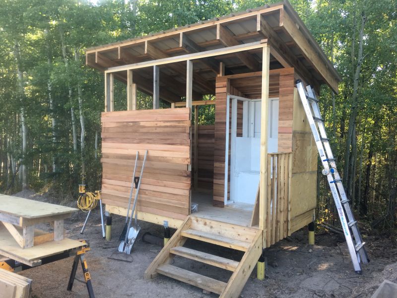

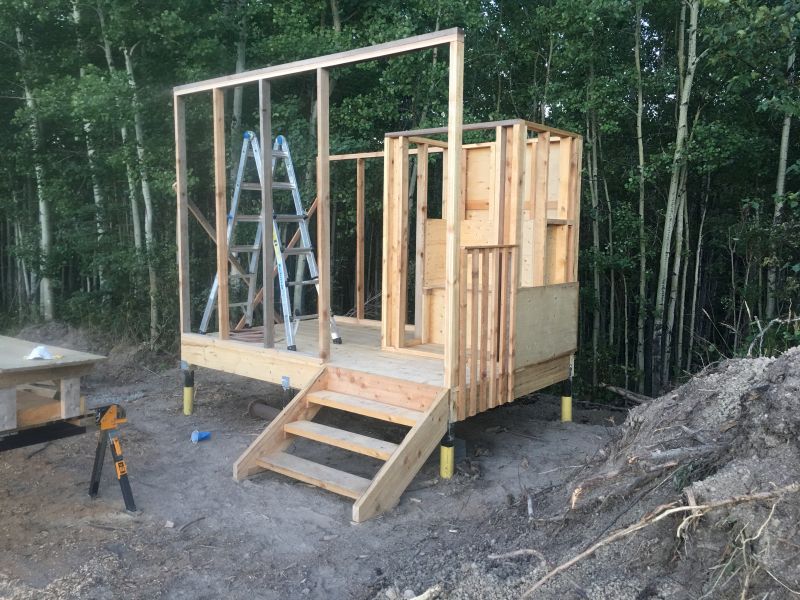

Started on an outhouse and shower room. All the framing is being milled from recycled cedar power poles.

Hey may I ask how you built your saffolding around your cabin. This would Work for me for my future cabin. For working on it with my prosthic leg for climbing
Greenland South
# Posted: 7 Sep 2017 10:06am
Built the scaffolding out of scrap 2x4 material. They're an A frame type scaffold. Nice thing about them is you can build them to what ever height you like, and cut them shorter as you move down the wall. You can call these pieces kindling.
The safety police will be along shortly to warn us of the dangers of this system. There are literally thousands of pics on the internet of these scaffolds

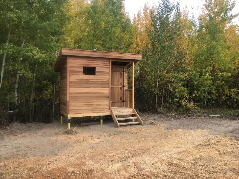

Greenland South
# Posted: 18 Sep 2017 10:00am
Managed to get a bit more of the outhouse done this past weekend.
smallcabin
# Posted: 18 Sep 2017 03:56pm - Edited by: smallcabin
I like your outhouse and shower combo. GOOD JOB! A couple inside pictures would be nice to see?
Greenland South
# Posted: 18 Sep 2017 06:52pm
"A couple inside pictures would be nice to see?"
Not much to see yet. Now that the seating arrangements for the daily constitutional are done, it will be next spring before the interior gets done.

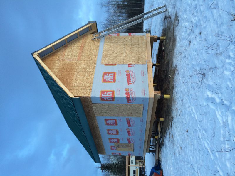

# Posted: 18 Sep 2017 07:03pm

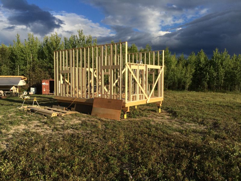

I noticed in your third picture you have large support posts for the ridge beam coming down onto the loft floor at one end of the cabin and onto the top of the main floor wall at the other end. In the second photo I can see that there is just a single king stud next to the large door opening underneath this post (can't see the other end).
Did you beef up the first floor wall framing and the loft floor joists under the loft posts in order to transfer the loads all the way down to the foundation?
"Greenland South" as in actually Greenland?
Greenland South
# Posted: 19 Sep 2017 01:50am
Hi Rockies
Under the support post at the rear is a 3 lam 2x10 sitting on top of a 2x6 framed wall. Under that wall the rim joist is another 3 lam 2x10.
At the front there is 10x10 beam sitting on top of the 2x6 wall. Under that wall is a 3 lam 2x10 rim joist.
The framing was changed a bit after those pictures were taken.

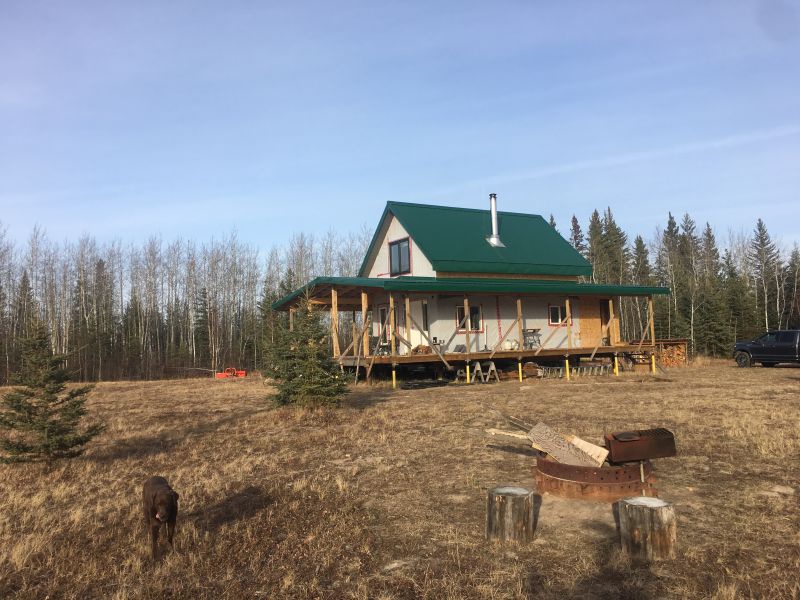

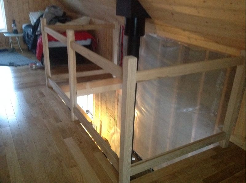

# Posted: 18 Feb 2018 09:19pm
Finally pushed my way in th the cabin. Lots of snow. Working on the railing around the loft this weekend. Beautiful day here. High cloud -15c

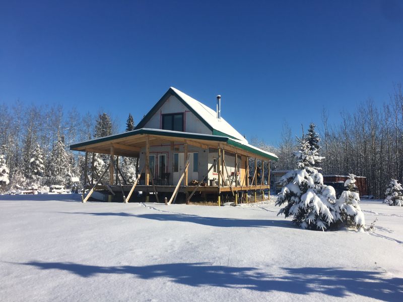

Greenland South
# Posted: 27 Nov 2018 09:10am
Getting there.
