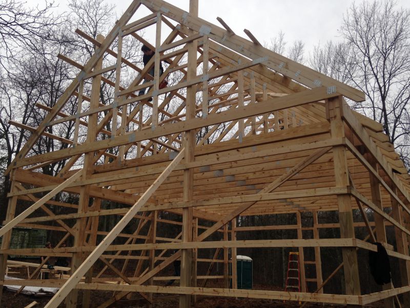

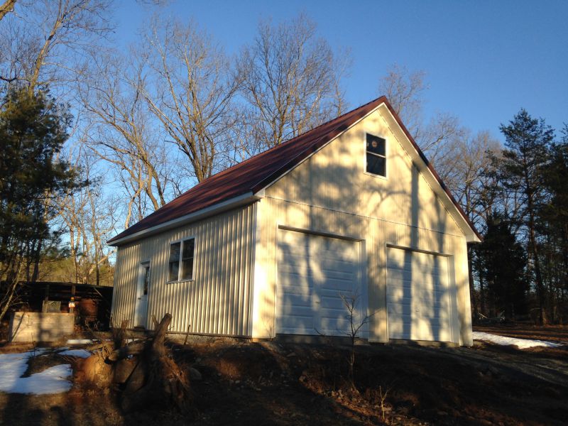

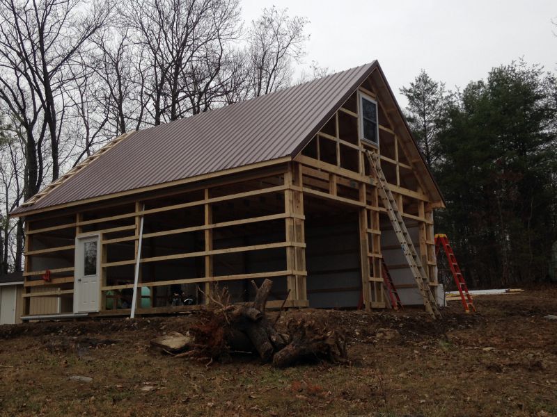

Just got my garage finished at my cabin property.
I know people share their builds as they go along, but I'm doing it all at once.

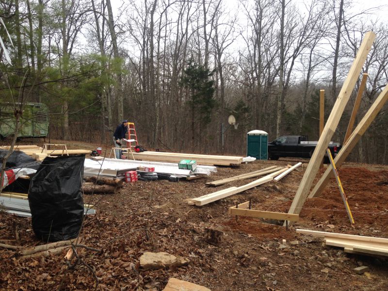

I learned a few things along the way: * plan for water, electric and a drain in advance. * although I contracted this out, I had to be there to wait all day for the county inspectors. * big trucks carrying big joists make big ruts in my road. Talk to the contractor about who's responsible for road damage. * building elevations are sometimes different in the end. Plan for water drainage (French drain), and a ramp with gravel to get into the garage.
Over all, I'm happy with this little pole barn. 20x32, with a walk in loft.

Looks like you have attic roof trusses. Would you know how much they added to the price over conventional trusses ? I also need to build a barn/workshop/garage building but did not price anything yet. I also would like to stay around the size you have. I was thinking 24 X 32 or 40. I also need to decide over footer style stick build or pole barn type. Thanks for the pictures and information.
RichInTheUSA
# Posted: 10 Mar 2016 07:15am
Yes, attic roof trusses. There are stairs in the back of the building to the loft. Unfortunately, I don't recall how much more that was... my wife and I decided we wanted that early in the process, so the contractor didn't quote us without it

Looks good. I do like attic trusses. If they spring from the overhang it can make a little more useable width upstairs.

One more "lesson learned"... I may have made a mistake by not getting gutters on it. I do plan to put gravel along the perimeter and directly under the overhangs.
But as I said... so far very happy with the project outcome.
