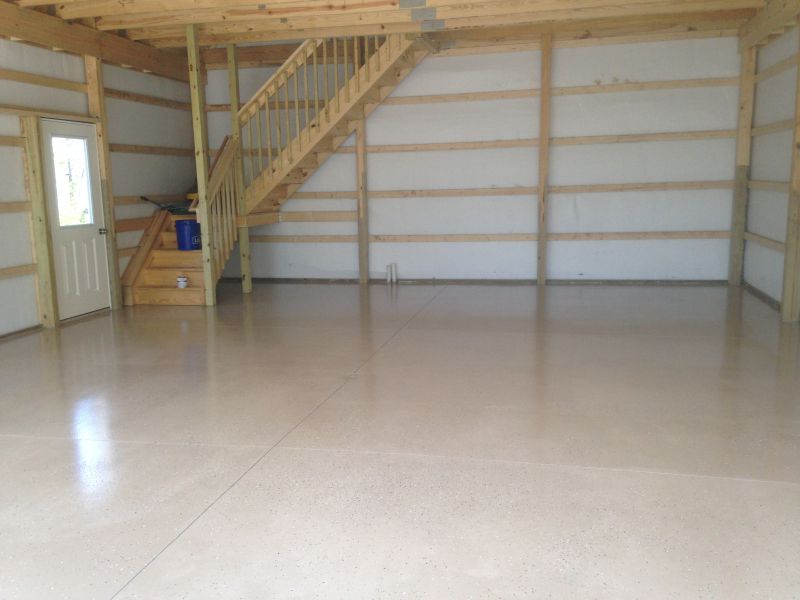

Finally got to complete my garage floor project. I used Lowe's Rust-Oleum 2 part epoxy paint, with no-skid additive, and then put the sparkley flakes down. Not too bad. The product says it only needs one coat of paint, which looks to be true once you put it down.... but after it dries, you can see some of the markings from the concrete. For whatever reason, my concrete slab had a blue tint to it... Anyhow, I'm happy with it.

That floor looks pretty good for the single coat. I'm curious, was there any form of sealer on the concrete or just raw ?
What kind of prep did you have to do ?

RichInTheUSA
# Posted: 25 Apr 2016 10:30
Littlecooner... thanks for the info on the carpenter bees. I'll definitely take a closer look.
Steve... there was no sealer on the concrete at all. In fact, the directions said it needed to be put down without a sealer or else the epoxy paint would not stick well.
The prep was to use a citrus based acid (which was included in the kit). They did not recommend Muriatic acid, which is the usual stuff.
I power washed the floor a good 6 times, with a good scrubbing with the acid and a broom in between. It was more work cleaning the concrete than actually painting it.
You may have to use muriatic acid to get the sealer off... but you also need to rinse well. Does your cabin slab have a drain?
