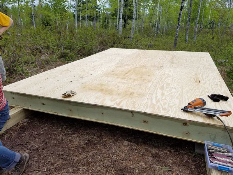

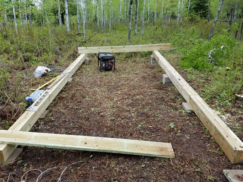

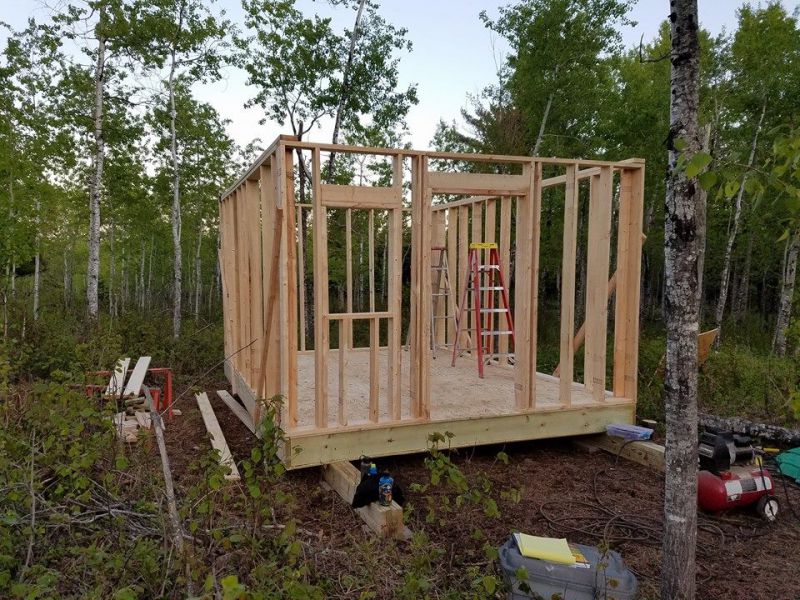

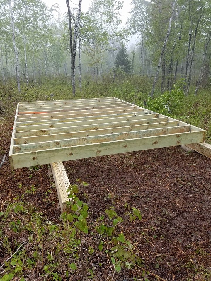

Just got back from twelve days on the land, and we have a pretty good start on our cabin. I started with skids and 2x10 treated on top. We put treated ply underneath, insulated with fiberglass, and then T&G plywood sheeting. Sealed the gaps and seams with Great Stuff, PL Pro on all the sheeting.

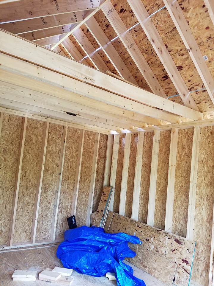

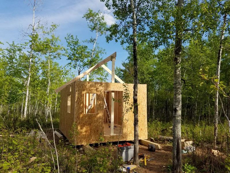

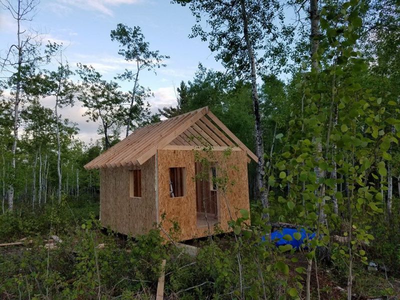

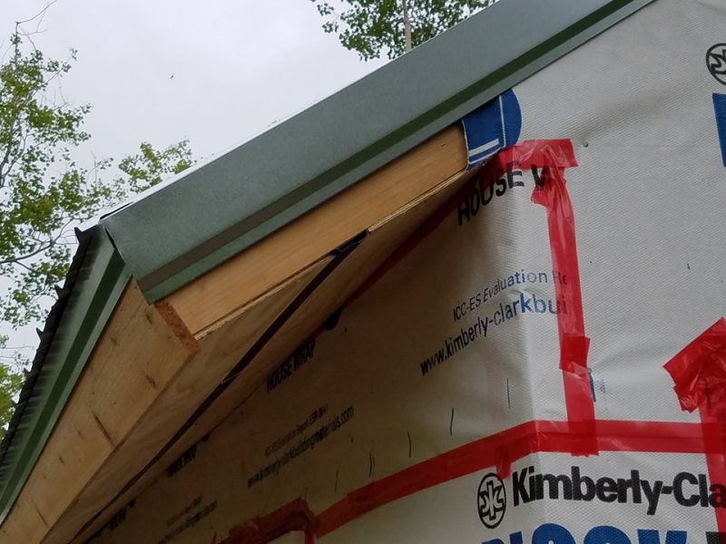

Walls are 2x6, OSB sheeting, gable roof with rafters resting on a ridge board.
# Posted: 8 Jun 2016 03:15pm
Looks good . think rafter ties next . IF only a metal strap over the tops .

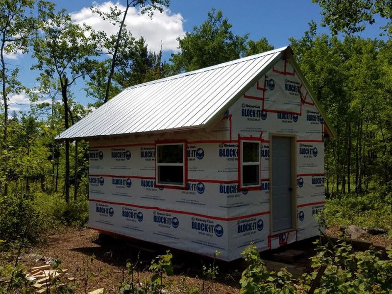

There is a loft over half of it, and we put up a metal roof over 30# felt. No roof overhang in the front, because we will put in a porch and extend the roof forward at that time. Otherwise, a 2 foot overhang all the way around.

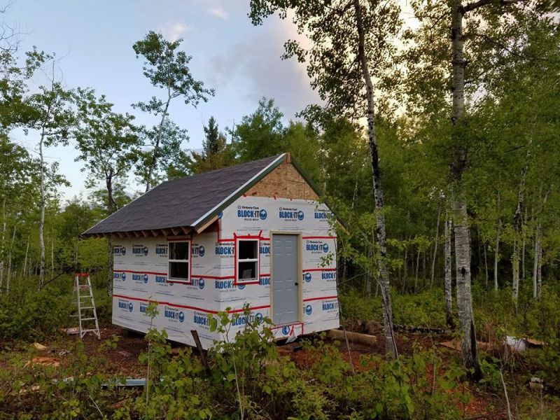

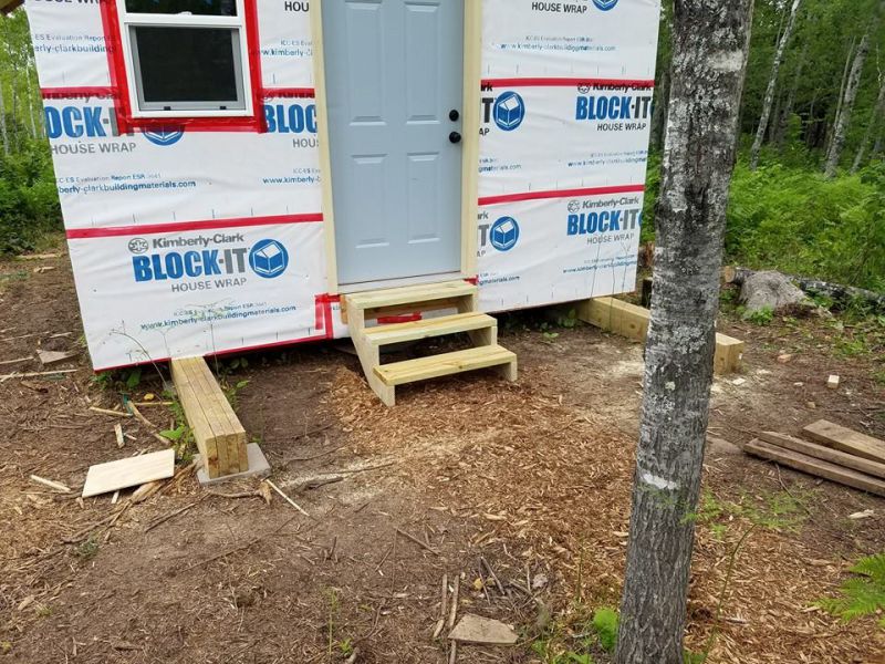

We got up for a delayed long weekend, and I got the soffit and fascia in on the eave ends. Also did some smaller projects, like putting in some front steps, temporary counter top, and clothes hooks and such inside.

I'm curious about your metal roof, specifically the ridge cap. Did you do anything special to finish the ends or did you just leave it as-is overhanging the panels at the gable ends? It looks like mine (Ideal Roofing) and I'm still pondering my options.
NorthwoodsGuy
# Posted: 28 Jun 2016 02:56pm
Absolutely- The roofing products are Pro-Rib, stocked at Menard's. I'm still pondering what I want to do with the ends of the ridge cap. The ridge cap closures weren't in stock when I placed my order, so it is tacked in for the moment and I still have some work to do up there. When I get the closures I will have to figure out what to do with the gable ends. I plan on putting a 4' porch extension out front so the front end is going to be temporary anyways.

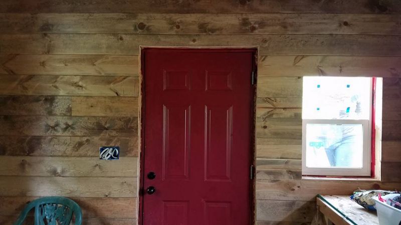

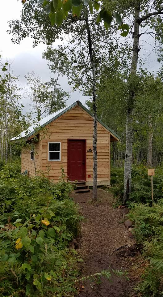

It's been a while since I posted updates. We got insulation and wiring roughed in last fall, and just came back from putting up some siding. Cedar on the outside and pine inside.
