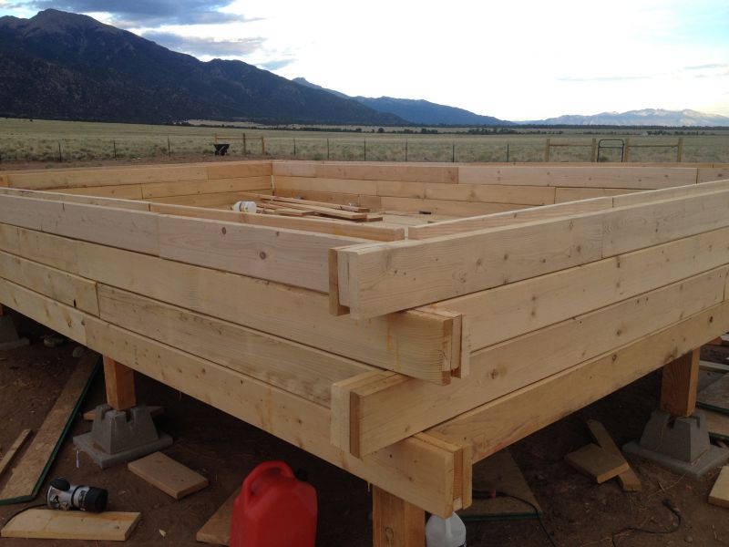

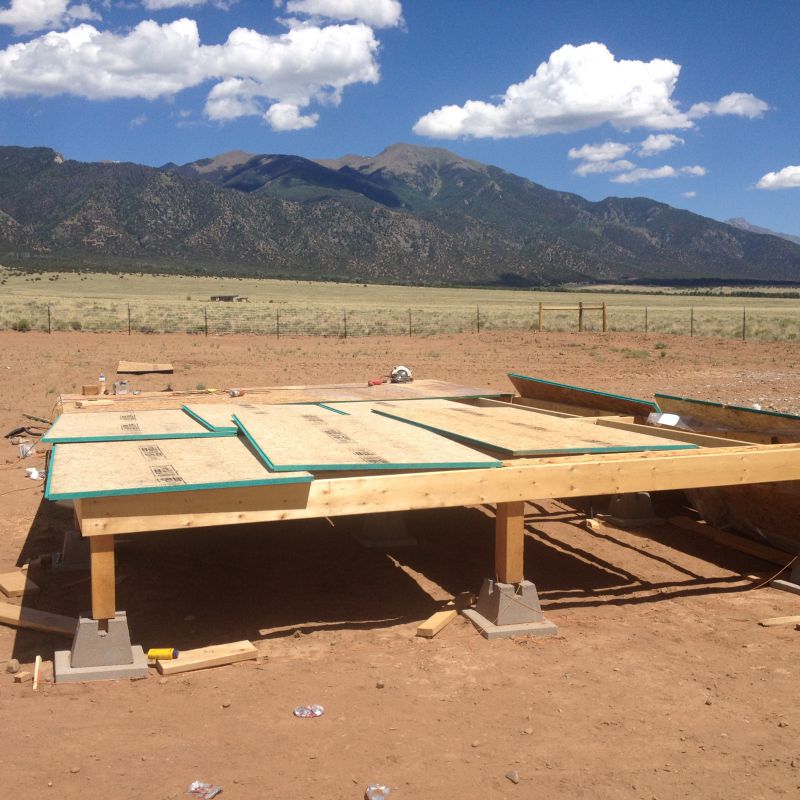

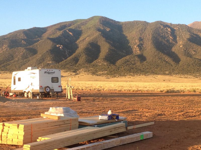

# Posted: 4 Aug 2016 10:38pm
Progress so far. Will resume in September. First camp
|  Start
|  Looking like something
|  Till sept
# Posted: 4 Aug 2016 10:43pm
Beautiful views! Where you located, approx?
# Posted: 5 Aug 2016 12:39am
I'm guessing Montana (eastern) Colorado Wyoming or Idaho. How did I do?

Looking good. one word of warning using the deck blocks, I used them also. Brace from post to post where they meet the deck block. I was looking at my base and it started to lean cause I has no lateral bracing. My tallest leg was only 8" and I thought I was safe, wrong. I pushed it back up straight with the bumper of the truck, added some bracing and things seem to be good.

Its near Crestone CO Sangre De Cristo mountains.
