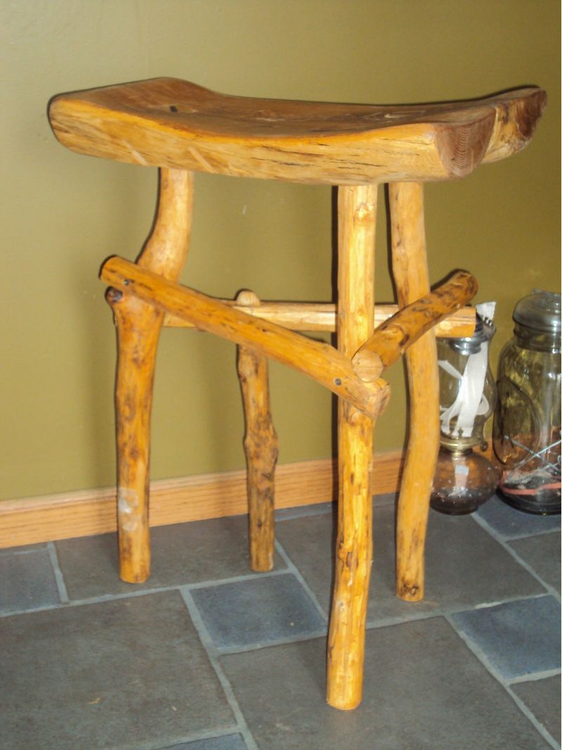

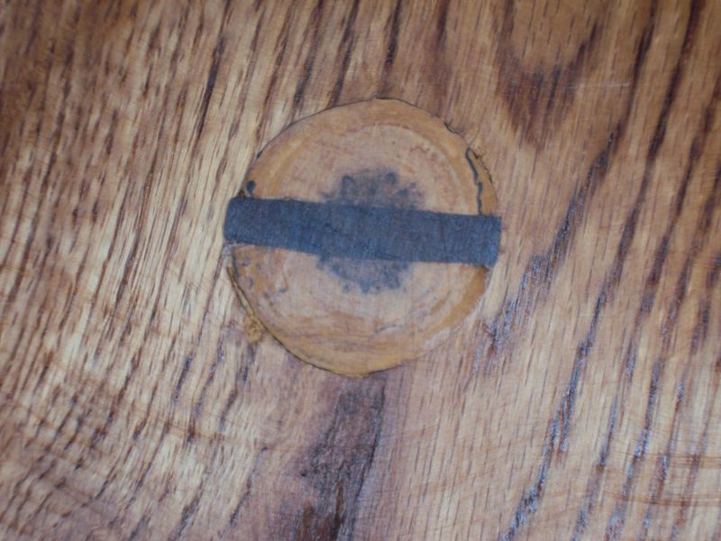

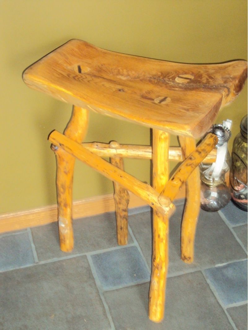

I trying to figure out how to make some basic cabin furniture with some of the scrape slabs and poles I have stored at the cabin. This is my first attempt at making furniture with an approach that is not timber framed.
The legs are secured to the stool with wedges and glue. I like this idea. However, I had to use screws for the cross braces. Any idea on how to secure this type of bracing without using screws?

typically, legs and stretchers are dowelled in, or mortised. A special tool like a big pencil sharpener is used to shave the ends of the stretchers into dowels which are then glued into holes drilled into the legs. Another method to enhance the screw-on method, and add significant strength, is to simply wrap the joints with copper or steel wire, being carefull to pull the sharp ends back into the winding. Good luck, and keep building.
Moontreeranch
# Posted: 9 Dec 2010 11:17
a paddle bit can drill holes in the legs...you can shape the other ends with a draw knife.
glue and a ratchet strap pull them together.
