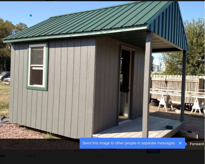

Finishing up my cabin, trying to figure out my solar wiring before i panel the interior walls. I am wanting to go with a 12 volt dimmable led light strip for the ceiling. And maybe a ciggarette lighter plug for charging cellphone. Anyone have any suggestions on which battery, light strip,charge controller, and solar panel i should get? Thanks !
