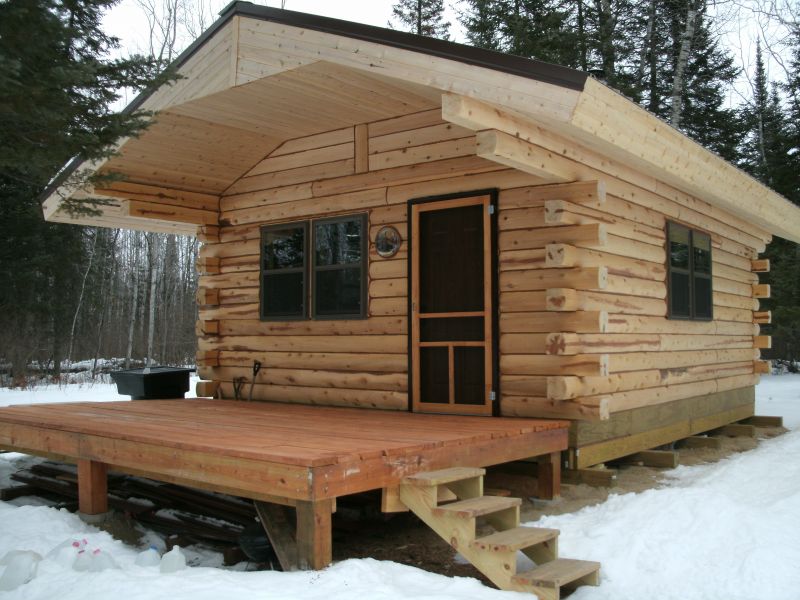

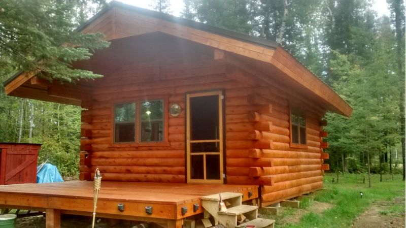

The name tells you where I'm at- up in the woods of the Arrowhead region of Northeastern Minnesota. I spend a lot of time in the woods, as I'm a Realtor in the area specializing in land and recreational properties. I'm also a new small cabin owner, having built at 16 x 20 log cabin last fall. We spend most of the spring and summer weekends doing the finish work this year.
The small log cabin was constructed of 8" northern white cedar "D" logs- locally cut and milled. This was built from the ground up in a total of 13 days by myself and my wife, along with one other guy. Mostly hand tools. No special or big equipment on the job site. Oh yeah, no power on the job site either. (other than the generator)
This cabin is designed to be put together by two or three people working with common tools.
And---no concrete or block on a simply developed foundation.
Great project- love to do another one. Questions? Be happy to talk to all interested. Mike
Bear River Cabin
Bear River Cabin
Winter 2015/2016
Winter 2015/2016

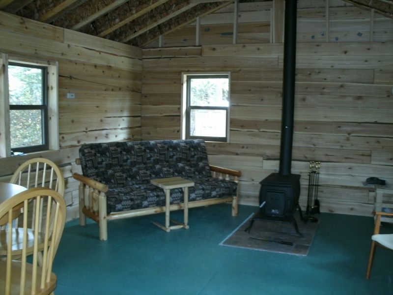

Inside-Fall 2015
Inside-Fall 2015

Welcome to the forum mike. Looking at your wood stove pic gave me an idea. You need to get something behind the wood stove to protect the wall from catching fire. At a minimum, it's going to turn black from the heat over the years. But it looks nice as is.
My thought was one or two 3'x8' pieces of metal roofing leaned against the wall from the rear wood stove legs with some 4" non-heat conducting stand-offs attached to the rear top of the panel. That way you would have some wall protection during the winter and then store it away during the summer.
Nice looking cabin!

Looking good got to get a good woood stove in mine soon. or something.I was thinking using that cement board they use for tiling floors or bathroom walls and then maybe a stone or brick layer. Please check my cabin out when you get a moment....
