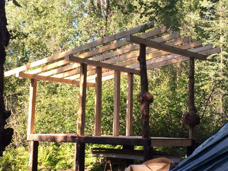

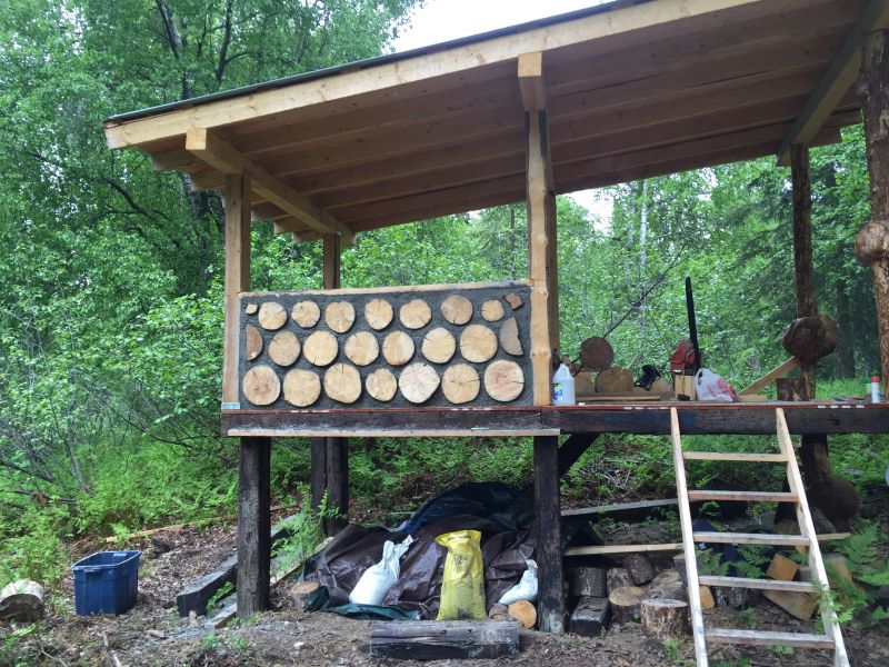

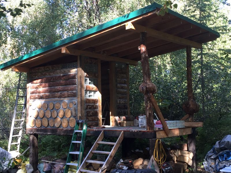

Cord wood is an excellent way to build a cabin, when built right it will last several life times. But, it is very time consuming. You would have had to log, buck, cut, and stack all the cord wood a year or two before you attempt to start making walls. The cord wood needs to be dry so that it doesn't shrink while in the mortar wall.
The mortar is quite expensive to make now days with the price of sand and concrete. I built a sauna this summer out of cord wood and D logs. It is fun but a lot of work. Would it have been easier to just build it out of logs, probably. But I like the way it came out and it certainly works as a swet lodge.
Looks like you have decent logs, I would get a bandsaw mill and start milling into 2 or 3 sided logs.
AKfisher
# Posted: 29 Nov 2016 06:16pm
A couple pictures.
Sauna
Sauna

Thanks. Your sauna looks great! I really like how you used the two front posts of burled wood. Have you used your sauna yet? I wonder if the extrme heat and humidity form it will impact the mortar and wood?

The sauna works well! I built cedar benches inside, I am fitting a cedar door I built as well. I originally used milled slabs for the door but wanted a tighter fit for the door.
The stove is a cheap one, from lowes. It works ok. I will upgrade someday. The cordwood and mortar work great in the sauna. The steam that comes off the rocks actually will be absorbed into the cordwood and eventually the cordwood will "breathe" and dry back out.
This coming up summer I am going to enclose the front with knee walls and bug netting for a changing room and cooling room.
