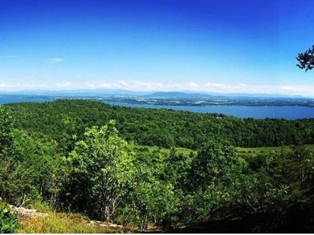

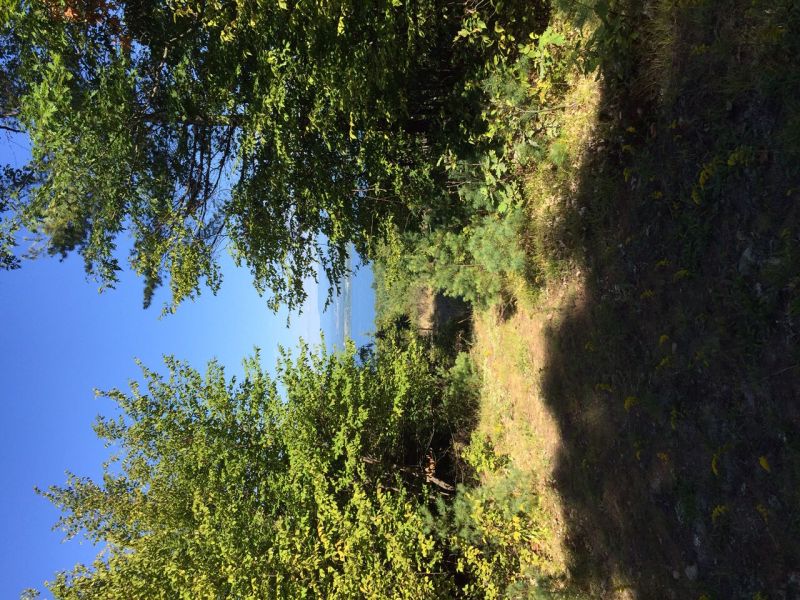

Here's some photos of the land

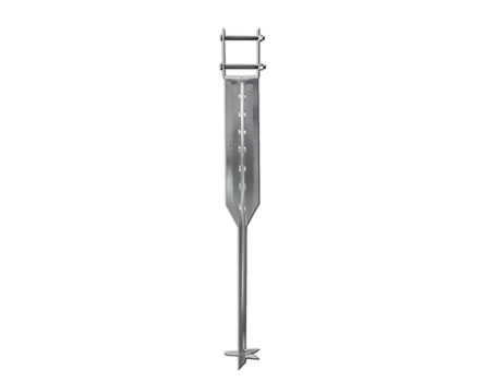

Foundations: Yes you can use concrete piers as mentioned in the flyer... Piers are not considered a permanent foundation as they can be removed if needed (boy that would be a PITA). You can go the route of Screw Piles which actually make a lot of sense if you don't want to futz with mixing concrete, digging holes and setting forms etc... Check out http://www.pylex.com/en/index_en.html [Products] -[commercial shed] for the pile shown below.

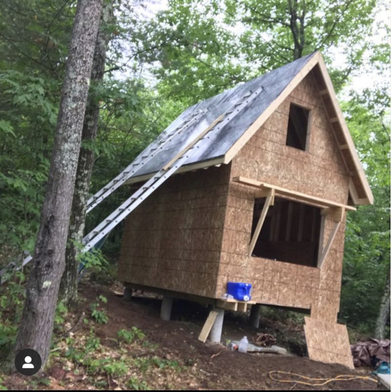

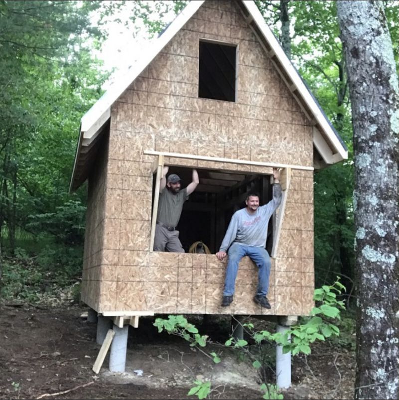

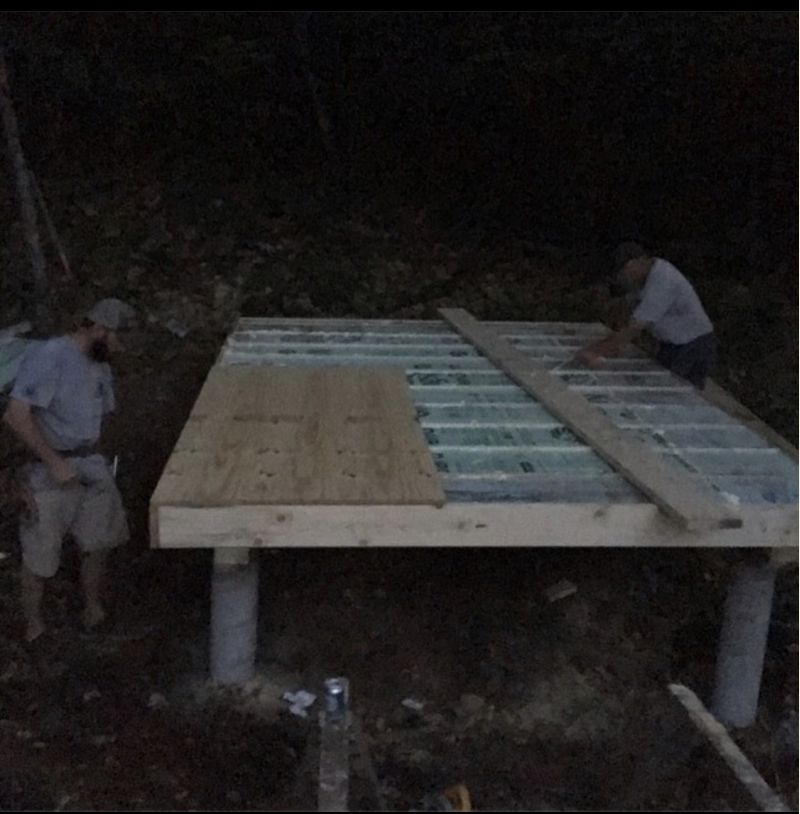

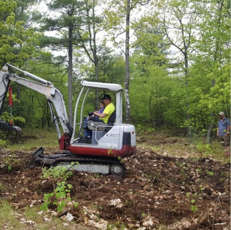

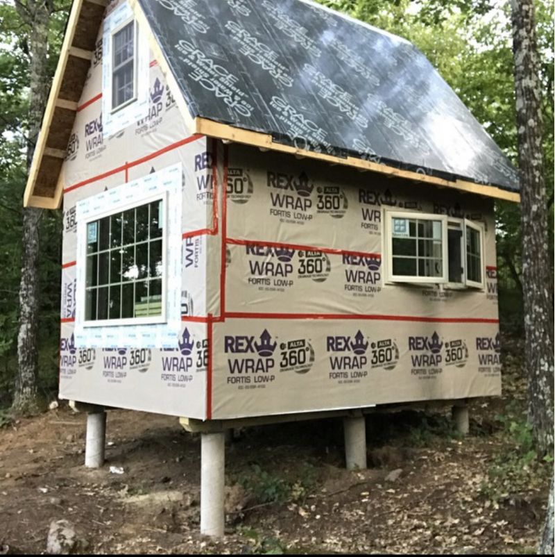

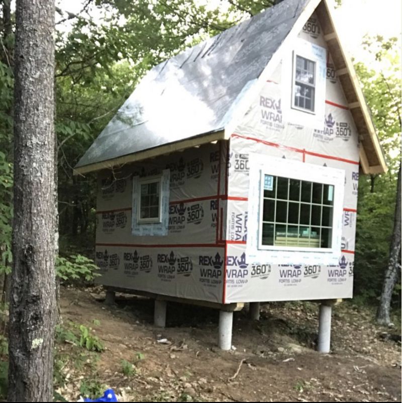

2019 Memorial Day weekend we broke ground on the camp. Footing piers were dug and placed on the ledge rock which was anywhere from 3-4' down. (6) 8" diameter piers with rebar, and a stainless 3/4" threaded rod to secure the Simpson anchors which would hold the 4x6 pressure treated beams down to the piers. Over the 4th of July weekend a good friend and I framed the camp over 4 days and installed the ice and water shield as a temporary roof. Dimensions are 10x14, with 8' walls and a 16/12 roof pitch.

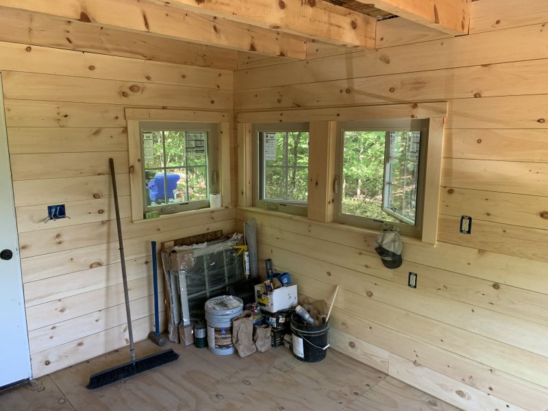

Tyvek, windows and doors were installed. A large picture window overlooking the lake, 30x30 casement windows, and small double hung up in the loft to get some airflow. Two of the casement windows came out wrong with the sashes rotated 90 degrees. I got the replacements on the way.

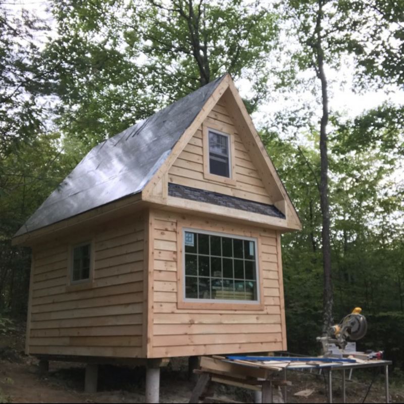

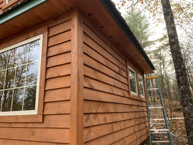

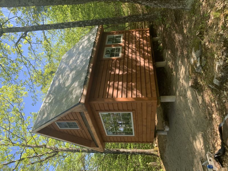

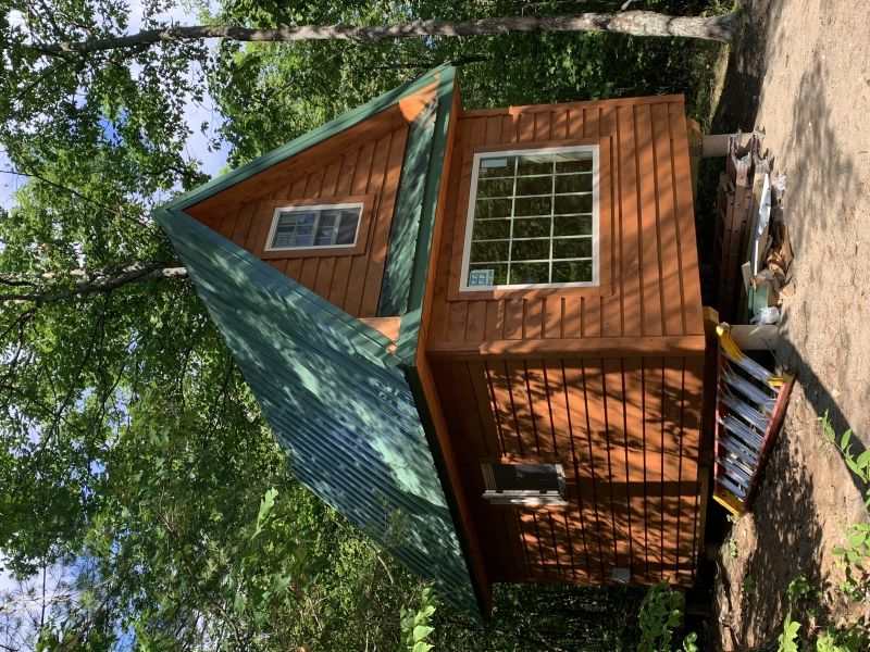

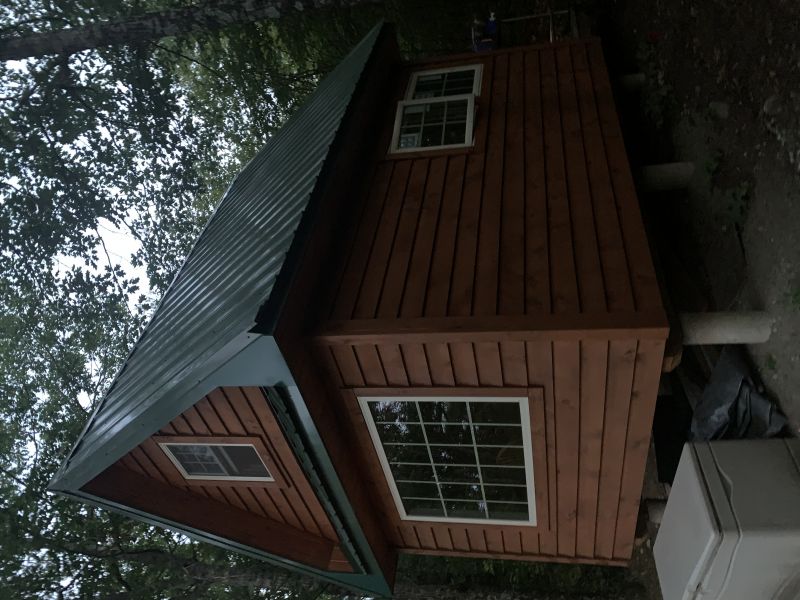

I picked up a White pine clap board siding from the local saw mill. We framed the soffits and sided the cabin. I installed the siding when it was green in hopes that as it dried it would not warp as it dried. Huge gamble but it worked out well for me. I used v groove knotty pine for the soffits.

I returned to camp and was happy to see it sat just as I left it. She weathered her first winter, and while the ice and water shield has been exposed for longer than it should it was holding up well. The siding moisture content was low enough to stain. I protected the windows and doors, and proceeded with staining the siding in a cedar color.

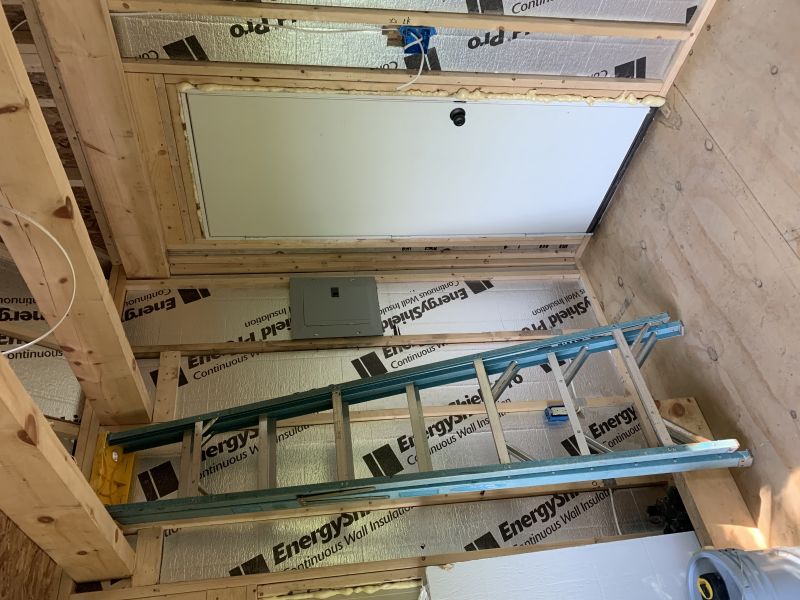

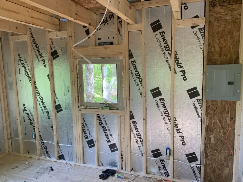

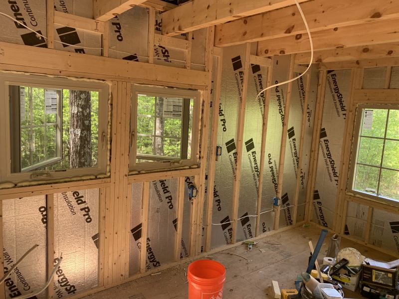

I began insulating the interior walls and roof. I was glad I made the decision to insulated the floor as I framed. I used a polyiso 2" foam core with a 12 mil reflective foil face on one side, and a 12 mil acrylic coated aluminum face on the other. Really good insulation, when installed with a 1" gap between the interior of the wall and the insulation, it's good for R14. After cutting to fit the board, I spray foamed all the edges to the framing to ensure a good tight install.
August 2020 update

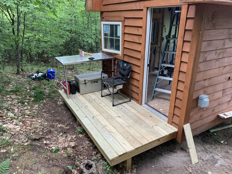

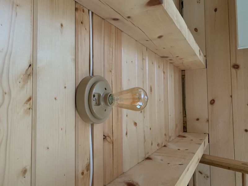

Electric was run. I installed a 30 amp plug outside to plug in the Honda 3000 inverter generator. Inside we installed a small breaker panel, lights for the interior, and outlets. I also decided it was time to build the deck. I kept it small, 4x10.

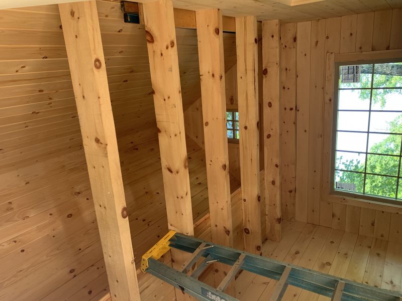

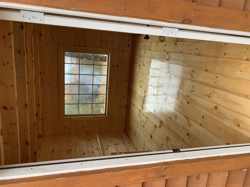

Labor Day weekend 2020, I loaded up 1400LF of white pine ship lap and v groove and installed the interior wood. This was a verify enjoyable weekend working at my leisure and I couldn't be happier with how it turned out. I started on the ceiling and gable walls in the loft and then worked down to the main level.

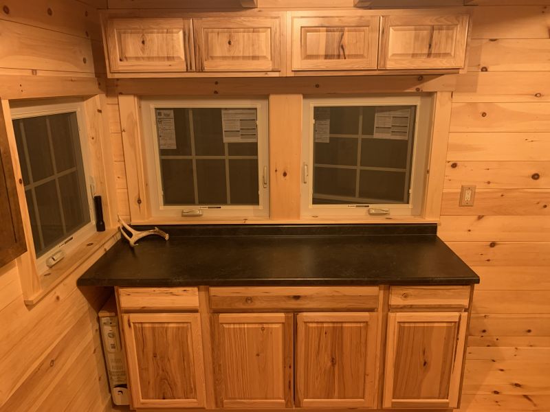

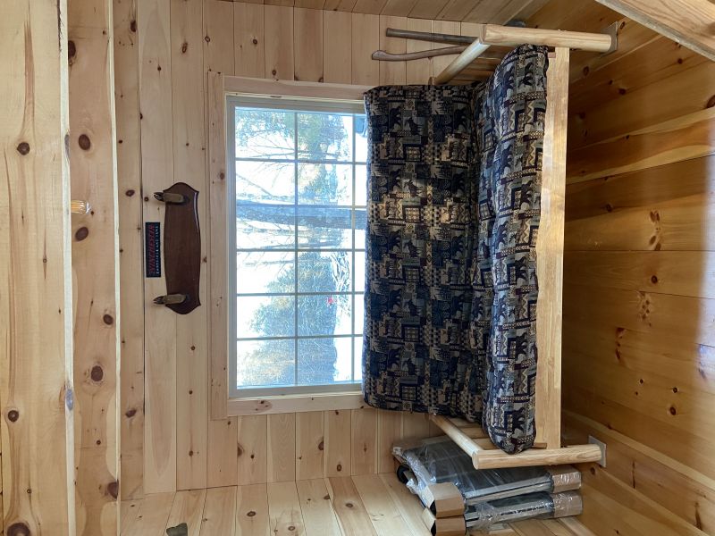

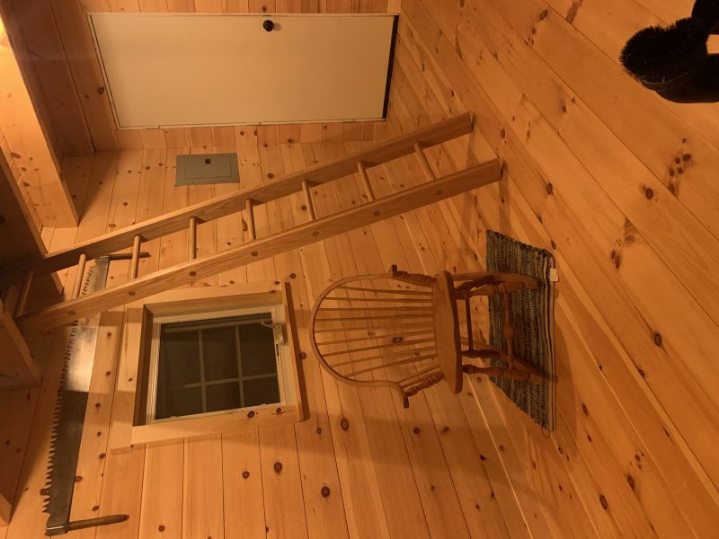

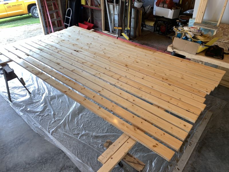

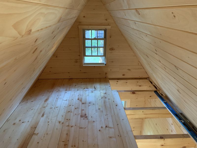

I made one more trip up in 2020 to get the cabinets and flooring installed. I used beetle kill pine t&g 2x6 for the loft flooring. I pre-finished the wood and installed so that I didn't have to work over my head on the first floor later. That made things much easier. I left a hatch opening for ladder access in the middle so that I could maximize the bed layout. Another thing I did with a little forward though was cut the loft flooring to 12' and spliced the last 2' and made a removable panel to be able to bring up mattresses later. For the flooring on the main level, I glued and nailed 3/4 t&g white pine. All flooring was finished with an oil based polyurethane floor finish.

I returned to camp Memorial Day 2021 and again 4th of July and Labor Day. I trimmed out some loose ends, deviced out the electrical and such. I did get a temporary Formica countertop installed, but will later replace it with a wood slab with a natural edge. This post I will share the interior work and the next the exterior as it sits now.

And for the exterior updates. I paid someone to install the roof and complete all the metal flashings. I was happy to let someone else work off that 16/12 pitch! Plus I did not have a metal break so I needed the help.

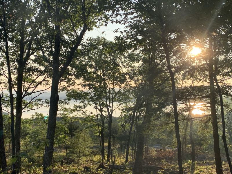

I did spend some time on a trip in 2021 clearing out to improve the view of the lake. It was important to me not to open it up all the way, but achieve a filtered view of the lake. I didn't want the cabin visible from the other side of the lake, I like being hidden thru the trees.
