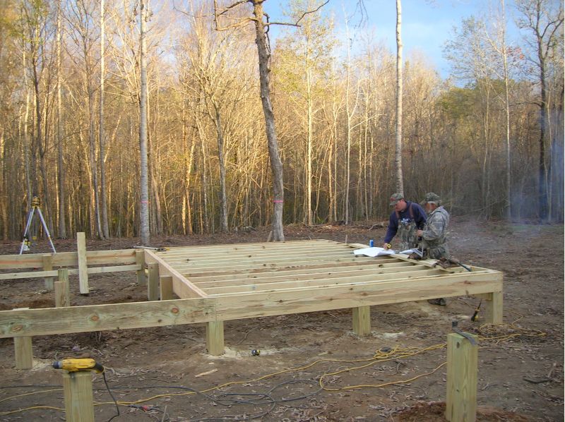

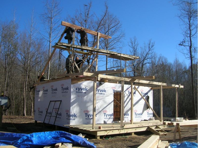

I had the idea for this cabin rattling around in my head for several years. I finally found the right piece of property and purchased it in early 2006, right after Katrina. It is 90 acres of mixed pine and hardwoods bordered by National Forest land on one side, timber company land on another side and good neighbors on the other. The Noxubee River is my southern border, excellent fishing for catfish, spotted bass, crappie and red bellies. The hunting is outstanding also.
We started the foundation and framing work in early November and here is our progress so far, hope you enjoy!
floor
floor

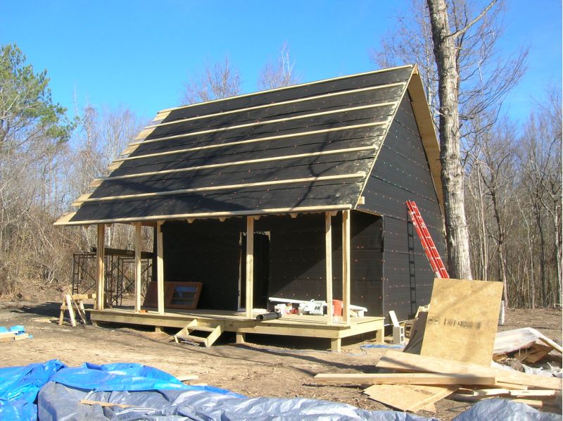

rafters
rafters
roof
roof
in the black
in the black

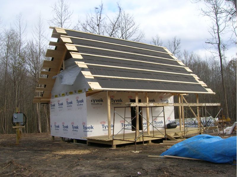

# Posted: 22 Dec 2010 10:00pm
Wow your making fast progress! whats going on with the left roof line on the gable end? is that part of your design or will those pieces get trimmed? and Im guess i twill get a metal roof judging by the strapping

Sorry, we are in Mississippi. I have some excellent help, my friend Chet who is a master carpenter and he really gets into building cabins. We let the 1x12 roof decking run 'wild' off the ends and have since gone back and trimmed them off. You're right about the metal roofing, in fact it will be delivered tomorrow morning but we won't put it on until next week since our roof insulation wont be delivered until Monday. It is really shaping up quick but some of my help will be out of town for the holidays so work will definately slow down.

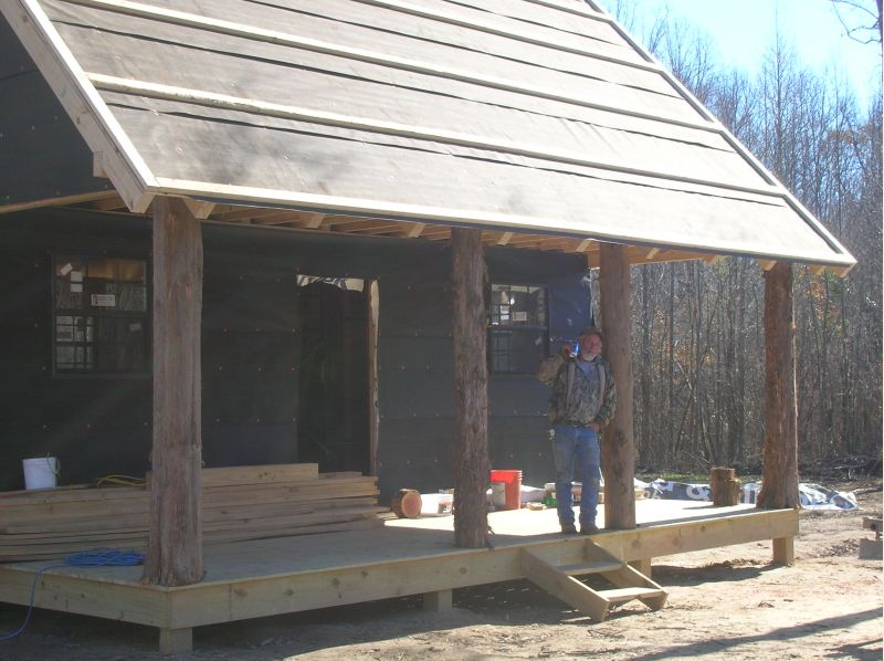

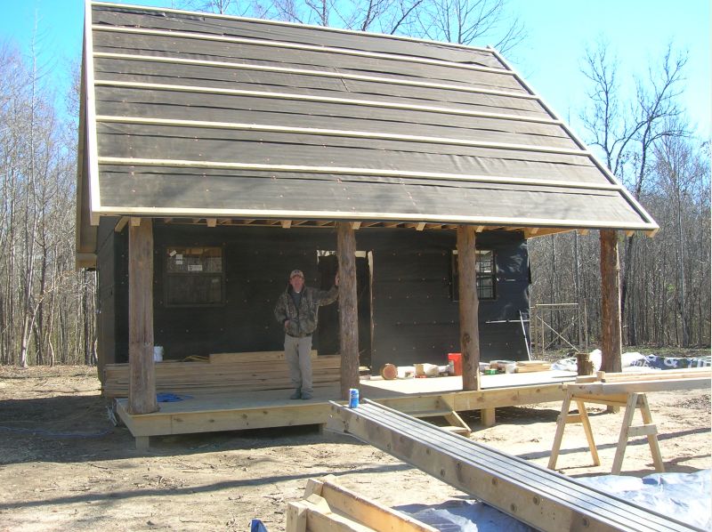

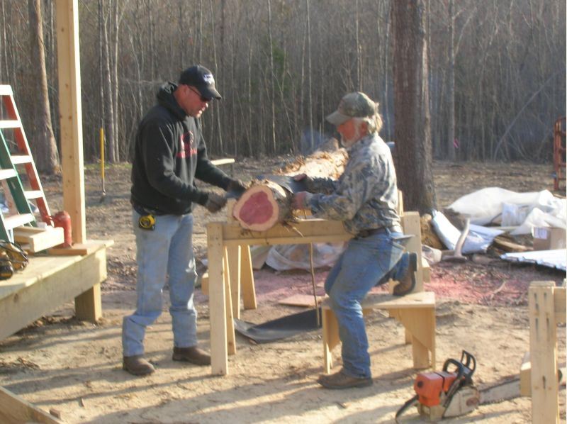

I cut some cedar today for our porch posts. I tried to get as close to the ground as possible in order to save the "swell" at the butt of the trees. We will try to get these all in place tomorow and I hope to have more pics.
cedar
cedar
studying
studying
trimming
trimming
Timberjack
# Posted: 24 Dec 2010 09:56pm
Got our porch posts up today and I think it turned out very well!

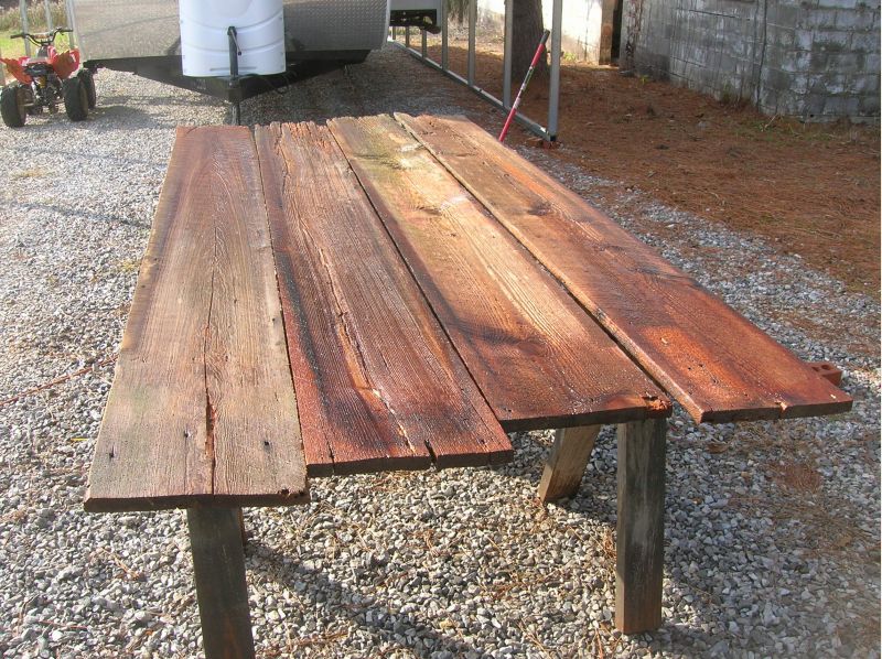

There won't be any plywood or osb visible anywhere in this cabin once it is completed. That was something I was very adamant about.The floor in the room above the porch is 1x12 syp leftover from the roof decking. I got a good deal on it (475/mbf) but had to buy a whole bundle. I'm thinking barnwood for most of the interior walls along with some 1x pecky cypress I picked up from one of my mill contacts. I am a forester by trade so I've been lucky in that respect. I salvaged the barnwood from an old tenant house on my inlaw's farm. It is mostly 1x12 heart pine. I hope it looks good.

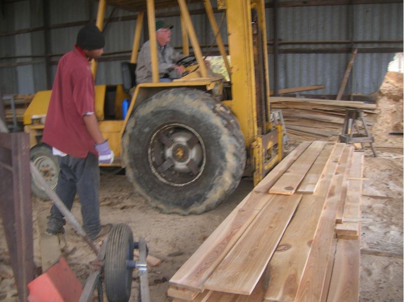

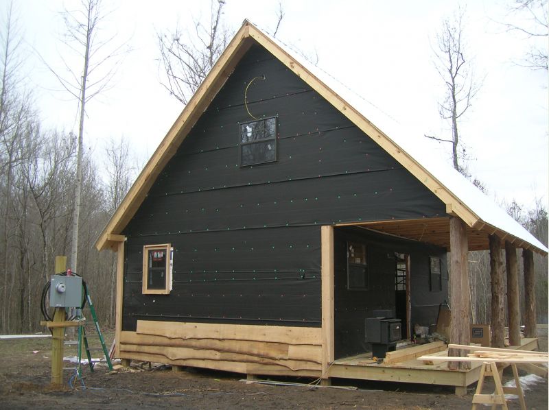

We are almost ready to put the siding on and we discovered that we had no trim for the corners of the cabin as well as the windows and doors. I still had about 10 logs left so i made a quick trip to the sawmill and had Mr. Jackson (he's the one on the lift) cut 20 2x6x12s. They're still green and I'm sure we'll have some shrinkage but we didn't have much of a choice. He's been very helpful and even offered to come and play the fiddle for us at the inaugural cabin warming party. I hear tell he's very good.

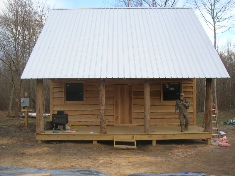

# Posted: 28 Dec 2010 07:06am

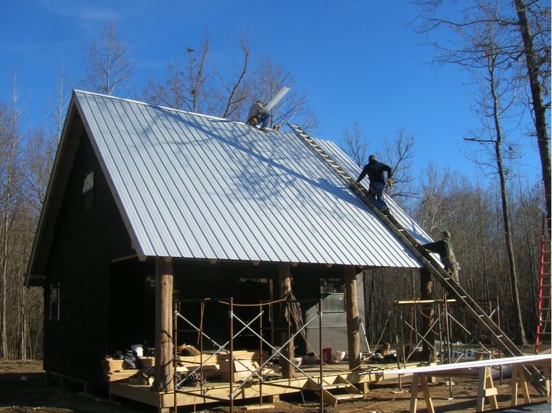

Finally got our metal roofing on! -relieved to be in the dry.

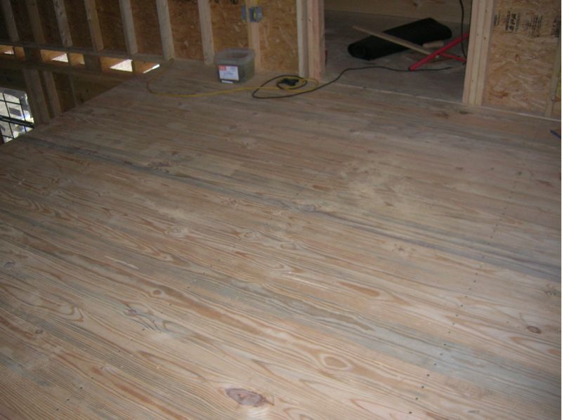

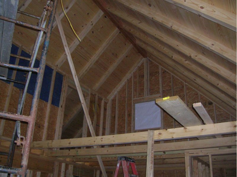

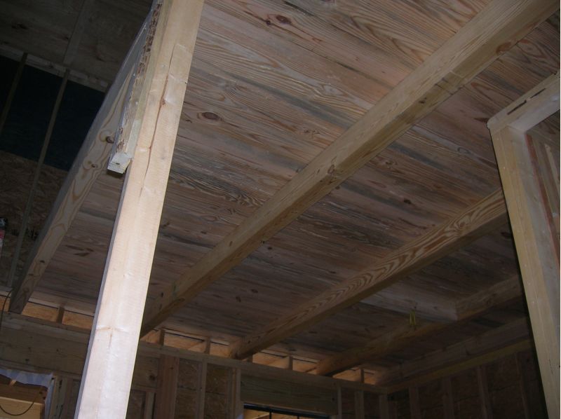

Been busy doing some odds and ends but in the meantime we got our loft floored. We used 2x6 pine that we had milled from some bug killed timber (hence the "blue" streaks in some of it).

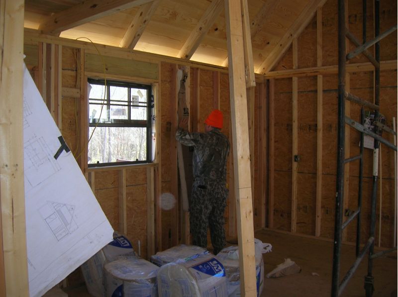

Since you are located in hot & humid Mississippi I thought I'd mention that when it comes time to insulate the walls and apply whatever you will use to finish the interior wall, do not use any polyethylene vapor barrier. It's a bad idea in a hot & humid climate.
Timberjack
# Posted: 3 Jan 2011 07:23am
Thanks, I actually started insulating the walls yesterday. I'm using R13 rolls with the kraft vapor retarder. I have several sheets of the 1" polyiso foam leftover from the roof, thinking of using it somewhere, maybe in the walls or under the floor. I wonder how it would do if I doubled it? It has an R value of 6.5/inch with foil on both sides. I guess thats a vapor barrier though, may just use it under the floor, thoughts?
# Posted: 3 Jan 2011 03:28pm
I would not put the foil in the walls unless it was on the outside, with fiberglass or cellulose in the wall cavities. Under the floor joists would work too.

# Posted: 12 Jan 2011 11:05pm
Been doing some insulating, I guess the brother-in-law is good for something after all!

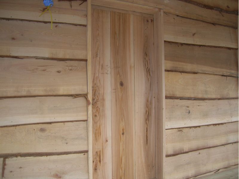

I like the live edge on your siding! Is it Cedar? I too like to see barcoded materials covered by natural looking stuff. As HomeDepot becomes more powerful across the country it's good to see the locals stepping in to offer cool stuff.
I'm curious how much your sawyer is charging. Does he give you a Board-foot price?
Timberjack

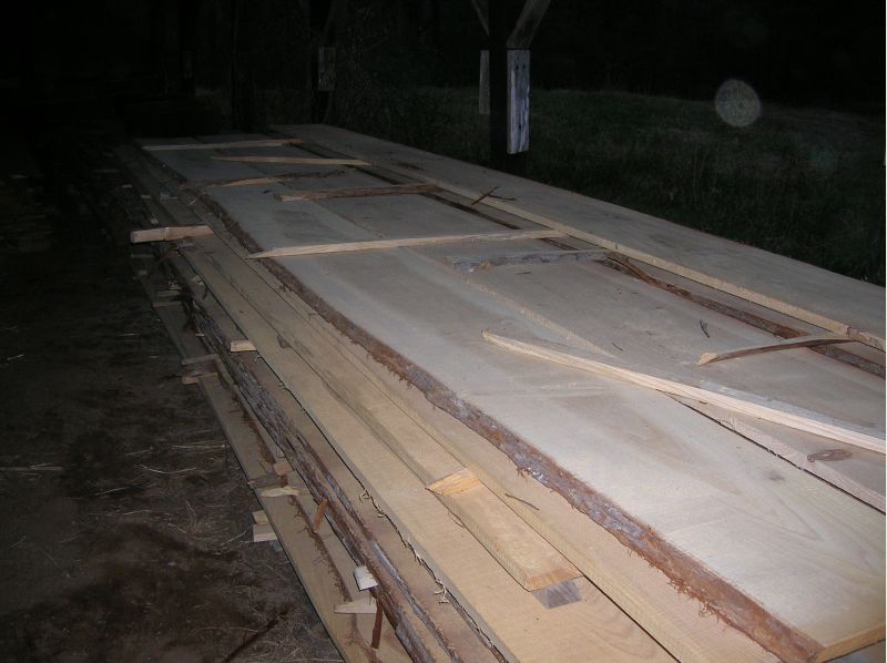

# Posted: 18 Jan 2011 07:09pm
Tom, my sawyer charges me $200/mbf which may be a little bit pricey compared to some others but he does excellent work and I can call on him whenever the need arises. I carried him 25 nice cedar logs yesterday which will yield much more lumber than I will need. We decided that it would be best for both he and I to do it "on halves", meaning we split the lumber.

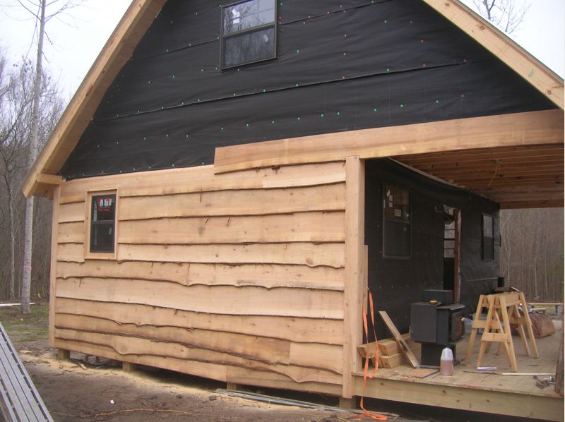

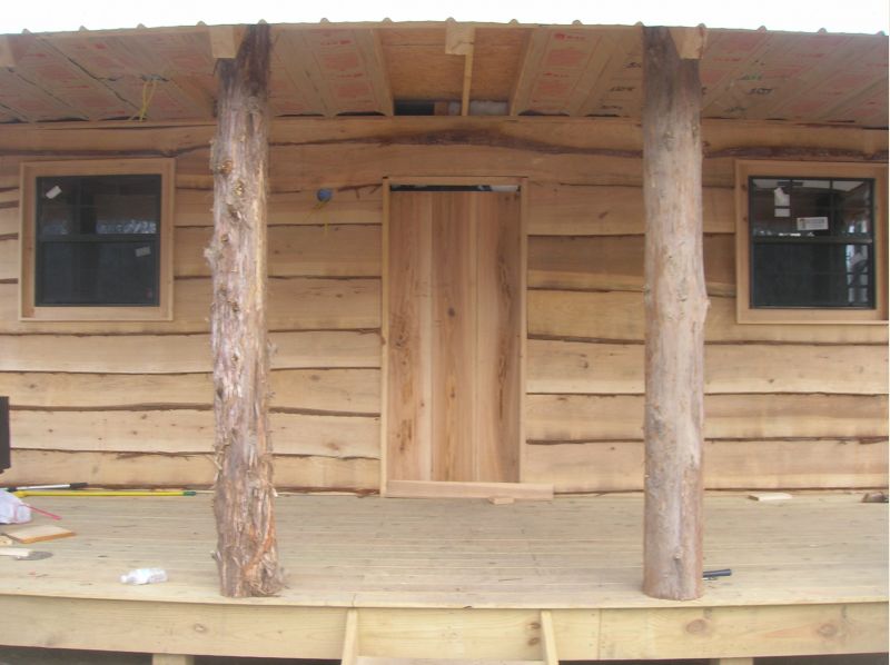

Timberjack
# Posted: 22 Jan 2011 07:45am
Finally got our siding on, I thought it turned out very nice!

What are the dimensions of this cabin?

The living space is 18x24 with a 12x12 loft and a small room over the porch. The total footprint of the building with the porch is 24x26.
