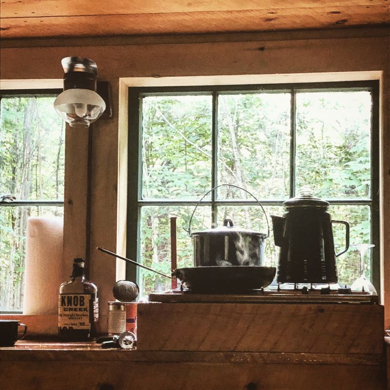

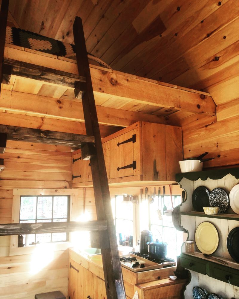

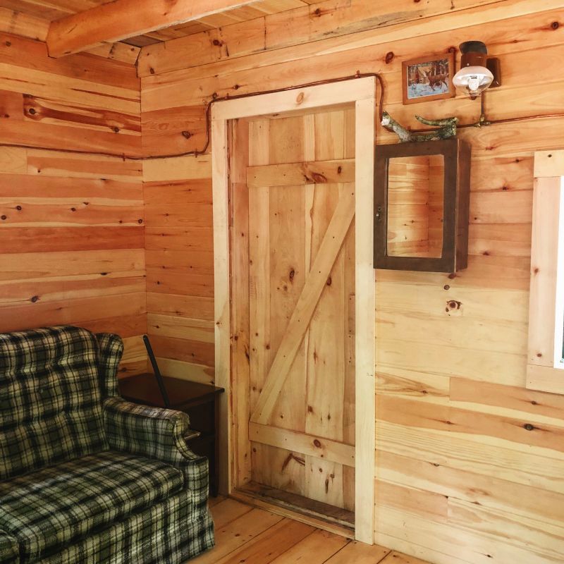

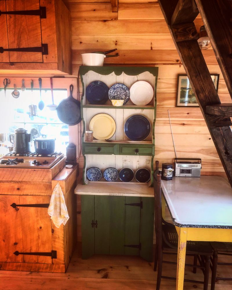

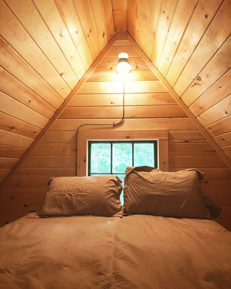

Well I finally finished!!...almost, I’m bringing the outhouse up next weekend I’ll post pictures of that once it’s up there![9E8EF631C91946A5B.jpeg 9E8EF631C91946A5B.jpeg](https://www.small-cabin.com/forum/shared_files/uploaded/7351/118159_1.jpg) 9E8EF631C91946A5B.jpeg
| ![A66AFF892B2546A7B.jpeg A66AFF892B2546A7B.jpeg](https://www.small-cabin.com/forum/shared_files/uploaded/7351/118159_2.jpg) A66AFF892B2546A7B.jpeg
| ![218DB97A08FC406FA.jpeg 218DB97A08FC406FA.jpeg](https://www.small-cabin.com/forum/shared_files/uploaded/7351/118159_3.jpg) 218DB97A08FC406FA.jpeg
| ![902D877B7ED04935B.jpeg 902D877B7ED04935B.jpeg](https://www.small-cabin.com/forum/shared_files/uploaded/7351/118159_4.jpg) 902D877B7ED04935B.jpeg

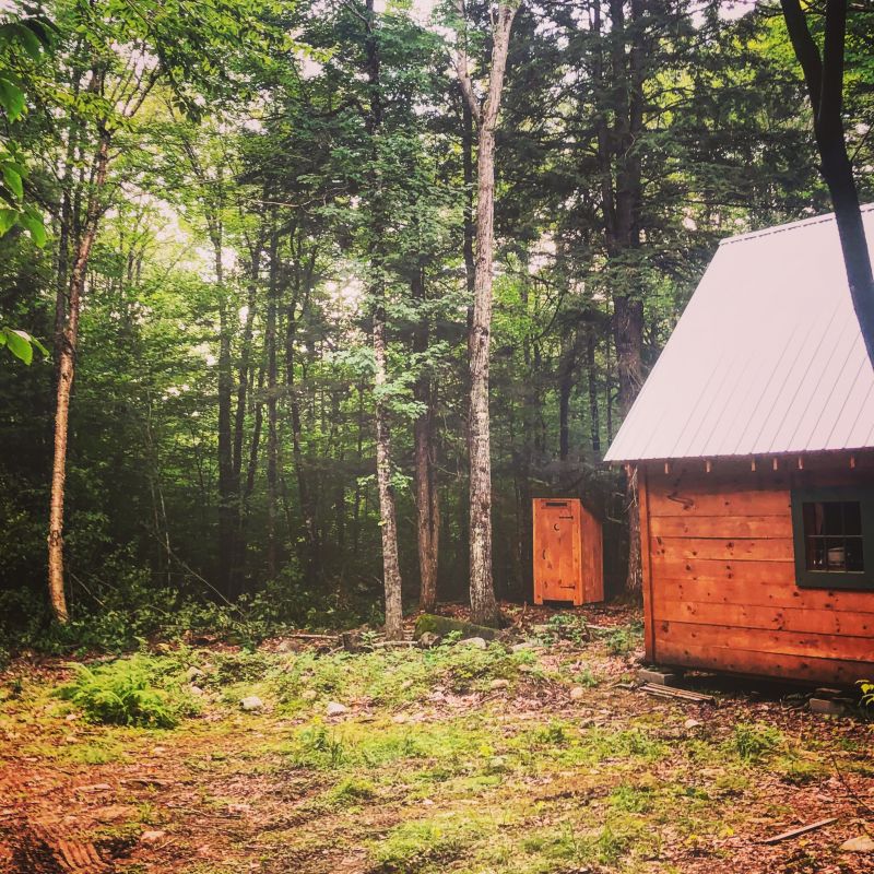

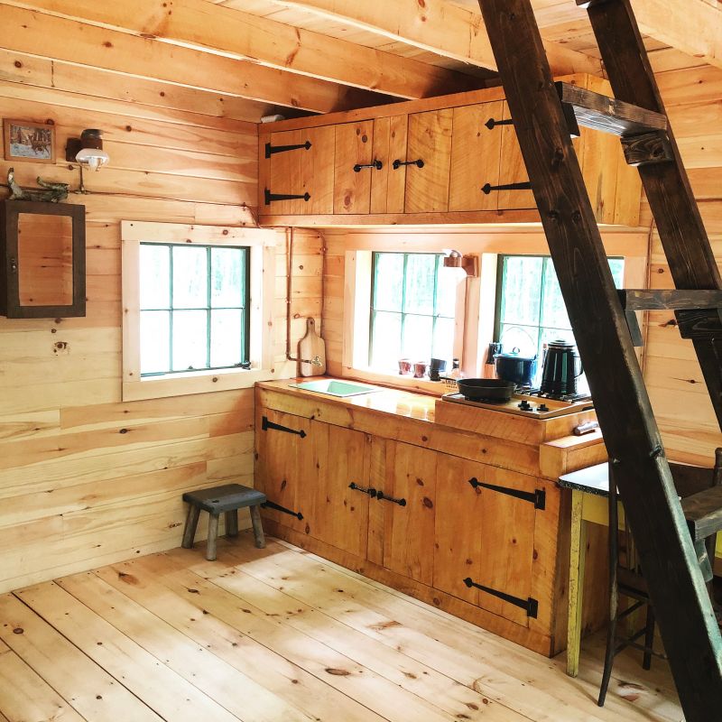

A few more...![3D7F9379BAEA48F6A.jpeg 3D7F9379BAEA48F6A.jpeg](https://www.small-cabin.com/forum/shared_files/uploaded/7351/118161_1.jpg) 3D7F9379BAEA48F6A.jpeg

gorgeous

Amazing work!

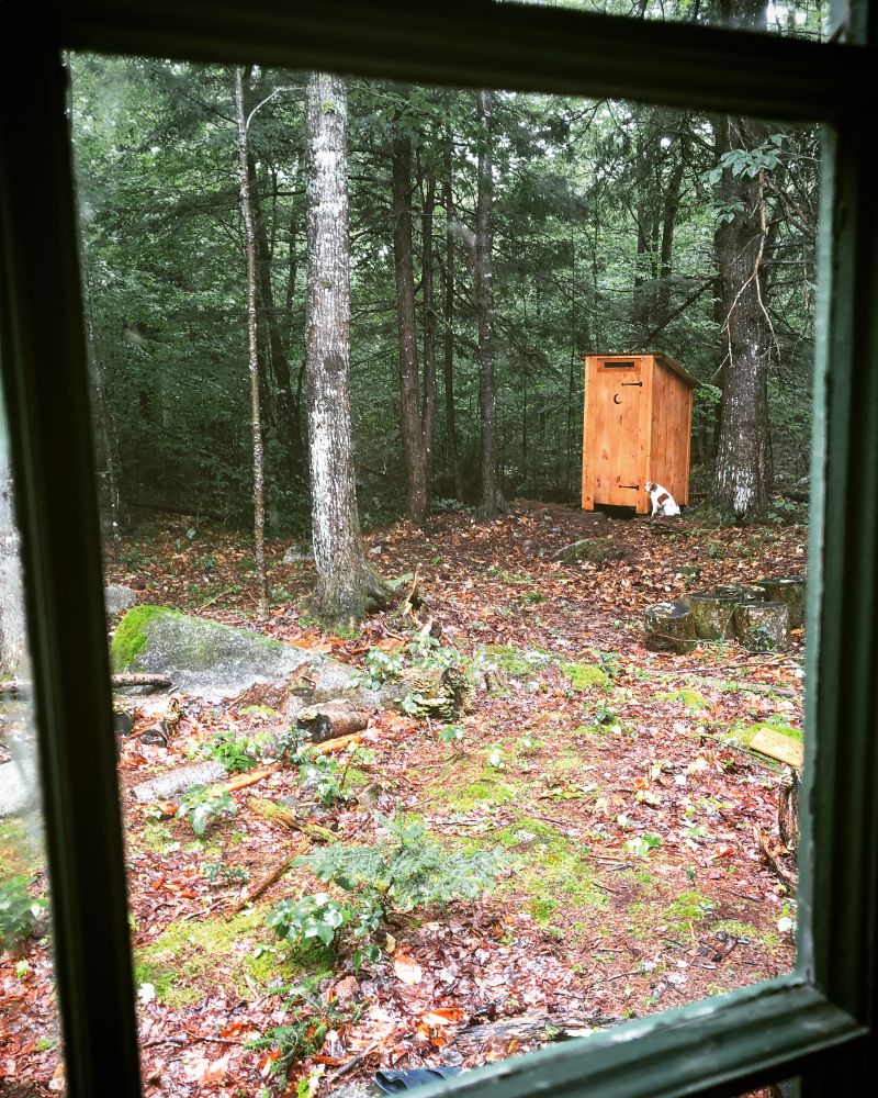

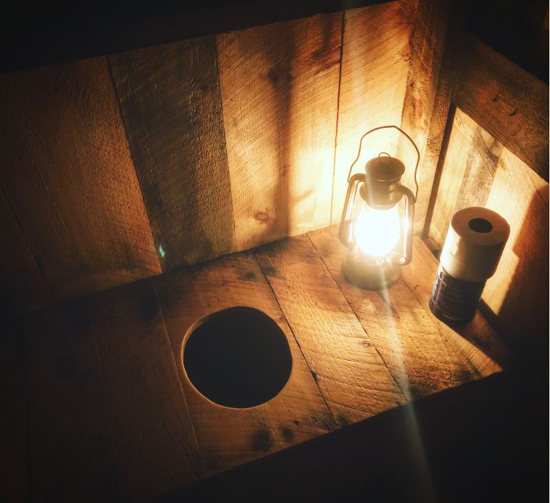

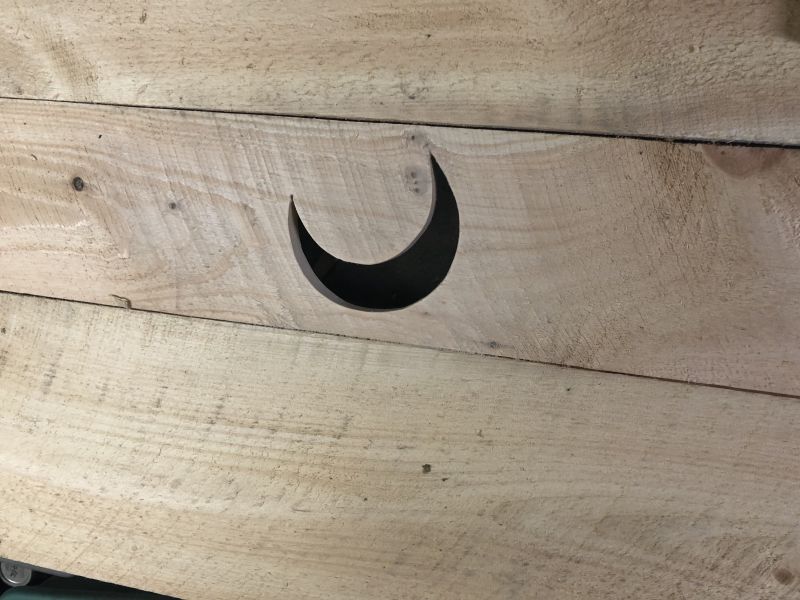

Thanks! Here’s the finished outhouse![7661251C943B4DFF9.jpeg 7661251C943B4DFF9.jpeg](https://www.small-cabin.com/forum/shared_files/uploaded/7351/119770_1.jpg) 7661251C943B4DFF9.jpeg
| ![C74A39C703E24F3CB.jpeg C74A39C703E24F3CB.jpeg](https://www.small-cabin.com/forum/shared_files/uploaded/7351/119770_2.jpg) C74A39C703E24F3CB.jpeg
| ![C9C75764CFBB48798.jpeg C9C75764CFBB48798.jpeg](https://www.small-cabin.com/forum/shared_files/uploaded/7351/119770_3.jpg) C9C75764CFBB48798.jpeg

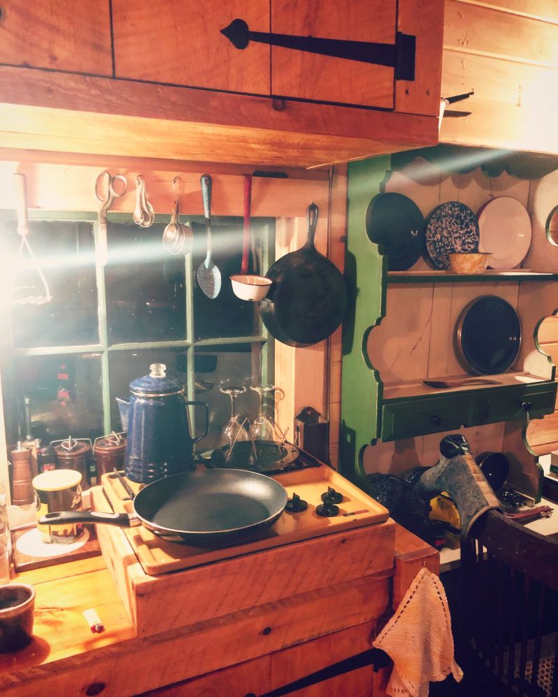

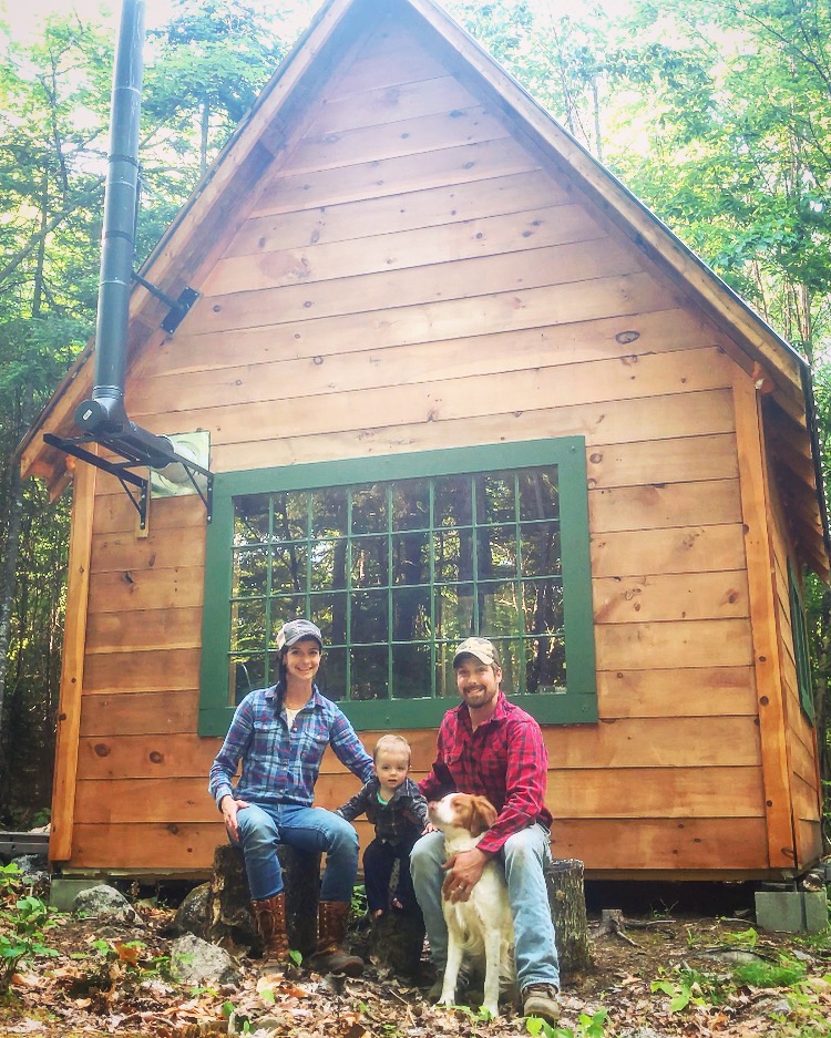

Finally got to use it during hunting season!![8B1D646C51F44327B.jpeg 8B1D646C51F44327B.jpeg](https://www.small-cabin.com/forum/shared_files/uploaded/7351/121246_1.jpg) 8B1D646C51F44327B.jpeg
| ![A3AC4755F2DE4278A.jpeg A3AC4755F2DE4278A.jpeg](https://www.small-cabin.com/forum/shared_files/uploaded/7351/121246_2.jpg) A3AC4755F2DE4278A.jpeg
| ![A91FA486810745DAA.jpeg A91FA486810745DAA.jpeg](https://www.small-cabin.com/forum/shared_files/uploaded/7351/121246_3.jpg) A91FA486810745DAA.jpeg
| ![F46E94AA4FF64718B.jpeg F46E94AA4FF64718B.jpeg](https://www.small-cabin.com/forum/shared_files/uploaded/7351/121246_4.jpg) F46E94AA4FF64718B.jpeg

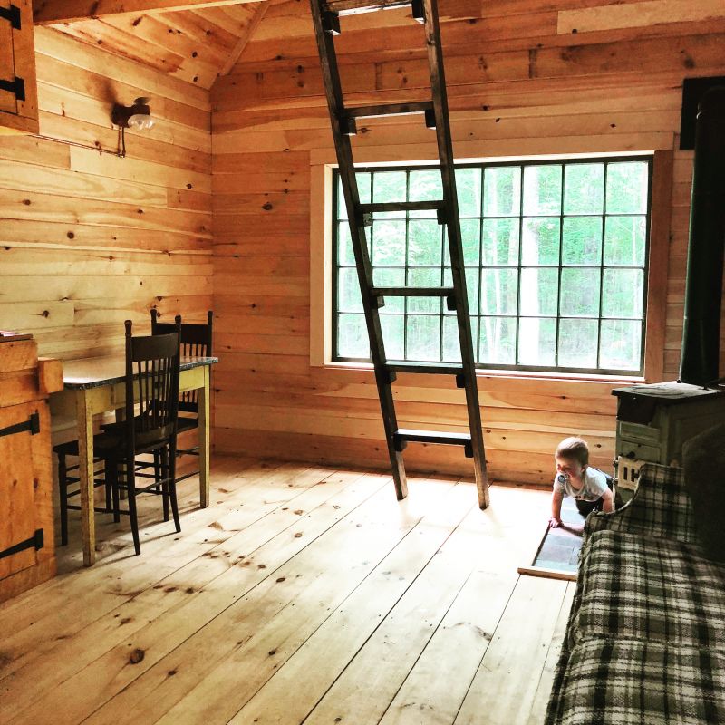

Looks great. Love the look of your old woodstove. I bet those gas lights look good when they are lit.

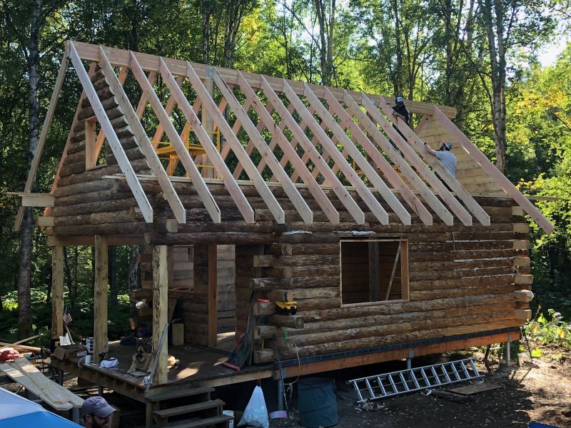

Hey there. We're working on getting our cabin in Maine closed in. It looks like you went without collar ties on your rafters, as we are considering doing. Ours is a 16x24 with a 12/12 roof, built very similarly to yours. What was your thought on the collar ties? I'd really like to have that headroom in our loft. Your place looks great!
bwalak
# Posted: 8 Nov 2018 19:58
Thanks guys! No luck yet but I’ll be heading back up next weekend. I hung the rafters off of a ridge beam and and then used oversized beams for the ceiling joists (floor of the loft) so i figured collar ties wouldn’t add all that much more stability, and I was dealing with a 16/12 pitch with a metal roof so snow load wasn’t as big of an issue.

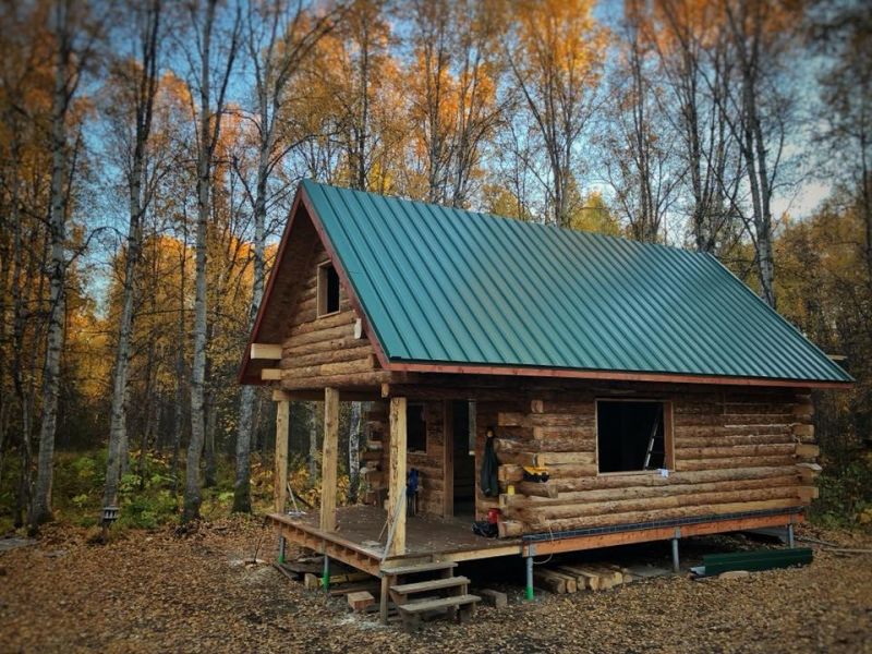

# Posted: 12 Nov 2018 14:16 - Edited by: AKfisher
Quoting: milfordchief Hey there. We're working on getting our cabin in Maine closed in. It looks like you went without collar ties on your rafters, as we are considering doing. Ours is a 16x24 with a 12/12 roof, built very similarly to yours. What was your thought on the collar ties? I'd really like to have that headroom in our loft. Your place looks great!
Milford, this is what a 16x24 looks like with a 12/12. I did decide on a 2' knee wall so the walls are taller all around. Ridge beam is a 5x12" glulam, rafters are 2x10s with a birds mouth.

I would be interested to know how you orient the bed in your loft. It seems to be the same size and slope of mine and I am trying to figure out what to do.

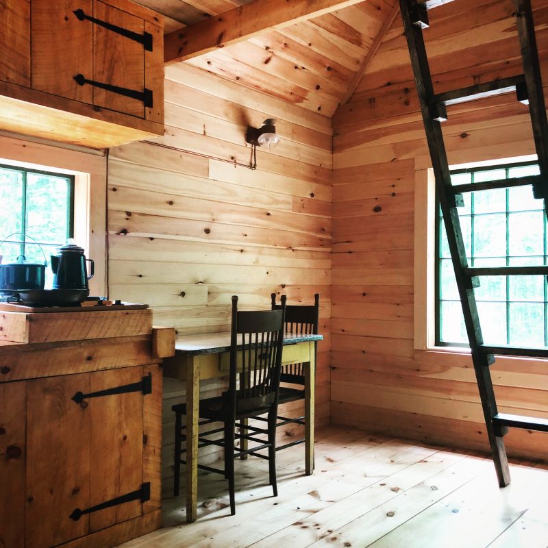

Bwalak, what finish did you use on your pine walls? Thanks, looks great by the way!

Thanks guys. It’s actually not even stained just natural pine.

Do you have water in the upper cabinet above the sink? If so can you post pics of the setup?
bwalak
# Posted: 9 Sep 2019 06:32
I do, it’s just a 15 gallon plastic tank hooked into copper water pipe, gravity fed. I’ll post pictures next time I get up there
