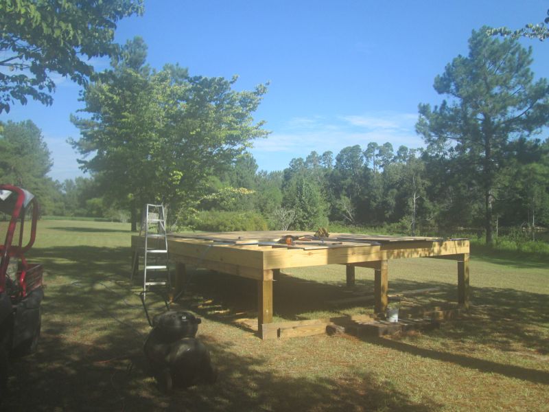

14x20 Cabin;
All lumber (except treated and OSB) was cut on a portable band sawmill, Woodland Mills HM126. Treated lumber was used for ground contact, and OSB for floor, walls between frame and exterior siding boards, and roof under shingles.
The floor and foundation:

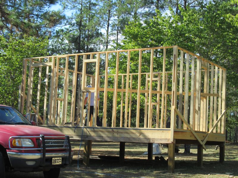

I used regular Quikcrete and treated 6x6's from Lowes for the foundation. I dug a 2' hole and added 6 inches of Quikcrete to the bottom of the hole. When it cured, I placed the 6x6 on top and filled in with dirt to support the 6x6 pine runners (2 10' runners joined in the middle and running the full width of the cabin) that will support the floor. You can see these in the below photo, one set on each side and the middle. The floor joists are 2x10 on 16" centers. The flooring is 23/32 tongue and groove OSB.
Getting Started
Getting Started

Prior to this project I had never built anything larger than a doghouse. I learned to frame by watching youtube videos.
Framing

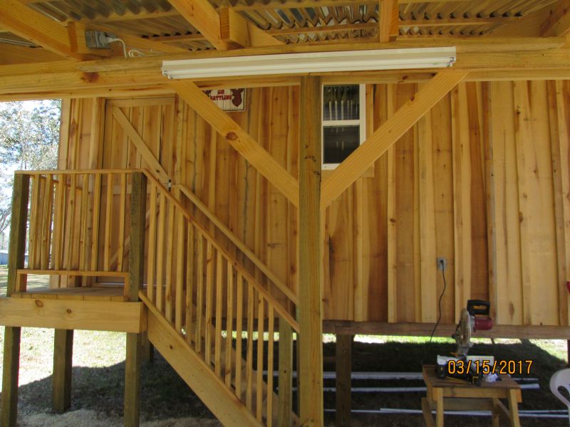

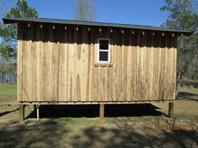

Cabinmonkey
# Posted: 16 Mar 2017 08:40am

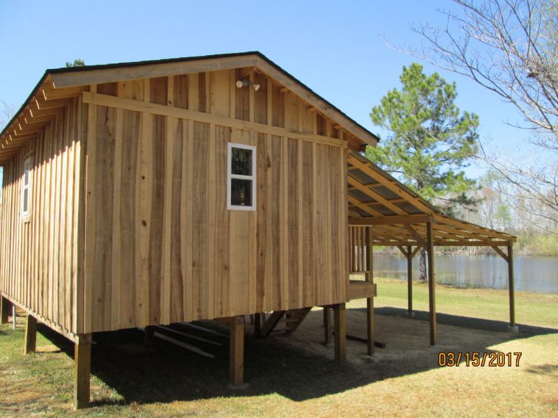

The exterior walls are poplar board and batten. I used roofing felt between the boards and OSB wall to offer some breathability since the boards were only air dried for about 3 months, and the pine framing was pretty much put up wet.

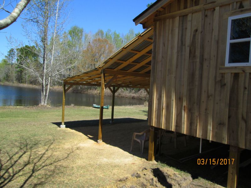

The cabin will be used for fish fries and cookouts, so it isn't very far from the house.

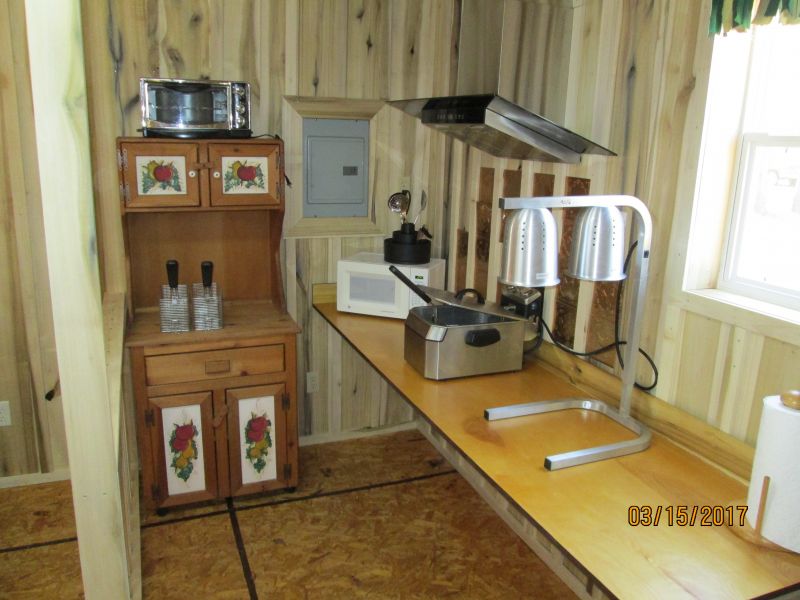

Cabinmonkey
# Posted: 16 Mar 2017 08:59am - Edited by: Cabinmonkey

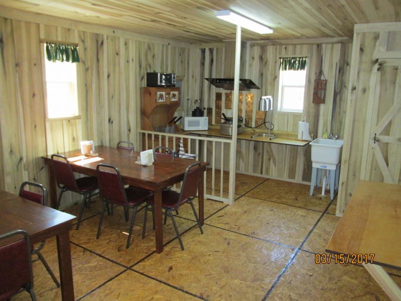

The countertops were made from plywood. Walls are poplar board and batten. There is no stove; just a deep fryer, microwave and toaster oven. If it has to be cooked on a stove, we'll cook it at the house and carry it over.

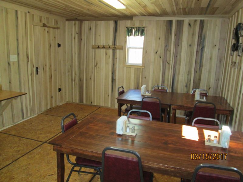

The tables were made from leftover poplar and pine, stained and 3 coats of polyurethane. The OSB floor also has 3 coats of polyurethane, and the brown stripes on the floor are to hide the blue paint on the tongue and groove joints.

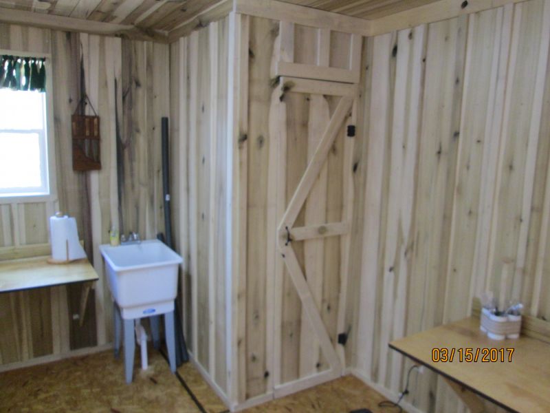

Right now the deep sink is cold water only. I may install an inline water heater later.
The tiny room in the corner is a toilet.
Ceiling is poplar.

Smawgunner
# Posted: 16 Mar 2017 09:23am
Speechless!
Cowracer
# Posted: 16 Mar 2017 09:25am
Looks good. If you ever would have told me an exposed OSB floor would look that good, I would have laughed.
Well done, sir!
Tim
Cabinmonkey
# Posted: 9 Apr 2017 07:58am
The OSB flooring was not my original idea, I had seen in other posts where it had been done like this. It looked good to me, so I went with it. I was relieved that it has been met with approval. My decorating taste, according to my wife, leaves a lot to be desired.

# Posted: 10 Feb 2018 07:24am
I was concerned that my cabin might not stand up to Hurricane Irma, it was by far the strongest sustained wind that I can recall in all the years I have lived in this area. I shouldn't have worried though, there was not even a hint of damage. Being so high off the ground, I was afraid the wind would get underneath and move it off its foundation, but it didn't budge. Now, I'm starting to think about building a tiny house to maybe rent out.
