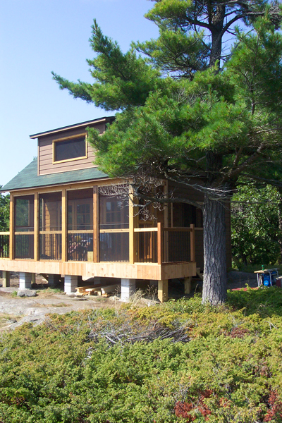

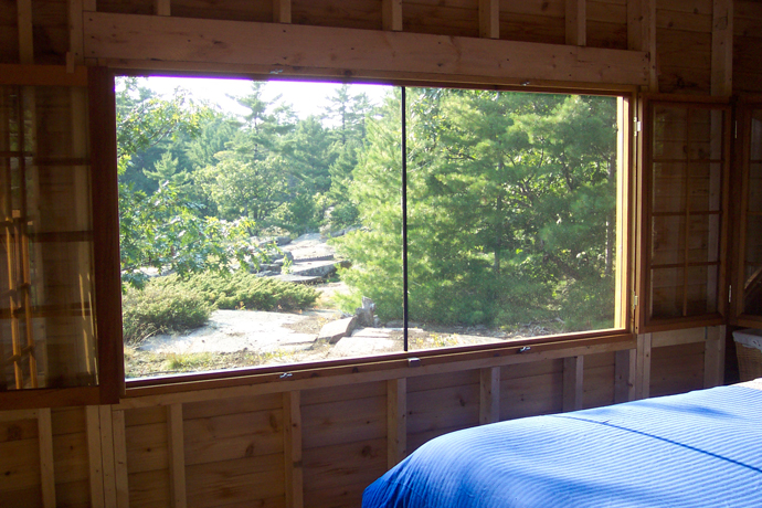

I have signed on to get some info on flashing my windows. The swing in bifold windows are hand-made but were installed without flashing so they leak in driving rain - badly. I hope someone can tell me where to post my flashing question. I assume the windows will have to be removed and reinstalled. I love the look of these windows (summer cottage only) and don't want to replace them - hoping I can fix them. It's a really nice sleeping cabin.

rockies, the rain is wind driven onto the windows and then it pours in at the sills.
Salty, unfortunately storm windows would defeat the purpose of having windows that open completely. They are designed so that it feels like you are in a screened porch when the weather is good. As a summer cabin, air-flow is important. I am unsure how flashing is installed so I am not sure how the way these windows open affect it. Thanks

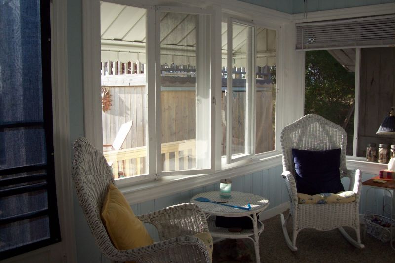

# Posted: 22 Mar 2017 11:20pm
I have similar windows in our sun porch at the lake they are hand made and do not leak l will snap a pic next time we go.. do you have a close up pic with the window open??

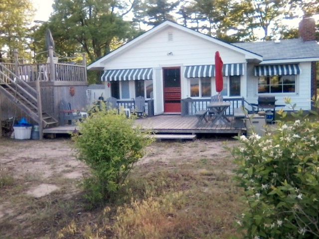

# Posted: 23 Mar 2017 06:05pm
If you can blow this pic up a bit you will see that I cut a 1\2 in dado all the way around the outside edge of the window , I then applied a 3\8 in stop to the outer jam so when the window is shut the stop fits tightly in the dado . I also drilled drain holes in the bottom stop so if any water dose get in it leaks back outside. This has worked well NO LEAKS .. and we get some hard blows off lake Erie . I WILL GET A BETTER PIC NEXT TRIP
