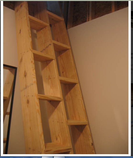

Thats what I was suggesting, a murphy bed or a futon in the main 1st floor and a ladder to the small loft for storage or additional sleeping options for guest. I figured that stairs would be too obtrusive in such a small cabin. Kind of hard to get around a ladder but you can do something angled more like a stair around 30-35degree angle which would be easier to go up

I am 65 and have a ceiling mounted fold down aluminum ladder rated 350 lbs very solid which fits into an opening large enough to pass sheetrock etc upstairs. I dont see the problem with the ladder when up there is more room. I built it entirely myself with the exception of the excavator who specialized in septic tank instulations dug it perfectly had to do no shiming of the forms I build. A paid a truss company to make the trusses cost $950. set on the building. I hired two carpenters to help set the trusses and help me put the sheathing on the roof. The rest I did myself. woops I hired two concrete finishers to help me pour and finish the slab $500.
