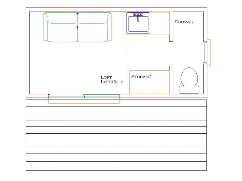

 Seesaw,  that 8x16 plan may really work for you.  If you have kids you can put them in the loft and use a futon down below for yourself and have a nice couch during the daytime.  Since you wouldn't be on a trailer and won't have the wheel well I think I would use a 6' sliding glass door for the solar window.  You can make a sliding wood door on the exterior that will protect the glass door when you are gone.  Put a deck in front of the sliding glass door.  If you get too much solar gain in the summer you can build a pergola over the deck and use greenhouse cloth to help control how much sun you get.  Remove the greenhouse cloth in the fall/winter/spring.  Square off the wall where the current entry is.

 Beautiful!

 Just in time. I've been drawing this house to scale and it's such a pleasure to see it built! I used your idea of sliders and deck in the front and it's working out nicely.
