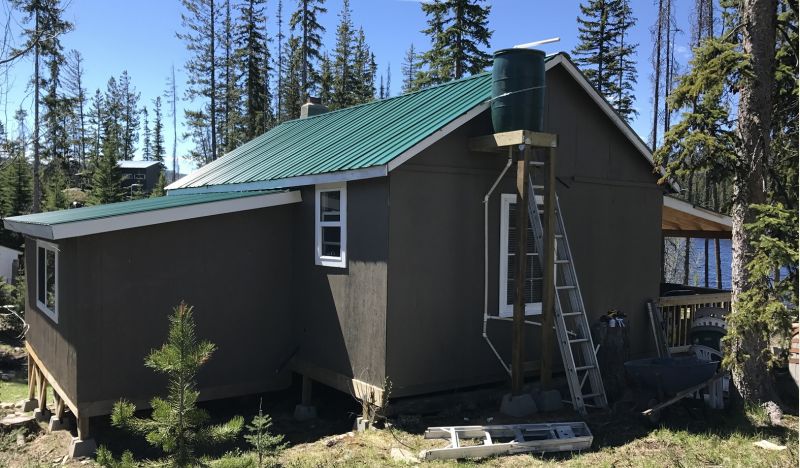

Spring has finally sprung! Spent a few days on the project.
1st step was building the water system for the cabin. The idea being that it would be this same system that's used to fill the tub. Everything worked out great. The design is pretty simple. Oldschool gas powered briggs and stratton water pump, 1.5" water line, and a 50 gallon barrel on the roof (sorta). There is a T in the line that will be used to fill the tub. Very pleased with the results, gravity fed water is ample flow (careful consideration into fixtures and plumbing used to maximize flow with low pressure) and the barrel fills in only a few minutes.

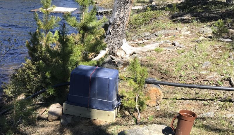

# Posted: 30 May 2017 12:09am
Here's a pic of the pump. Well, not really, it's a pic of the pump enclosure with the lines running to/from the pump. Forgot to snap a pic with the cover removed.
It's just some pressure treated lumber and a rubermaid tub as a cover.

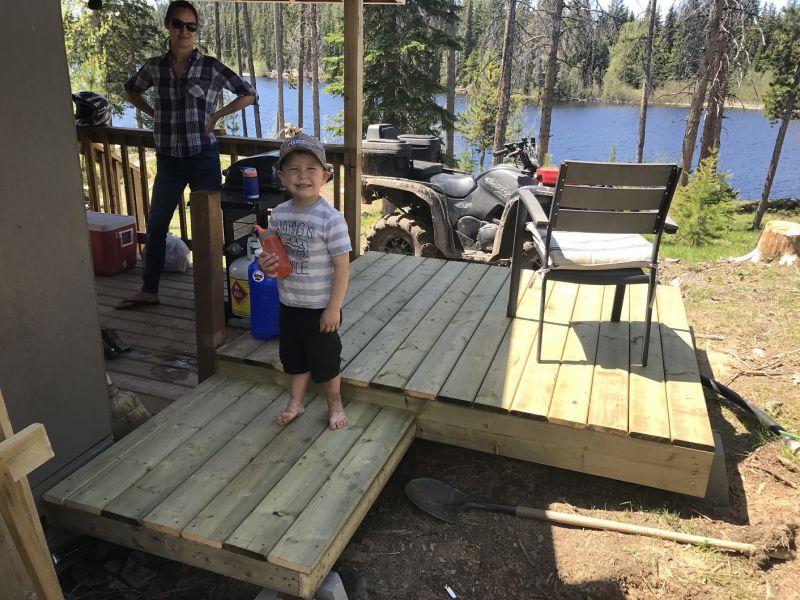

# Posted: 30 May 2017 12:11am
Also got the decking built. Nothing fancy here. Pressure treated lumber and lots of deck blocks to handle the weight.
Smallest shop foreman and SWMBO approved!
