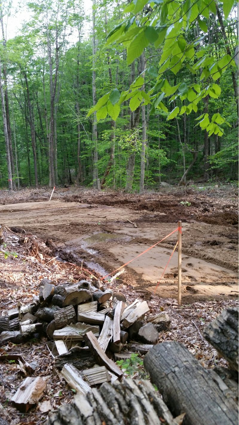

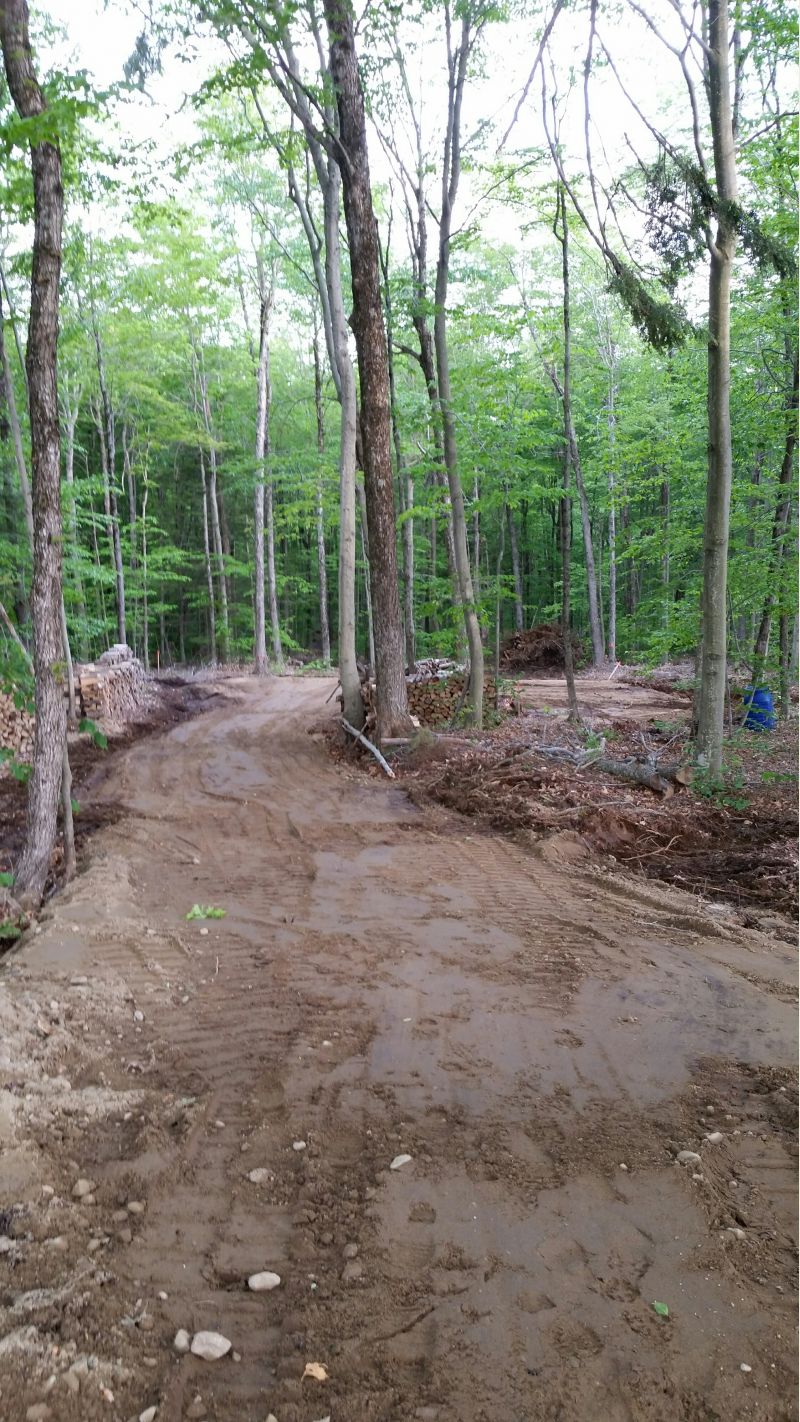

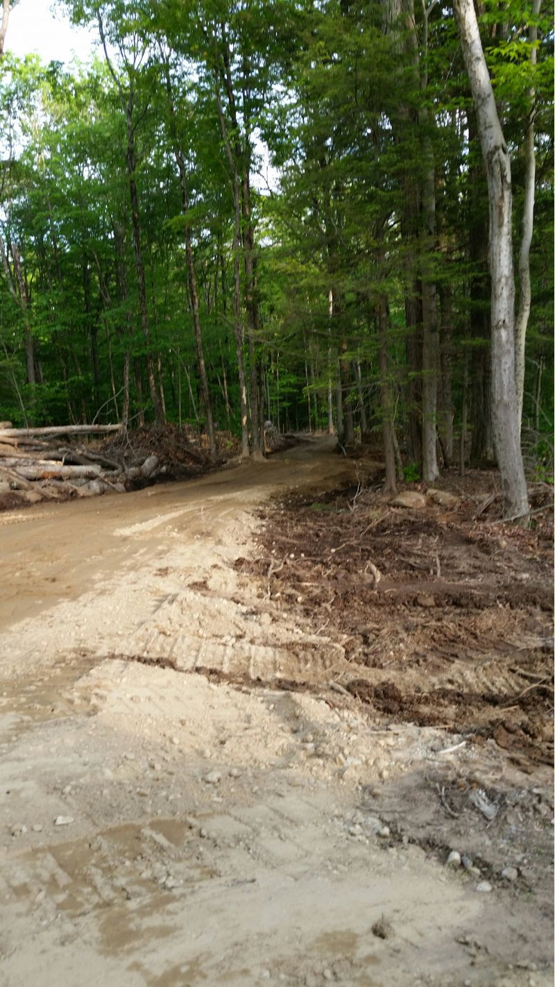

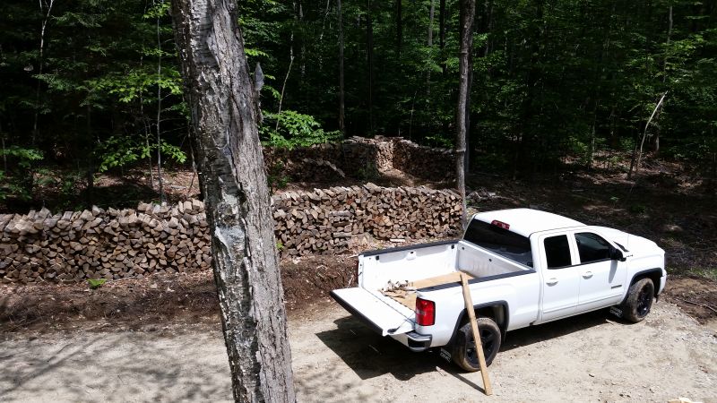

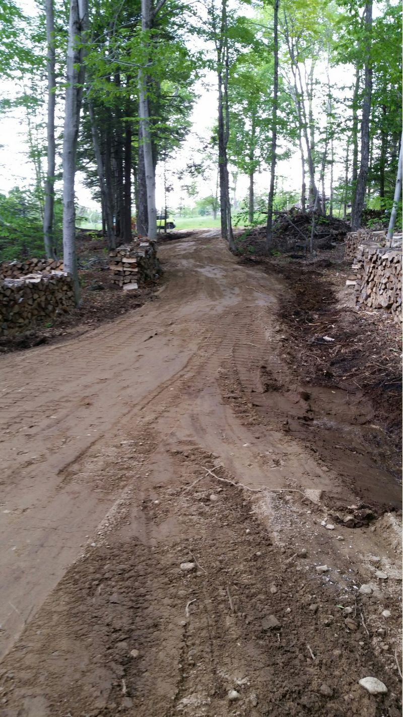

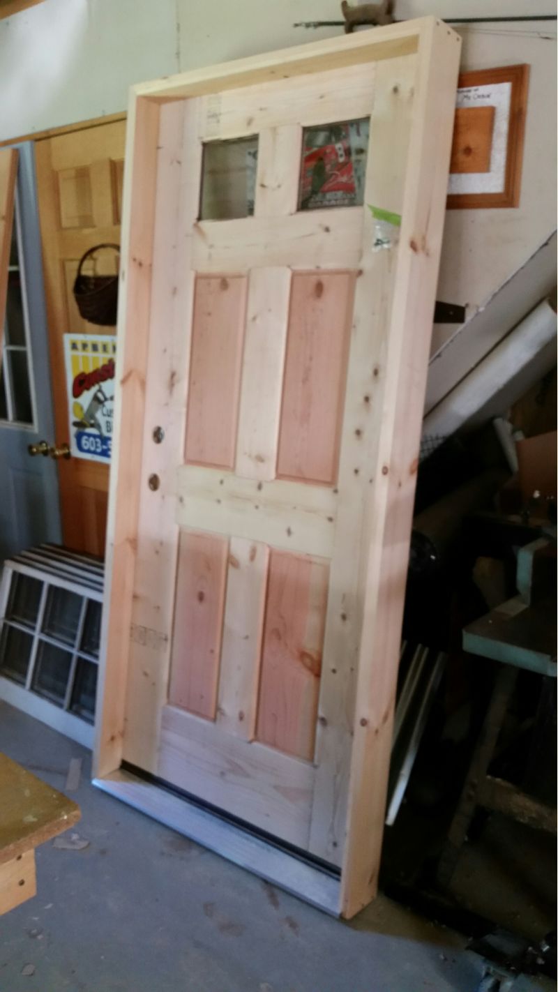

 Well, Wednesday was a monsoon of rain here. The excavator did show up and pulled all the stumps and roughed in the driveway and building site. When I showed up after work, it looked like a swamp. He planned on coming back on Thursday, but upon arrival, it was still too wet. Planned on Saturday. I arrived on Saturday morning and he was there spreading gravel on the driveway. My Dad and Grampa showed up to try and get the water in. This is where we ran into some bad luck. The vein of water was running in on ledge. We couldn't get down to build a reservoir, and couldn't get down in to get a pipe in the ground. Plan B-Grampa dowsed a new location. Only issue is, he doesn't like putting water in this time of year because the water table is usually high due to the seasonal rain. This year has been way above normal. We ended up digging and hitting 2 veins of water that was pouring in. We decided to leave it until Fall to see if the table drops. The excavator then went back to work on the driveway and cabin site. We took a ride back up that evening and was very pleased with his work. My dad and I spent yesterday building a jamb for the Shamp door. We prehung it and bored the knob and deadbolt holes. Fingers crossed that things will dry out a little more this week so maybe, this weekend we can pour sonotubes.
 |  Driveway looking towards road
 |  Shamp site
 |  Driveway looking towards Shamp site
 |  Road looking down driveway

 Updated pic of Shamp door in its jamb.

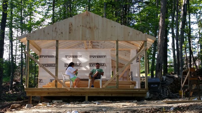

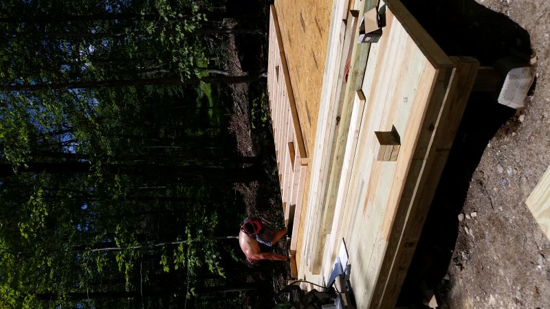

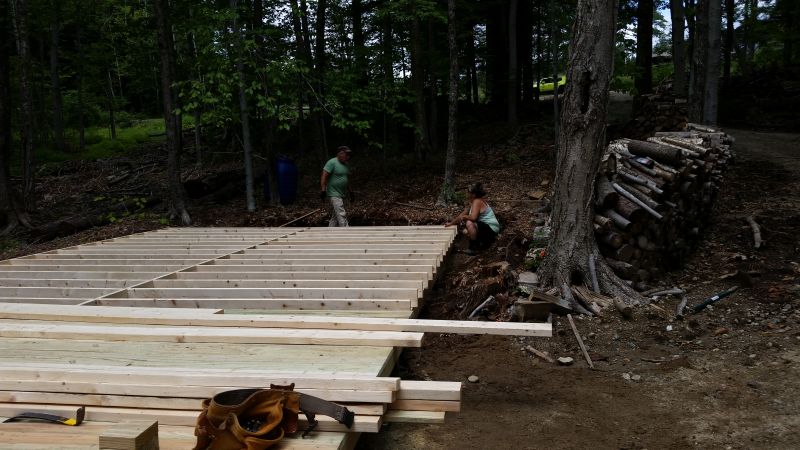

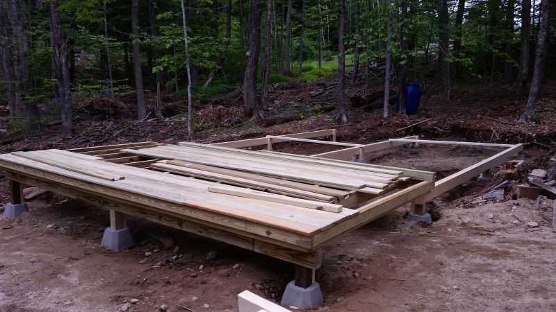

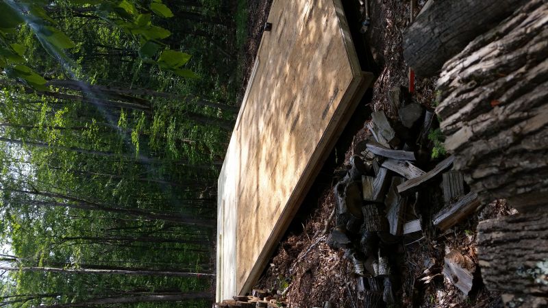

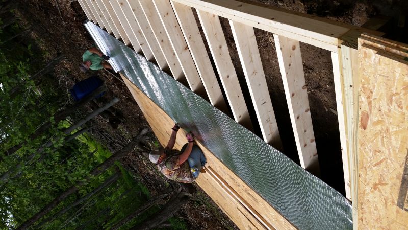

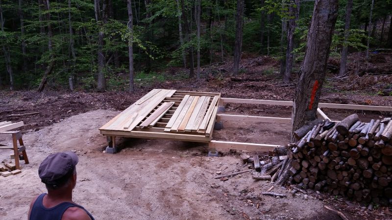

 Day 2 found us back picking up lumber for the cabin deck. My wife, my dad, and myself got the deck framed, insulated with the bubble foil and decked.
 |  Framing
 |  Insulating
 |  Finished

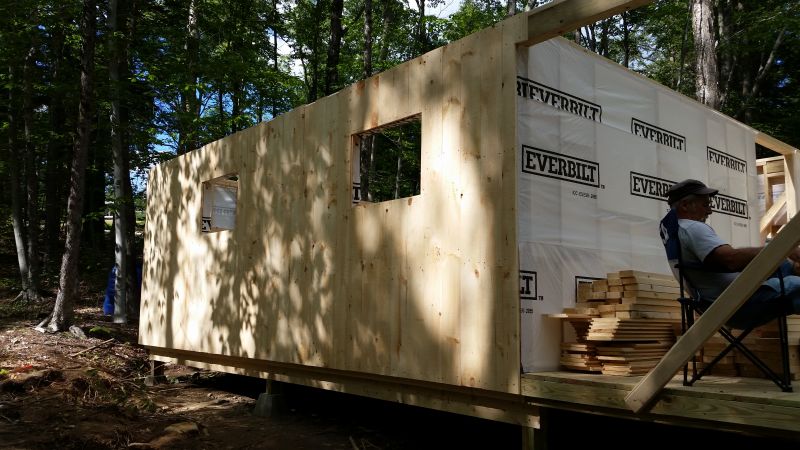

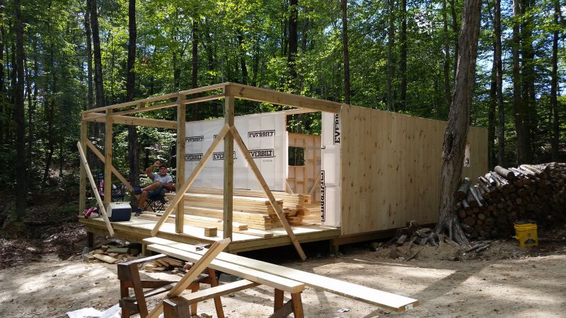

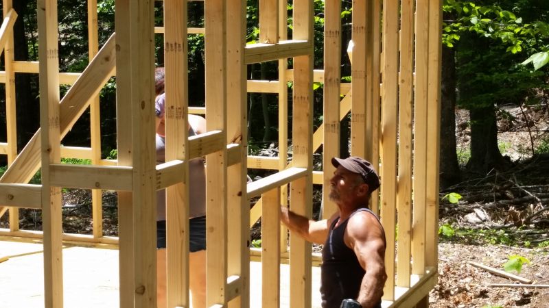

 Day 3 and we have to hit Home Cheapo because the lumber yard is closed on Sundays. We spend about 2 hours picking out lumber. We finally get started on the exterior walls.
| benny8 Member
 | # Posted: 14 Jul 2017 04:09am - Edited by: benny8 Reply

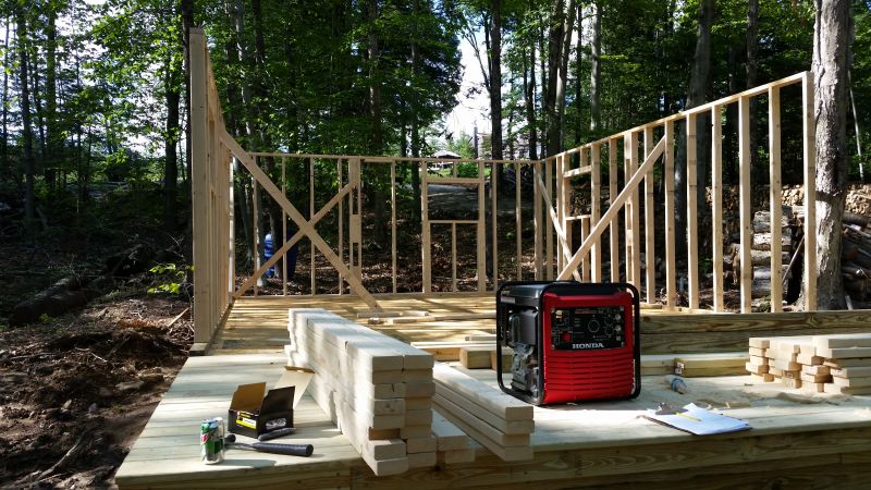

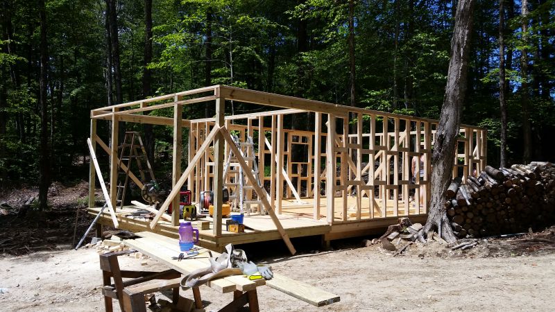

 Day 4 was a short day due to a Drs appointment and therapy, that would eventually get cancelled. We went to work, but would have been better served going fishing as we could not do anything right. Think we got the final wall built and the porch framed.
| benny8 Member
 | # Posted: 14 Jul 2017 04:20am Reply

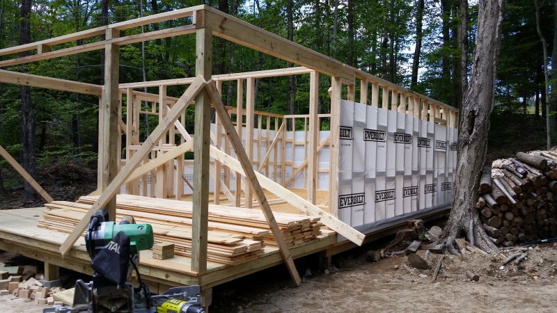

 Day5-Independence Day. My daughter and I loaded the truck with 600 board feet of Shiplap and picked my dad up. We started by plumbing the walls and blocking them for the shiplap. Day ended early when the nailer blew the trigger valve. Oh well, we had a cookout to get to. We actually got it partially wrapped as well.

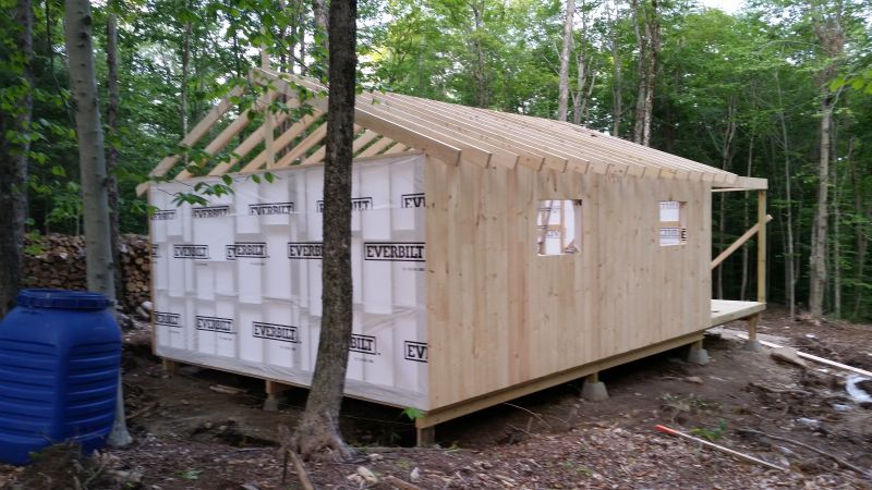

 Day 6- Back at the local lumber yard. 2 hrs to pick thru their rubbish lumber for rafter material. We also picked up the new valve for the air gun.We finished the blocking,  got it wrapped and 2 sides shiplapped.
 |  Fully wrapped and 2 sides boarded
 |  Dad and a well deserved brewskie
 |  Brook side wall

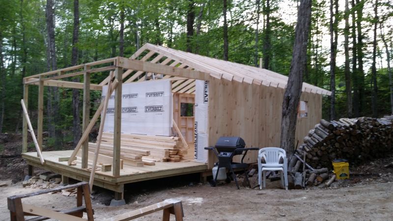

 Day 7-We got our rafters all cut and set on the cabin portion. Sarah and Mom came up and cooked us an awesome dinner on the grill. Steak and potatoes.
 |  Rafters up on cabin
 |  Rafters
| benny8 Member
 | # Posted: 14 Jul 2017 04:36am Reply

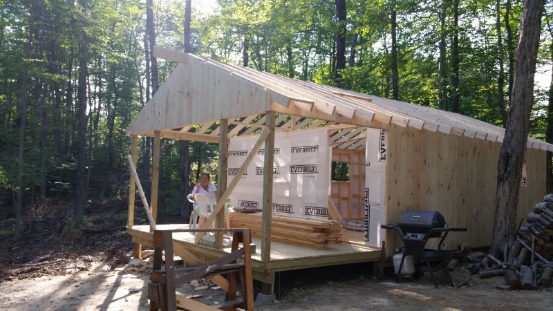

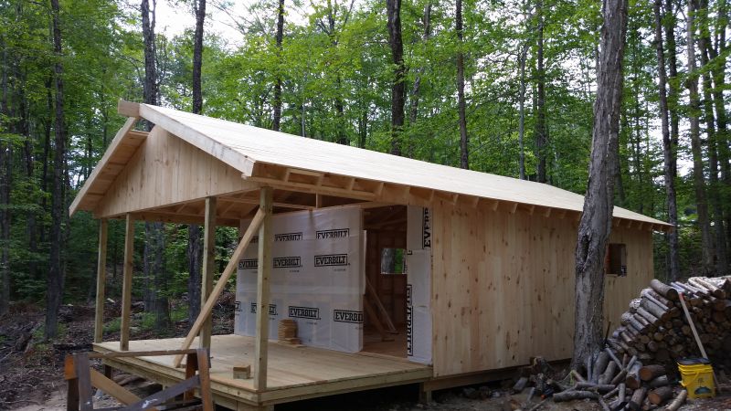

 Day8-We finished the rafters over the porch. Boarded in the porch gable. Boarded the back of the cabin and gable. Sarah delivered pizza and beer for dinner.

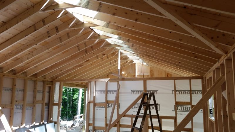

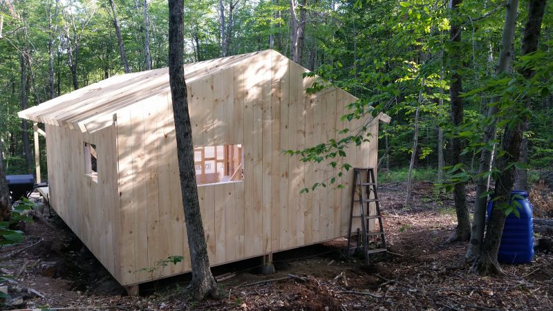

 Day9- We got the roof boarded up until we ran out of material.
 |  Inside looking up at ceiling
 |  Roof

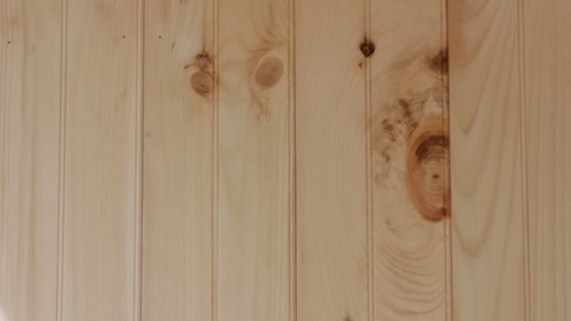

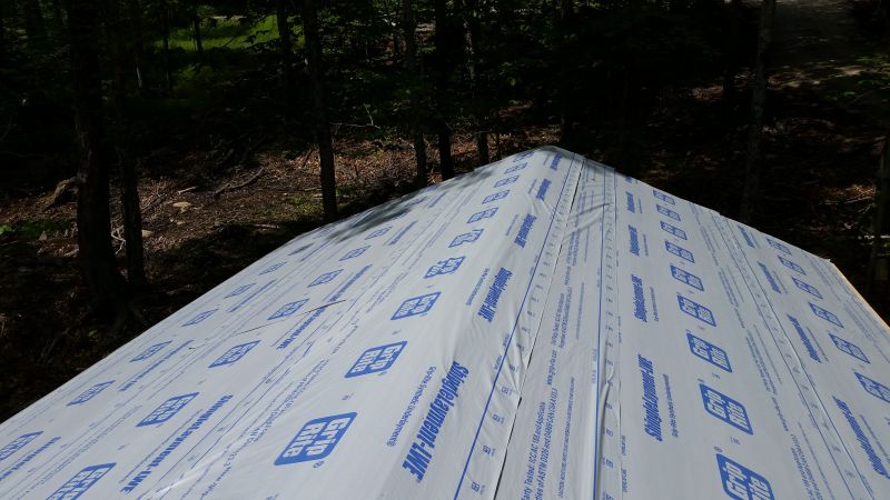

 Day 10 was spent mostly on the road. Drs appointment and therapy. Then on a hunt for shiplap. I get a good buy on planer outs from a buddy at a local mill. But unfortunately,  I couldn't get a hold of him. So, I bought directly from the mill. 40 cents a board foot is not bad,  but his price to me is 18 cents. Anyway, all I could get was bead board/v-groove. It will work for the cabin. Price was right. We finished boarding the roof and got it covered with the grip rite paper

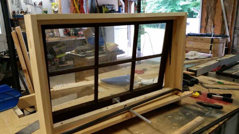

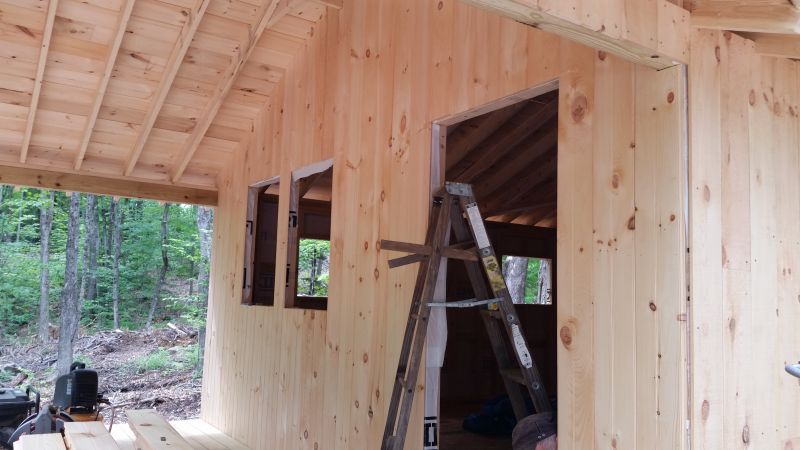

 Day 11-My dad had to take my Grandfather to the drs so I worked on the screens for my homemade awning windows. We then went up to the Shamp and boarded up the front wall and gable of the cabin.

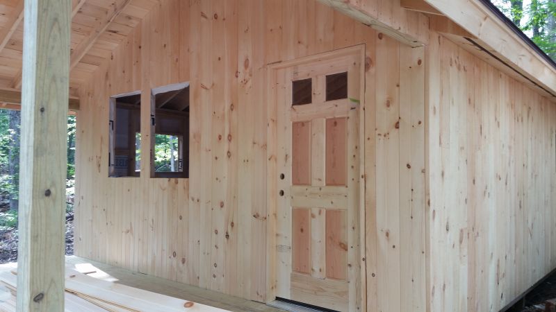

 Day 12-Dad played golf this moring and I finished and installed the screens on my awning windows. We then went and installed the drip edge.  We boarded up under the rakes and installed the soffit vents and soffit boards.We also temporarily installed the door.
 |  Drip edge
 |  Door temporarily installed

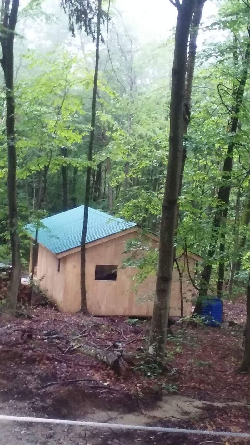

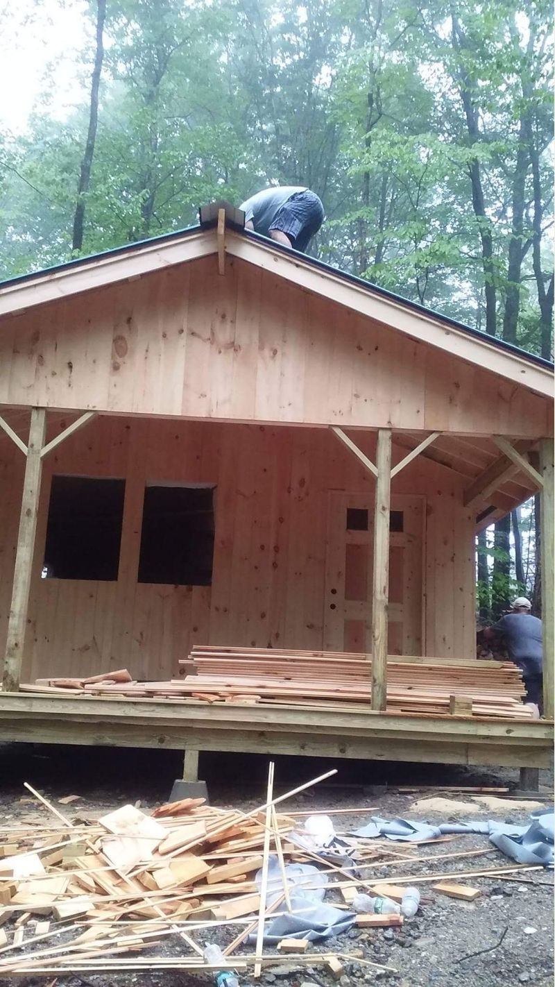

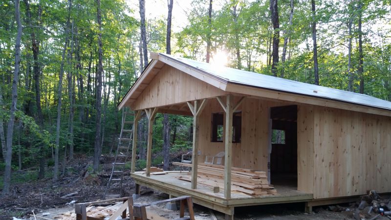

 Day 13- It rained most of today, so i got my ATV implements in the mail the other day and I assembled them. I will soon be putting in my food plots. Finally the rain let up, so we went and picked up the metal roofing and headed up to the Shamp. Sarah, Dad and I put it on in less than 2 hours. We got one side finished, and had just started the other side when the rain started again. How my dad stayed on the roof is beyond me. We got it done, though.
 |  Superman on the roof
 |  Roofing done

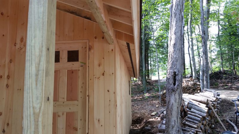

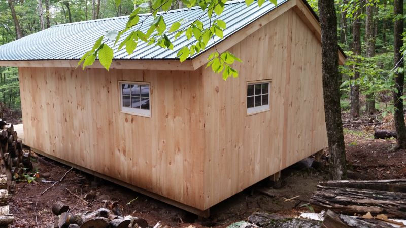

 |  Windows in
 |  Back windows
 |  Front porch cleaned

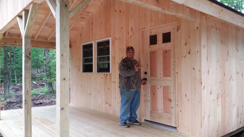

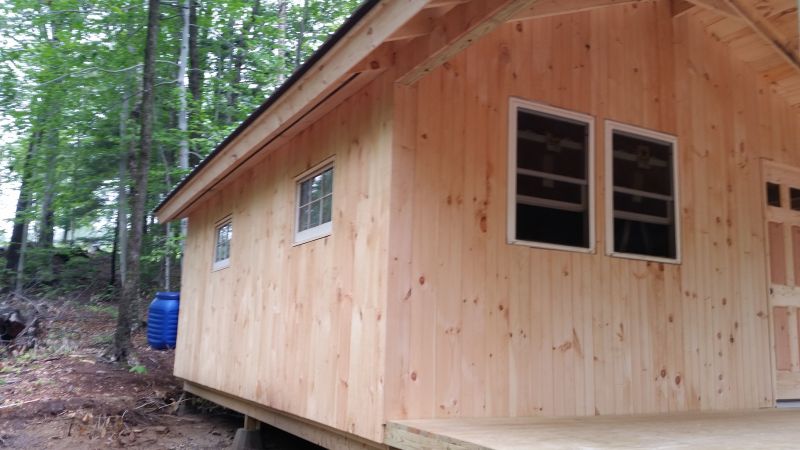

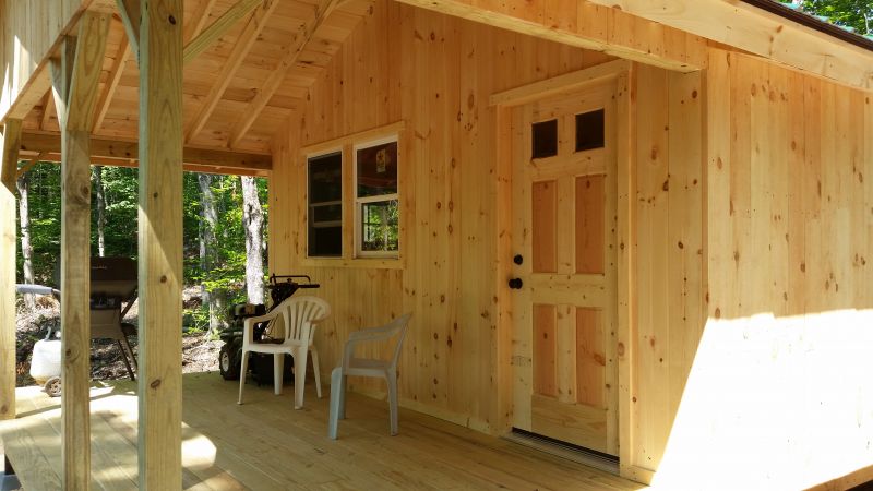

 We finished the exterior yesterday.  It is now weatherproof.  We had about an hour of trimming the windows and door. We met my goal of having it finished by the end of my vacation(16 days). We worked 14 days and about 70 hours.
| benny8 Member
 | # Posted: 17 Jul 2017 04:52am Reply
 Some finished pics

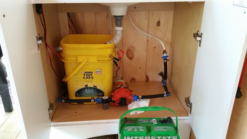

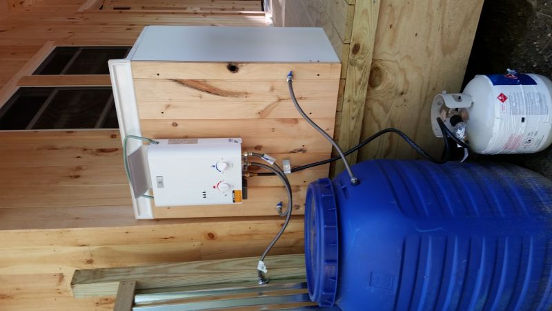

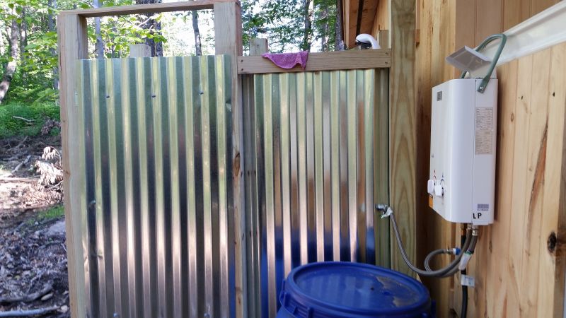

 We spent the last couple Saturdays working at the Shamp. We put up the plywood skirting. Built a ramp and an 8' set of stairs.  This Saturday,  I framed the bedroom walls, got temporary running water hooked up, and built the outdoor shower. Hooked up my Ecotemp L5 hot water heater and it worked like a champ. Spent Saturday night there with the wife and the pups. Life is good.
 |  Under sink pump and plumbing
 |  Water barrel and hot water heater
 |  Outdoor shower
 |  The pups

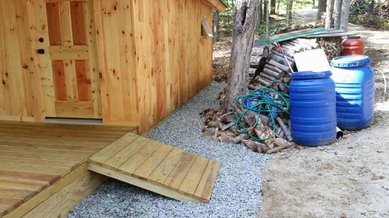

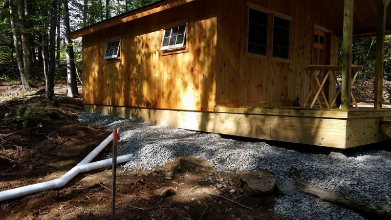

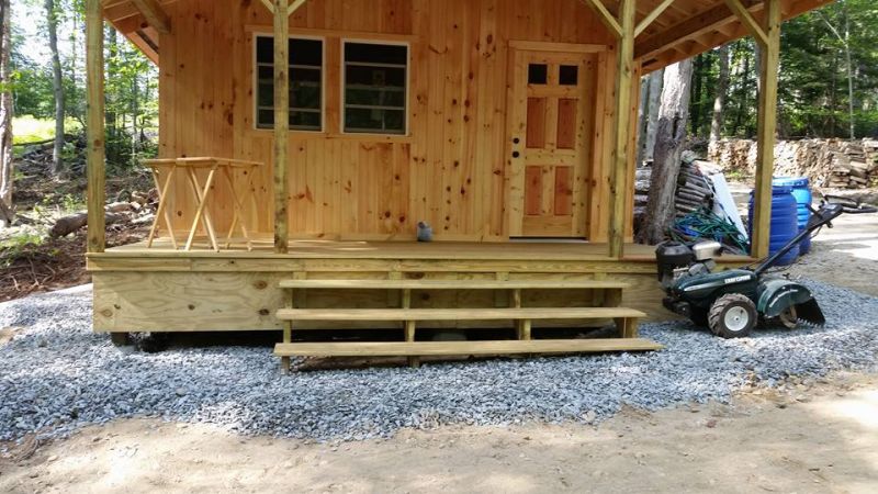

 My folks put the Thompsons water seal to the exterior and it really turned it into a nice color. The excavator came back and extended the driveway so now we can turn around. dropped me off some crushed stone to cover the perimeter drains. My dad and I spread that last night and we are now ready for the guy to cover the solid pipes and finish grade. things will be coming to an end soon due to hunting season and my folks will be headed back to Florida for the winter.
