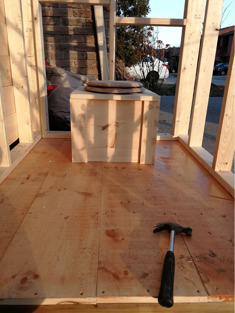

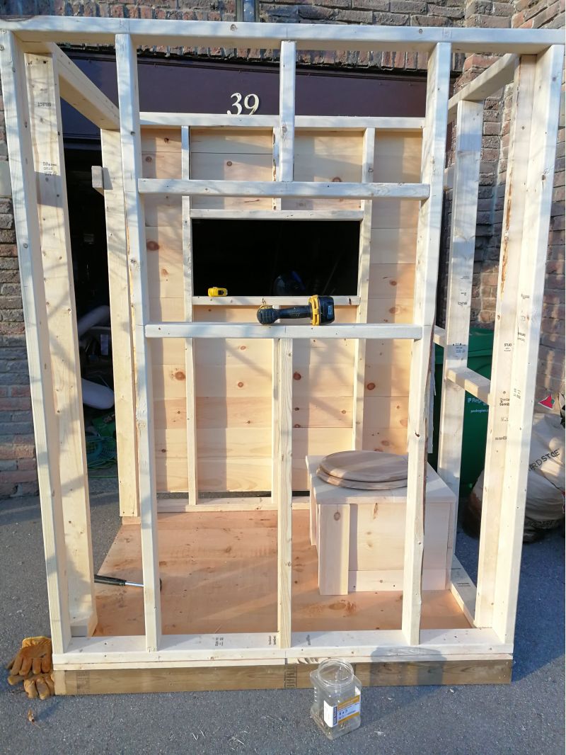

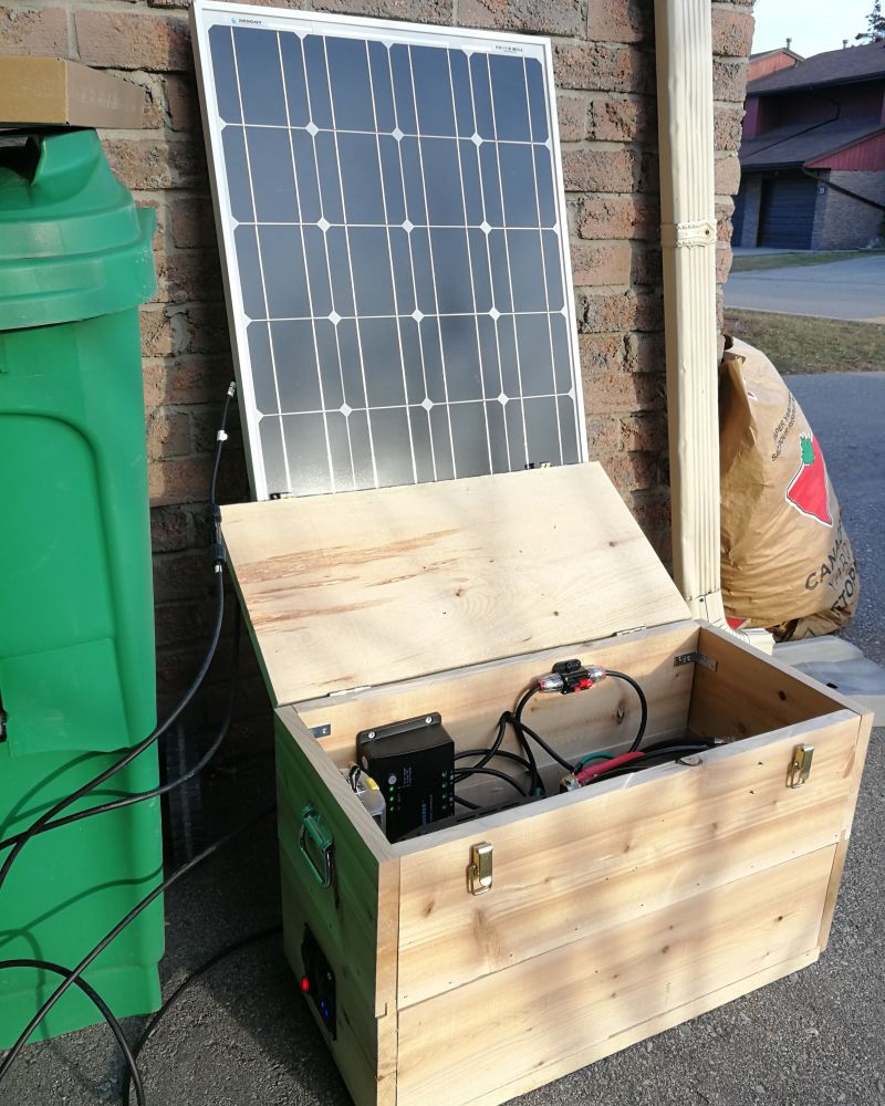

To keep myself busy I started a few projects.
#1 - The Privy - Fairly simple 4x5 build. I am building it at home and will take it down into wall and floor sections when I drive it up. I have to store it in sections in my garage also as I don't have great height.
#2 - Sawdust toilet. Based on my land and preference I am going for a sawdust style composting toilet. You can see it on its own and in the outhouse.
#3 - Portable solar system. I wanted a small source of power for the basic needs we will have at this point. As well I built it to be portable and later be connected to our bunkie for our main power source. Pretty simple, 100w panel, inverter for a few tools and charging, 12v outlets off a bus/fuse box and a single 12v 70ah battery.
Now I have to focus on finishing up the privy. Got to do the roof, rest of siding and build the door, plus a few little things on the inside but that likely can be done once its on the land.
