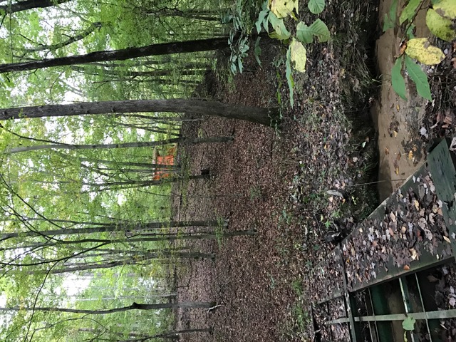

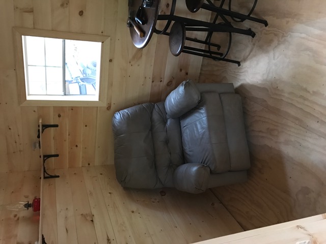

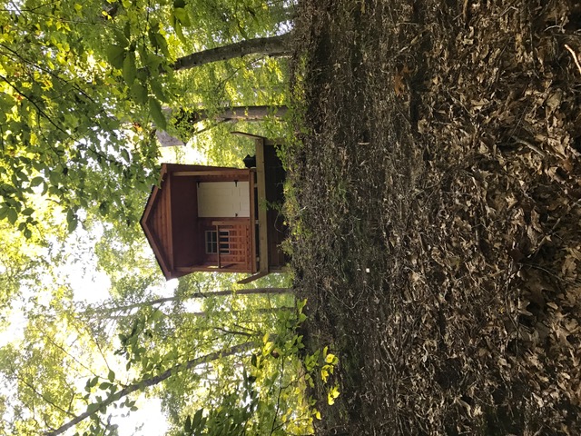

Here are a few pics of my 8x12 (8x8 interior) Still a work in progress

Any recommendations on how I should insulate the ceiling? Its a shingle roof, plywood w/ a thin foil radiant barrier then 2x4 rafter's 16'' o/c. No gable vents. There seems to be some sort of ridge vent "I think" from looking from the inside. I'll have to take a closer tomorrow. If there in no ridge vent, then what? There is a small gap along the soffit ends.
# Posted: 29 Oct 2017 10:21pm
Is there a loft or plans for one? Are there ceiling joists ?
How tall are the walls ?
Jaybird
# Posted: 30 Oct 2017 12:16am
Loft area over the porch. Storage room only. No joists, just 2x4 rafters. Walls are about 8 foot tall.
# Posted: 30 Oct 2017 09:49am
You can get some insulation in the ceiling by cutting 15 in. wide 2 in. foam and instaling it between the rafters . tape it in place with packing tape then seal the edges with canned foam . this will leave you a 1.5 in. air space to ventilate the roof ,make sure you have a continuous venting system . Now you can cover the ceiling with a finshing materal .
If the loft area above the porch is not large enough for a bed you could create a new loft at the back of the cabin just above the window and build a table and resterant style booth under the loft . some folks here have done that.in very small cabins I can't find their threads at the moment perhaps some of the other members will help.
Jaybird
# Posted: 30 Oct 2017 11:45am
Just - I appreciate your comments and help.
# Posted: 30 Oct 2017 02:54pm
Wood ceilings can make a small cabin very dark, white moisture resistant drywall or a white washed wood can realy help.
