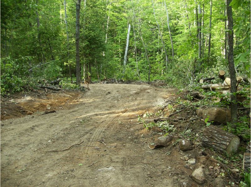

 Did some improvements to my road into the 2 acre property...

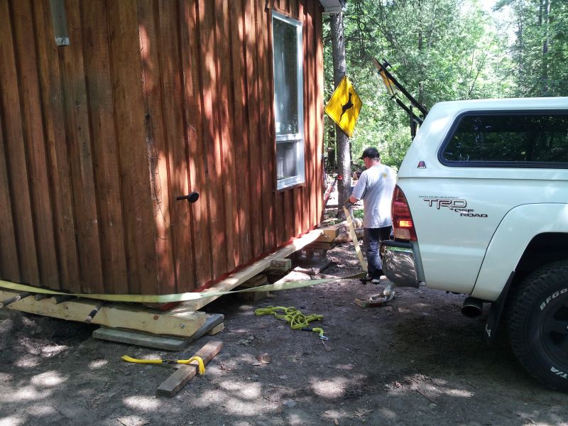

 Then it was time to get rid of my mouse infested trailer for good...

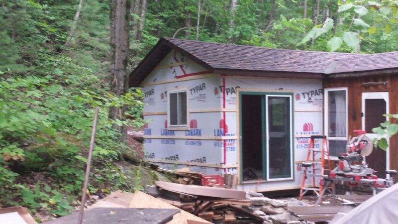

 After getting rid of the trailer and moving the addition a tad, it was time to start the new addition! First I got a mini back hoe to clear and level the land...lots of rocks to deal with!

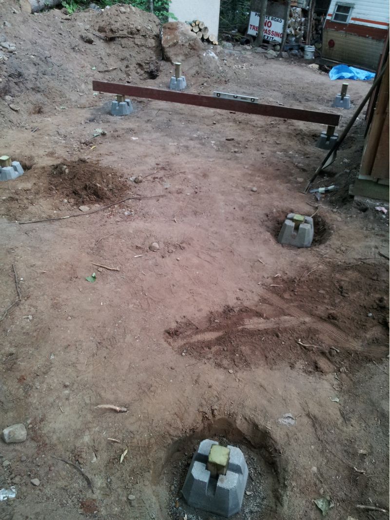

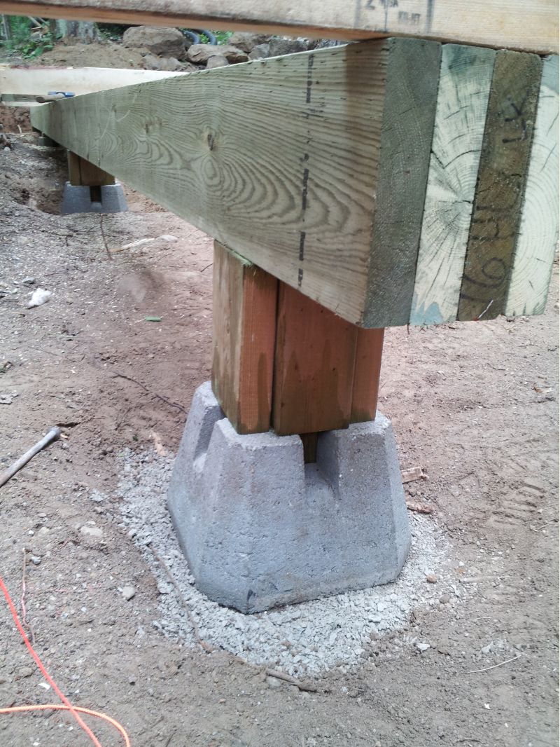

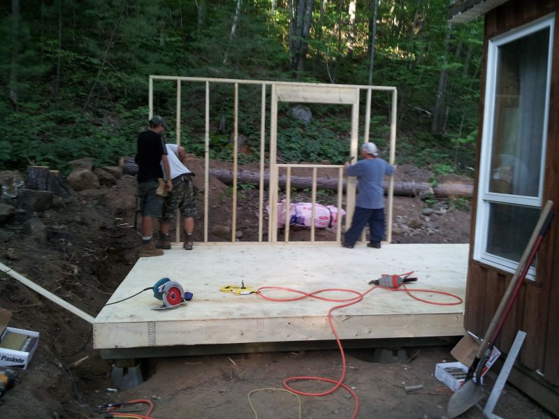

 Then we set some deck blocks and started the foundation

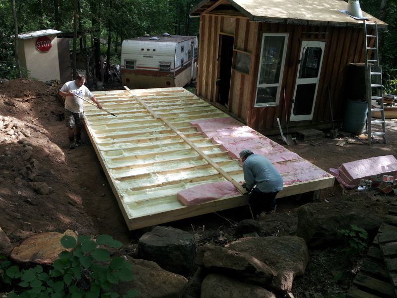

 I went with the expensive diy spray foam and the added r-20 so the floor wold be super warm...

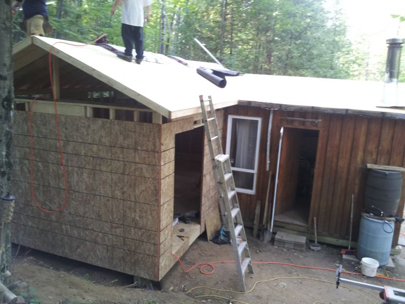

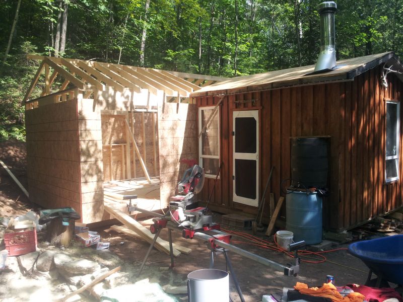

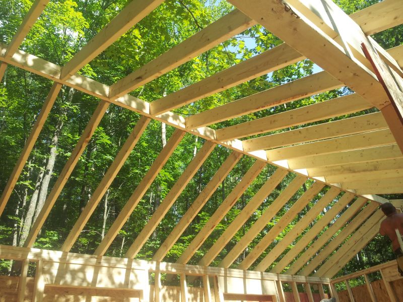

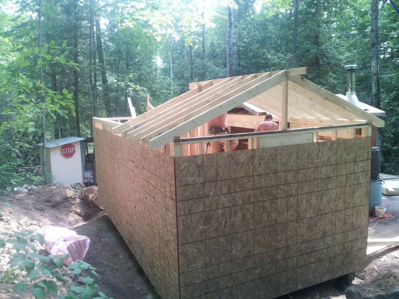

 Then came the fun part...framing!
| tombiosis Member
 | # Posted: 10 Dec 2017 03:28pm Reply
 My materials arrived on a Thursday late morning, and by Sunday evening we were dried in...3 guys who worked their asses off!

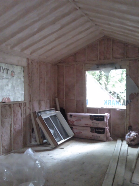

 went with a cathedral ceiling for the new part...which got the spray foam treatment as well... brought in a pro company for the ceiling though...spent a fortune on insulation but I am glad I did!

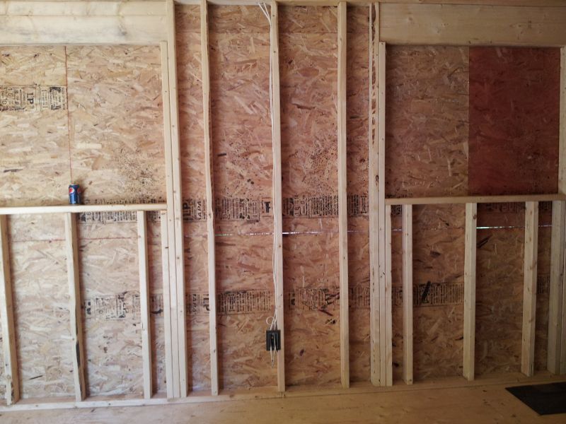

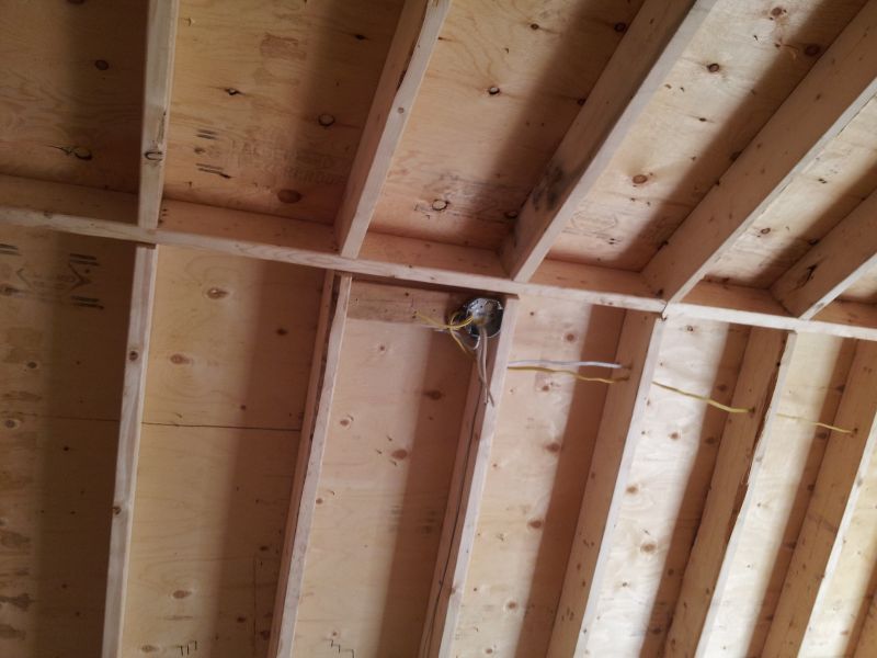

 I wired the cabin to run off my genny...installed some plugs and a great ceiling fan

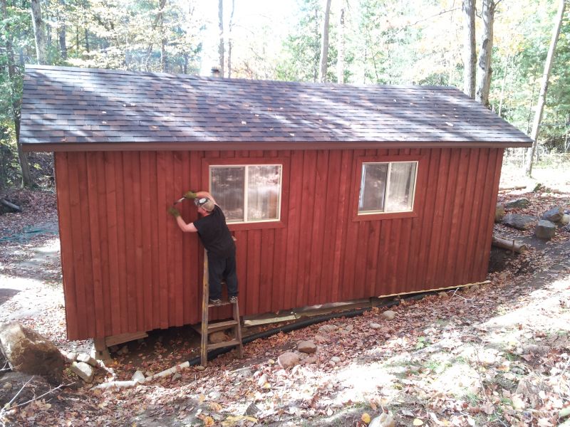

 I bought some rough cut pine to do the exterior siding...the old part was cedar, so it was hard to match it up...but it turned out pretty good.
 We worked really hard to stain all the boards before installing them.

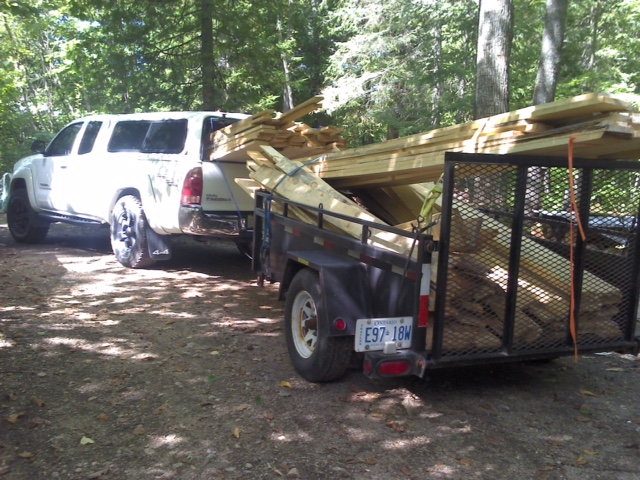

 | # Posted: 10 Dec 2017 06:42pm Reply

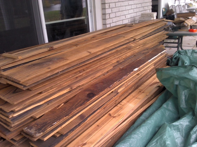

 I wanted to show the load of rough cut pine I bought for a great price for the board and batten siding...I drove the back roads slowly for about 60 kms to get to my camp...what a ride it was! I was scared I would get pulled over the whole time! lol
 But I made it no problem. Turned out I had to go back for more anyways...thought I could get it all in one trip.

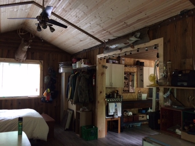

| tombiosis Member
 | # Posted: 10 Dec 2017 06:54pm Reply

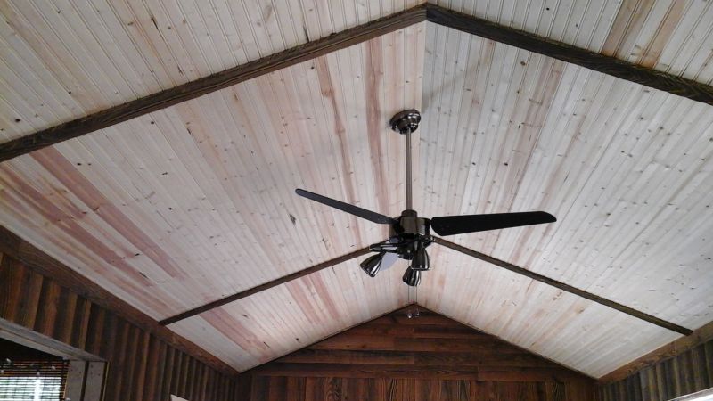

 I picked up some cheap b-grade t&G pine wainscotting for the ceiling, and I used the last of the wall siding to cover the seams of the 8 foot t&G boards to look like mini beams kinda...I used black and brown crayons to rough up the clean cuts on the barn board boards, and it hides the cuts perfectly. This engineered barn board is really cool... I will try and find a close up pic of it. Very unique, and I doubt I could ever find more like it. Oh...and the ceiling fan was installed to center the other room (the 10X12) in order to draw heat from the wood stove in fall and winter. That is why it is off centre to the 12X24 room.

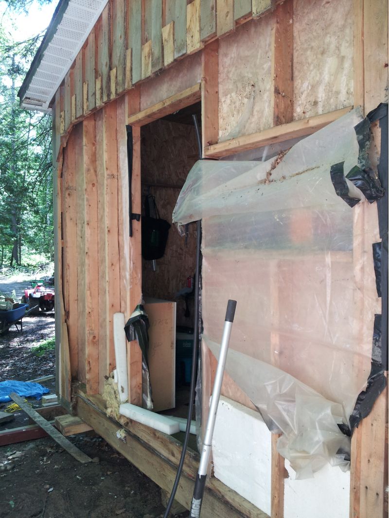

 I opened up the regular door on the 10X12 to make it open concept. My carpenter buddy did an awesome job on trimming around the windows etc...I used thick rails from a waterbead found in the garbage to fab all the windowsills....love to up-cycle!

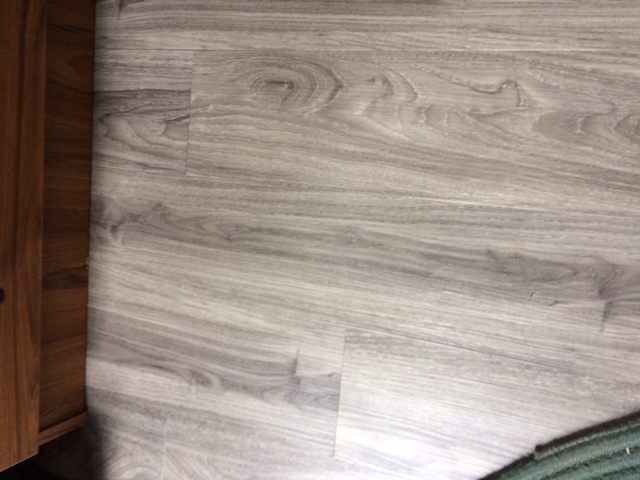

 I went a year or 2 with just a ply wood floor, which was a pain to sweep. Last year I found about 700 square feet of LVP vinyl plank flooring for 500 bucks. I used what I needed and easily sold the rest for 250, so I got a new floor for cheap, and it looks all right...wasn't my favorite colour, but I think it looks ok.  Vinyl plank is much easier to keep clean, and it was pretty easy to install myself.

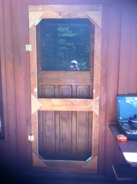

 The original door for the original 10X12 cabin that was attachec to the trailer was always problematic, as it was an odd size, homemade, and very drafty. Last summer I found an old door on line that had a window, and a dead bolt and knob lock that worked...it even included two sets of keys! I drove an hour to get it, but it was only 20 bucks, including the frame!
 I had my carpenter friend fab me up a screen door with the wood from the old door. If you closely in this pic, you can see the gussetts on the screen door has some green plaid wallpaper in the corners of the door. I purposely left the wall paper on the wood as a nod or a tribute to the old trailer. The thin plywood with the wall paper used to be shelves in the camper, and it reminds of how we used to "rough it" everytime I see it.

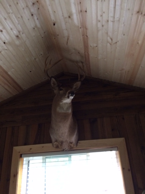

 I always dreamed of having a hunting/fishing cabin where I could hang up my hunting and fishing trophies....and now I have one!

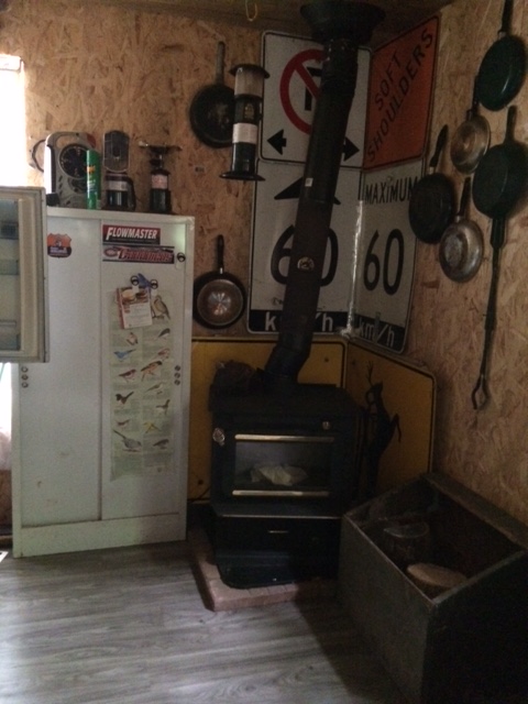

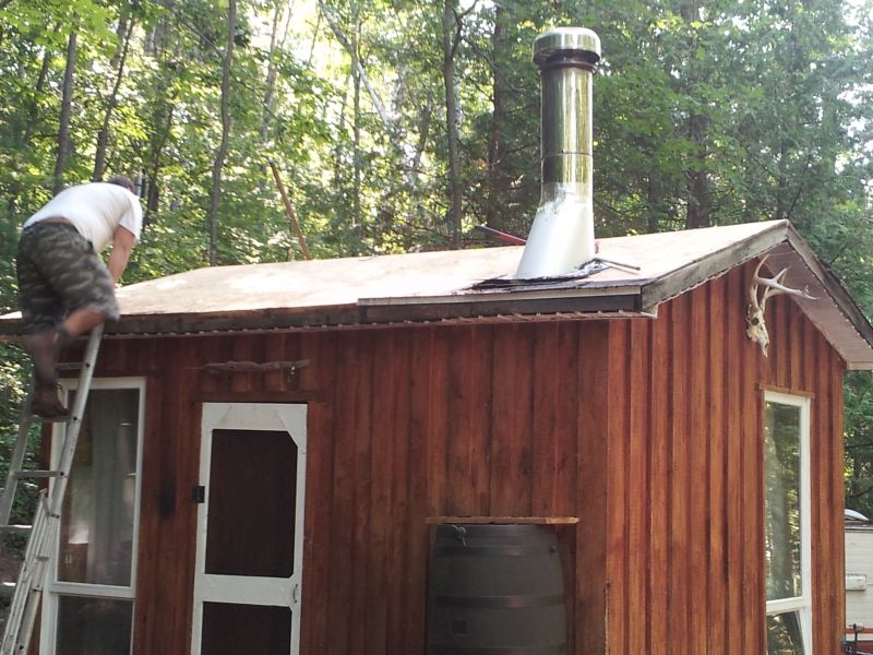

 Last summer I decided to switch out my old style wood stove for a newer air  tight model. I burn way less wood now, and the walls don't get hot anymore. My old box stove went through wood really fast, and the metal wall protection got pretty hot sometimes. I know my clearances aren't to code...but its amazing how much better this newer stove runs. It has a blower on it as well.

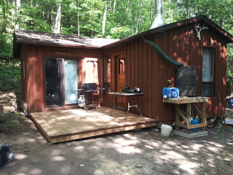

 Last summer I finally got the help I needed to build my little deck, and I love it! I threw up a bit of eaves trough as well. A new water table was built to finish off this year's project.

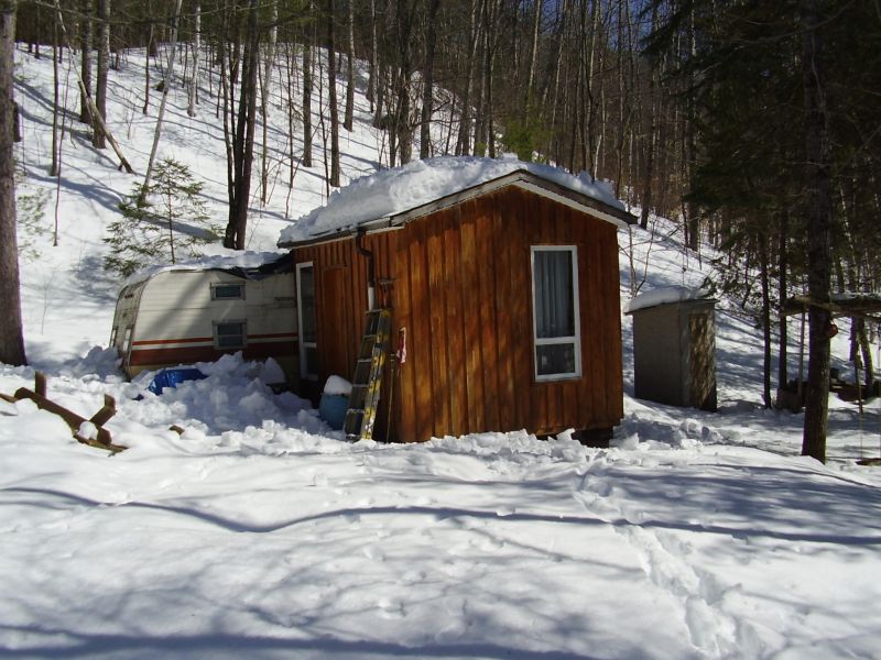

 Remember, the picture above started from this pic...but I must say we had some good times in that old leaky trailer too!
