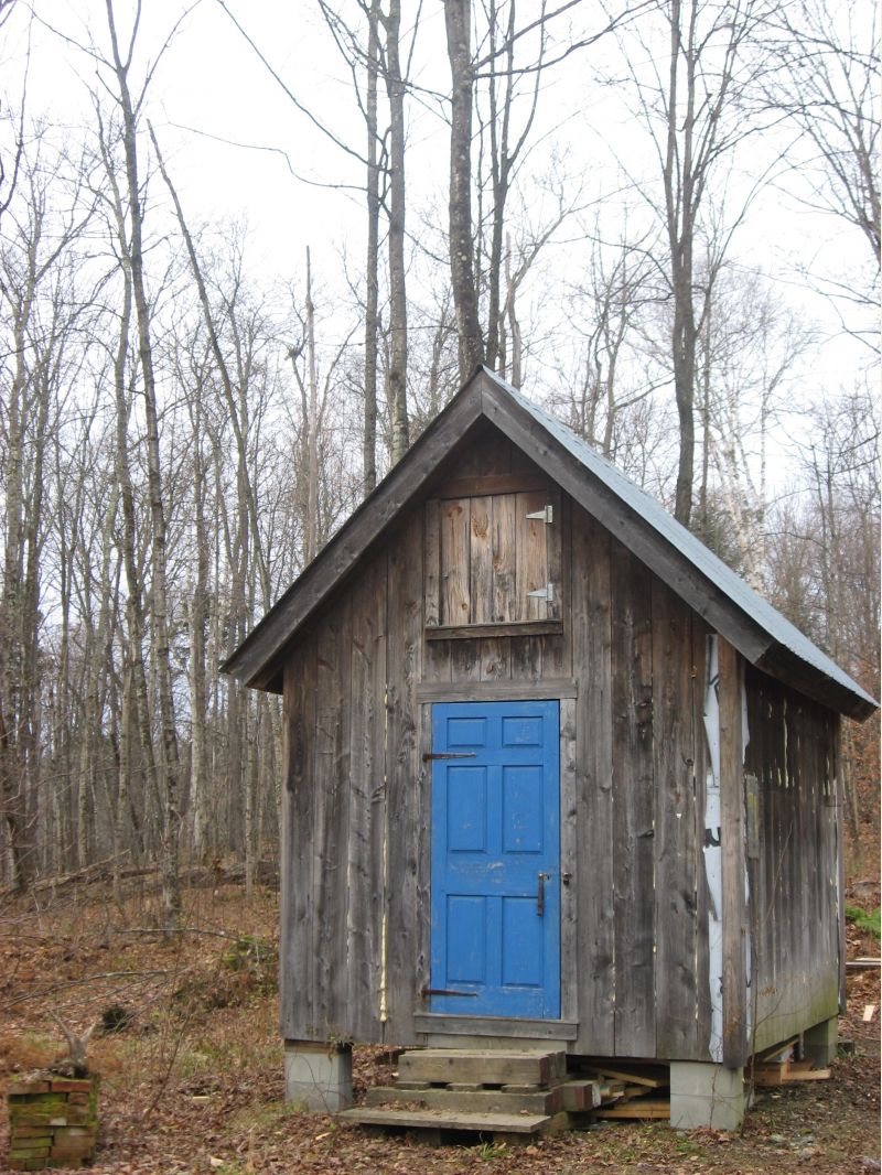

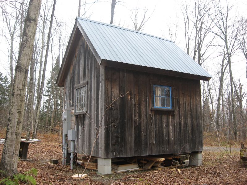

Hi, I'm in rural Vermont and just started building my small cabin. I started with a 10x12 tool shed and added a sleeping loft. I also insulated it and put in better doors and windows. I will be finishing it this winter and will move in in April. I heat it with a small Pro-Com vent free heater, which seems to do the job very nicely. I plan to have a small burner Coleman stove to cook on but was wondering if anyone had ideas on which stove model is the best. I want something that will cook hot, but also has good simmer-abilities and can easily be hooked up with a 6 foot propane cable to a 20lb propane tank on the outside of the cabin.
Thoughts appreciated, here's a pic of my dwelling in progress!

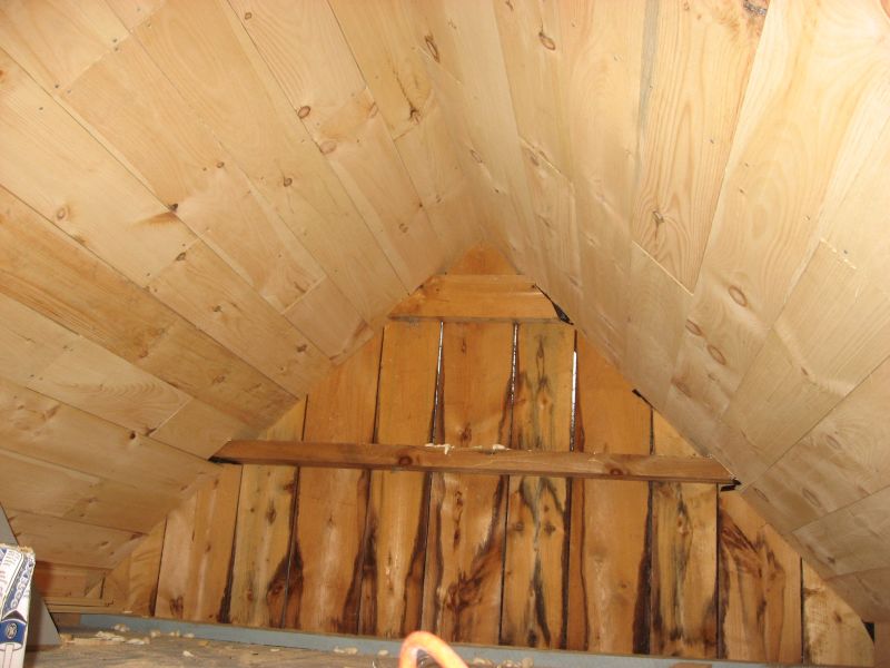

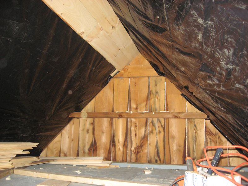

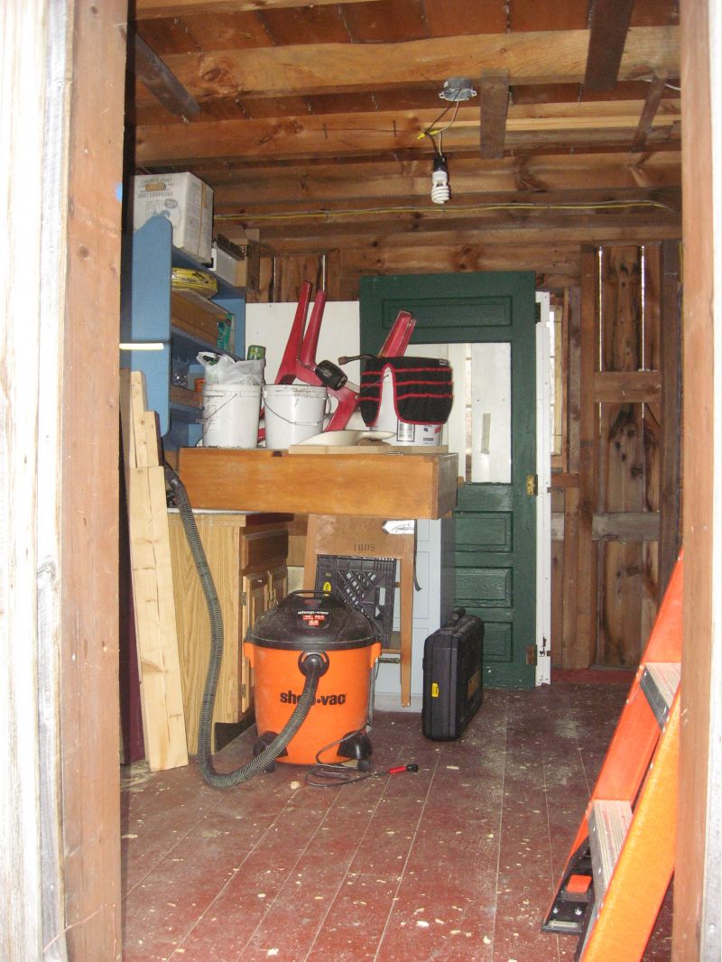

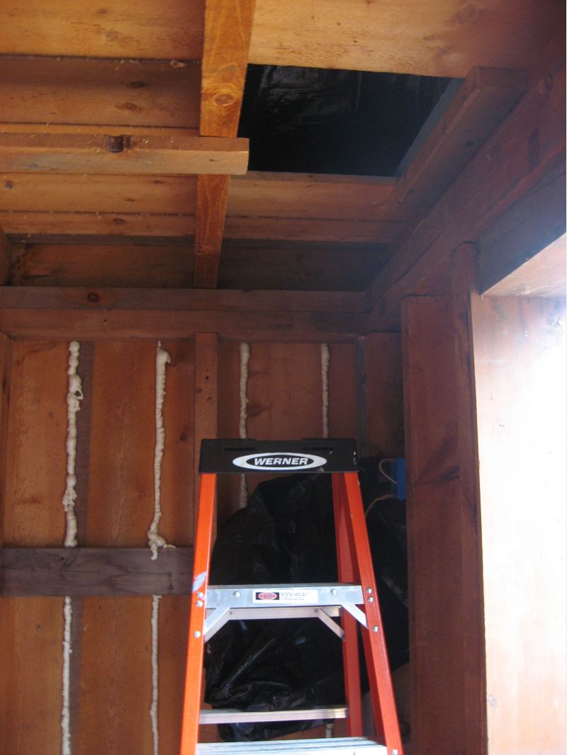

Hey mikeonabike - here are a few inside photo's though the inside still needs a lot of work. the loft is in and ceiling is up, but still putting boards on all the walls. Just got the heat in last week which makes working on it much more present. Good call on the return policies! is your stove hooked up to a 1lb bottle or a larger propane tank?
the finished ceiling
boarding up the ceiling
ladder to the loft isn't built yet
inside clutter!
inside clutter!

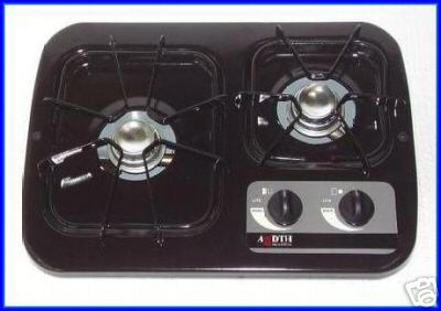

why not look at rv stove tops most are 3 burner much like regular home types .small in size hook up with regulator to a 20# lp tank on ebay used for fair price... my buddy actually uses an rv oven / stove in his cabin works out great.
backattheshack
# Posted: 3 Feb 2011 01:09pm
heres one i found quick on ebay 60.00 plus 20.00 shipping brand new cat beat that i feel many others to choose from

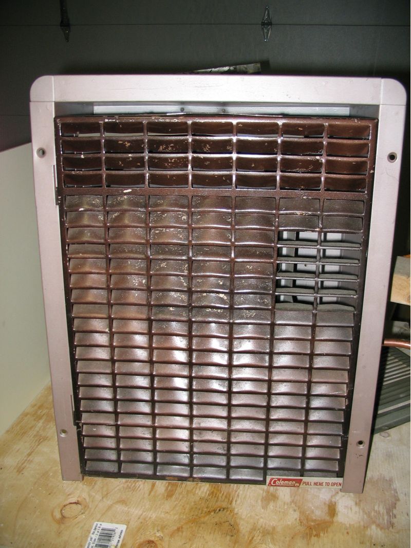

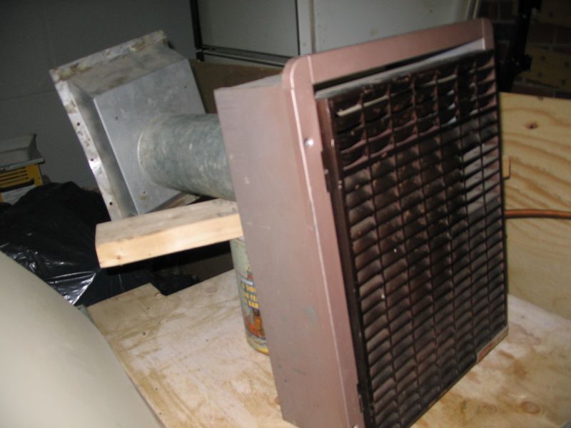

I agree with Mike on ventless propane heaters...too many folks have gone to sleep...permanently.
I understand your challenge though....even a tiny woodstove is often overkill and I have a 100 sq. ft bunkie....so I have the same problem.
My solution was to find a Coleman Gravity vented propane furnace salvaged out of an older RV.
No electricity required...just propane and it vents to an outside wall.
Fresh air comes in....bad air goes out through the vent.
I had a friend recondition it for me...not many working parts...heats up extremely well. Next project is the install.
Just something else to consider!
# Posted: 3 Feb 2011 08:18pm
That's a great idea! Those non electric RV furnaces used to be fairly common. We had one back in the 70's. Check out salvage yards. There used to be some on the web; I haven't looked lately.

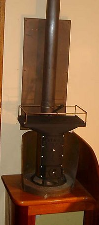

I'm planning to do something similar to this using 8x12 shed plans. I had been looking at a small wood stove made by Vogelzang called the Lil Sweetie which could be had for a a relatively cheap price. I decided that to do this I would need to make my cabin/shed a couple feet longer to accommodate the needed wall clearance for the stove. Then I came across Fatsco stoves which burns charcoal or pea cole and are meant to heat sail boats. They do not need much wall clearance and won't roast me out the door the way a wood stove would have. It costs a little more but I will save on building materials.
I found this picture on the net.
Fatsco
Fatsco
lukabrazi
# Posted: 27 Feb 2011 03:52pm
Oh and it also has a cooktop.

ooh that looks fabulous! I'll have to look into those more. The other thing worth looking at is a pellet stove, which can be quite small and not need much clearance. The one we have at work you can literally put store paper's on top of! For me though the biggest purpose of wood stove would be its free (i live in woods). Maybe some day I'll go a few feet larger in each dimension to accommodate one. Best of luck with your project, if you get one of these I'd love to hear how it works out for you.

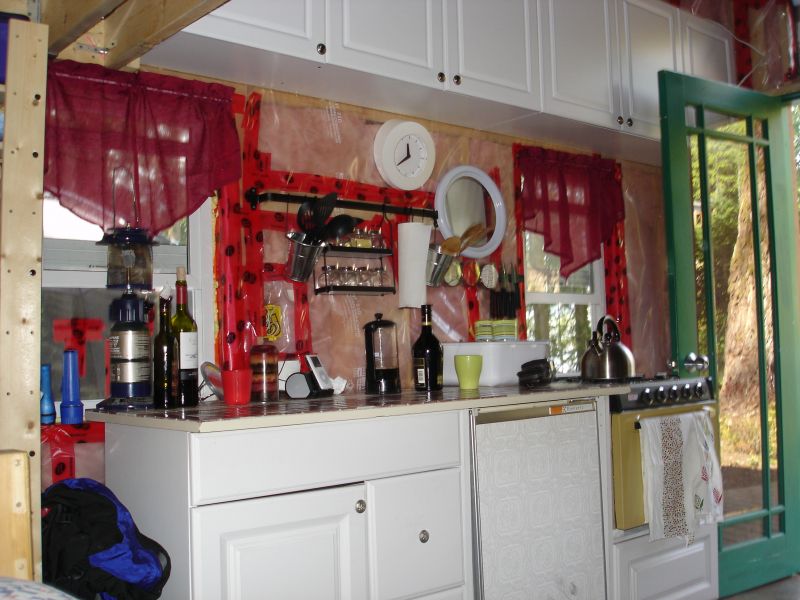

I was reading this reply late, so sorry about the tardy reply, however we are also building a little cabin in the woods. No electricity, so we wanted a propane stove and little propane fridge. We really did this project on a shoestring so we didn`t have the $$$ to buy the appliances, so we instead looked on craigslist until we found someone that wanted to sell cheap a trailer with functional propane appliances. We went with a saws all and a couple of other tools and dismantled the trailer, took the appliances, regulators, windows....basically anything we could salvage and then brought what was left to the scrap metal yard. Attached is a pic of our kitchen:)

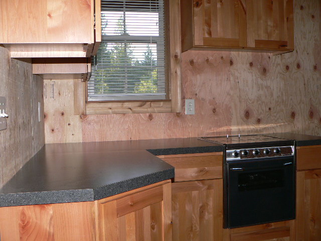

I used one from an RV. Its a Magic Chef 4 burner with oven. It has a stainless top for more counter space when not in use. Its plumbed with 3/8" copper pipe, I used a double flare on the ends and hooked it to a BBQ regulator and rubber whip hose to attatch to the propane tank.
