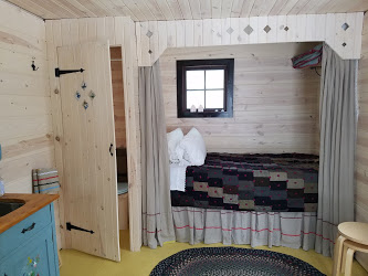

# Posted: 15 Nov 2020 09:39pm
Picture of the bed nook with the "bathroom" to the left. Bed nook has drapes you can draw closed to make it cozy. Bathroom has a little window and a bucket toilet.
bed nook
bed nook
