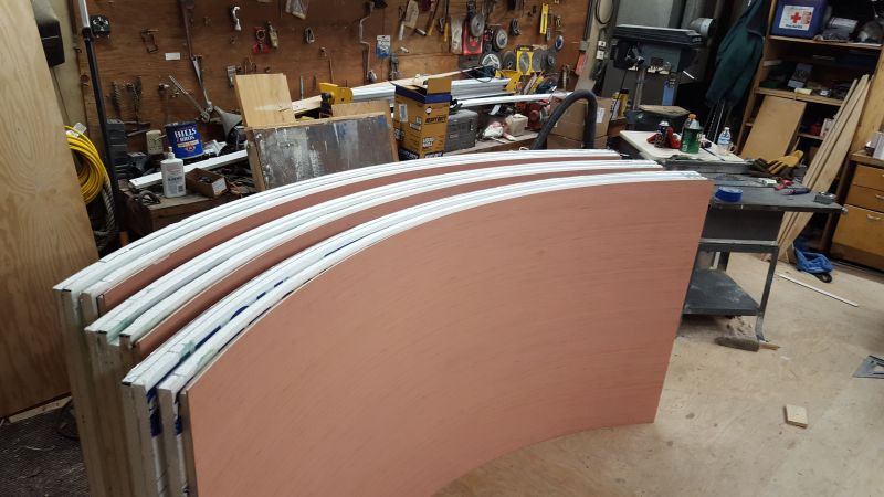

In an effort to build a well insulated cabin that I could prefabicate and assemble myself i decided to try and make it out of laminated polystyrene panels.. wall/roof panels ready to install

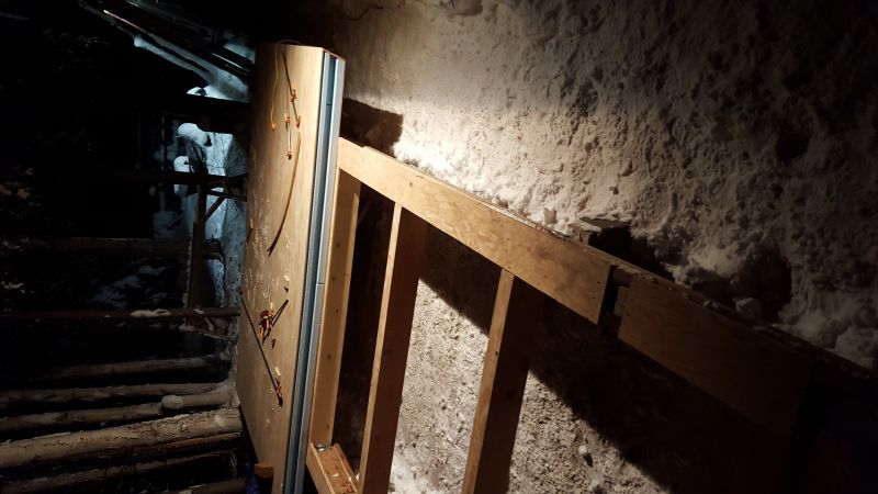

|  first panels installed

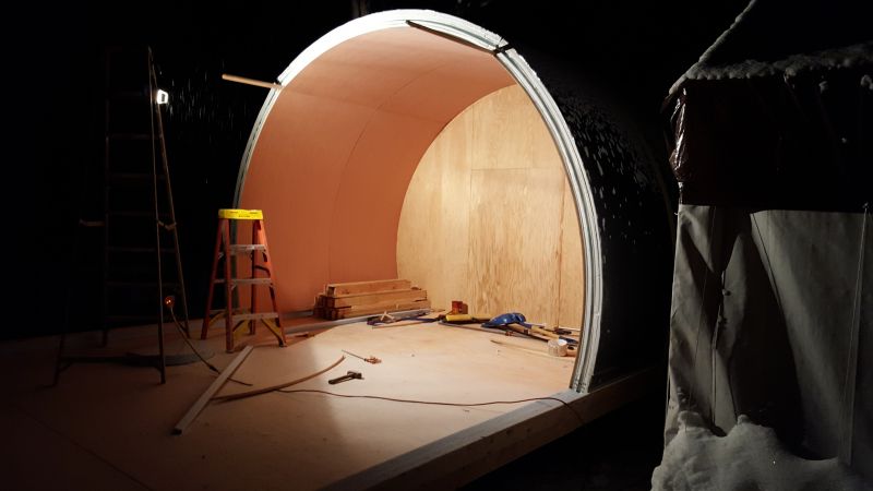

|  before cutting in the dormer

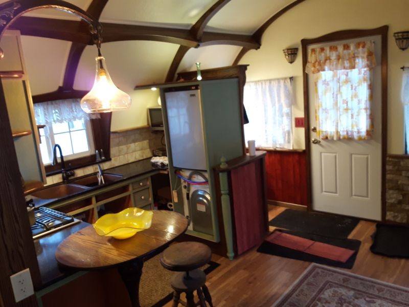

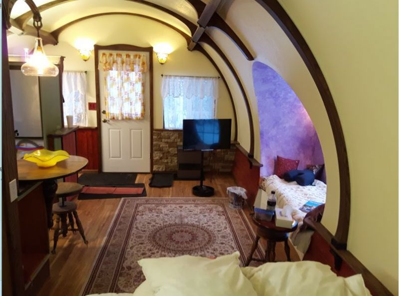

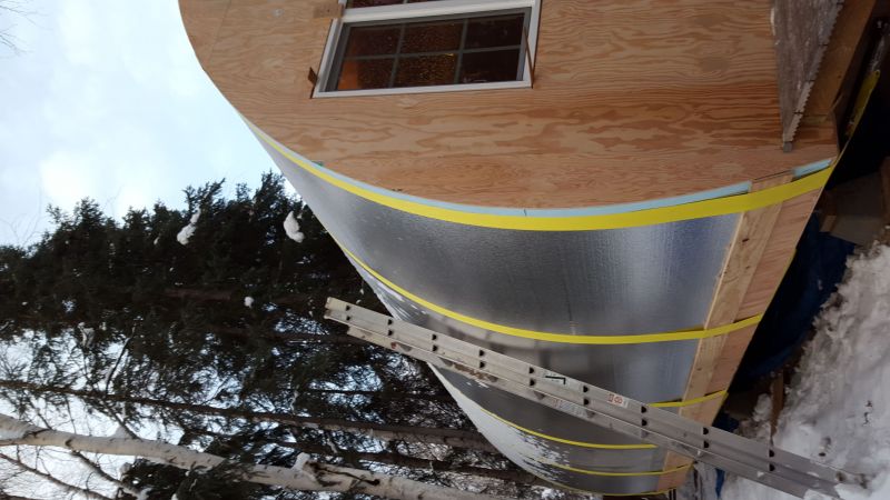

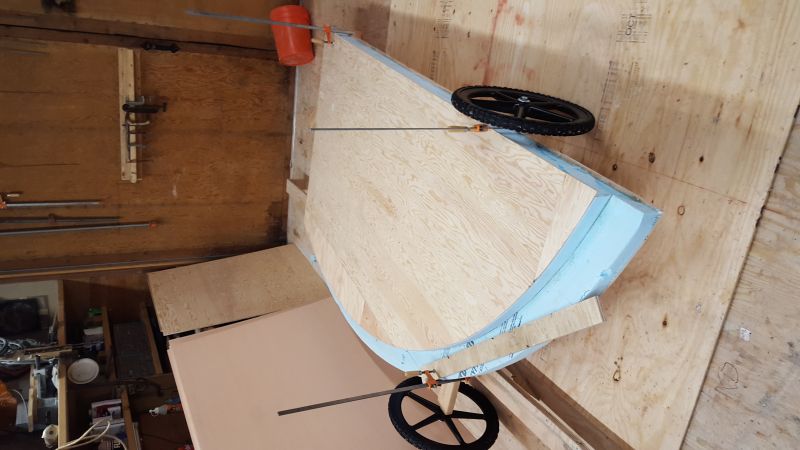

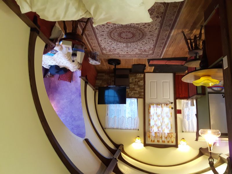

I still need to do a permanent roof but for now I wrapped it with snow and ice guard.. Still some final finishing to do on the inside but way livable in the Alaska winter.. I hear it with a popcorn fart since there is almost no thermal bridging because there are no structural members inside the panels.. just foam. beams are fake from foam
|  8ft 6" ceiling at the center

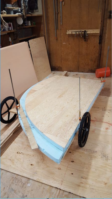

|  part of end wall set up on wheels to drag out

# Posted: 16 Jul 2018 12:35pm
sorry about the sideways and upside down pictures.. they didn't look like that in the album.. maybe a moderator can help me adjust them

# Posted: 16 Jul 2018 01:52pm
How did you bend those panels?

# Posted: 19 Jul 2018 01:35pm
Happens to all of us from time to time...   beams are fake from foam

I've built a lot with xps/polyiso for insulation. Great R value. Pretty easy to work with. But I've never done arc or bent shapes. I might have to give that a try. Any tips on bending foam?
